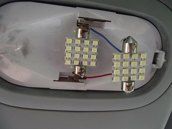

In terms of lighting the standard interior light I just had 16SMD festoons, jacked together like so: (one is reversed)
But I suspect you can get away with 2 24 or 36 SMD panels next to each other (easier to solder actually), I've got 2x 48smd panels here but they're just too wide to get 2 into the holder.

... But it's still far easier to just do the maplight conversion lol.

The flip style light is way better imo, after experiencing both as it allows for a bigger bulb. But it's a pain in the arse running led's in them as you have to do what McGherkin mentioned further up.
