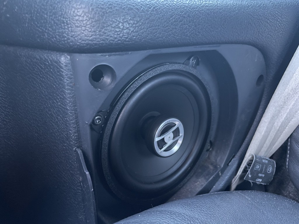

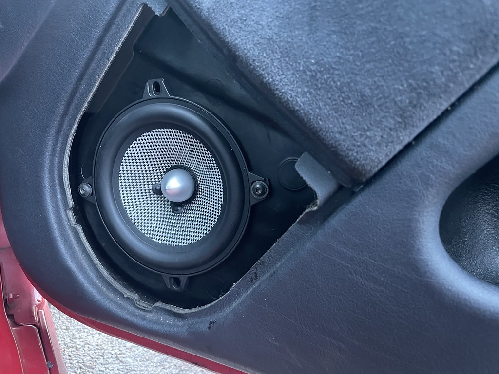

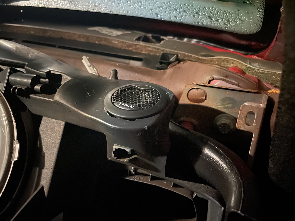

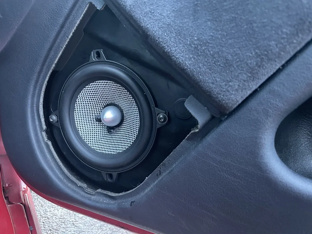

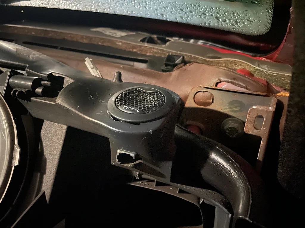

I grabbed a few pics of the fitment for anyone interested. I'm quite happy that it was possible to fit is all discretely.

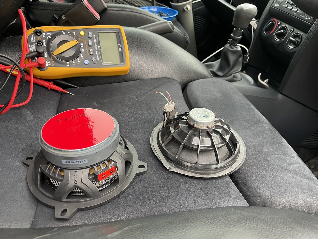

New vs. Old - If this doesn't offer a decent improvement once driven properly, I don't know what will!
by mikehhhhhhh, on Flickr
Untitled by mikehhhhhhh, on Flickr
and the rear;

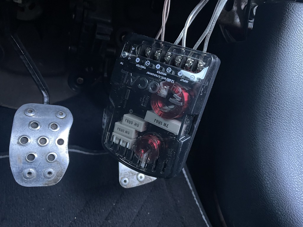

Have you had to run new wiring into the doors from the crossovers or have you used all the oem wiring?
Tempted by this now.
Yeah, I've cut into the OEM wiring close to the car side of the door plugs for the crossovers.
In hindsight,I probably make it more complicated than I needed to doing it that way. If I did it again, I'd probably do it from behind the headunit with an ISO extension loom to avoid modifying the factory wiring - that way there's no need to trace wires, either.
  182 Trophy
In my case i could just add the crossovers in the existing ISO lead couldnt i?
Where is the wiring split for the OEM mids/tweeters?
Absolutely.
It's not split per se as the filtering is done on the tweeter. The tweeter wire seems to come from the car side door plug. I didn't reuse the tweeter wire, though.
frayz
So if the crossovers were connected at the ISO lead, the OEM wiring to the doors would be used to power the mid drivers in the doors but then id run new cables from the crossovers just for the tweeters?
