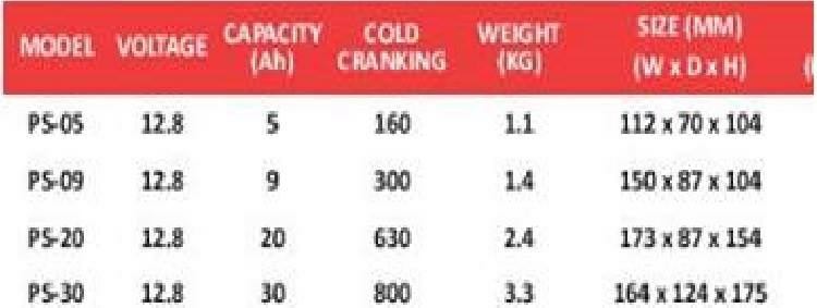

So I'm looking at one of these batteries. I, like you, use my car a limited amount during the year. I think @cpaterson76 ran something similar on his old trophy.
I'm not 100% that this will be sufficient for us however hopefully someone on here will be able to help...
For ease the spec of the battery is as follows:
  • Weighs just 898gr which is over 3kg lighter than standard
  • Comes with built in LED condition indicator panel
  • Can be mounted in any position without risk of spillage
  • Improved efficiency & cranking power compared to lead acid
  • Fast charges to 90% in around 6 minutes
Technical Data:
  • Voltage -12v
  • Manufacturer Claimed CCA - 240cca
  • Dimensions - 150mm x 87mm x 93mm (LxWxH)
  • Weight - 898gr
  • Recommended Charging Current - 2.0A
R3k1355
240CCA from a battery that weighs less than a kilo?? Smells kinda fishy to me?
Also isn't the standard battery closer to 20KG not 4KG??
Power Lite batterys are MSA certified, this 1.4 KG battery should be fine for track use, will only set you back about £100.
As with all Lithium batterys you need to use an isolator to prevent it draining when not in use, they also usually need a different charger, which Power Lite usually include.

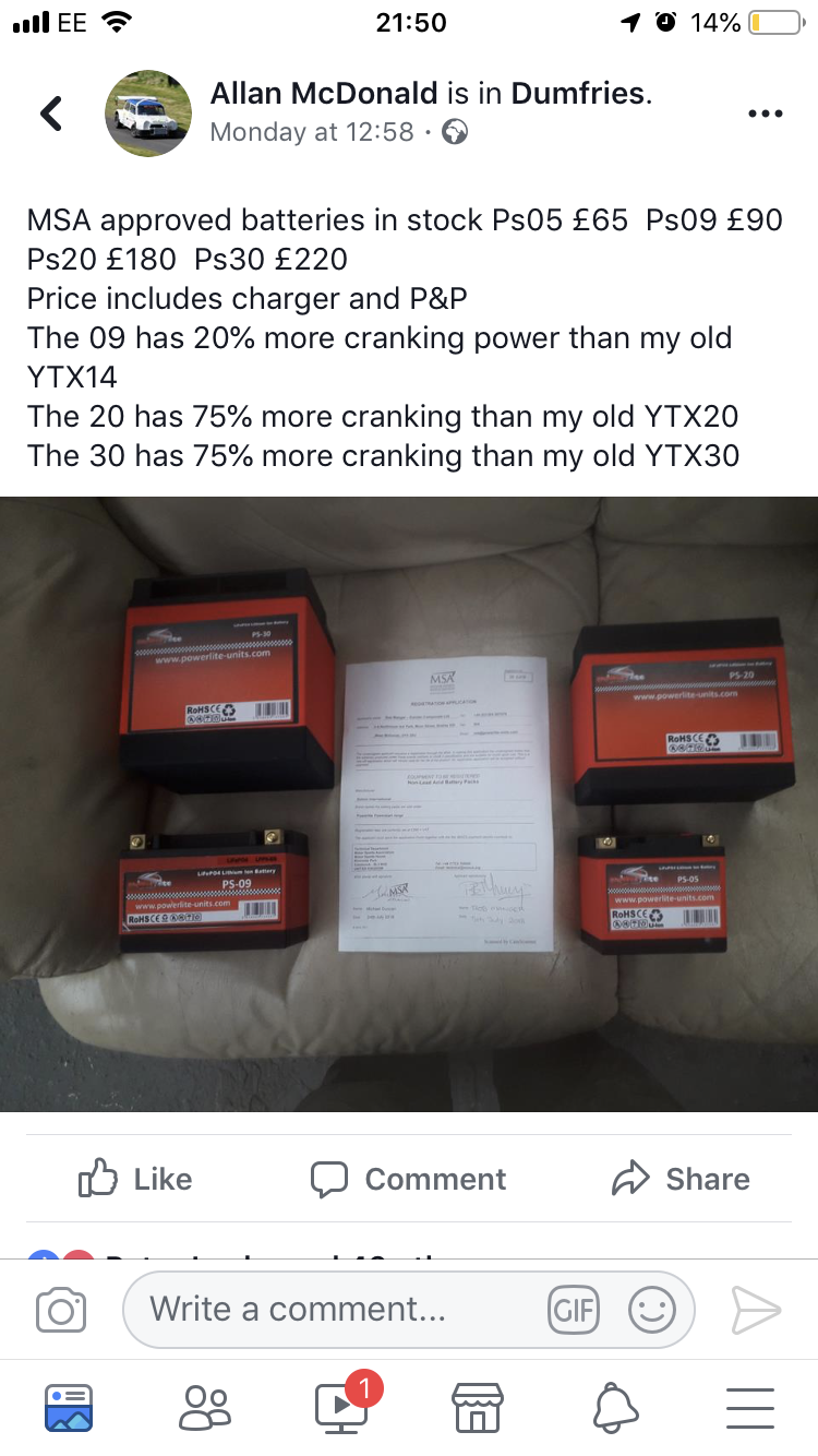

I was speaking to Paul Roddison at Roddisons Motorsport in Sheffield last week, he showed me a battery he uses on all his race cars. I think they are £240 and weight around 0.5kg. They are so light its insane. I will be doing the light weight battery route before any fibreglass panels now!
R3k1355
The link you provided wasn't great however I think I've found the batter you are referring to:
https://www.ebay.co.uk/itm/PS-09-Po...m546b6da21f:g:9VEAAOSwC71chjaA&frcectupt=true
Yea sorry eBay was down all day so couldn't grab a good example link, they were actually mentioned earlier in this thread though with the prices being a touch lower.
Maybe try to track this person down on Facebook, see if they still do the PS-09 battery at £90??
Their not as expensive as you think!
This is a well known sprint / hillclimb competitor who supplies batteries. PS09 is reccomended for Clio
R29TJR
  2005 RB 182 Cup
Funnily enough this is what I have done!
I paid him this morning £95 delivered currently including the charger, although he only has limited stock.

Looking at those Powerlite ones now for my car. Currently it’s driven a few times a month with the odd trackday thrown in and is hooked up to a Ctek charger when not in use. The car is alarmed/stereo fitted so there is some drain when not in use, never had an issue as long as it is on charge though.
Am I right in thinking that the PS-09 (based on someone saying this is recommended for the Clio), PS-20 and PS-30 will all have enough CCA to get it started, and that I just need to decide on the ah rating (aka how long it will last when stood off charge – unlikely!)?
Think I already know the answer (no) to this but can there be any issues using a much higher CCA battery than “standard” (current one is 440cca) if I’m aiming to get the ah rating as close to a “normal” battery as possible?
R3k1355
Should be fine starting the car, it's a popular battery for hill climbs and such so you imagine it's being used to get high compression race engines going.
PS-09 seems to be a popular choice for sole race use, but you might want the larger ones if you'll be using it on road and stuff as well.

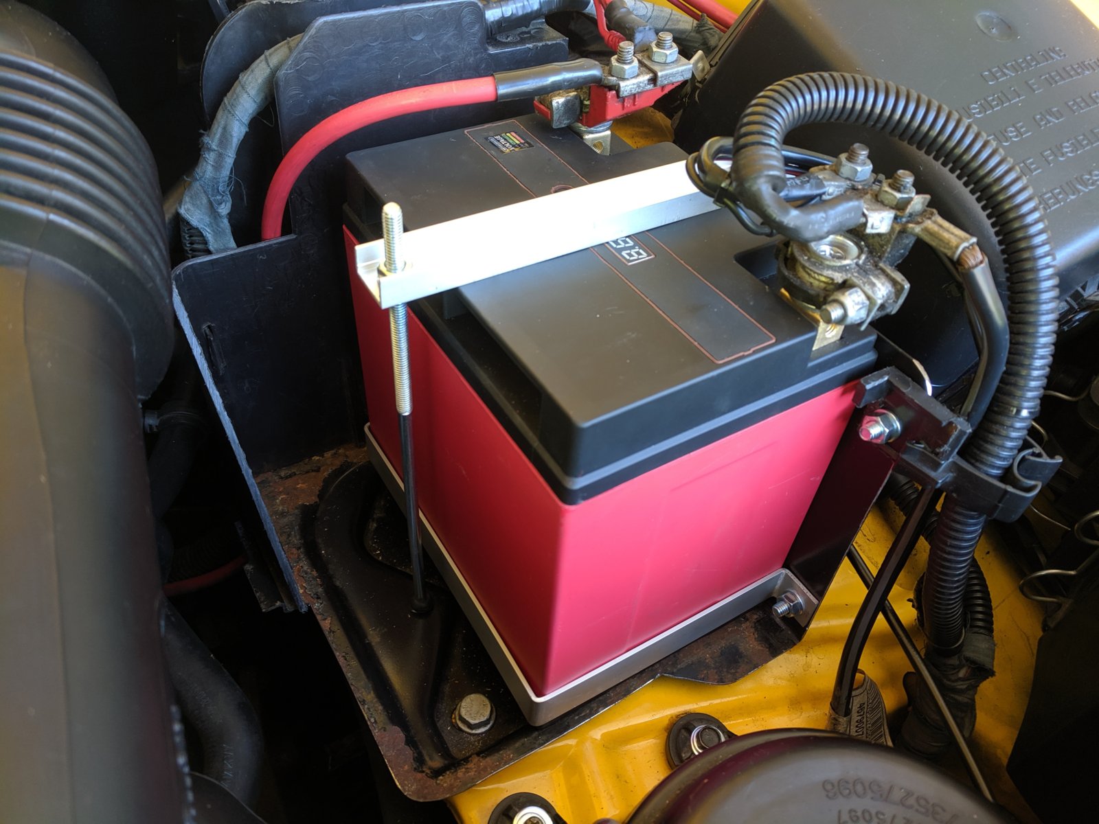

Did end up fiddling some more, obviously not a Clio but might give someone an idea.
I had the brace across the top to stop it wobbling on the single metal upright of the original battery holder so decided the full bracket was kind of pointless. Bent up a piece of aluminium to match the bracket shape just to hold the bottom, should look pretty tidy with some paint/powdercoat and hide my dodgy angle grinding a bit...
Just need to get rid of the bracket now and win some money back lol.
