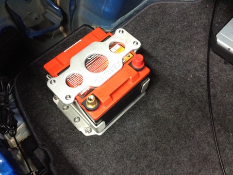

Here is a picture of when I was relocating an Odyssey battery to my boot...
Its a recommended mod especially if you are looking to shave more weight from your car,you would be surprised how much weight a standard battery is:fearscream:.SJ.

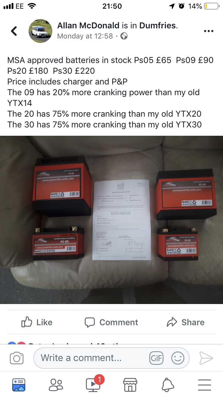

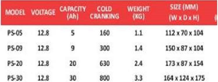

Their not as expensive as you think!
This is a well known sprint / hillclimb competitor who supplies batteries. PS09 is reccomended for Clio
