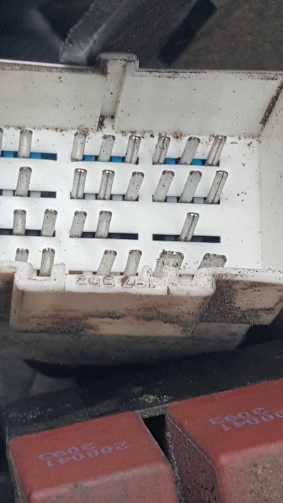

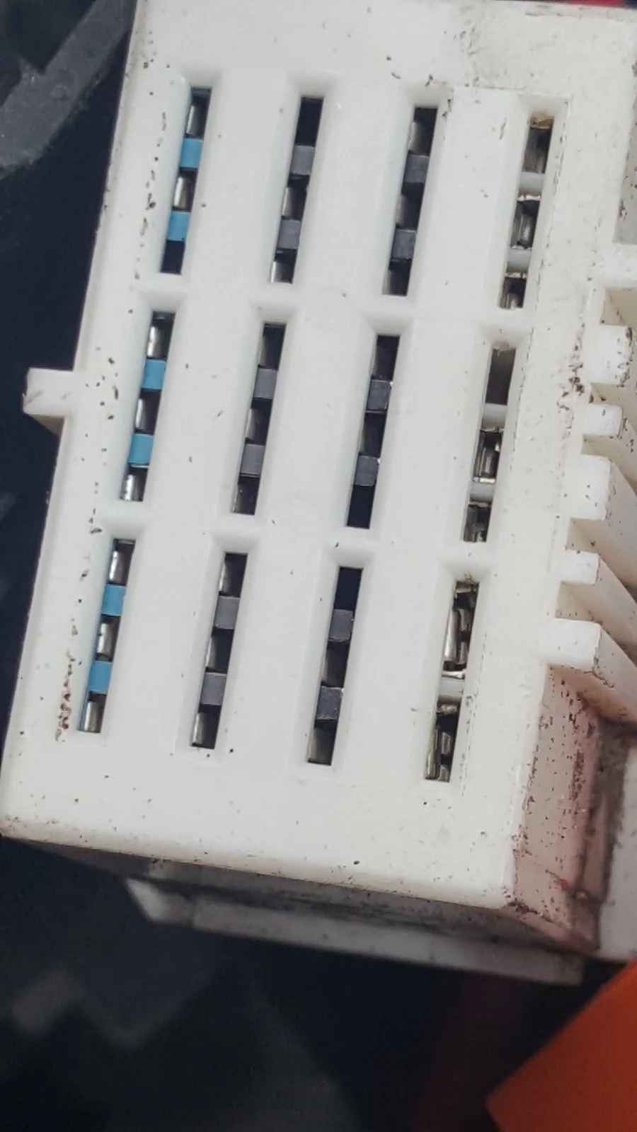

Corrosion on big white plug in fuse area on engine bay cured mine.Who was the specialist ?
ADS_V6
  Seat Leon
Large white plug in fuse box next to battery,the pins get corrosion and ecu thinks throttle problem
  clio 182
Hmm will take a look tomorrow day. Is it just a case of wiping the plug off and clearing the codes or do i need to get a new one

Clean it ,other than that hit limp mode in search button loads of info.Mine was putting squiggly lines and engine light on randomly .This stopped it brand new throttle from renault did sod all

Give the connectors a clean before. Not sure how corroded they usually get but i give it a spray with wd40 and used a small screwdriver and tissue to wipe the connectors down. Will see if it goes into limp mode on my way to work tonite

after i paid a reputable specialist £40 to plug it in and tell me the same as what my mates with diagnostic readers also told me i dont fancy spending more on a car that was meant to be a temporary run-around. I have spend close to £1000 on it in parts since Oct already. Its pointing to a fuelling or wiring fault somewhere as the usual fixes arent working. Its less hassle to walk atm. Going to check the injectors and clean that plug properly with an air line next week and if its still the same im just going to leave it. Thanks for the input though its appreciated

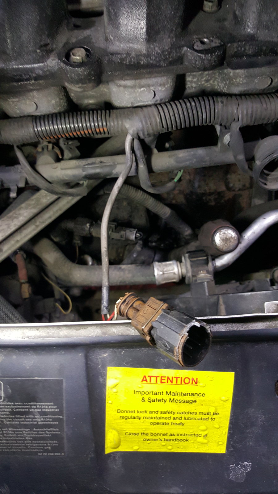

After looking its the knock sensor thats snapped off was barley being held on by anythibg. Not sure if it would cause the limp mode problems

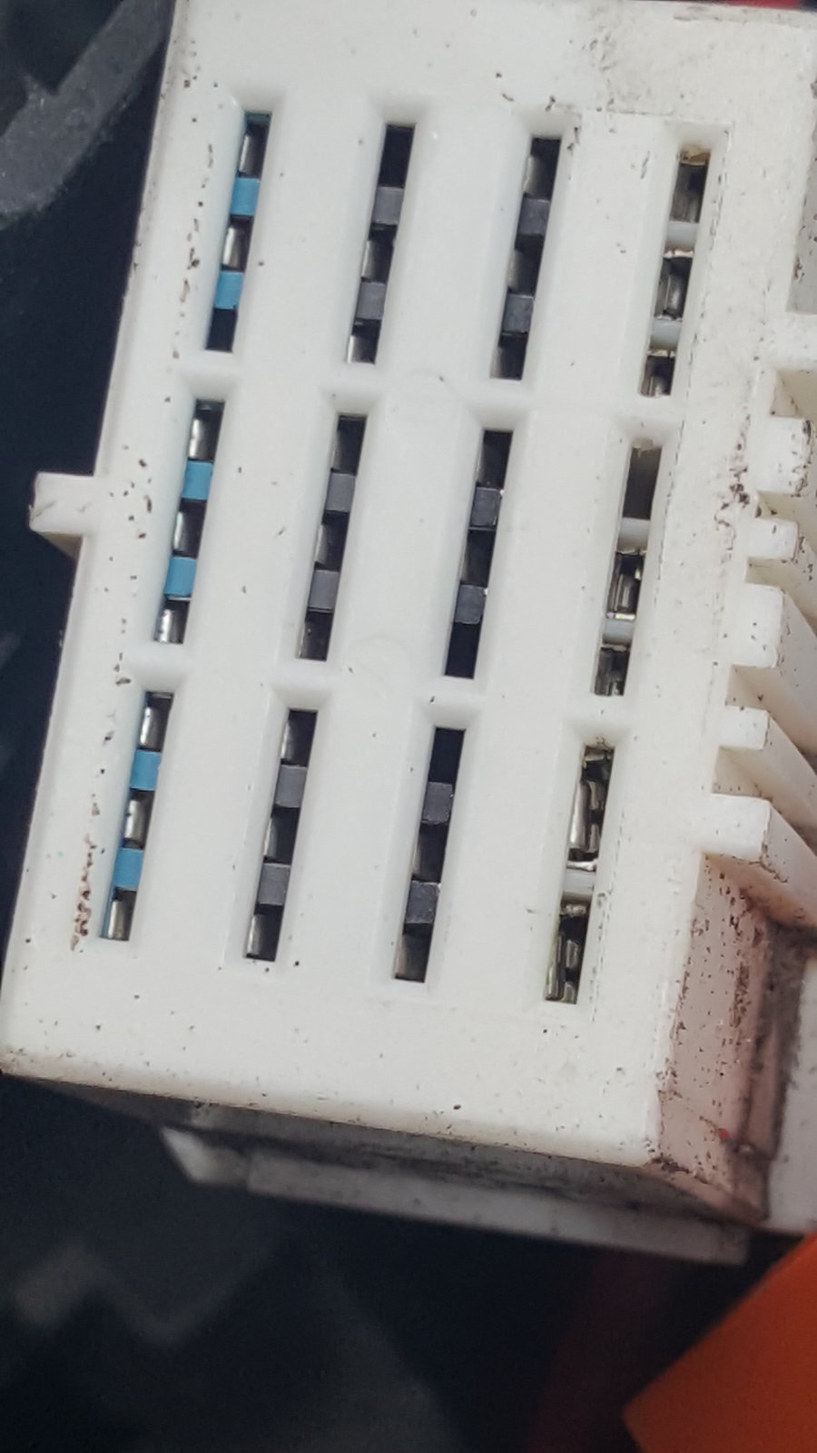

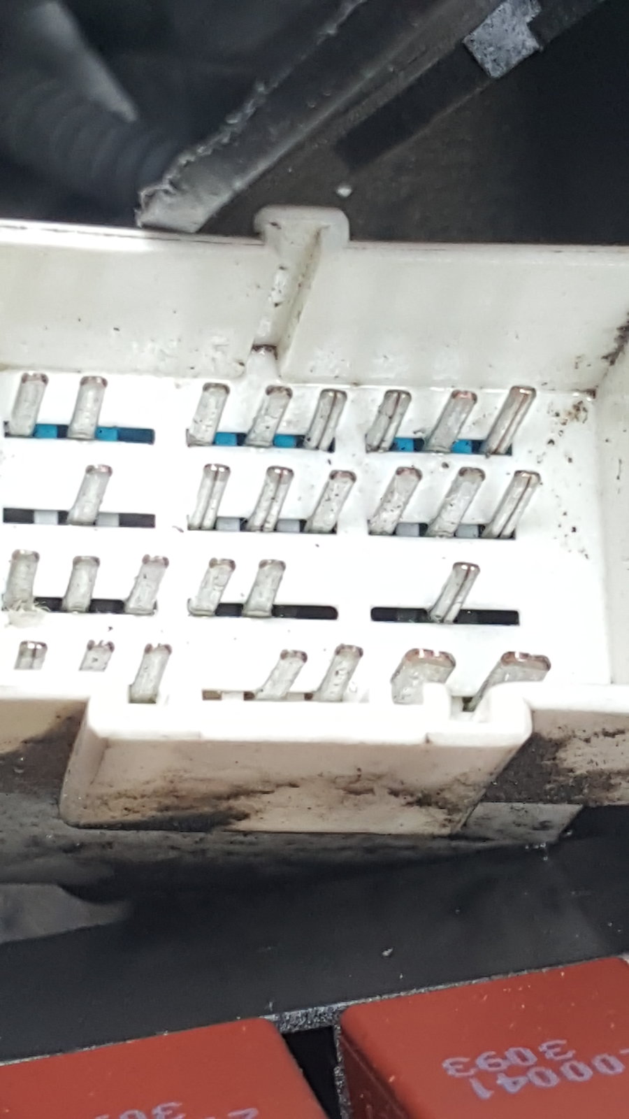

I was thinking you have more than one problem,as being in limp mode because of wiring corrosion in the throttle track circuit will not cause a misfire or flat spot.A poor connection to knock sensor probably will though.
The corrosion in the white plug is not pin to pin,but occurs from pin to copper wiring joint.

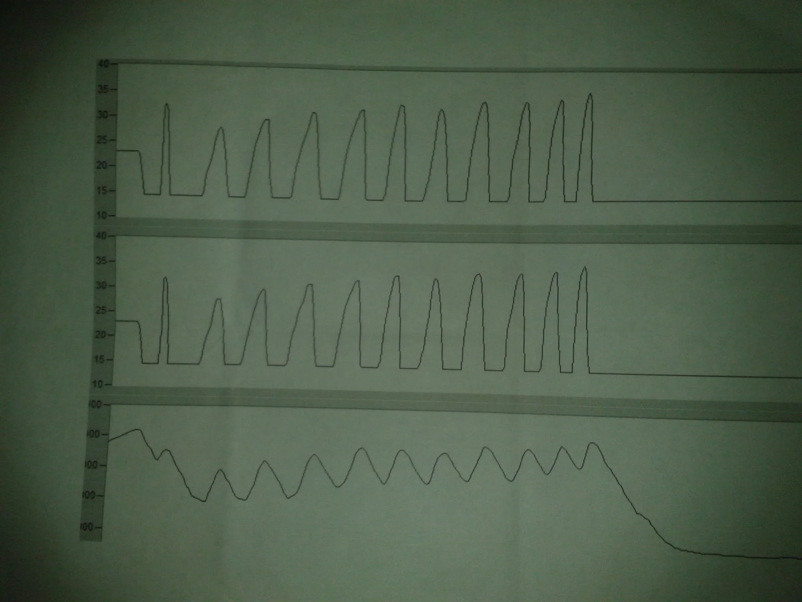

This has been dragging on for too long now.I would recommend you get down the 75 miles to Mick at Diamond Motors in Long Eaton and get it sorted whilst you go for something to eat in the local cafe.
He will only charge for his time,not for the use of his diagnostic kit,and IMO his charges are very reasonable.
