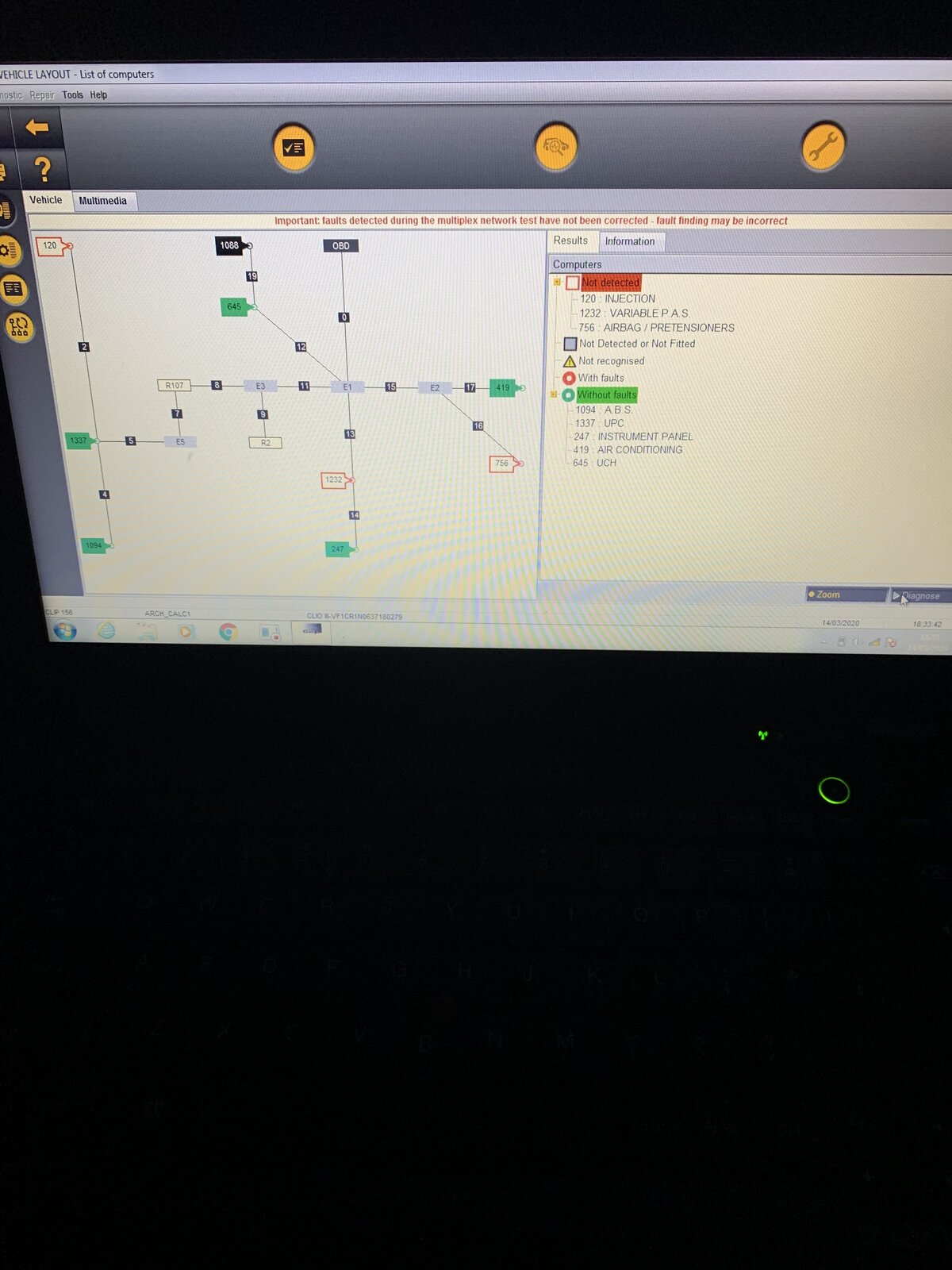

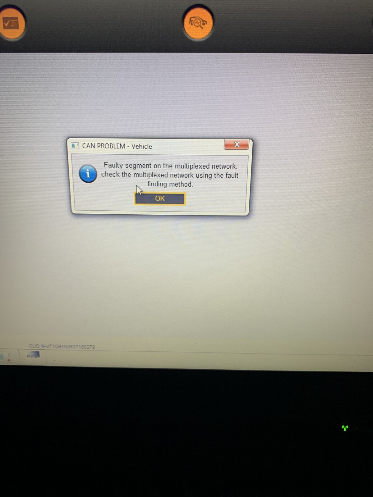

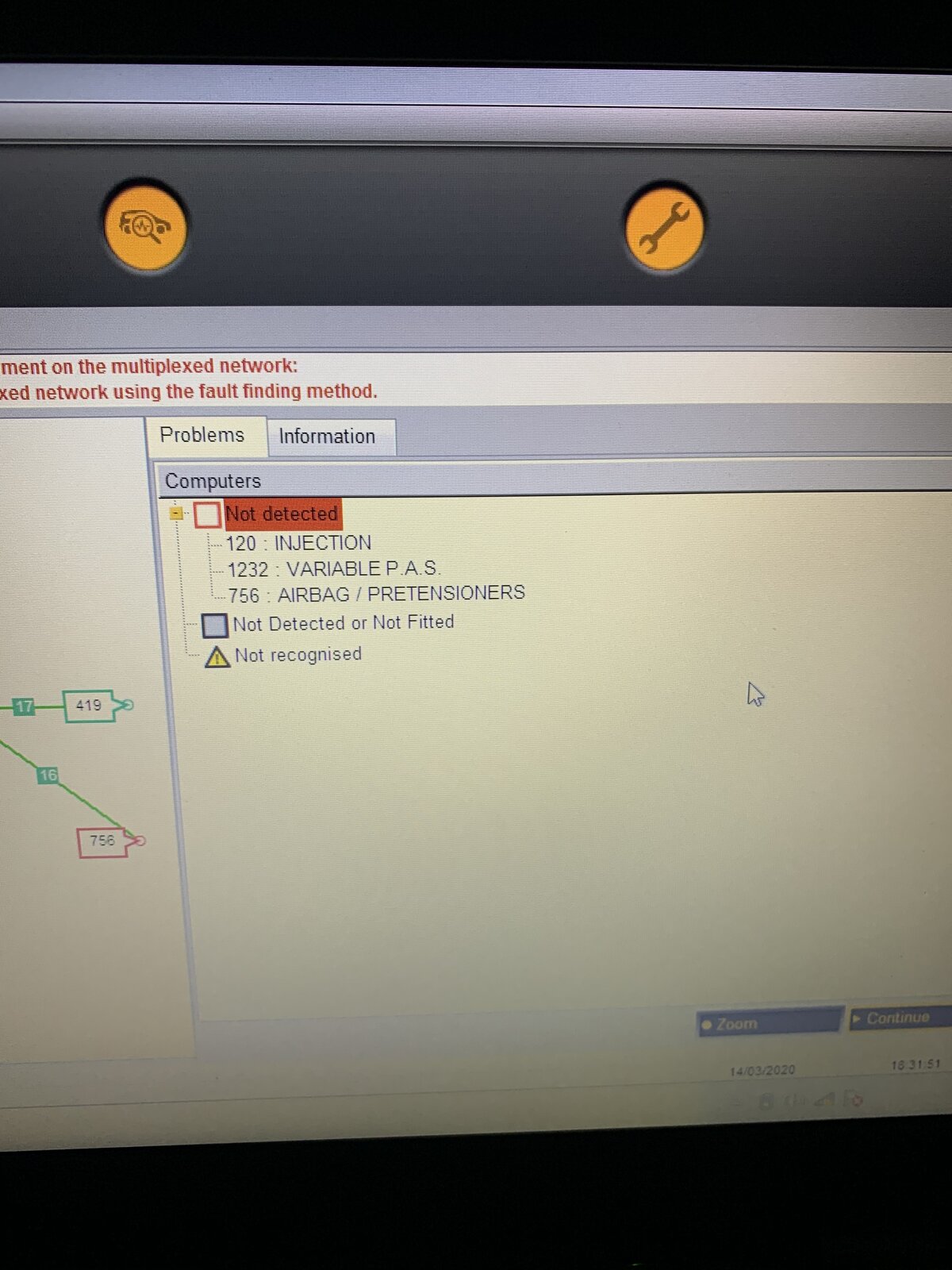

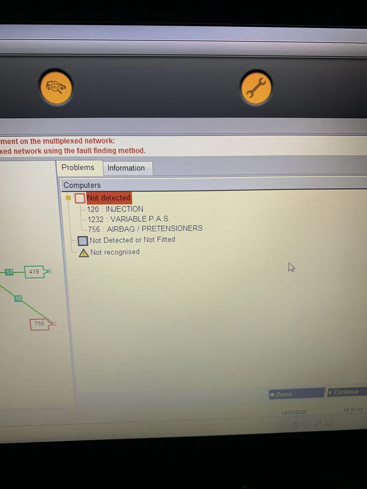

3) When diagnosing with CLiP, occasionally it'll say issue on the multiplex network, and then certain computers aren't found, then they are, then they aren't etc. Wondered if there's a specific component or part that might make this fail now and again. (Will attach screenshots)

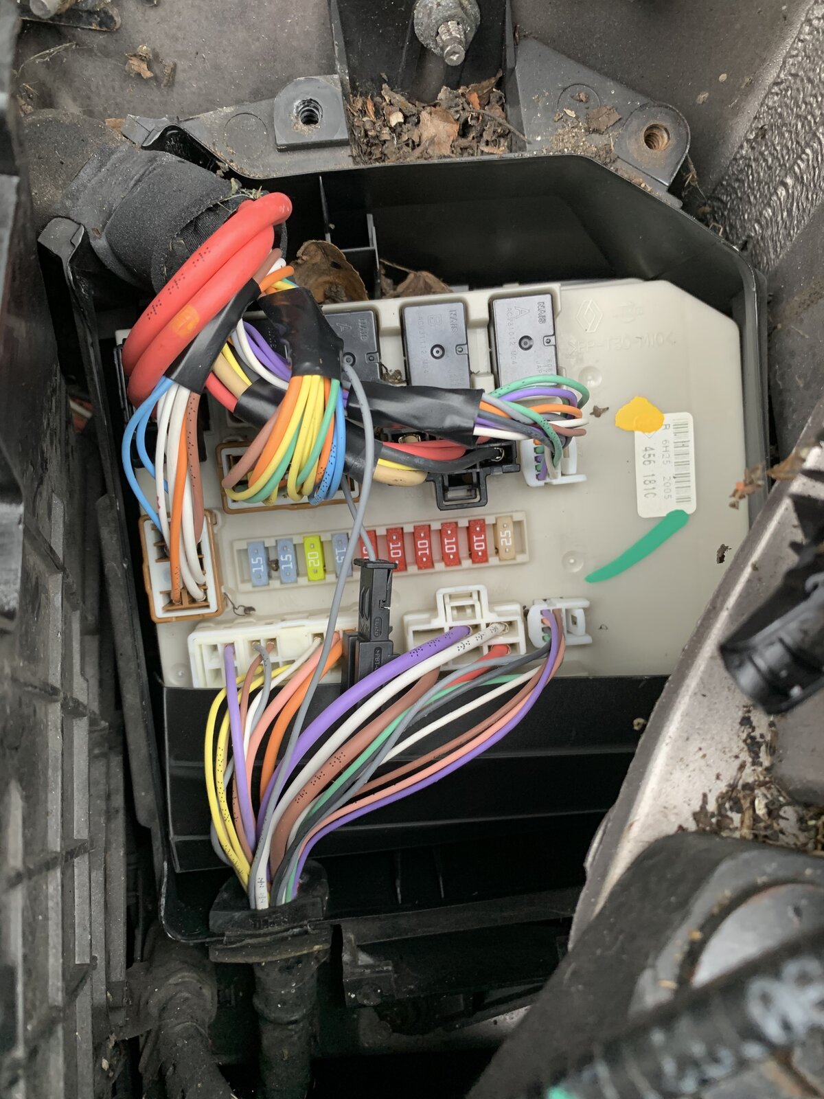

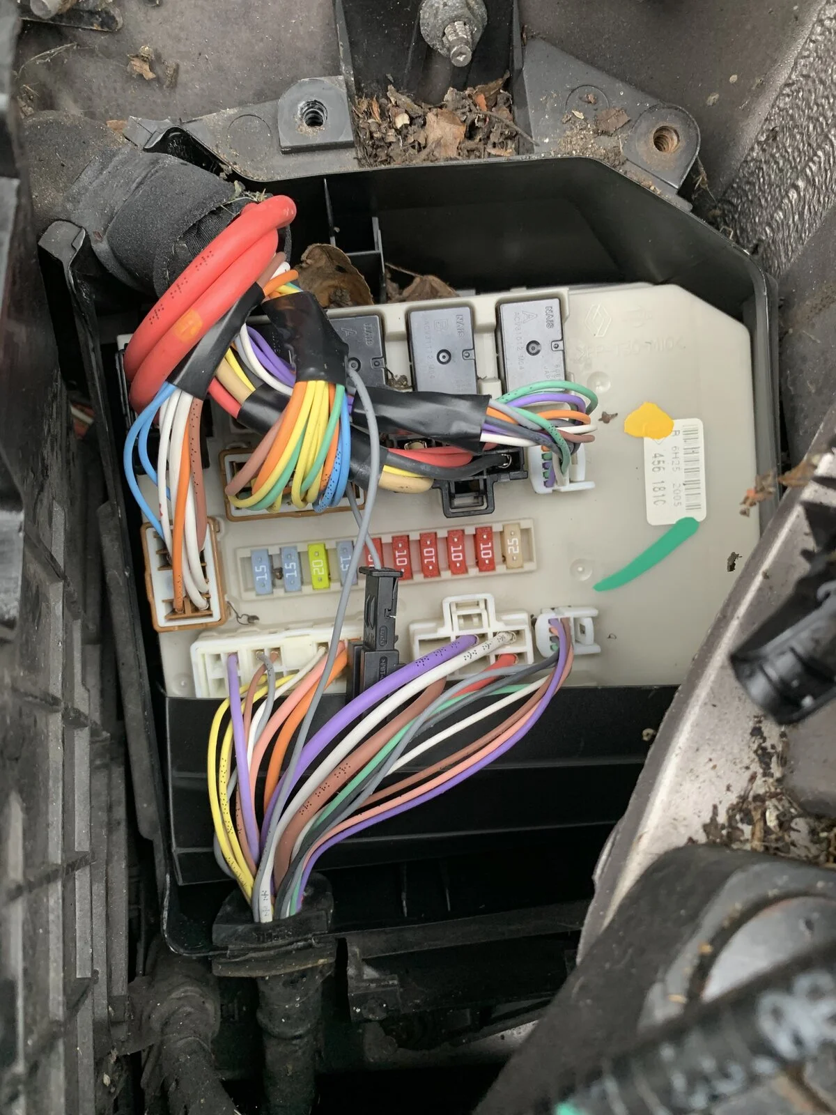

my 197 started having strange electrical issues, turned out that some CAN wires in the harness in the engine bay had shorted together and needed stripping back and repairing. Down by the fuse box in the top right of the bay as you’re looking at it. Under all that basically.
It’s apparently not uncommon due to the drainage from the scuttle panel.

I’d be going through the basics first, check wiring connectors to ecu, fuse box connectors, fuses are clean and clean the relay connectors etc. Cars that sit around like growing corrosion on electrical connectors and plugs.

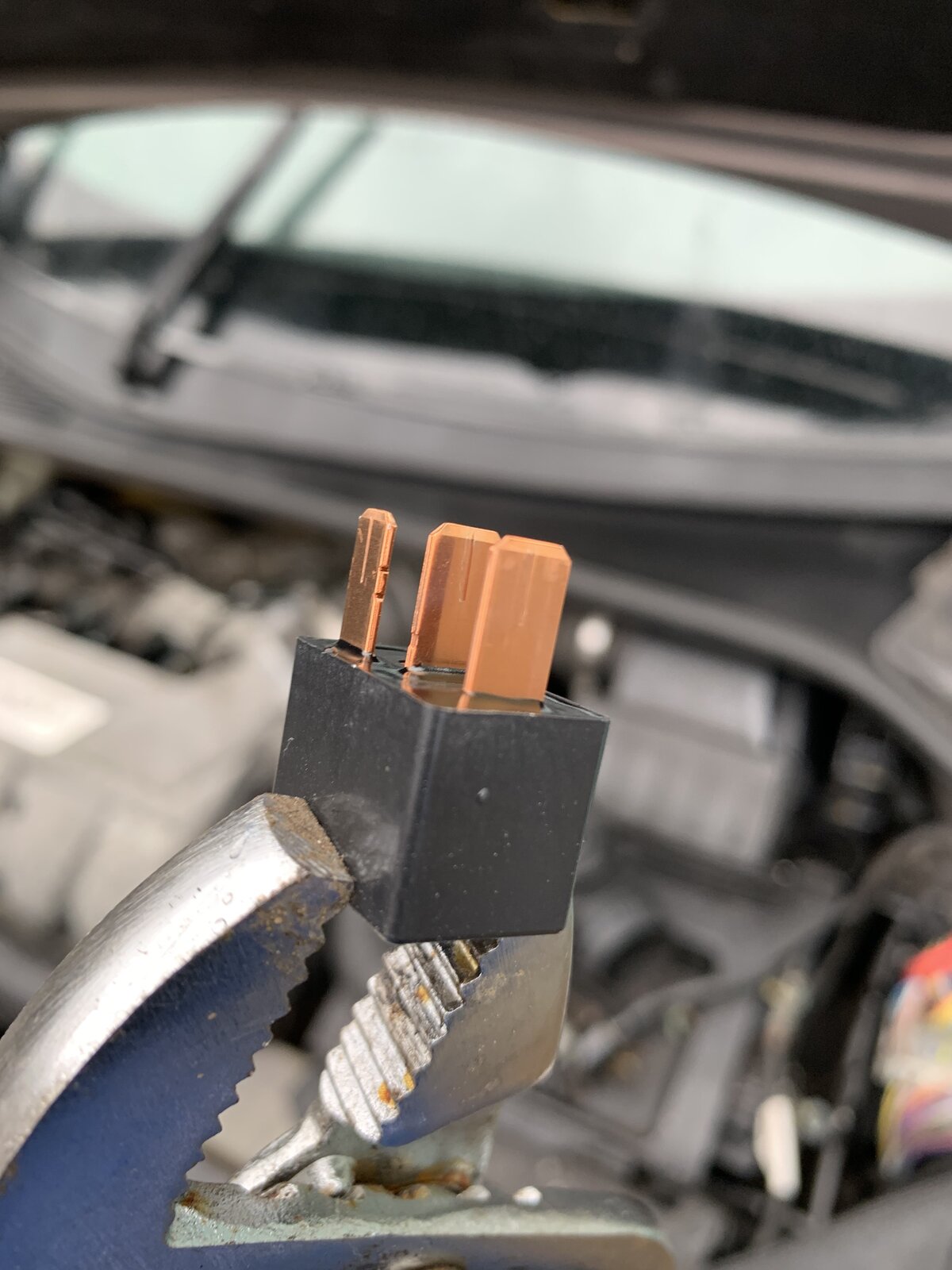

It's currently chucking it down but I managed to remove the acoustic valve and the fuse box cover and had a quick look over everything.
If I'm entirely honest, it looks really clean in there. All fuses seemed to be in good condition and relays too.
