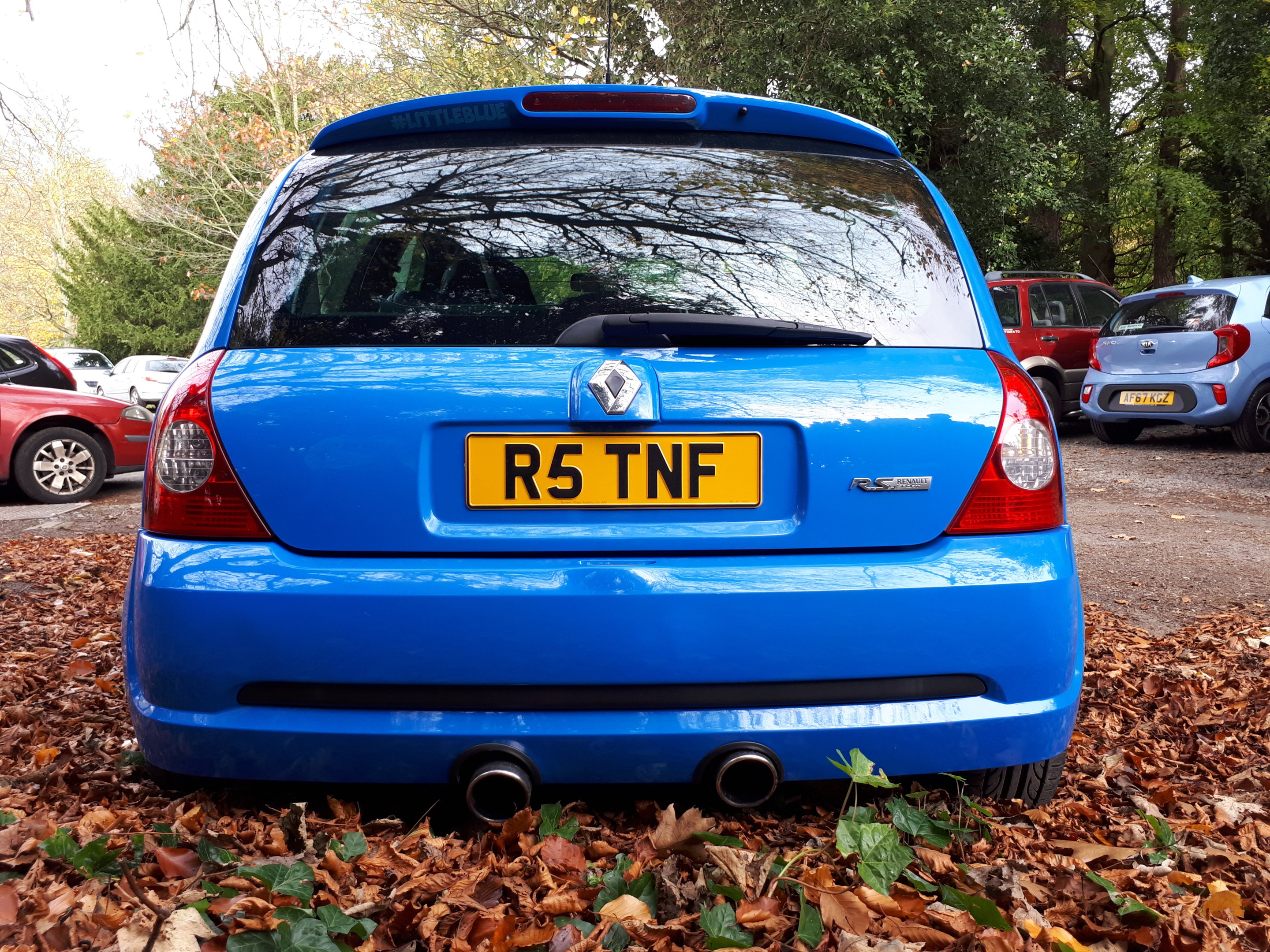

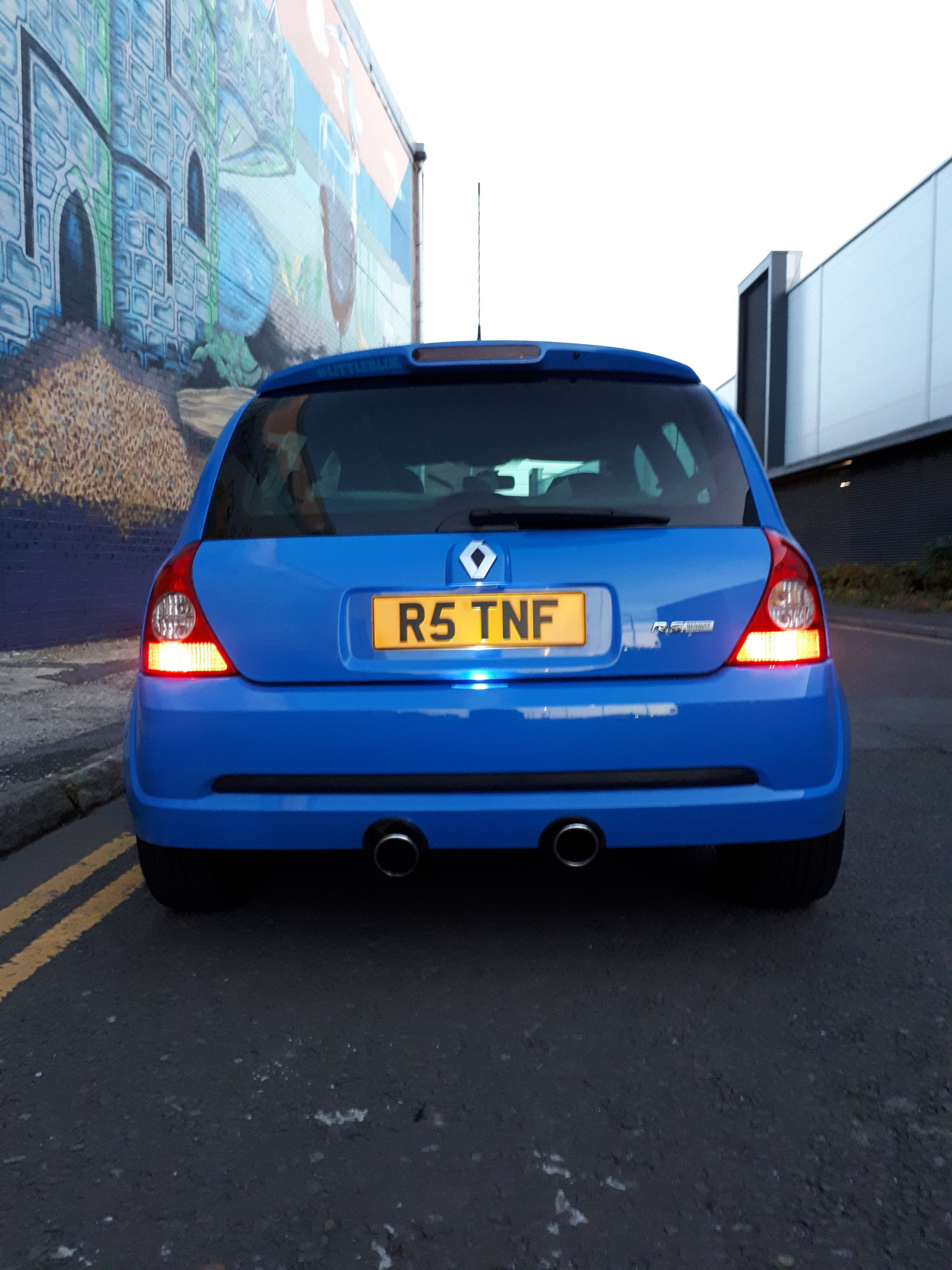

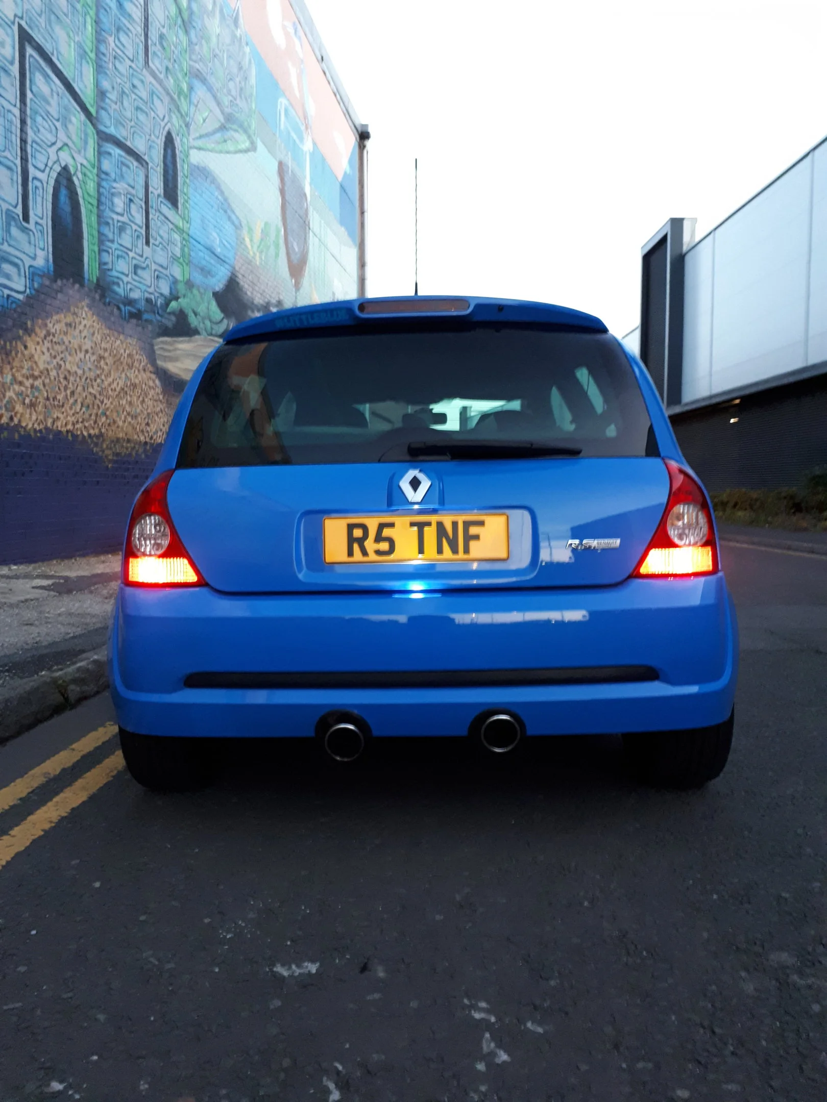

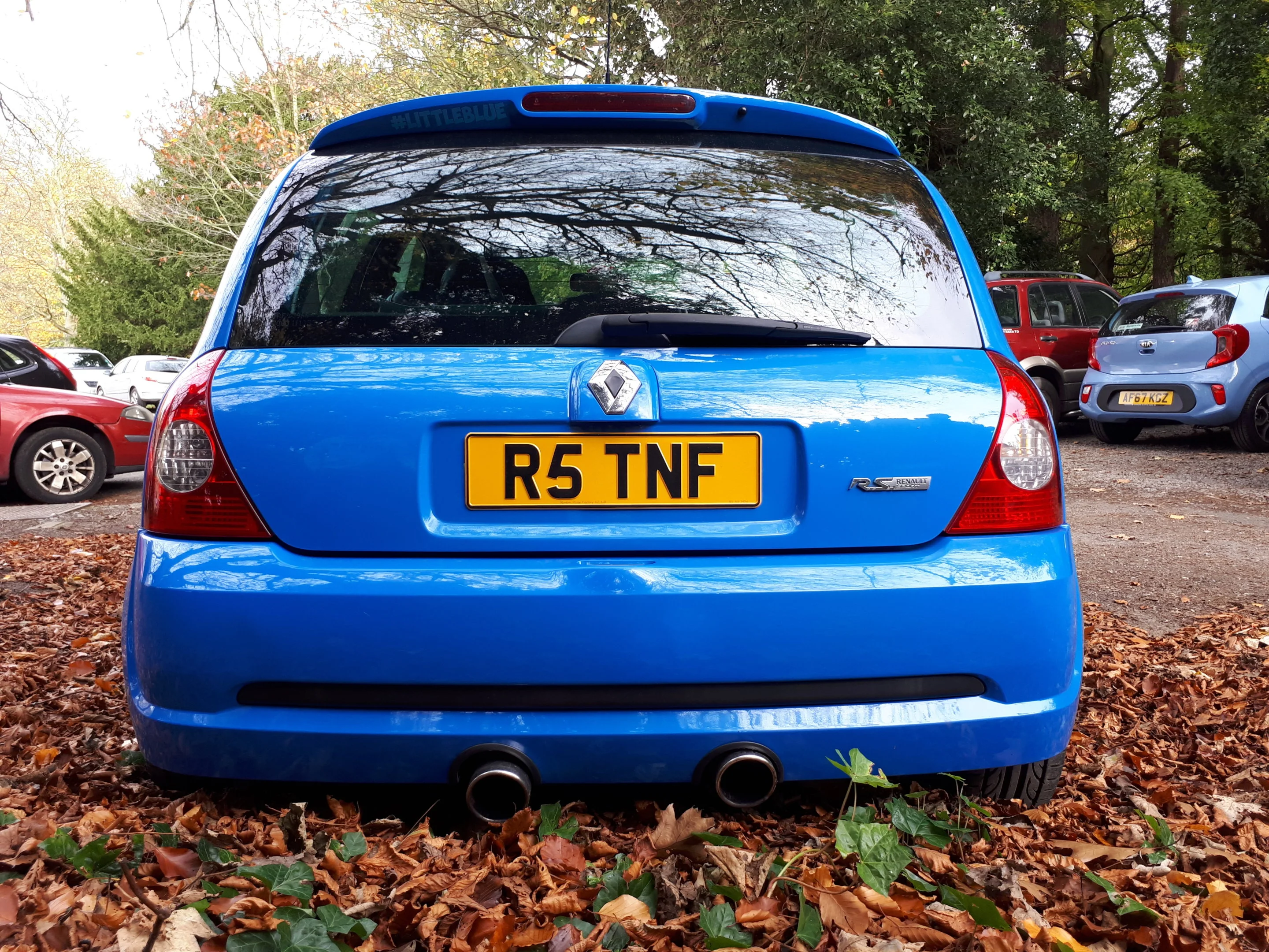

Best shot I have of the pipes ..
  Clio 182
Left rubber looks like it’s failed to me. Easy to spot once you look under the bumper.
Get some polybush replacements as the rubber ones don’t last with the heavy stainless exhausts.
Easy fix
