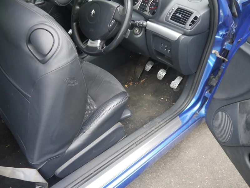

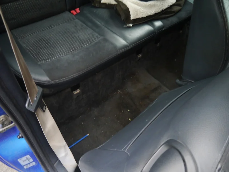

  • The car needs a good detail. The interior carpet in full daylight is shockingly stained, I'd imagine that the car has been used to transport dirty car parts at some point as there's rusty bolts and all sorts of odds & ends under the boot carpet edges. The paint isn't in bad condition generally but the plastics are all faded.

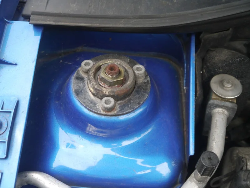

  • The spring rates are too high all-around which is most likely being used to hide cheap dampers.
  • The rear ride height needs lowering, it not only looks odd but on bumpy roads around here it can be quite un-nerving.

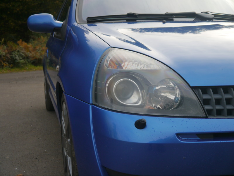

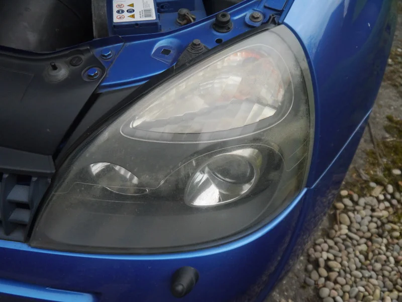

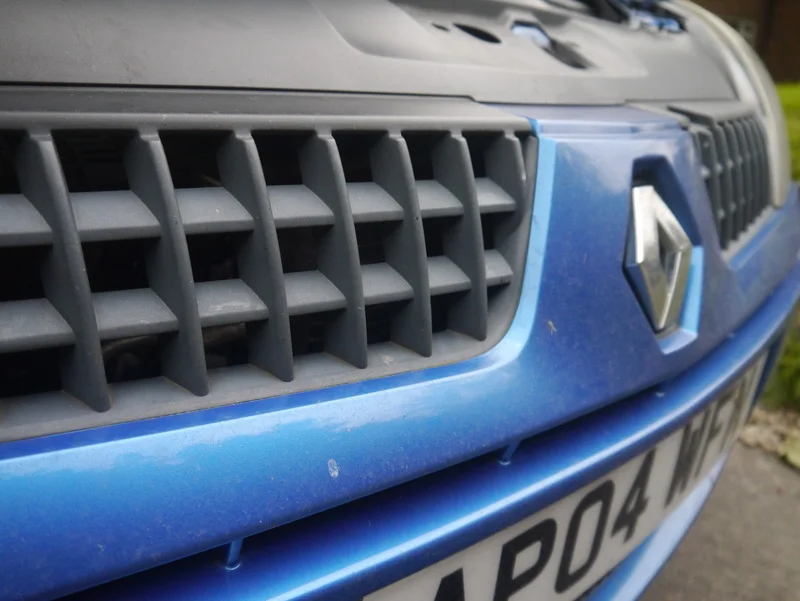

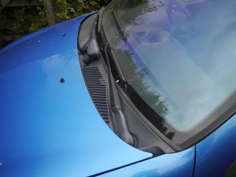

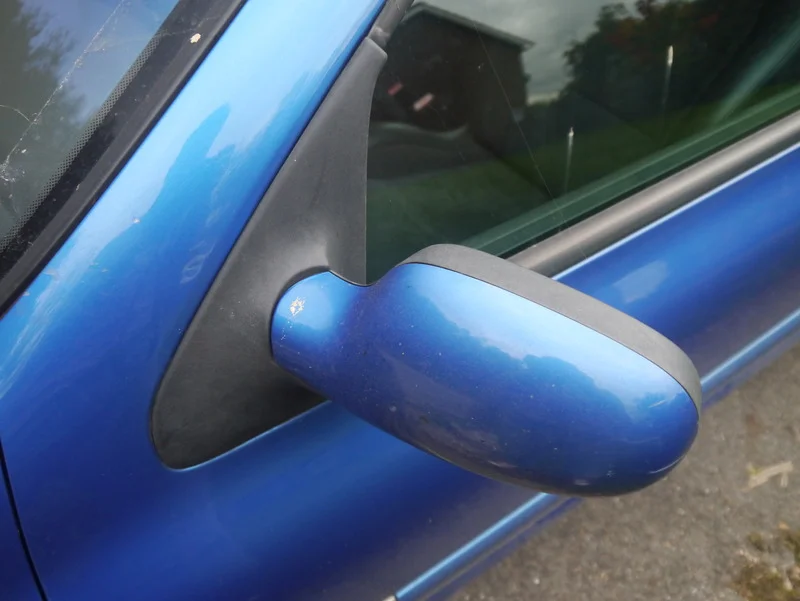

So here are some photo's of "Little Blue" - please excuse the lack of washing, I've got man flu.

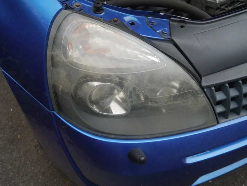

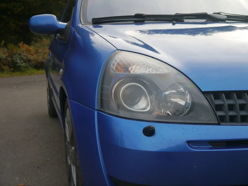

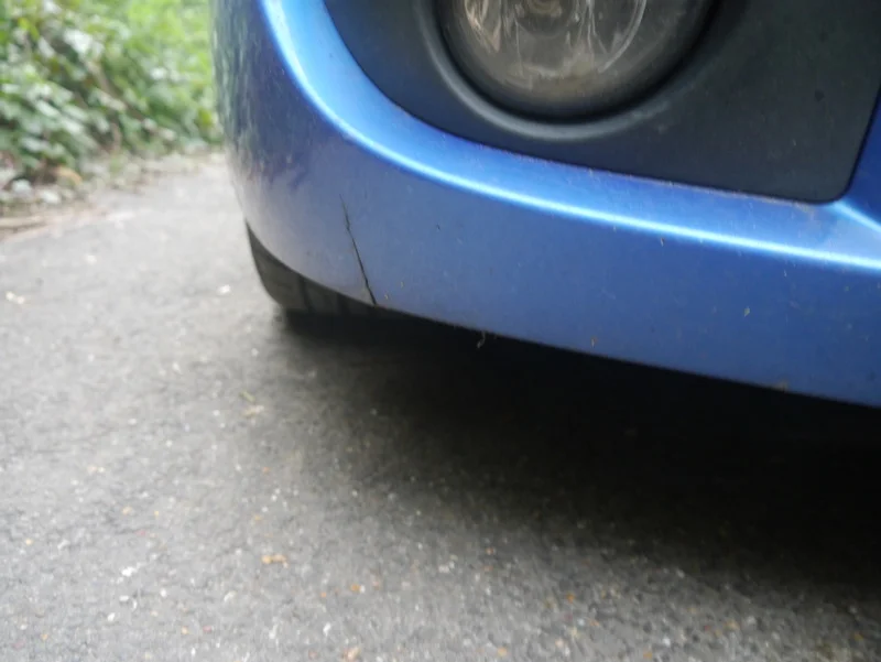

Exterior - needs some loving, fading plastics etc...

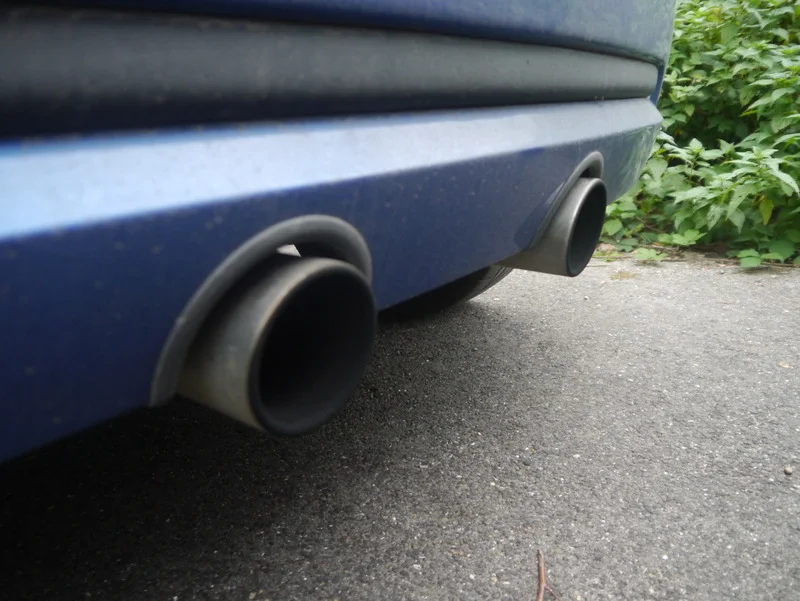

Slightly wonky Milltech - hard to see in this photo but the left tip needs a tweak

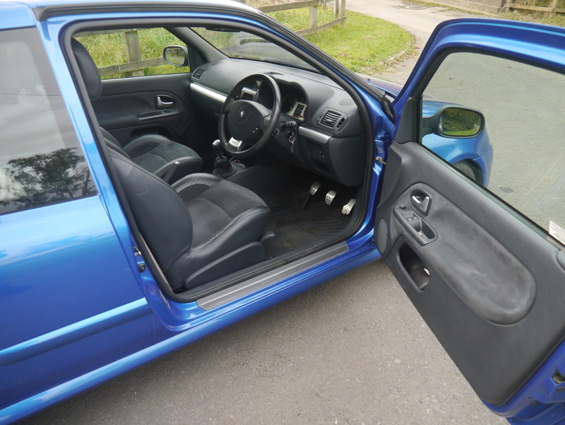

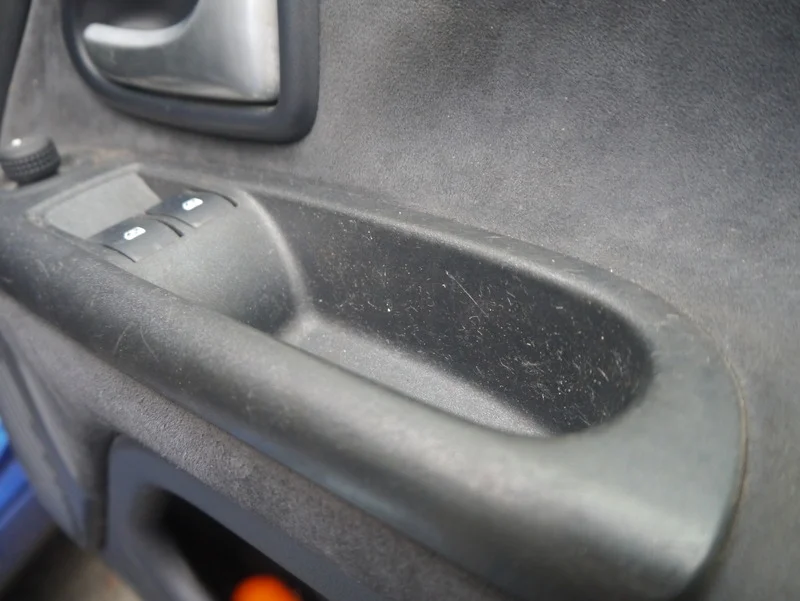

The interior...

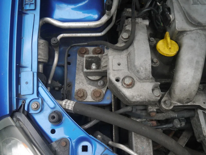

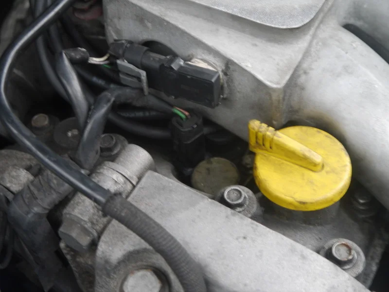

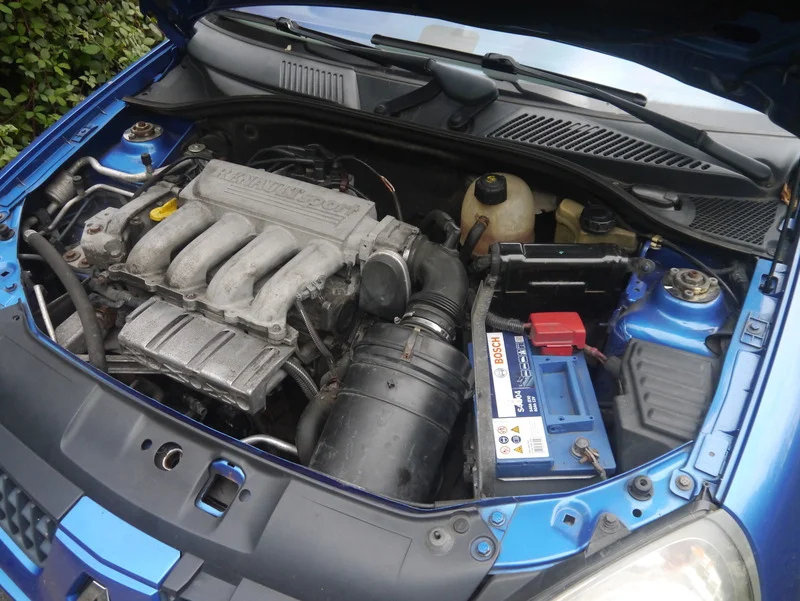

The all important engine bay - needs some detailing and mechanical love in here too.

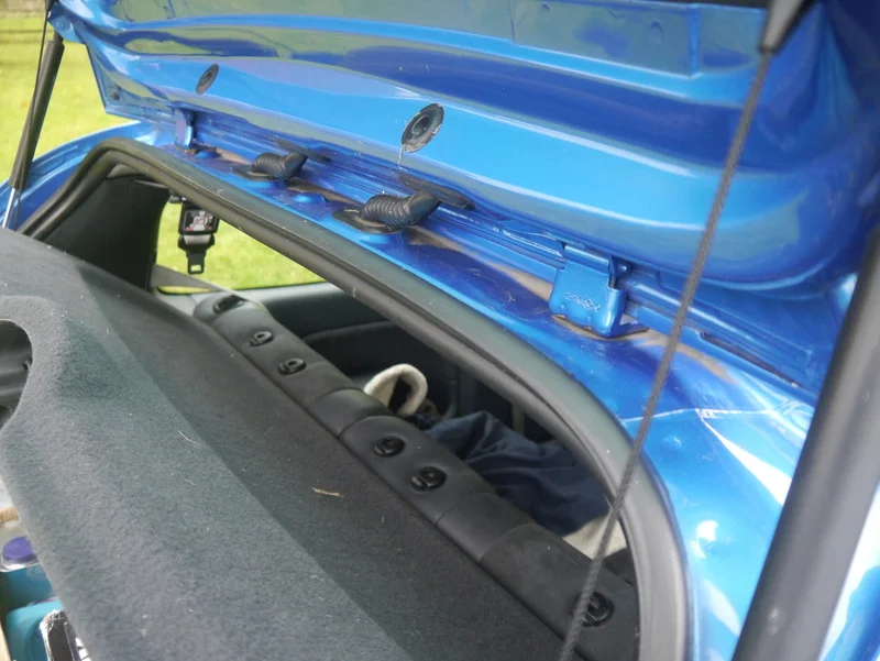

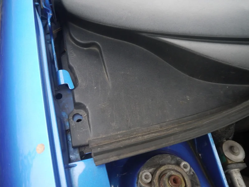

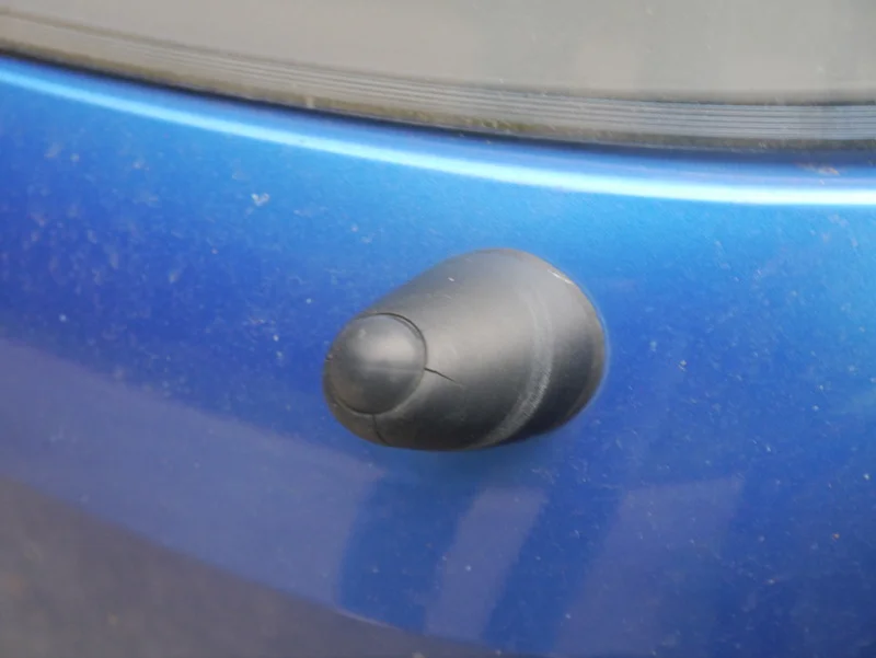

Various little trim clips missing - already ordered to be replaced

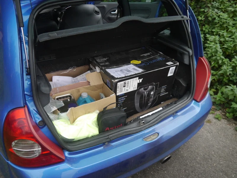

A boot full of parts and detailing gear

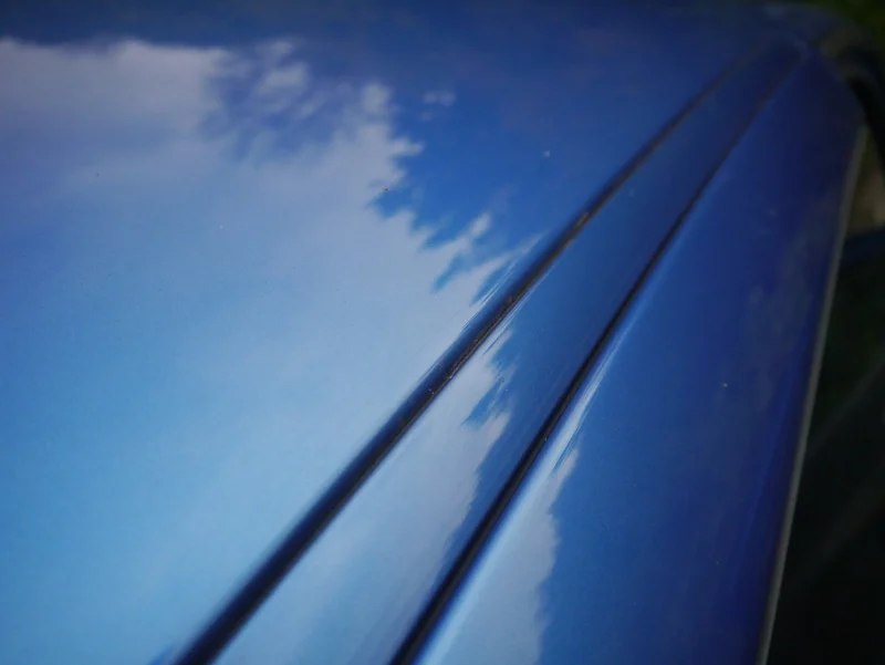

I then went a bit nuts, washed the car, removed the tar, removed the fall-out, clayed all the panels, hand polished and sealed the paint. I also used the 3M headlamp kit on the headlights which transforms the front of the car, they're not 100% but a damn sight better than they were!

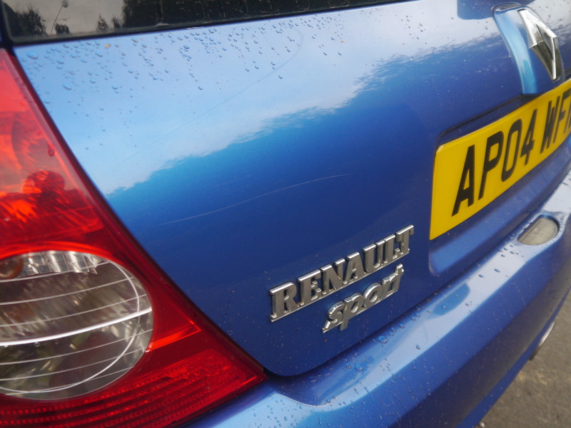

The only part of the paint I'd like to get dealt with currently is a scratch on the boot and a tiny rust bubble on the OSR arch [looks like a previous arch-rub repair gone wrong]

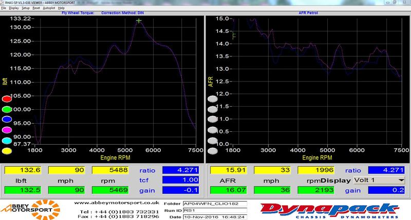

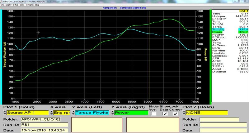

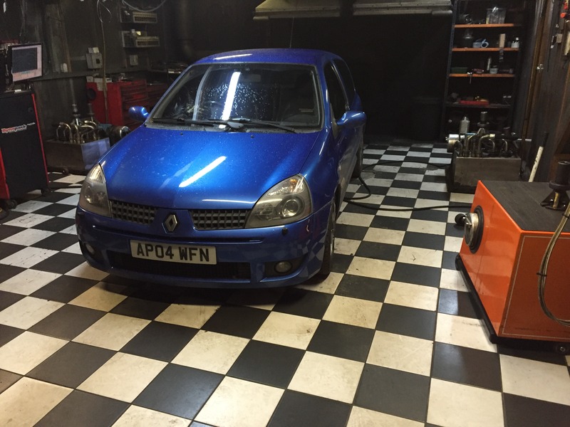

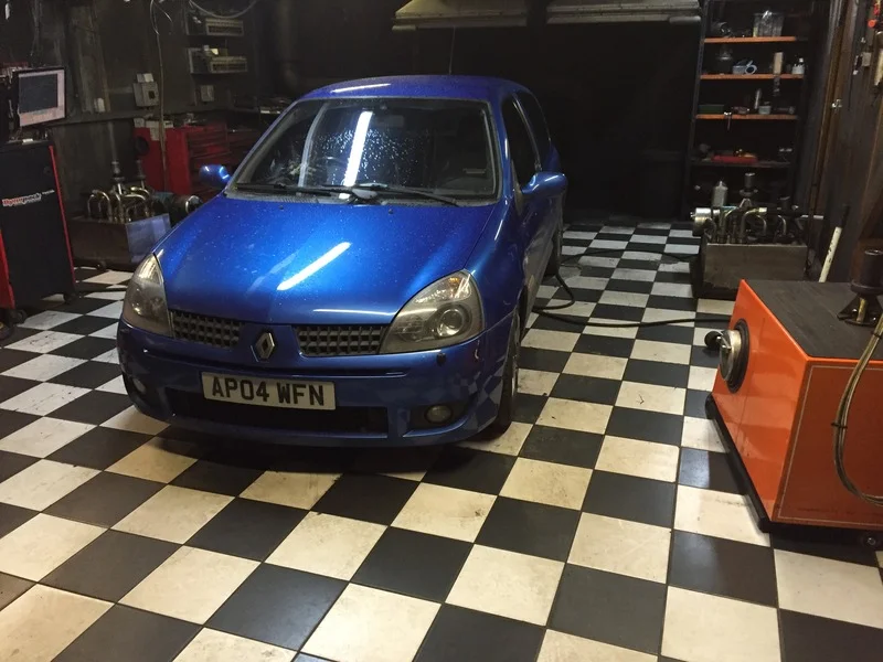

On Thursday I was called in by Abbey Motorsport to take a look at one of their client's twin-turbo Nissan 350z [which makes 650+ftlb of torque and 730bhp at the hubs...] which I finished with early, so I snuck the little clio onto their DynaPack to see just what shape she's in.

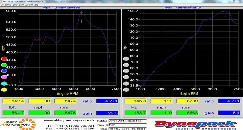

I realise on this forum that the DynaPack isn't a dyno that's used a lot, but it gives very repeatable accurate readings - it doesn't take into account ANY form of transmission loss as it bolts straight onto the hubs where the wheel would usually mount. Abbey MS have their dyno setup to only offer the true "at the hubs" figure, so it's a little unusual compared to traditional drum type dynos. In the main dyno screens I also run them auto-scaling, which makes for some funky looking torque/graphs but does help when calibrating to see small gains/changes in the calibration.
So... the graphs:
153.7 BHP at peak - the torque figure is the actual torque figure measured at the hub [divide by the drive ratio to achieve "flywheel torque"]
Here you can see that the AFR is far from steady and quite on the lean side throughout - not what I was hoping to see. I'd usually want to see a NA road car run no leaner than 13.2:1 through peak torque, as you can see it barely spends any time at 13.2:1 or richer...
So I scaled the power and torque together to get the stereotypical crossing at 5252rpm graph - for some reason I managed to load the 1st run which was the lowest power, but it gives you an idea of the torque curve which is pretty linear with a nice kick up at 5000rpm

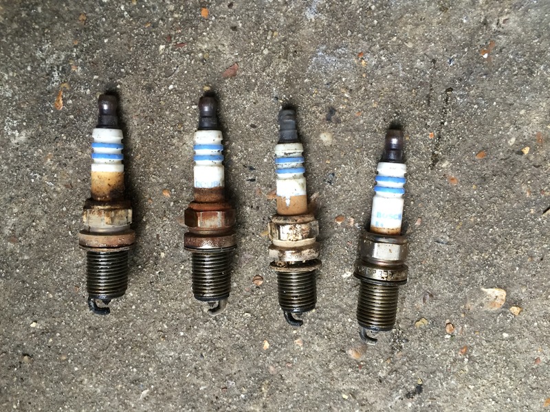

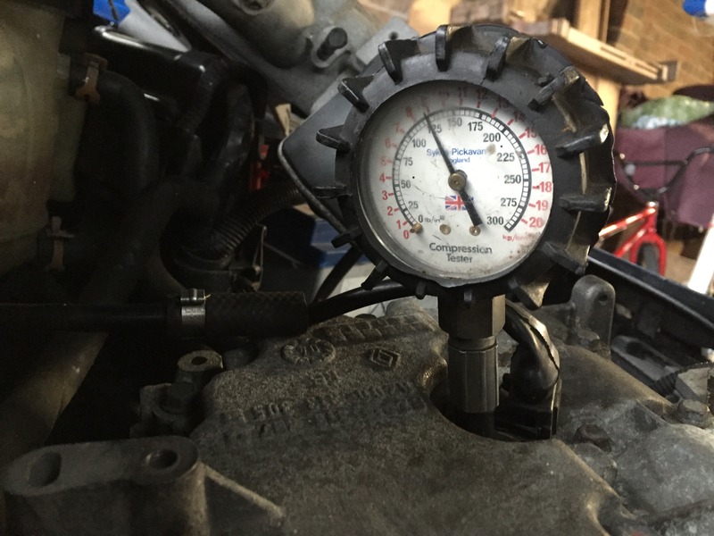

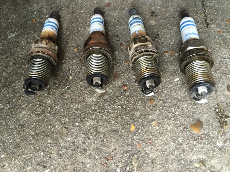

I got a bit of time earlier free and decided that I'd quickly pop in some fresh plugs and carry out a compression check before I embark on the belt & valve stem seal change...
It wasn't good news.
First bad sign was the state of the spark plugs, which look like they've all got wet at some point - the discolouration looks like blow by but all of the HT leads have a similar tide line around them on the outside of the rubber boot. Strange baring in mind where they sit under the inlet plenum.
Then I got onto the compression check...
Cyl 1 = 175PSi
Cyl 2 = 112PSi
Cyl 3 = 170PSi
Cyl 4 = 122PSi
Looks like the lean mixture seen on the dyno and the 100,000miles have taken their toll on the bottom end.

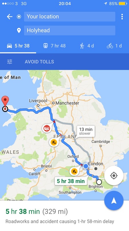

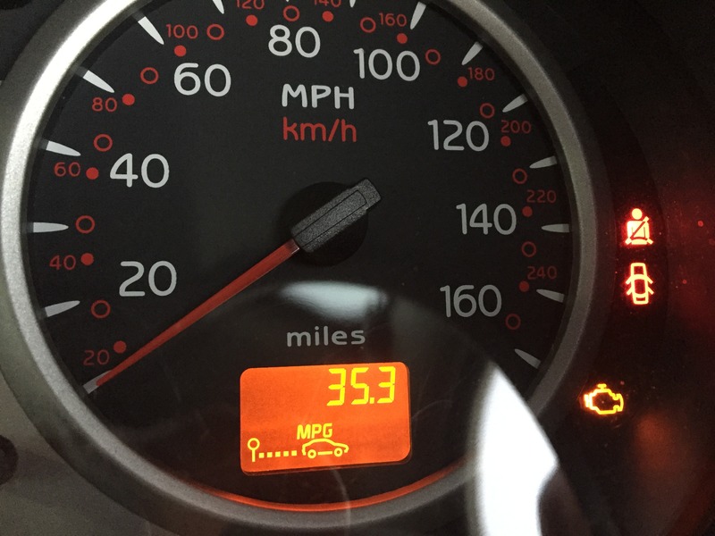

So I decided that I'd had enough with the UKs shitty weather and headed over to Ireland for a break at the in-laws place in Co. Sligo on the west coast. The roads out here have always amazed me and I enjoy a road trip, so I packed the Clio, filled the CD multi-changer, brimmed the tank and after a buy-one-get-one-free Pizza at the local Pizza house [one for the road too] I headed off from Forest Row at 6:45pm on Monday to Holyhead to catch the 2am ferry on Tuesday morning.
It rained. Every single mile of the journey. But, with the cruise control set at a steady 75 - 78 mph dependant on flow the journey flew by all the way up to just north of Birmingham where I decided to not listen to Google maps and actually head along the M54 and across North Wales along the A5. As I made this deviation I looked down at the trip computers averages of 67mph and 39mpg [see photo's below] and thought "that's good going for a hot hatch" - then I reached Wales.
The remainder of the journey included a 10 hour wait [8 hour delay] at Holyhead waiting for a storm to die down, a rocky crossing to Dublin and a final jaunt across Ireland to Co. Sligo - I arrived 23 hours after setting off. The car didn't miss a beat the whole way other than demanding a top-up of oil at Holyhead. The total journey door-to-door was 458miles, including numerous stop/starts through the night at Holyhead to heat the car up [it was 3 degrees C and windy :fearful:] the car averaged 50.7mph and 35.3mpg - not to bad at all!

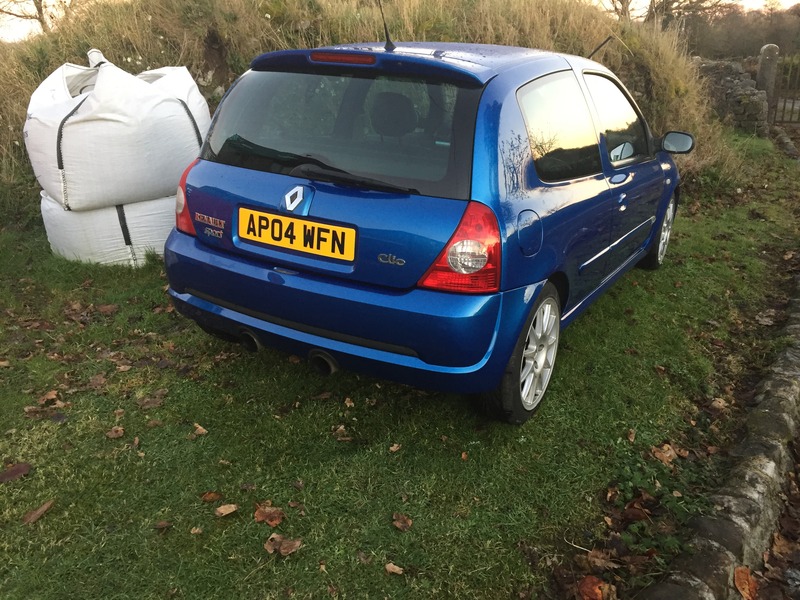

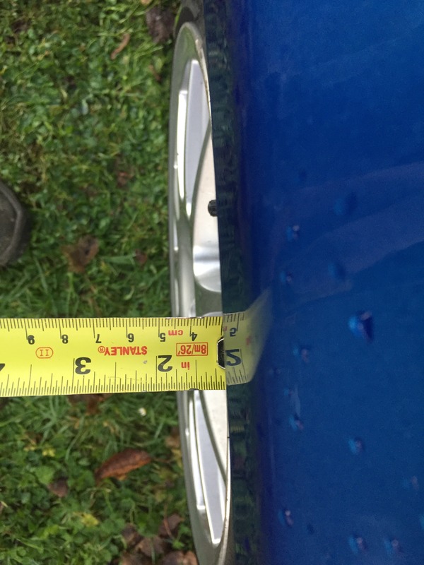

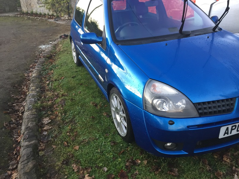

I'm over here until NYE now with the car, so I gave it a good wash yesterday to show off the new Turini's I picked up before leaving, they're shod in 195 45 R16 Toyo T1Rs that I'll kill over winter before getting the wheels refurbished in Anthracite and some 205 45 R16 Michelin PS3s fitted. I think I'm going to get some 10mm spacers for the front and some 5mm ones for the rear of the car to help fill the arches a bit more, but I like the look of the Turini's.

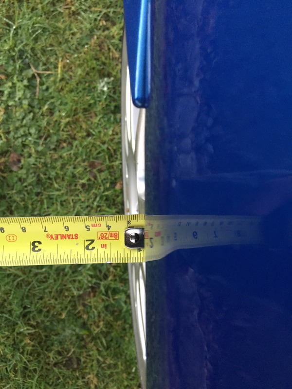

Front arch gap [measured from the top of the tyre's shoulder]
Rear arch gap [again, from the top of the tyre's shoulder]

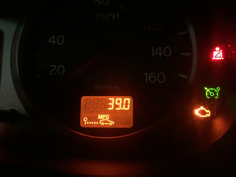

As above, I spent the whole of December on the West coast of Ireland in Co. Sligo. The weather was great throughout December and myself and the misses managed to get out and about a fair bit, we explored up and around the Ox mountains, down to Galway and along many of the deserted Irish country roads in-between.
The Clio didn't miss a beat - it proved to be the perfect car for over there, with decent chassis control and not too much power I couldn't imagine having more fun it something more expensive.
