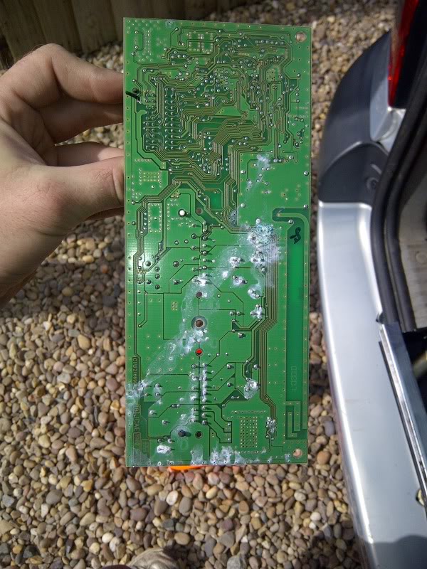

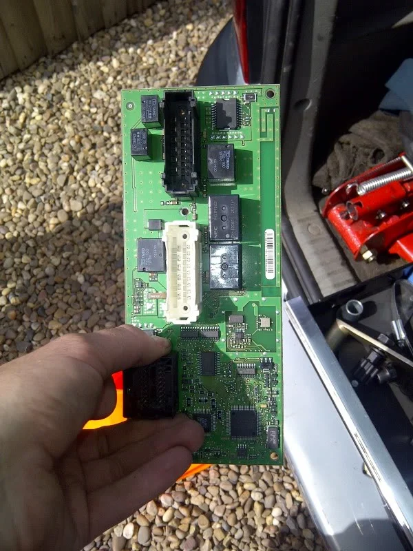

I bet your UCH, when pulled from the car, ends up looking like this:

I tested the UCH relay responsible for the unlocking on the above unit and found it to be buggered so it was replaced with a new part along with any obvious damage to the PCB tracks which was repaired and the board reflowed... this didn't work though and there was obviously other unseen component damage elsewhere.

If you look closley you can see where the printed tracks have burnt out... if there's a cleaning product that can repair that then let me know about it.
