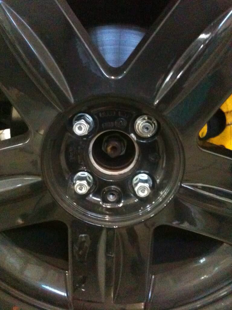

Probably not needed but I'd like to have a locking nut on my wheels if possible. Only issue is I have the PMS stud and nut kit.
I did look into it before with no success.
Now I've had a thought about using a Honda stud and locking nut on one of the fixings on each wheel, does anyone know if this will work?

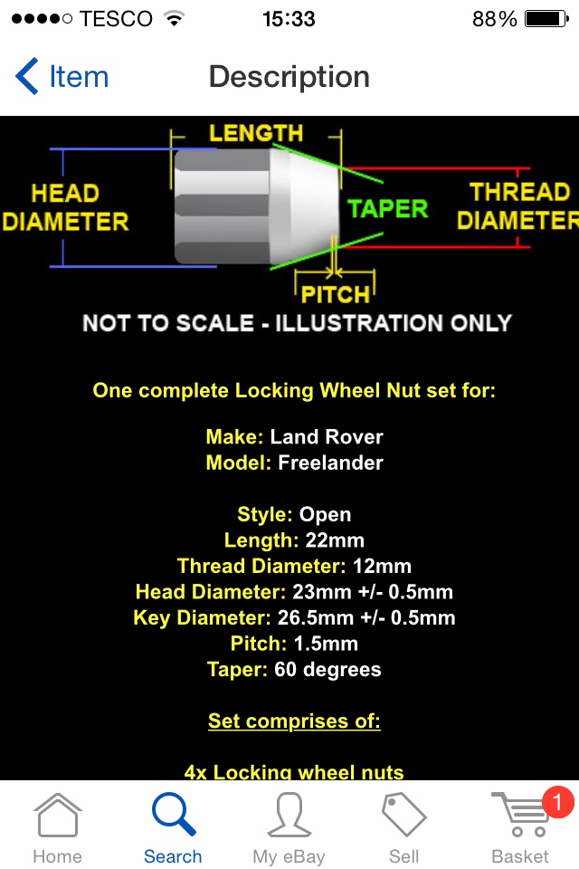

Check out the item number on eBay wouldn't something like this do for you. Wouldn't have to cut down either.

It should do as the socket is a deep socket and the nut is quite long. Have a better look around mate that was the first set I come across so I'm sure there will be others.

@Carbonraider - that's a good call , only issue I can see is if studs were to long , socket would bottom out if nut needed more twisting down stud .
Are they the right pitch angle and thread pattern? If so might be worth a try. Could always get a slightly bigger spacer if the stud thread was too long for the tool.
Or drill the top in the tool so it passes over the stud?

I've emailed them and asked for the strength grade. If they are decent enough then I'll give them a go.

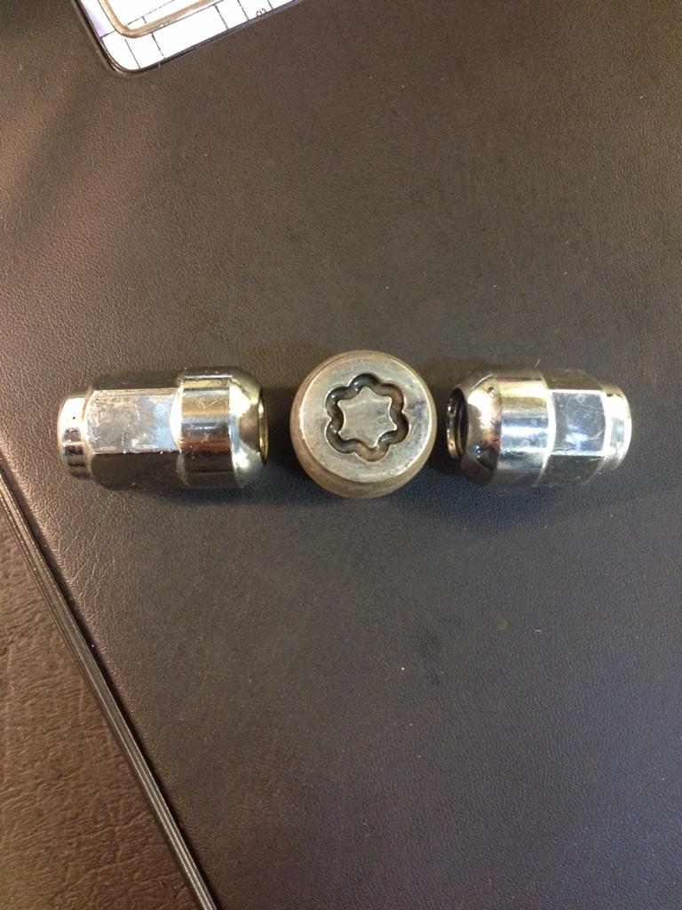

I didn't order the ones above. I've just got another type. But haven't tried them yet. Will need to trim down the stud as the socket for the locking nut has a closed end.

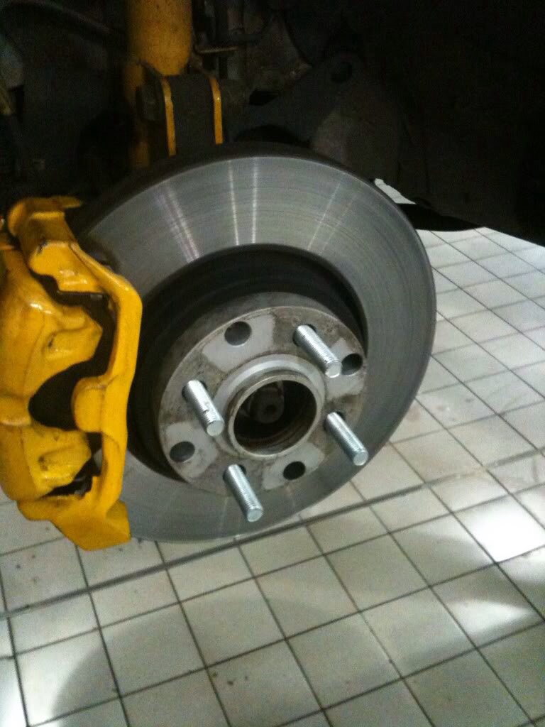

From memory the wheel stud length was approx 80mm
but dont forget i am running 20mm spacers also

That's right buddy. Realised I'm never going to find an open ended locking nut key. So just going to trip down one of my studs whilst it's on the car and do so until the socket fits over the nut.
