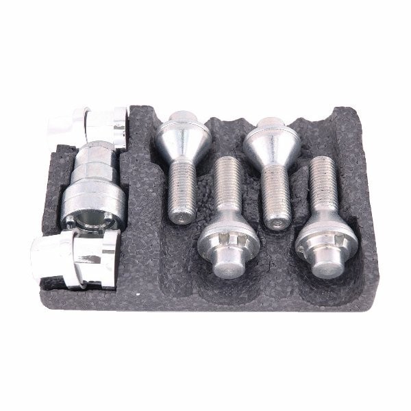

what do the lockers look like!?
my 172 came with the same problem!
mine were like this
i just twatted a socket onto them and undo! took about an hour to get them all off!!
