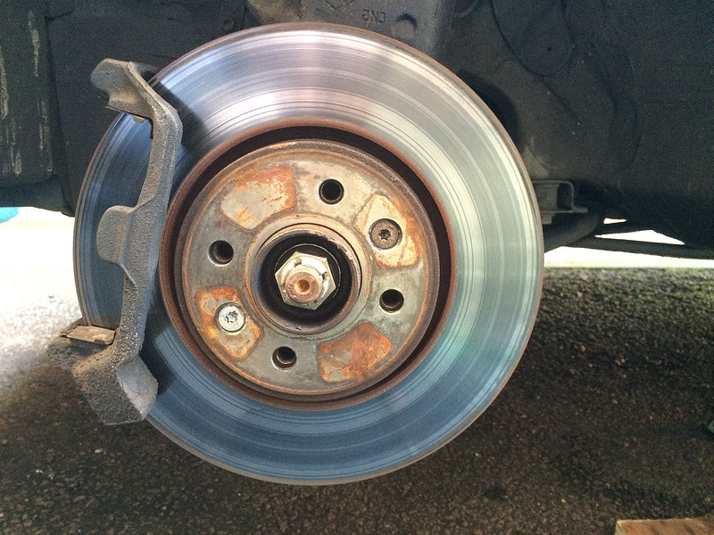

Bought some motul RBF 660 (only 500ml though stupidly!) bled the calipers but still a long pedal. Took the pads out and found this!
Untitled by rbaldry86, on Flickr
Disc looks ok though!
Going to order 2 more bottles of RBF 660 and some carbon lorraine RC5+ pads to fit next weekend
