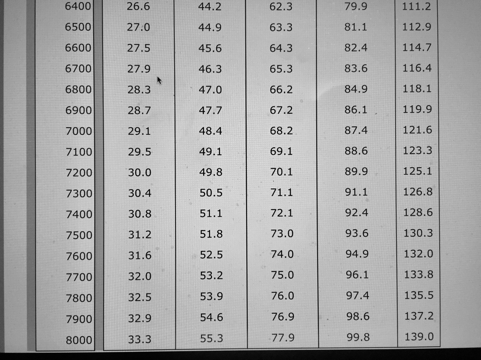

on my 2003 clio 172 i have 5.25 mfactory final drive.i need a longer 5th gear.any advices?
BashRacing
This is the 0.738 from the jc5-107 and 072 the longest available for the jc5 box,
bottom picture is what speed your pull in each gear with a 5.25 cwp
