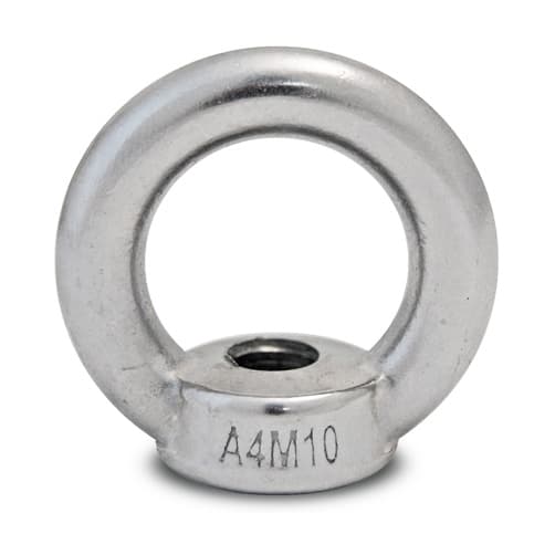

Ah yes similar to this:
Lifting eye nut's they're called here too.
Although I don't get how the one I've linked would work, it'd have to be screwed on the end of a bolt, because of the head.
The one in the pic you've linked I'm guessing the hoop bit swivels so you can get the bolt through.

Edit: Swivel lifting bolts/nuts seem to be the one you shown. They're bloody expensive the ones I can find!
