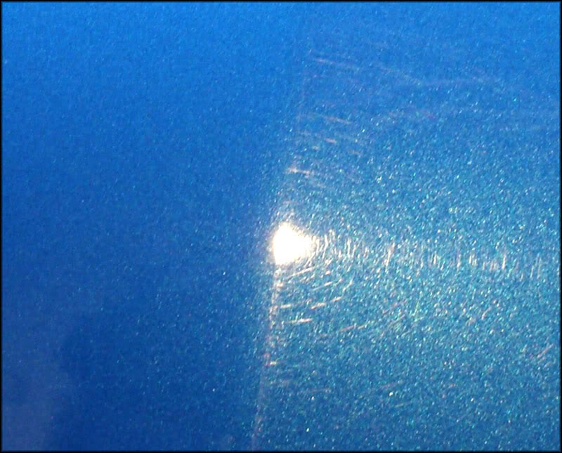

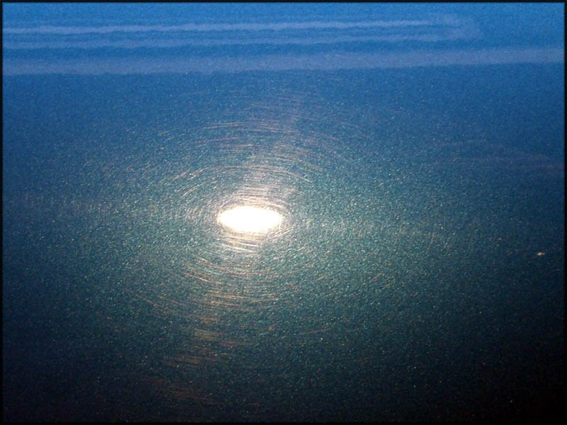

I saw the car the previous day in direct sunlight and it looked good. One pass through the swirlomatic gave use these lovely lines.......
I was surprised how deep the swirls were as on the bonnet it took 2 passes of the rotary @ 2000rpm:doublesho and ssr2.5 to clear!

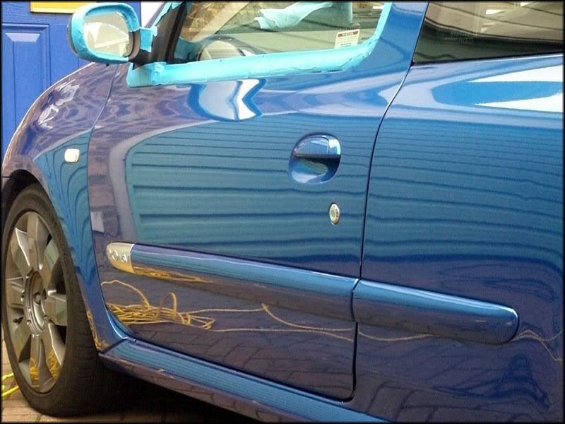

Half and half shot
Fortunatly i'm finding the RS clio paint to be quite thick at 150 microns plus. The above dropped it by an average of about about 6-7 microns.

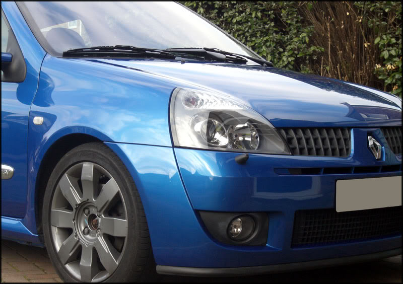

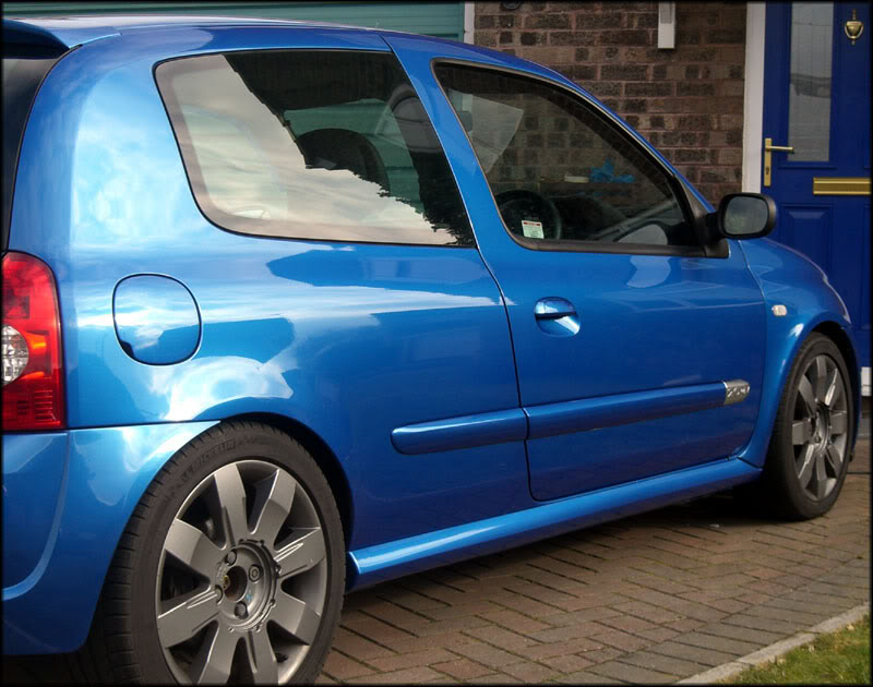

The afters
It's half a job, so much pissing about with the rotary and PC it needs finishing off. 10 times better than it was though. Assholes really ruined the paint there wasnt a mark on it before :(
