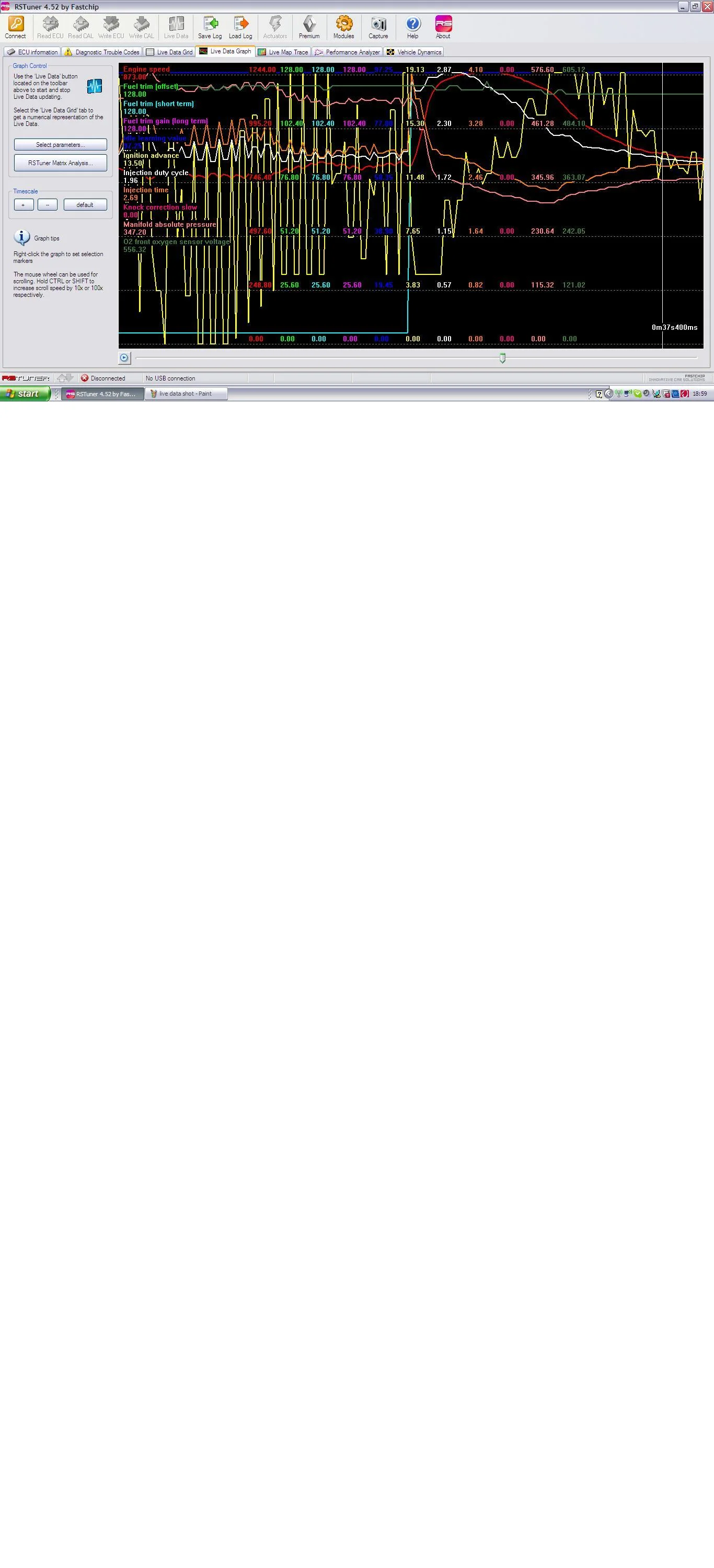

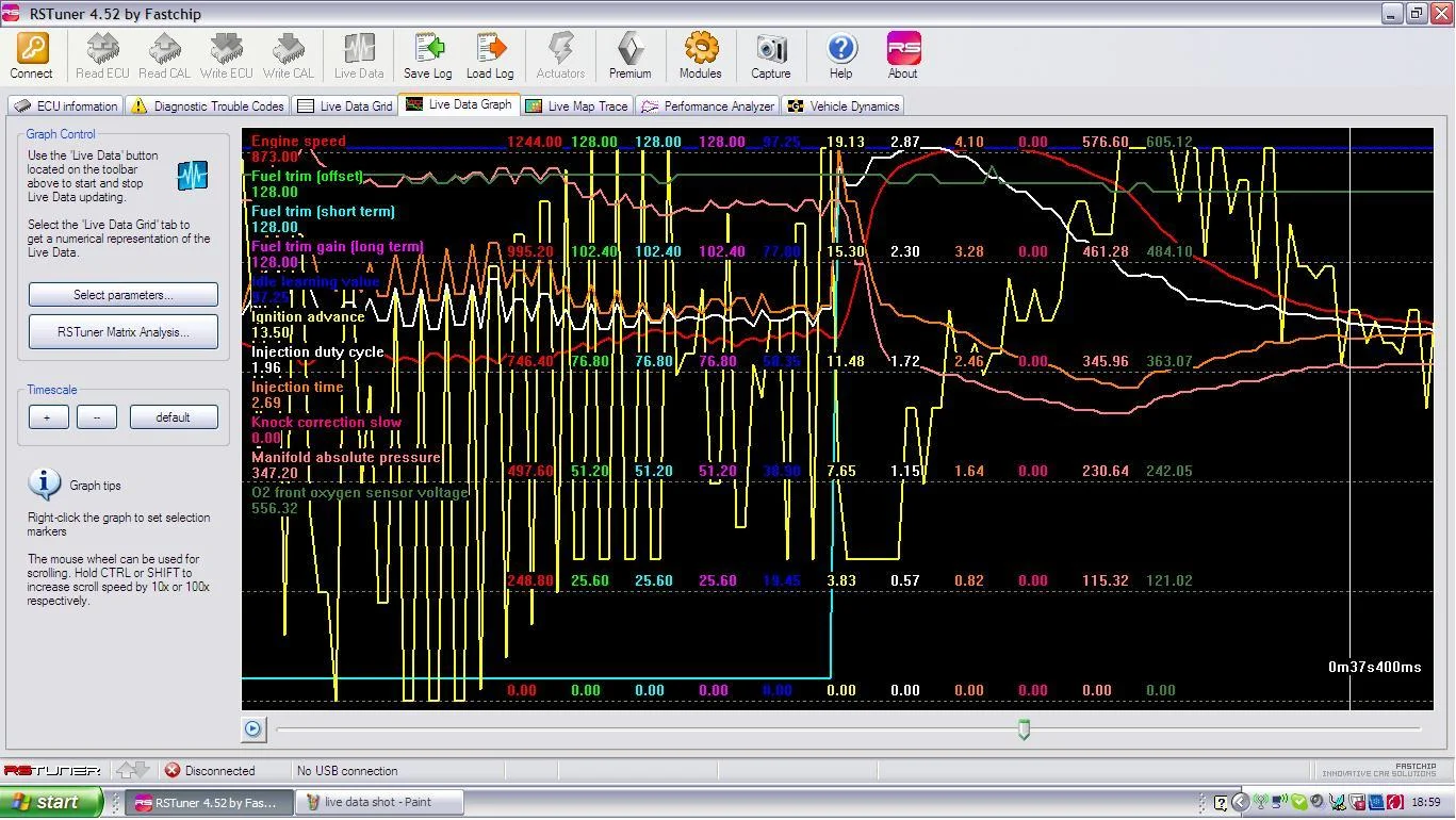

The good news is today I have my RS Tuner with me. I managed to replicate the issue in the pits by getting the failure on track and coasting in. Sure enough, the car runs rough and then all of a sudden corrects itself. Attached is the screenshot where the change happens. Its definitely a fuelling/ignition related issue, but no clue what is causing it. Wriggling cables made no difference!
The only ECU errors showing are for the canister (which has been removed) and the front O2 sensor which has been replaced. I think this error is a symptom of the issue, not the cause.

That data graph shows your O2 sensor isn't working, did you use a decent make? And did you plug it into the correct loom? Didn't plug the front into the rear loom etc?
Unplugging the map sensor will just force the car to revert back to open loop so would run ok as it won't use any sensors. Ignition advance was going crazy, I'd start with the O2 sensor and check the knock sensor.
