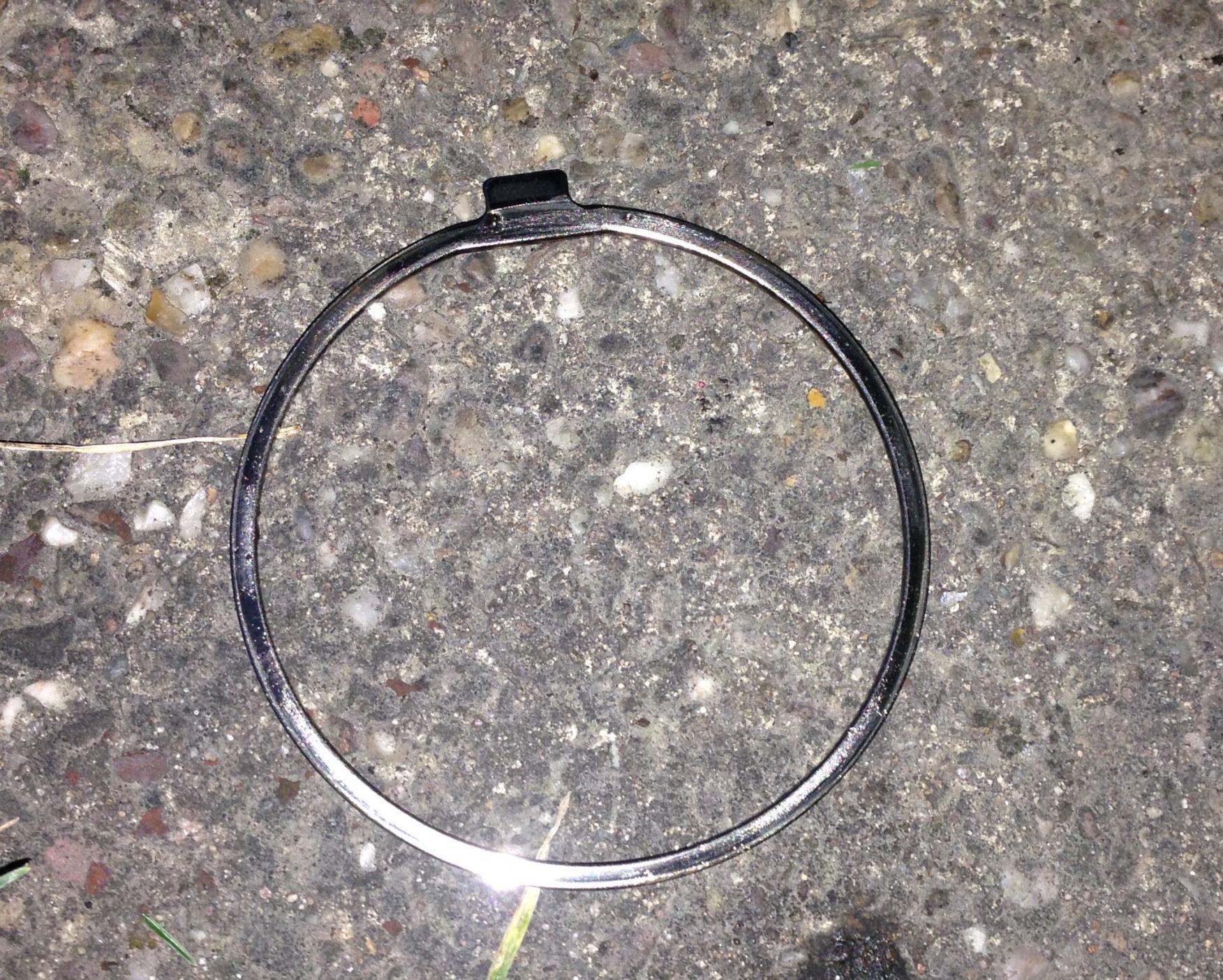

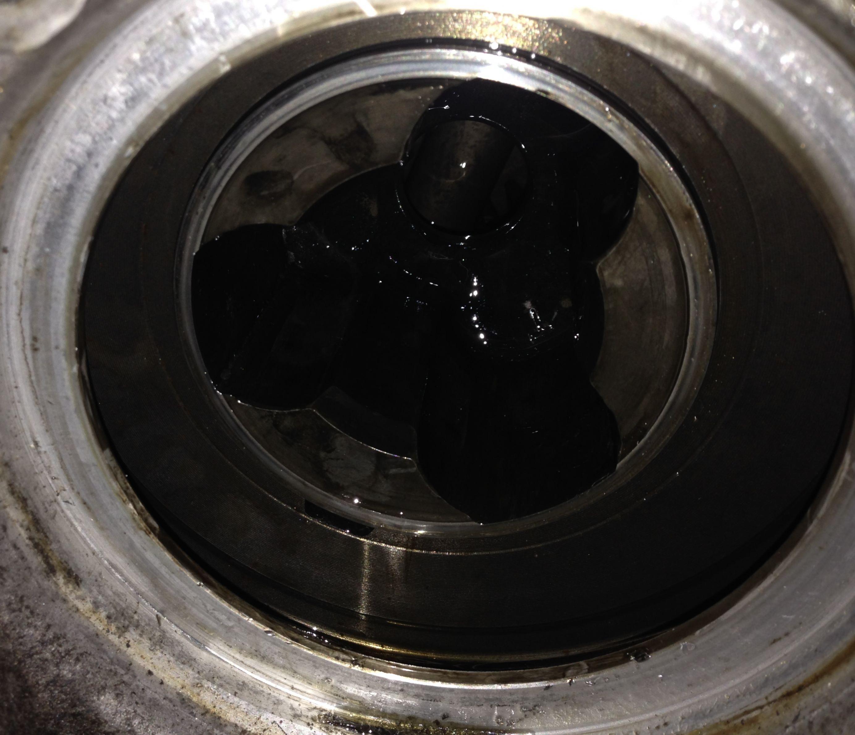

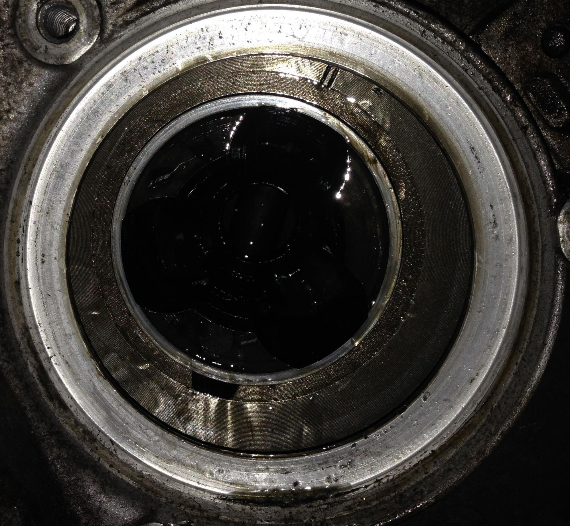

so i have just removed the driveshaft and this is what i found , i persume the 2nd picture is the washer , but could not find the circlip , any advice on what i should do next ?

Yep, circlip has gone pop and it will be hiding inside somewhere in at least two bits.
The bolt in diff could be used yes but it's a box rebuild job.
What you need to check on your existing box is for damage in two places:
1 - the slot that the circlip goes into. Make sure the edges are not fillet radiused on the edge.
2 - pull the knuckle out (the bit that the drive shaft goes in to which is normally retained by the circlip) and inspect the planetry gears... Make sure nothing is chewed up.
If both the above are okay then bang in a new circlip and spacer shim. If they aren't bin the box as it needs a diff.

Whats gonna be the best way to find the broken circlip? magnet ?

Magnet would be my first choice yes. It will have been pushed out so that limits the space which it can fall in to.
As for the eBay item I can't say for sure as I've never seen one but I guess it could as it's effectively what Renault did to the later ph2 boxes.
Enjoy drilling the diff in-situ though and be sure to catch any swarf.
