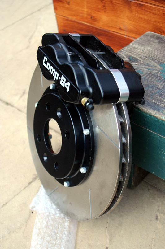

Re: Nitrac discs any good?
would you concidered a set of 4 pots? with new two piece disks - the lot?
normal rrp is £800
i can sort you out for £650
  C63 AMG, F430 & 172
u sure?
  F4R'd ITB'd '92 cup racer
so let me get this right, these performance parts are for a 1.2?!?!?!?
dont bother, stick with standard, job done :rolleyes:
