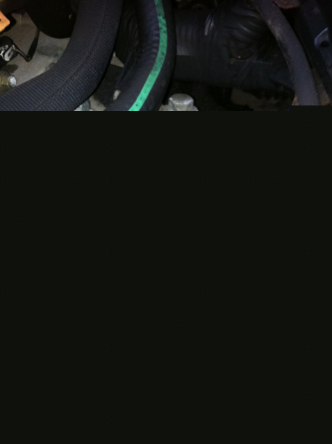

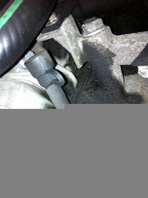

Lots of oil on top of gearbox.
Car  2004 182FF
Car has full service history with 91k miles. No gearbox oil change ever recorded.
Ordered some to arrive during the week but was bored so thought I'd do a dry run taking the airbox out etc. Just to kill some time.
Any idea where this lot has come from? It was mostly stained but looked wet in patches.

coming out of the breather, usual shite with renaults, nothing to worry about tbh
Doesn't that mean its potentially running on 91k old oil and under-filled cause it's pissed a load out of the top?
Guess I'm changing it anyway so doesn't matter I guess.
surely you check your oil at least once a week so would know if its under filled? :p
its nothin to worry about as said above, I bet every other RS clio will have the same damp patch in the same place
it could be just a spillage where the gearbox oil has been topped up, or changed previously?
