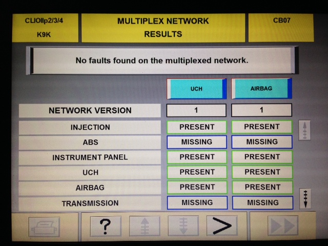

Lots of pedal farts from ABS fault. Video and photos enlosed. Clip screenshot
GrahamS
  335d
One of our DCI's has an ABS problems.
Symptoms
Pedal farts at lower speeds
Can feel judding through pedal at any speed
ABS light comes on at 60 mph (goes off when car is turned on and off again, comes back on as soon as you go over 60)
Diagnostics cannot connect to the ABS module on clip
The pedal farts seem to turn off when the abs light turns on but I have only driven the car a short distance so can't 100% say that's always the case.
Any help is very appreciated as always.

check the abs rings for cracks? what is in the multiplex page that page is ok the next page lets you scroll systems to check

Haven't checked for cracks no as I only had a quick drive and check over earlier.
Past the multiplex page is in the second video where it lets you select the individual modules. Tried to connet. Gets flashing lights on the dash then cant connect. Works fine on the other 2 DCIs
Didn't want to get my hands dirty until I knew the checks to do :)
