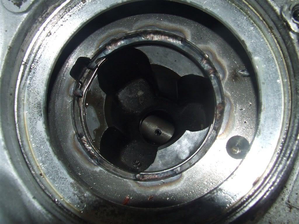

If you still have the 172 Cup with a JC5-129 gearbox it will either have likely popped the diff circlip ( see picture ) or stripped a driveshaft or hub spline (unlikely).
You could either weld it up like the pic, or have it converted to bolt up diff,

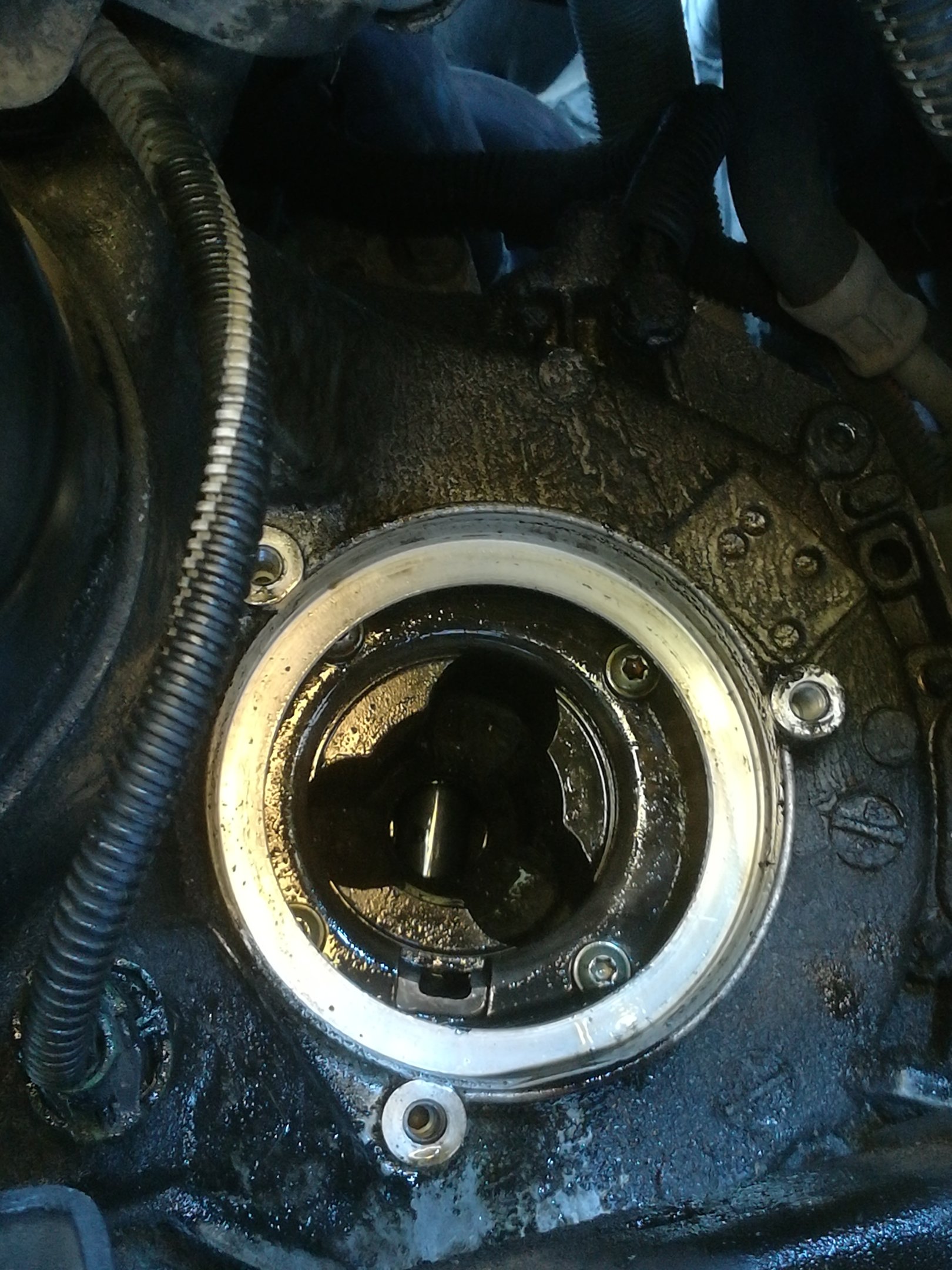

So finally stripped it down, to my surprise it has the bolt on cover, however there was no circlip present and the drive shaft was loose, is it just a case of undoing the cover put the new circlip and spacer on and bolt bag together?
No I’m afraid not mate. Sounds like your diff is fucked in this instance. I take it the driveshaft is still in good condition?
  clio 172 cup
Yep drive shaft is fine,
So should the drive shaft just pull out with no resistance?
So how will I know if it's the diff without removing the gearbox, don't wanna buy a new box before I know I need it.
The outer part with the t30 torx screws can also be spun independently from the middle part.
You are supposed to be able to spin the inner and outer sections independently. That’s how an open diff allows you to corner with the inner and outer wheels at different speeds.
It’s time to just start taking the box out in my opinion.
