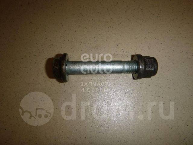

You seem to have misunderstood what I said which was the subframe / wishbone bolts (no 4 ) should face the front, like so
https://partsouq.com/en/catalog/gen...VEAAAAALvrwdw$&vid=1247&cid=75627&uid=3249&q=
The shock absorber bolts ( no 3 ) should face the rear, so you have now placed them the wrong way round
https://partsouq.com/en/catalog/gen...2MAAAAABFyq0A$&vid=1247&cid=75628&uid=3262&q=

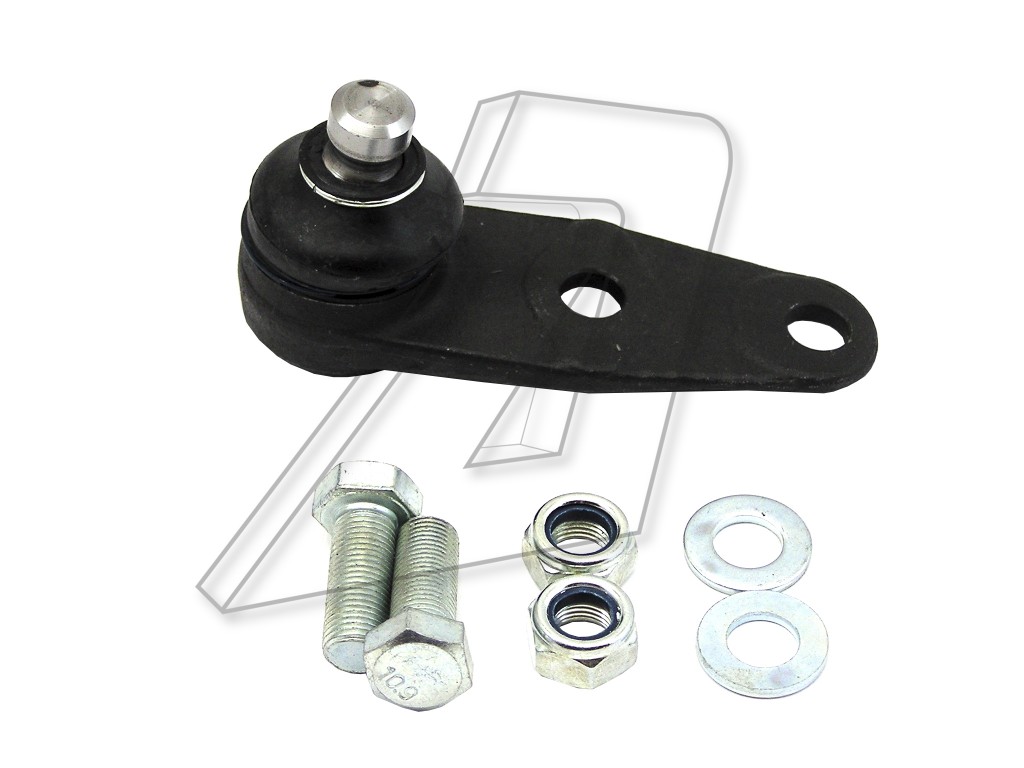

It sounds as if the outer RH ball joint bolt/nut has stripped, ( no 2 ) take one off your old wishbones that you replaced.
If you threw them away ( You never know when you might need them, so don`t ) it is a 12mm bolt on the Sports. (10mm on non Sports)'

The offending bolt is holding the ball joint assembly to the wishbone, looks like a bog standard bolt:
