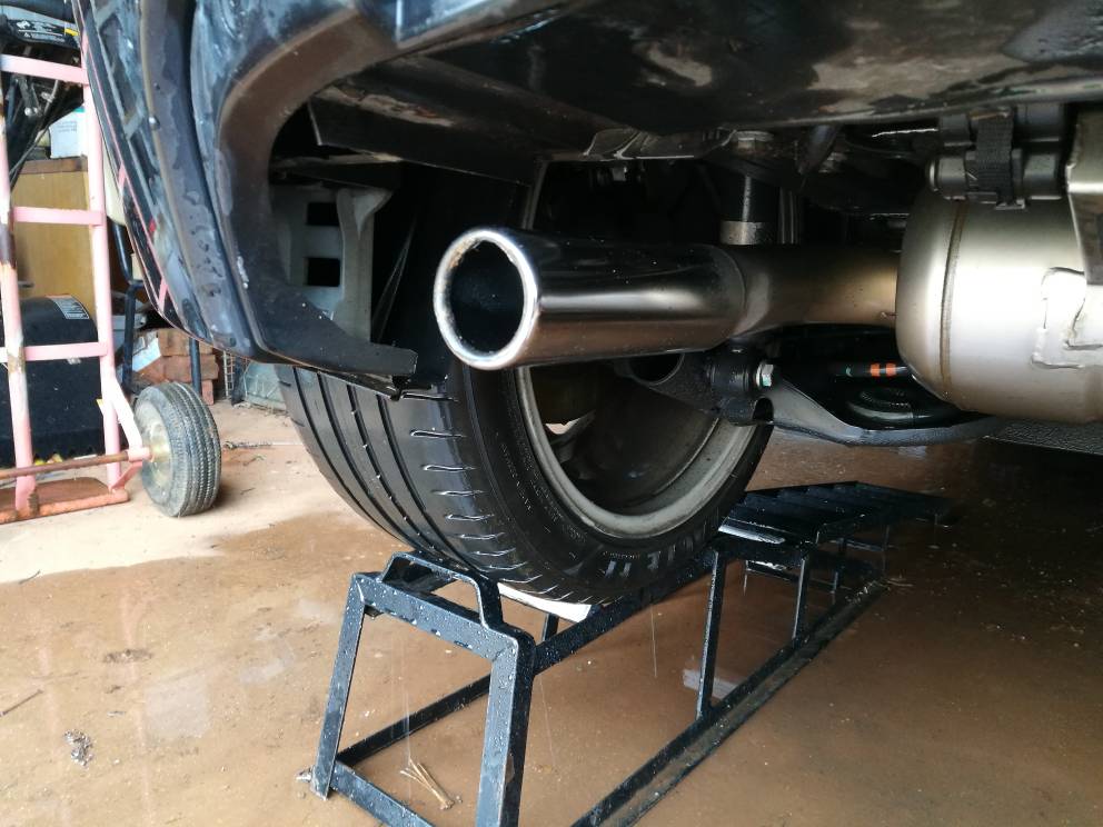

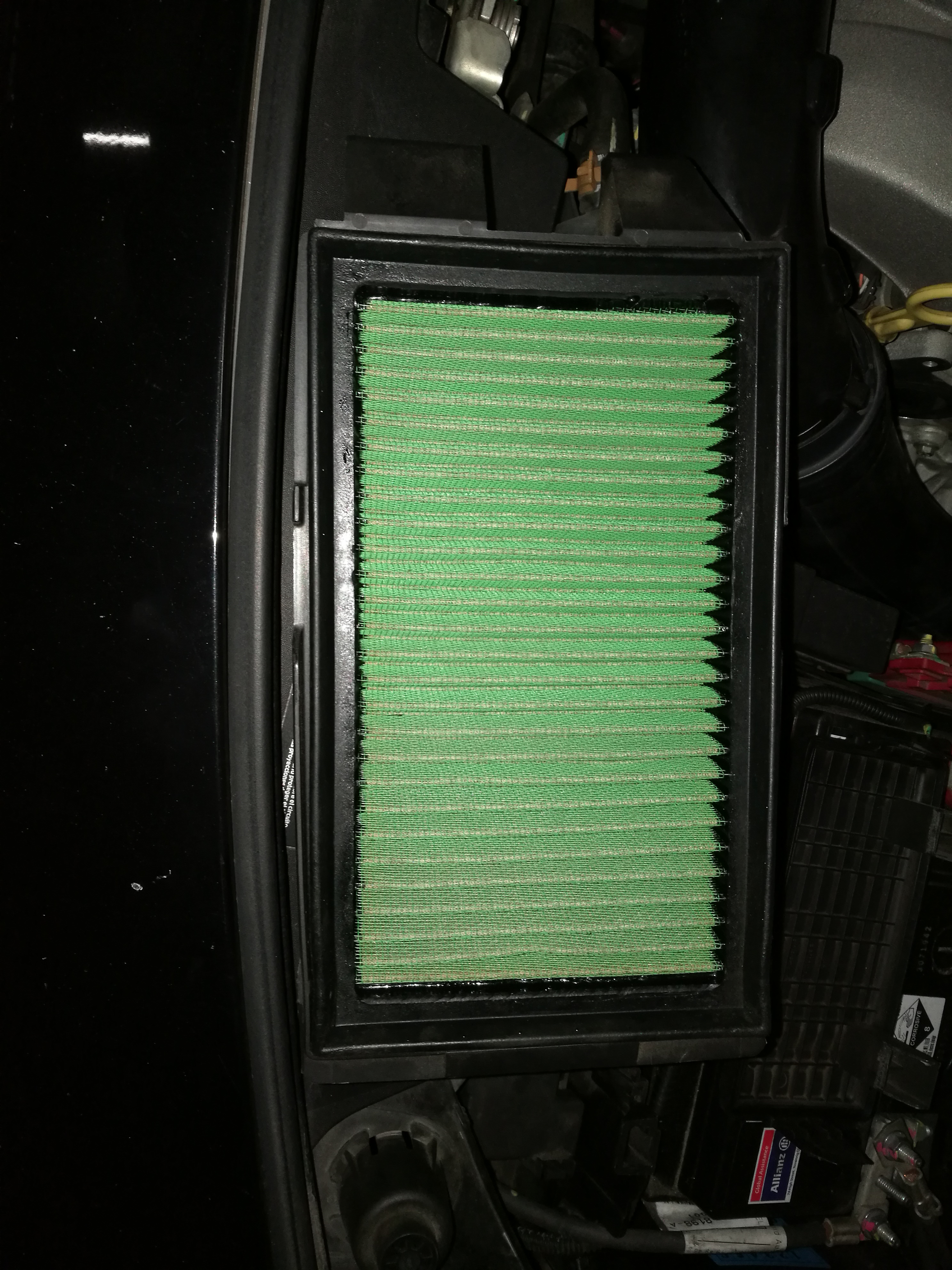

When i purchased it, the car was mostly stock besides an Akrapovic exhaust and green cotton panel filter.

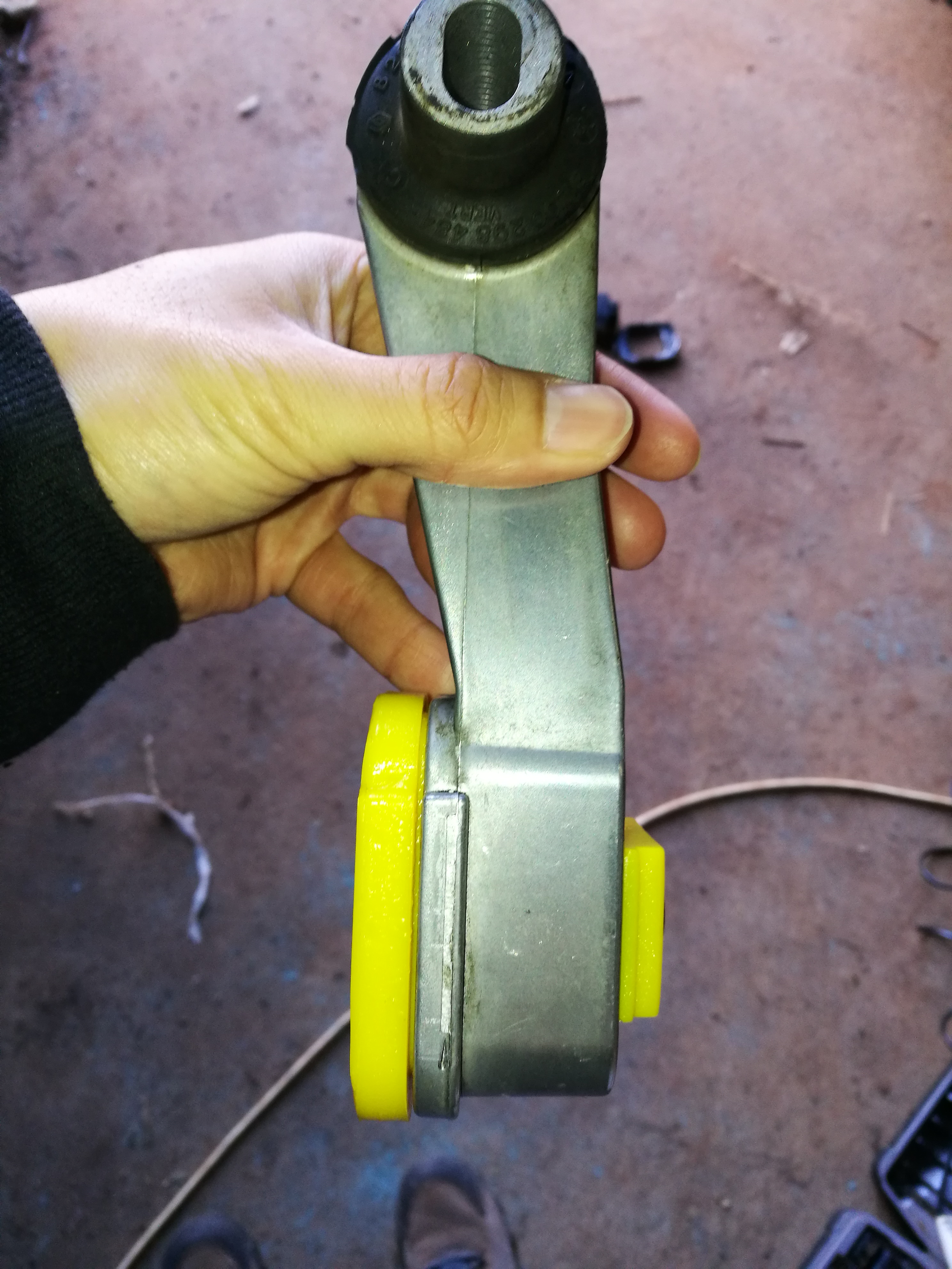

I also did the usual power flex upper torque arm bush as the mount was stuffed and fell out

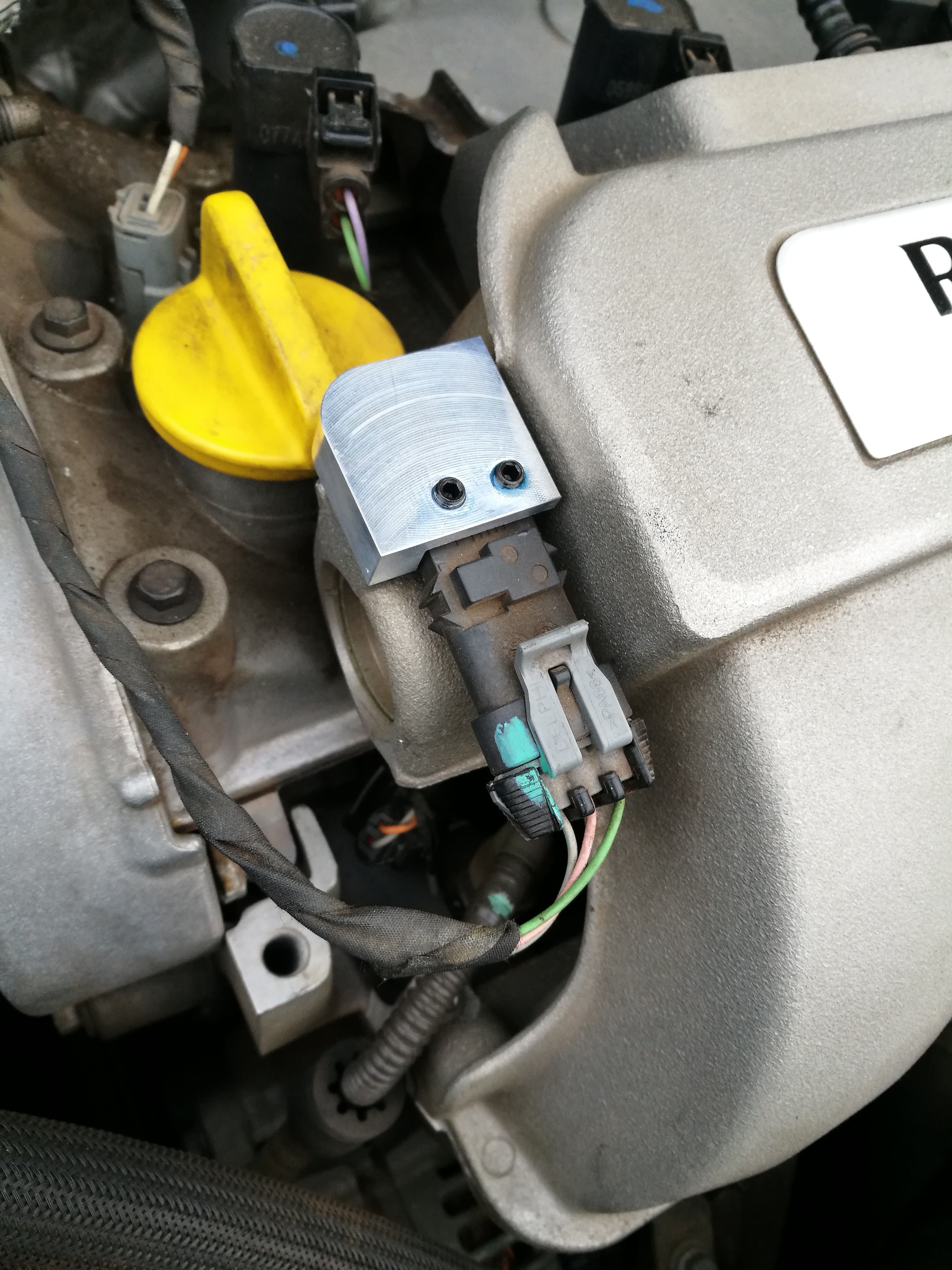

I got the MAP sensor bracket also

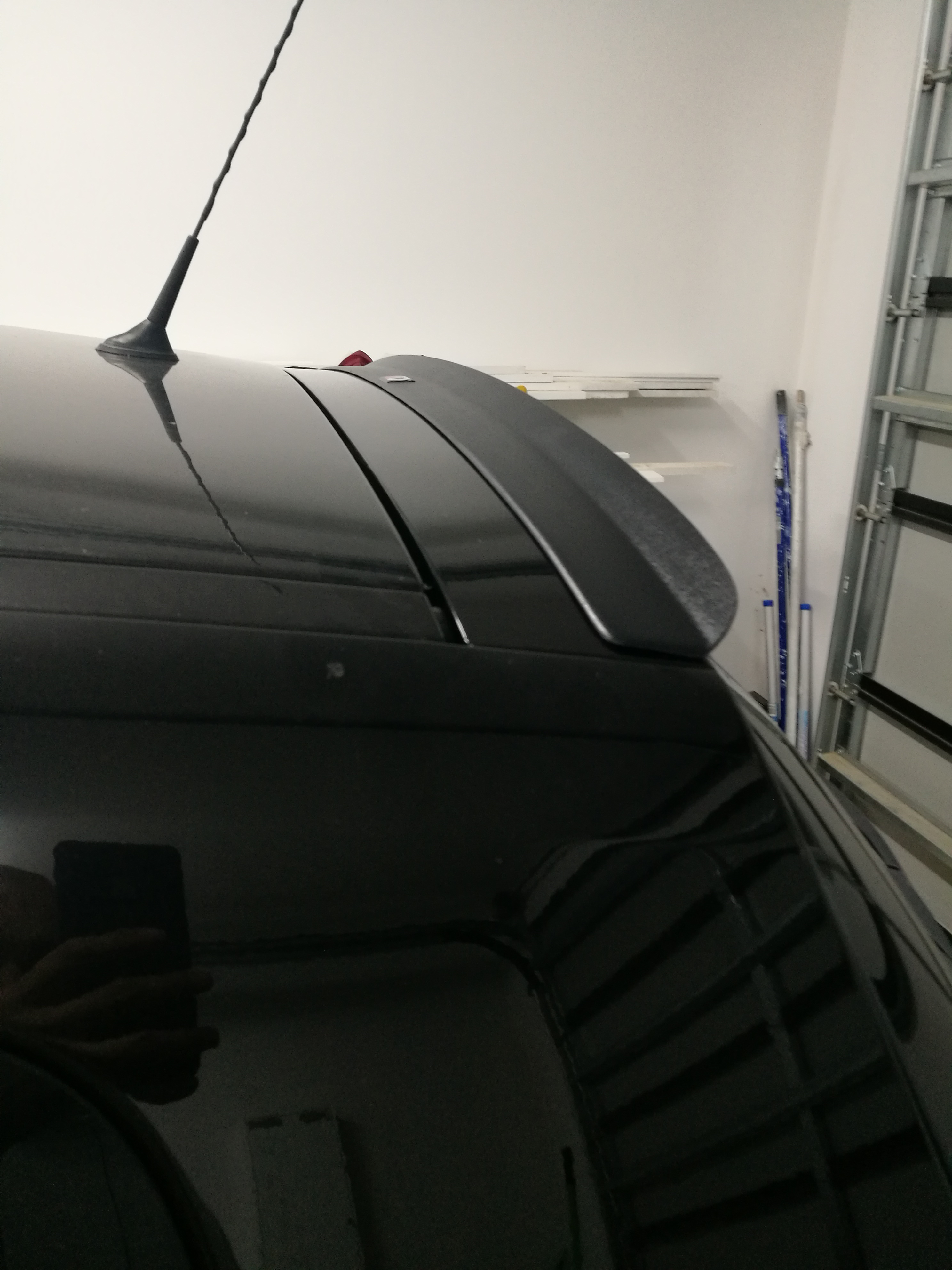

I also wanted to keep the car looking fairly OEM but got a Maxton rear boot lip thingy

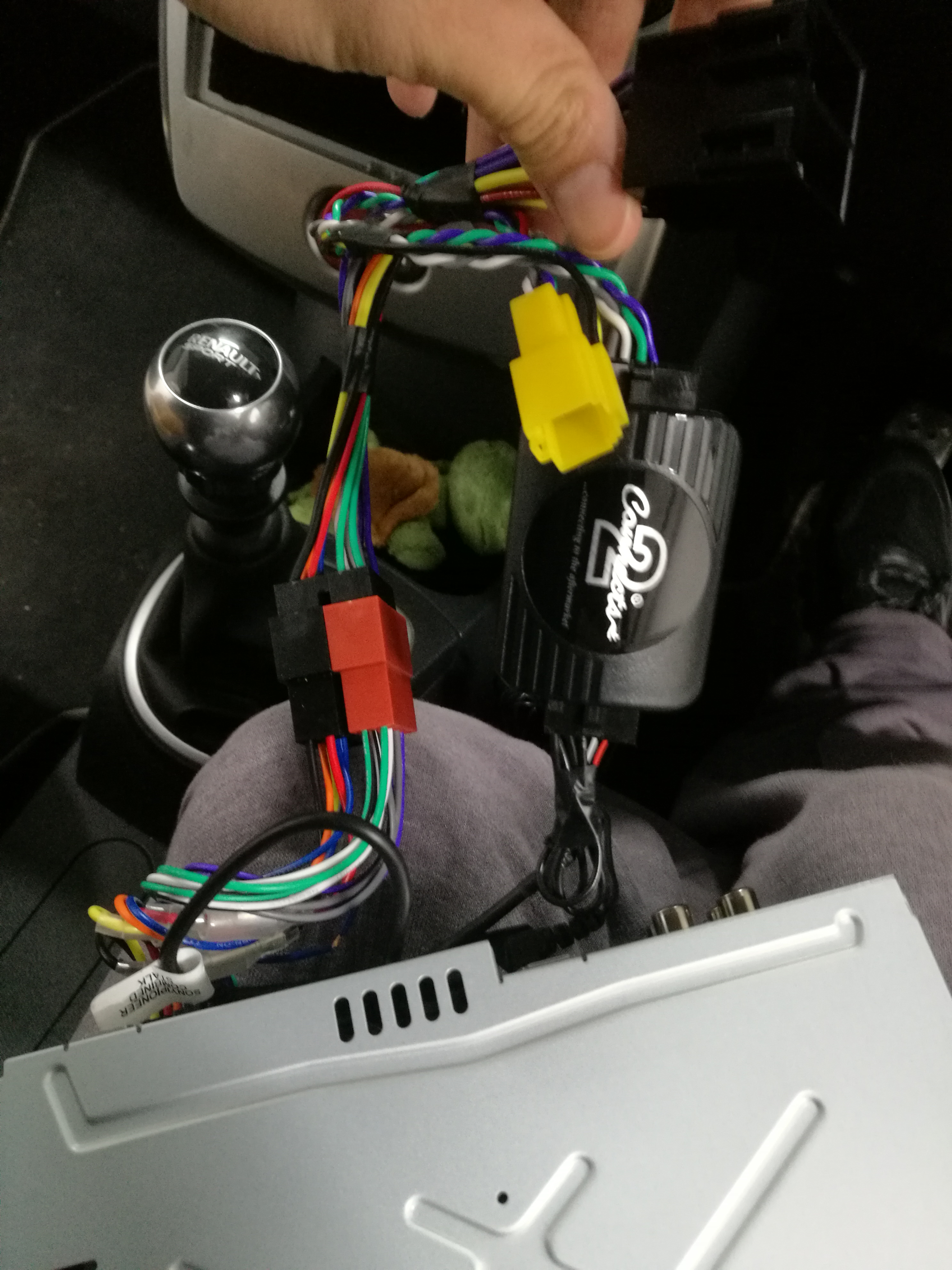

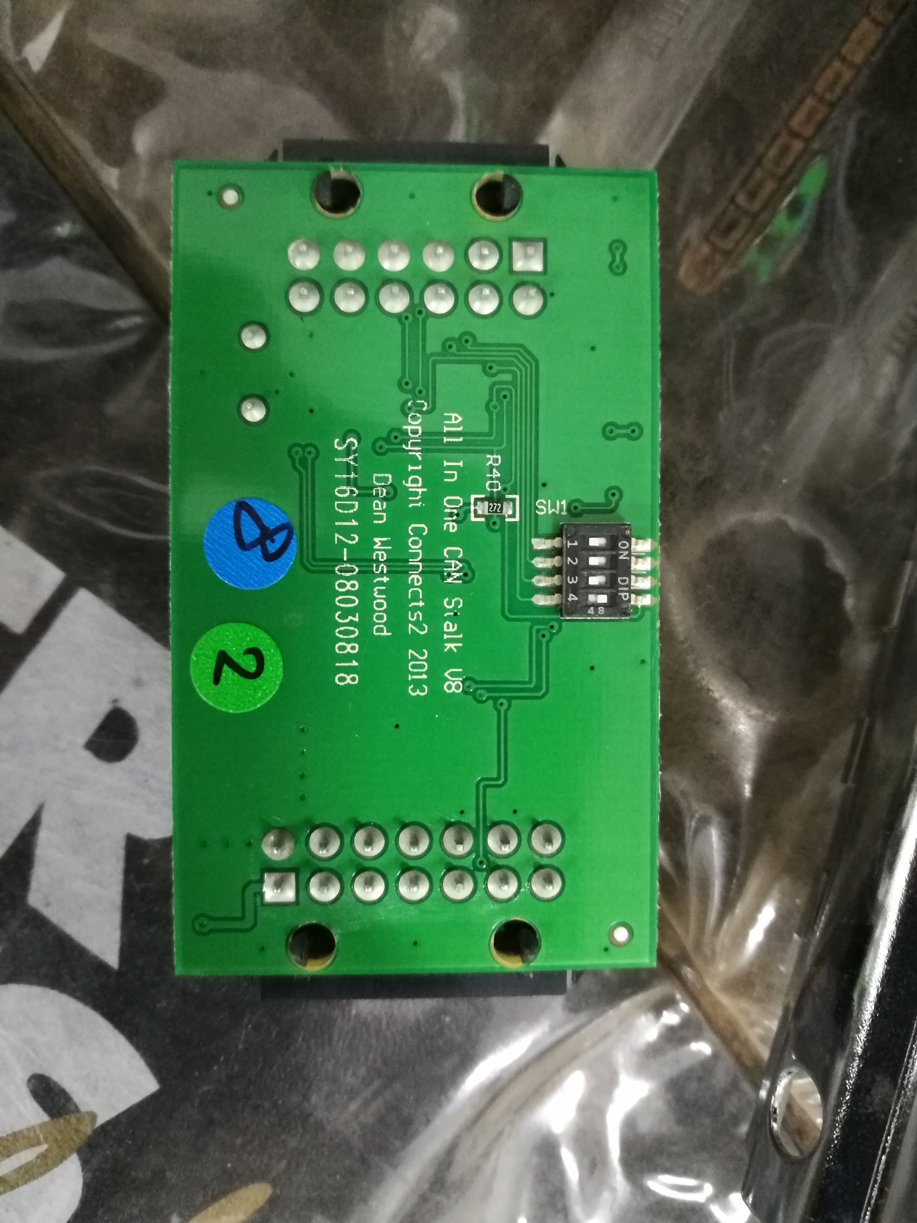

I also updated the stereo to a Sony headunit with the Connect 2 harness, man that was a pain in the arse to figure out why the steering wheel controls would not work properly. You have to open the connect 2 box and change the last DIM switch to enable Sony and Kenwood stereos to work with the harness

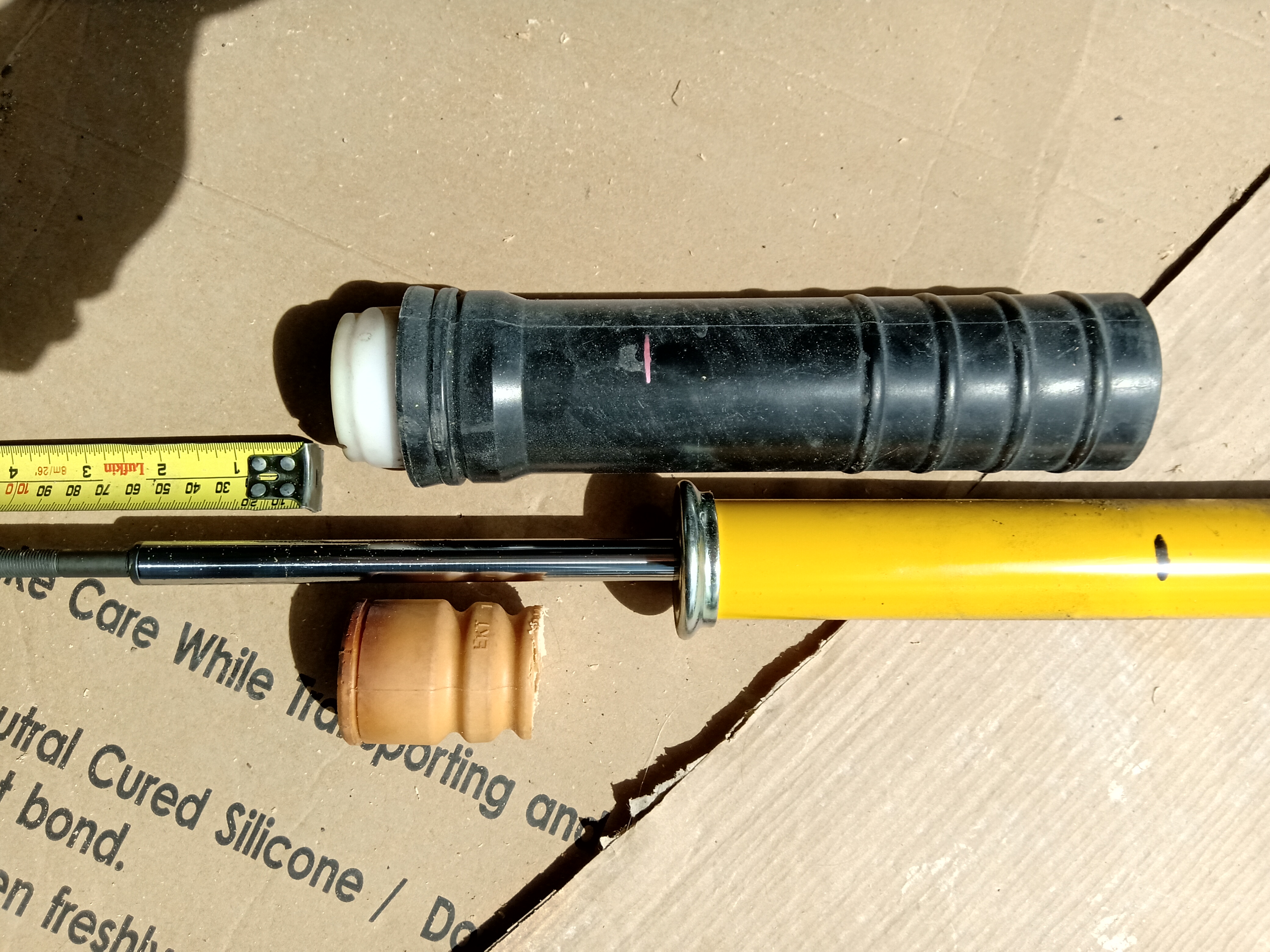

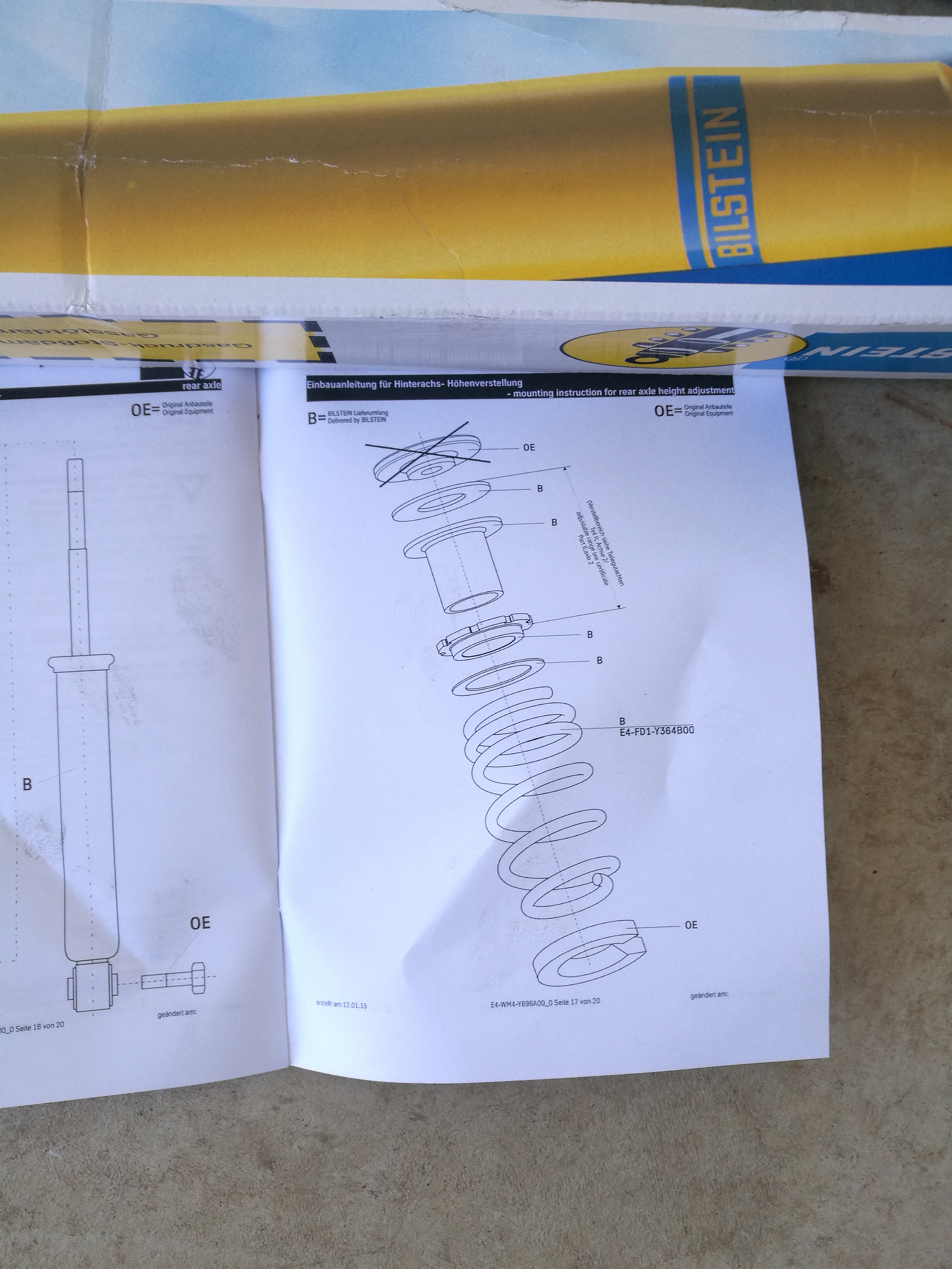

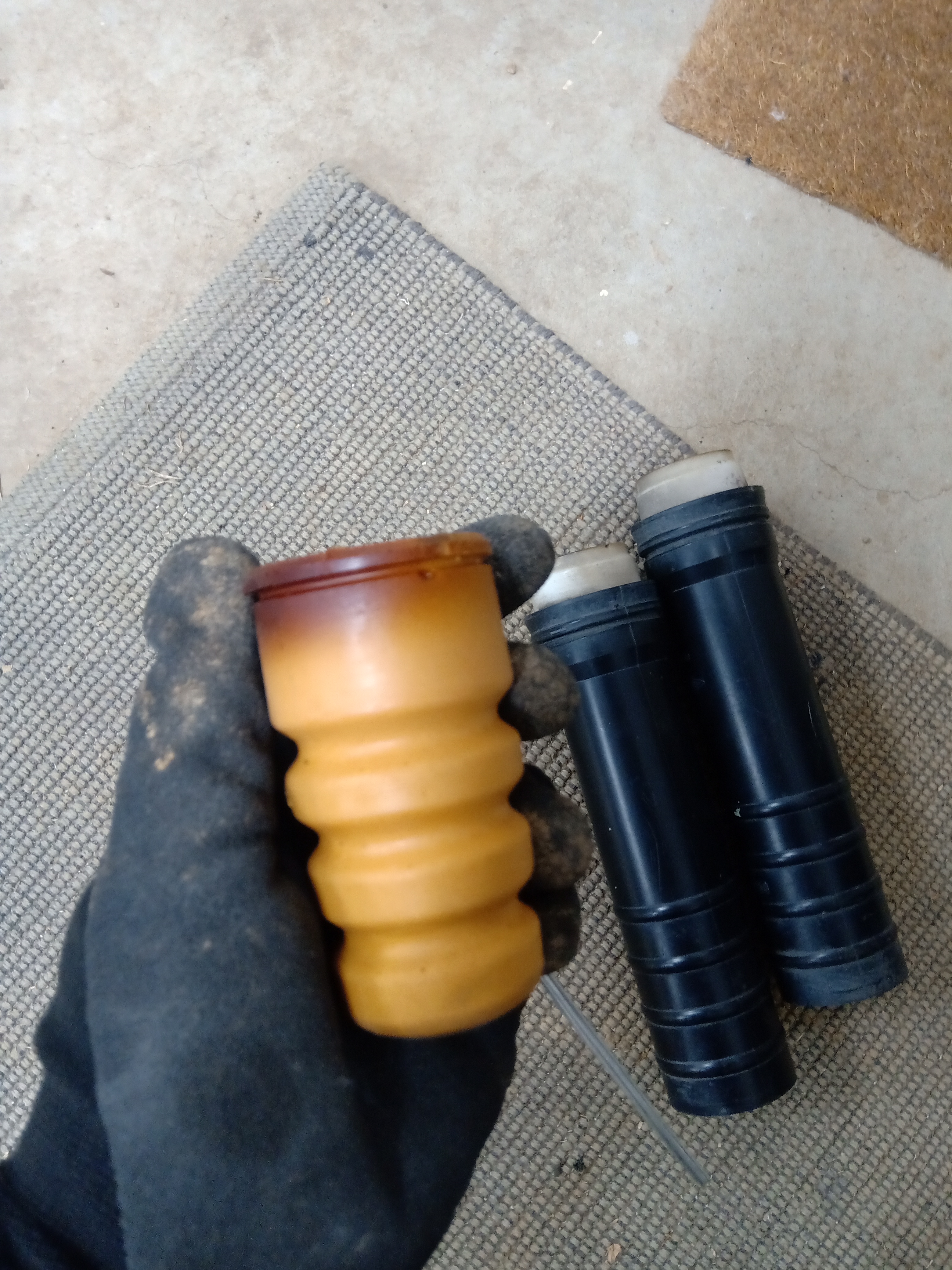

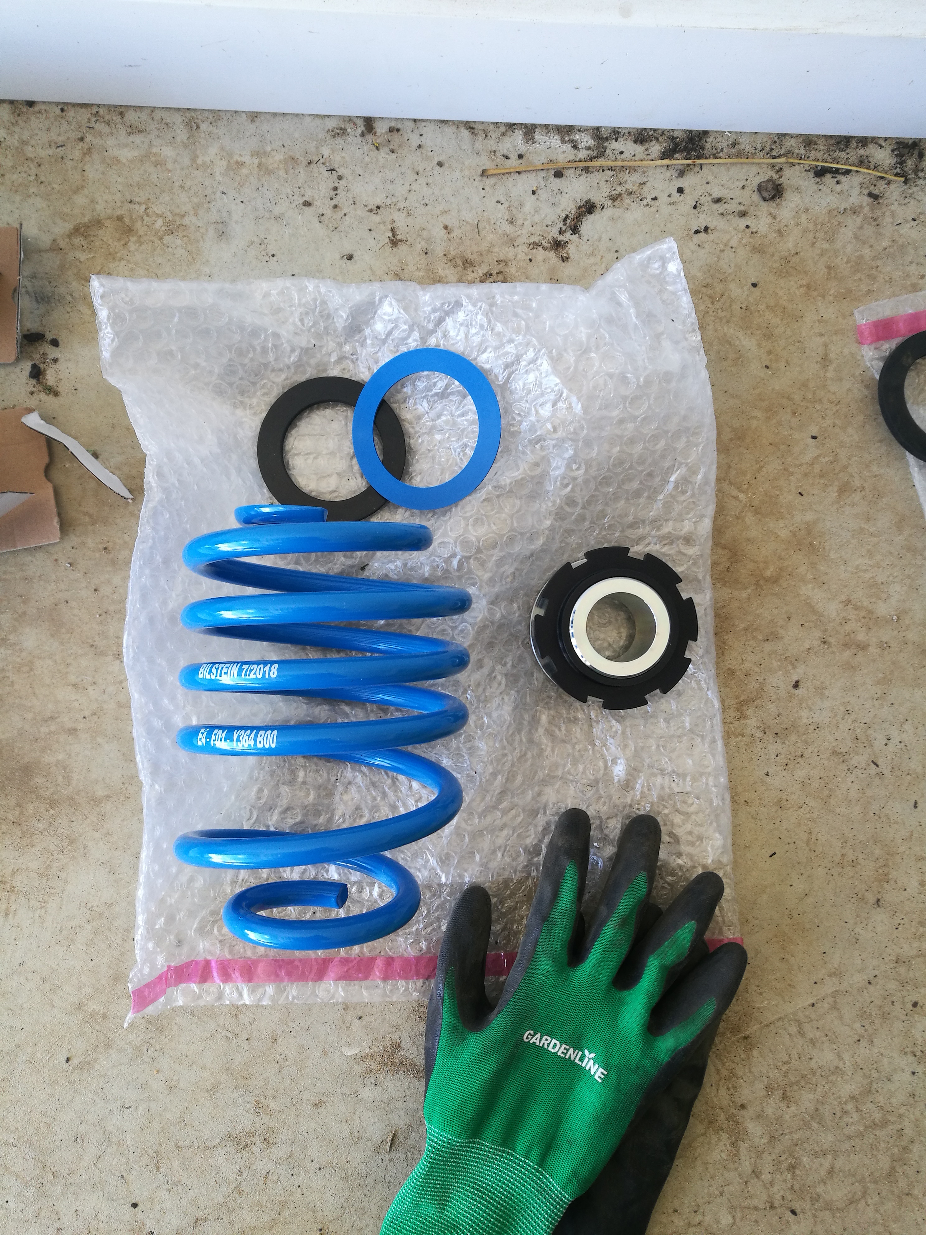

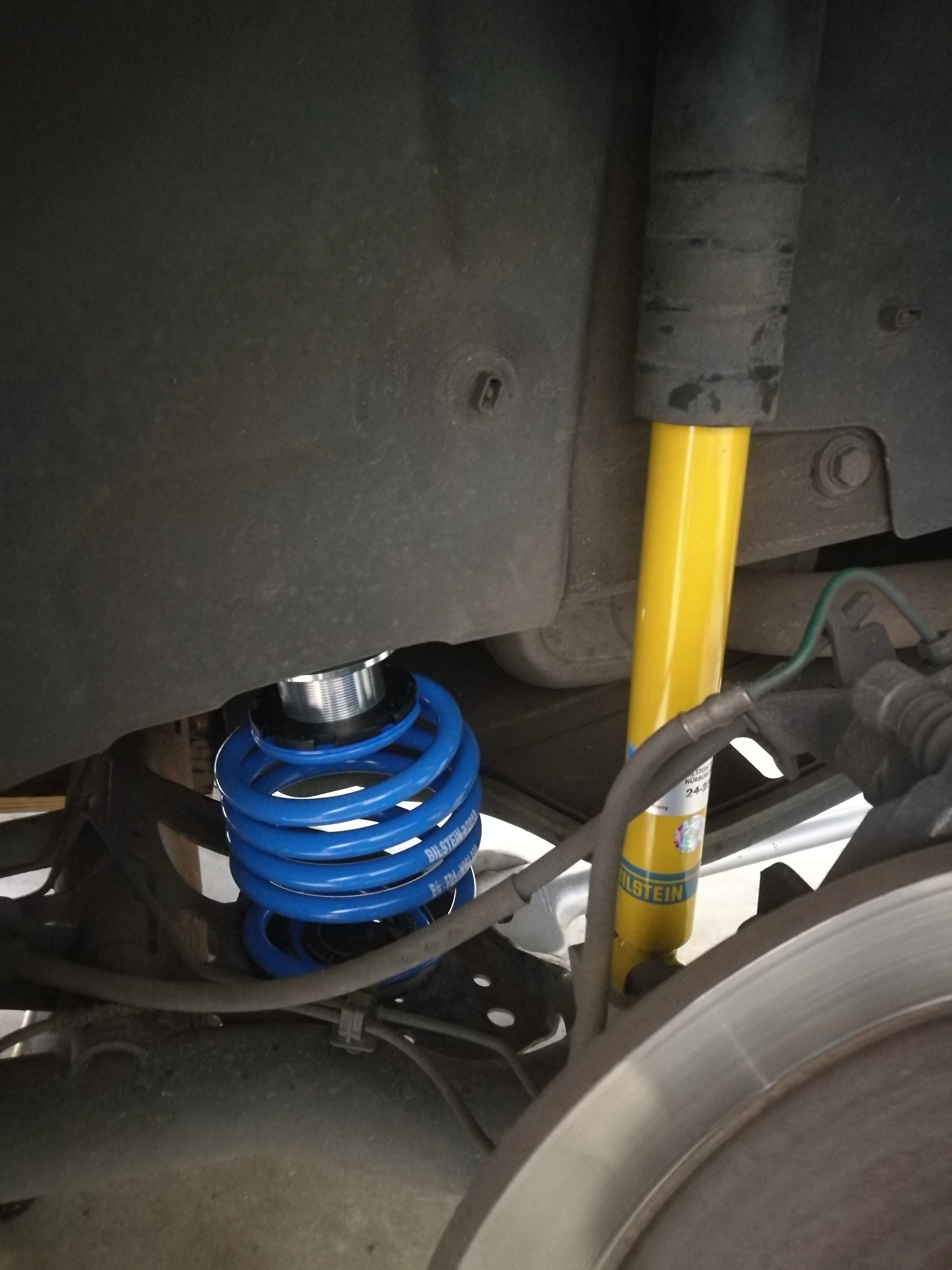

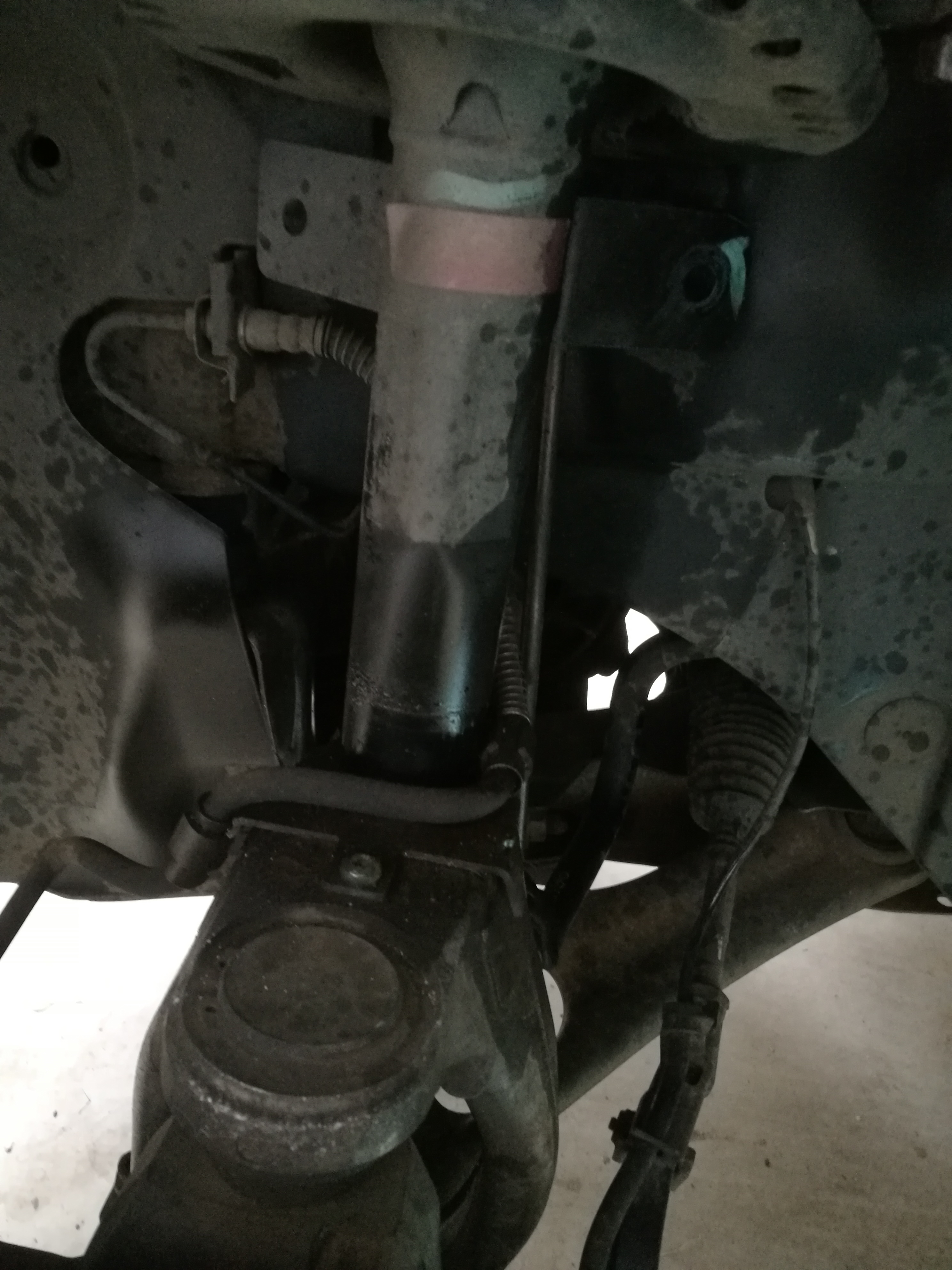

I ended up getting Bilstein B14s for a birthday present from my wife and went about installing them and hit the dreaded front shock removal. truth be told that did not go well and i decided i needed to pay someone to do that for me.
A little while after getting the front installed i noticed that the rear was quite firm and not the same as the front in terms of bump absorption. The rear was already set at the max height as I live on some terrible roads and need the clearance.
I took out the rear shocks and check the travel against the bump stop. Even on the hightest setting the shock was pretty much riding on the bump stop. so some measurement later i took about 1.5cm off it
The ride now seemed to match the front over bumps better now. They are actually hard to cut through hence the crooked cut haha
