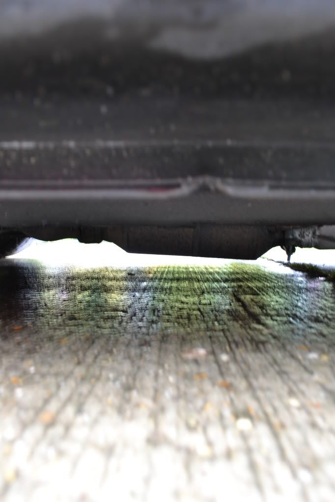

For some reason my cat sits really low. It bow's down slightly in the middle Any way i can raise it?
Can post a picture shortly if needed.
  BG182FF
yeah the whole exhaust sits quite low really :( cant seem to find a garage that can sort it :( my mate is going to post a picture later so if someone can look and help, i'll be over the moon :)

your cat is on a flexi piece of pipe so will be being pulled down by the rest of the system i am guessing.
Have you checked your mounts?
  Clio 197
Try spinning the clamp 180 degrees that joins the cat to the center section as that looks to be slightly lower than the cat itself, this might be the cause of the scrape

yeah good idea :) thanks mate, will get it into garage and sort it out until i can get hold of a decat, think that will solve the problem as they are only a thin pipe :)

cool, whilst you (or garage) are under there have a quick check everything is in order with the flexi pipe
