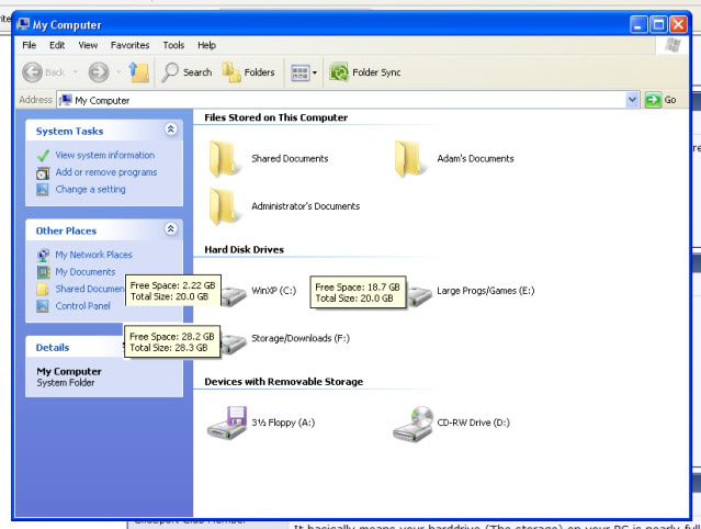

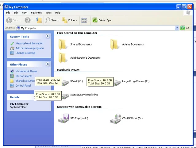

seems i have 3 hard drives WTH??? heres what in MyComputer as u can see c: drive is full E: and F: drives are empty is it simply a case of putin some software in to then folders to free space on the c:drive??

Programs try to install to c:\ drive as defaults, thats probably why.
How much memory does the computer have, maybe there is not enough room on the c:\ drive to run the memory buffer thing.

No don't think so, i think you'd have to uninstall photoshop, then reinstall it on one of the other drives.

You might have some problems running the programs if you move them to your other drives so I would avoid doing this.
I would move things like music/pics/movies/p**n to your other drives to clear up some space on your c drive

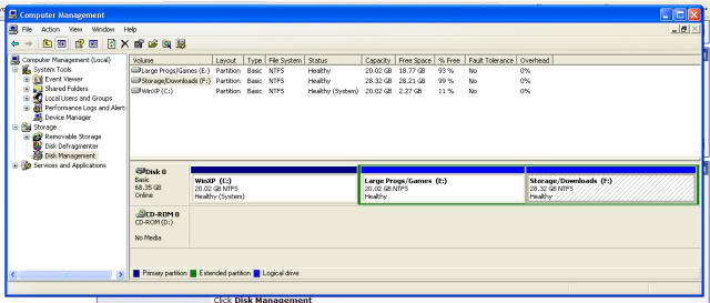

do you know how many actual physical hard drives are in your pc?
you might be able to repartition it to give more space to the c drive

But you can check how many drives you have by doing this (assuming you have Windows XP)
Click Start, click Run, type compmgmt.msc, and then click OK
Click Disk Management

No you only have 1 physical 60GB hard drive which has been split up.
You can use a program like Partition Magic to resize it. Sure there will be some free programs around, just search with google
For example, you can have:
c: 60gb
c: 40gb / d: 20gb
I'm sure you get the idea...
