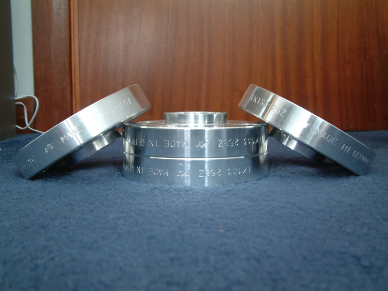

nice FK 25mm spacers

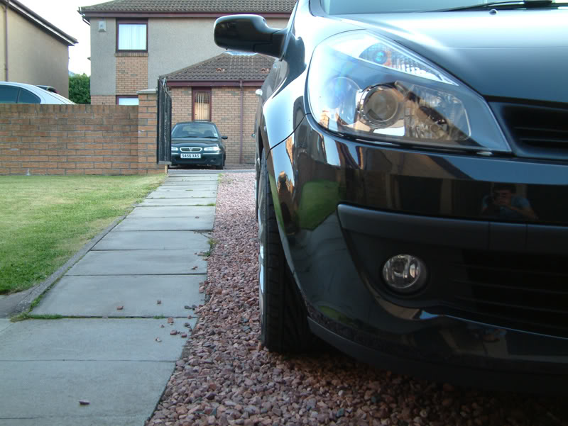

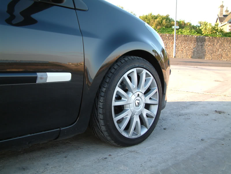

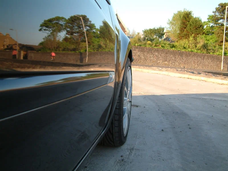

Before the spacers where on.

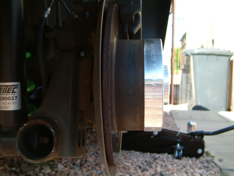

First one on and at that point i managed to snap a 17mm Socket :quiet:

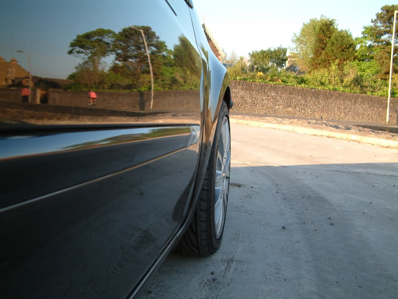

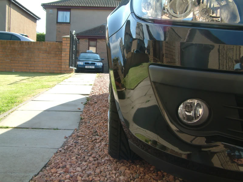

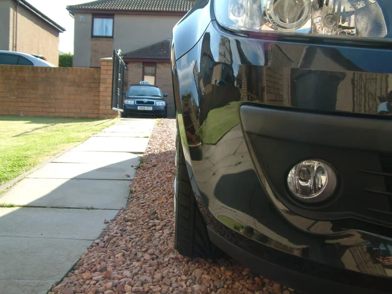

And After....Alot better imo
Didnt get any good ones of the rear will at some point and It will be getting lowered more now !!

Dont suppose anyone could shed some light on the size of spacer i would need to fill my arches, like that?
P.s. Looks marvelous
  RS RIP
Those spacers are sooooooooooo fat; i think you'll have problems in future when driving hard etc.. Puts stress on bearings etc. because you've changed the ET by a lot.
Maybe i'm wrong; it certainly looks very good :approve:

these are System B Hubcentrics so the spacer bolts to the hub, then the wheel to the spacer.
3 - 20mm spacers use system A where you need extended bolts, these are half the price.
