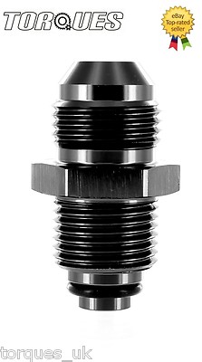

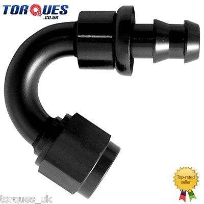

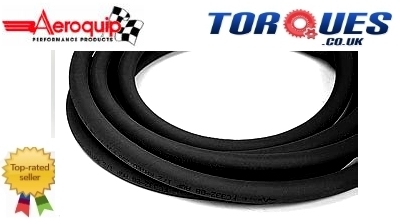

I can tell you that the reservoir suits -8 aeroquip push on hose, dont know about the oem hose. Have you thought about making a full custom line for the return? Pretty simple and not expensive to do.
HSH
I have thought about this, however unsure on the dimensions of the union at the rack end.
I’ve considered using pirtek to make a metal line crimped to rubber hose (with the rubber end a flying lead, allowing me to cut based on application). Then route the hose from the cooler to the res.
This is for the return, I wrapped the line in some fire sleeve as well although Ive forgotten what size I used.
