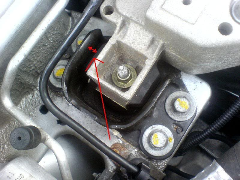

is this knackered? i am gettin the clucking under hard acceleration etc.

Just to note that
If you loosed the 4 16mm bolts on the left hand top mount, put a large bar behind the mount and pull the whole mount and engine forward as far as you can get it (engine is pulled towards the front bumper)
then whilst holding it forward tighten the 4 16mm bolts back up nice and tight,
try this as it will only take 2 mins and could solve half the problems for you guys
posted by me a while ago
try it!!
As Ben says this is worth a try. Loosen the bolts on the drivers side mount pull the engine forward with the mount plate and re-tighten. It should have the gap show in the pic at the front of the mount, not the back (arrowed)if that makes sense.
