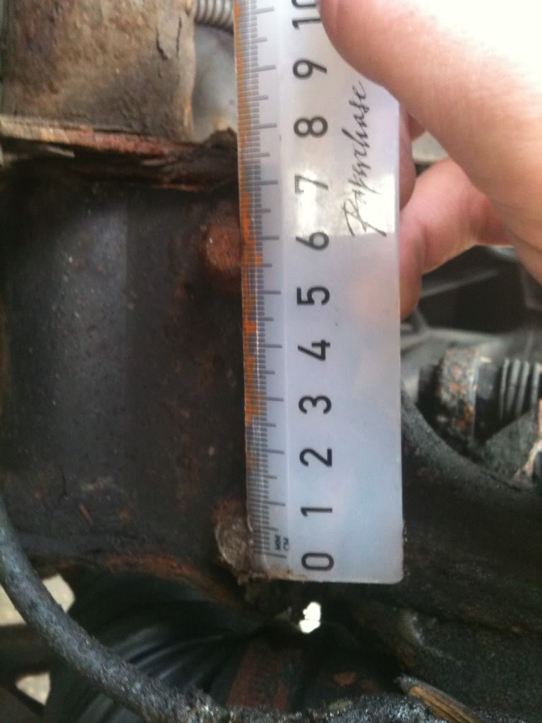

Dweeb: Where would I measure bolt spacing? I just looked on demon tweeks and they have 2 AP kits but one is for mounting brackets of 23mm ?

what car have you got ? 1.2 16 V ?
  MK3 GTI golf 16v
do a search on here, someone will have asked the question before. but i would measure just to be sure mate.
i know the 16V one is 58mm spacing, and im 99% sure the 8V is different so you will need to measure it or look on here mate
  chumpmobile
mine is 58mm, from centre to centre
wouldnt be 23mm hahah!
i think the 1.2 8v is 52mm
check though just in case
  MK3 GTI golf 16v
yeah i have a feeling its 52mm for the 6 valve. but you should check, just need to do what dweeb has shown above ^^ measure the bolts center to center on the bottom of the suspension
LOL Cheers guys is that on the front or back spring? (im clueless I know)

measure on the front suspension. the rear is different, the dampers and springs are seperate on the rear but one unit on the front. which is why you see coilover kits where it has 2 coilovers then 2 springs and 2 dampers that are seperate mate

Right better get a measure on
I wish I read that before I went out haha I got 52mm from center of the bottom bolt to center of the top bolt where the bottom of the shock is bolted behind the brake disk. Those 2 bolts there look about 12 - 13mm bolt heads?

52 mm it is then mate, i just spent ages looking online try any varients you can think of to get more search results. you could get coilovers for that money easy
