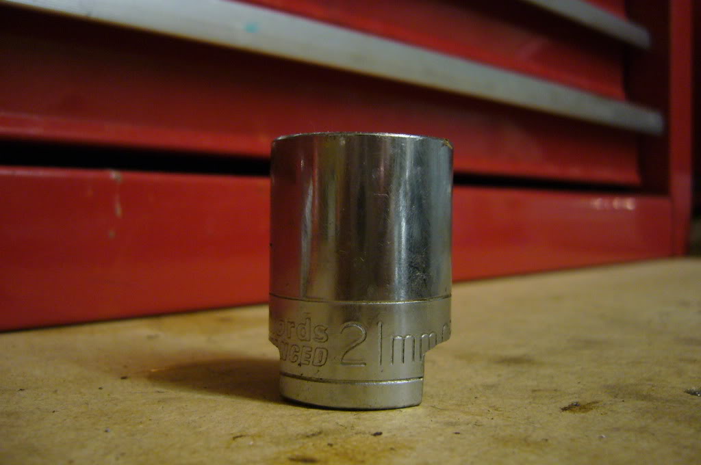

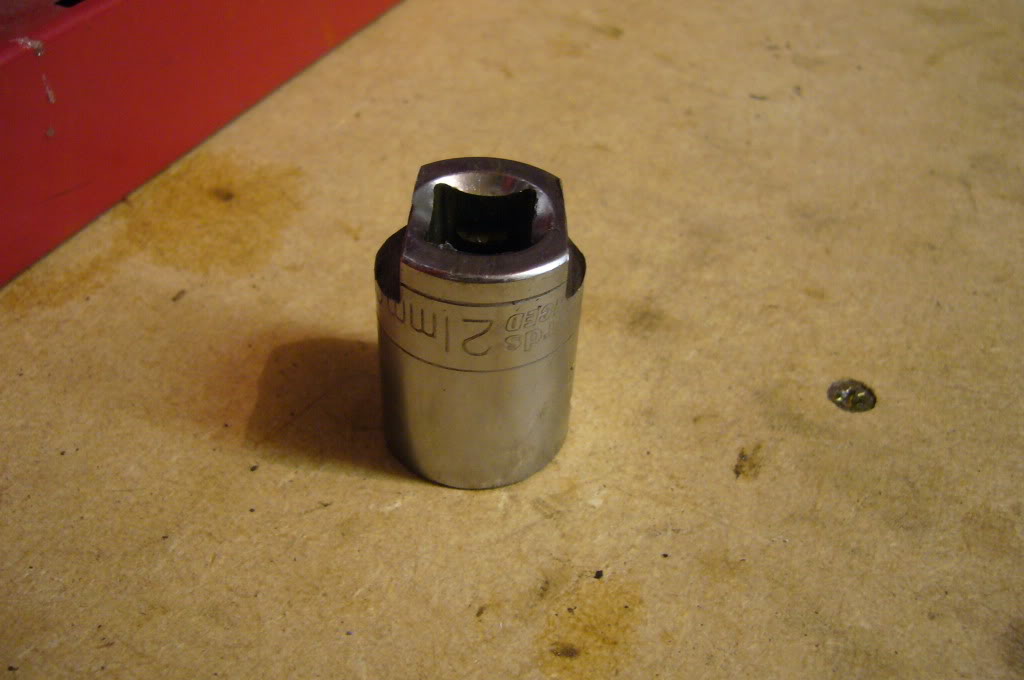

I would have already done fronts, but have struggled to source a drop neck 21mm spanner.
Make your own tool like me and Heez did!
It's genius.
Allows a torx/allen key to drop through the middle, 21mm normal spanner on the outside.... Yaldi.
Looks good...but really couldnt be arsed messing about THAT much. Tried loosening bolts earlier and seemed to move easy enough...so should be a happy bunny this weekend. :D
Fair play on your little home made alterations.
