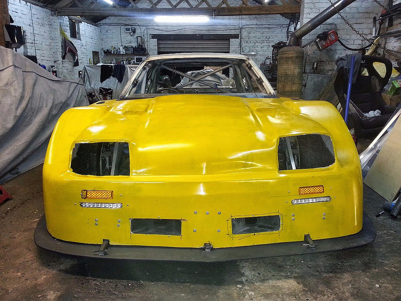

Thought I would post a quick thread about a friends project that I found out about this morning as I have a feeling it will appeal to a few of you.
A direct quote of the spec:
And some power to weight figures compared to his Porsche 911.
And a couple of pictures and 2 videos:
Untitled by Paul Morgan, on Flickr
It is very much a work in progress still but I can badger him for updates if you all wish.
Thanks
Paul

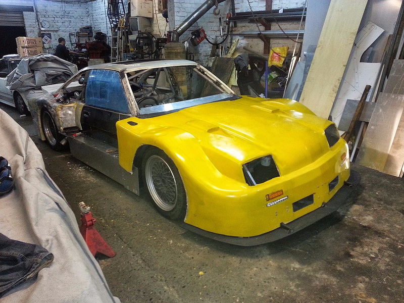

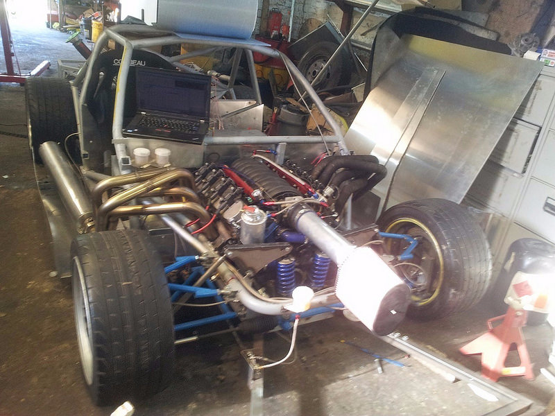

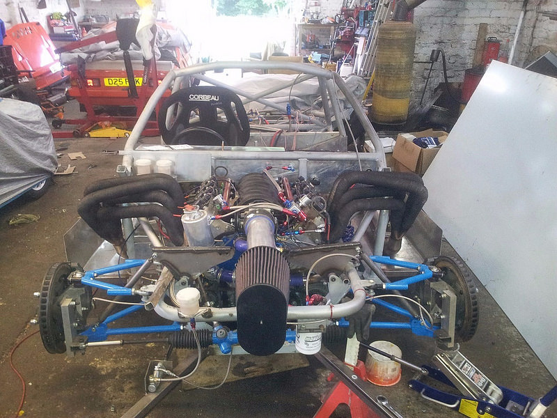

Engine is an LS2. It's a new completely stock crate engine, with an electric water pump, full dry sump with valve covers that oil the valve springs, custom exhausts, and a DTA S80 controlling it all. Plus the comedy intake.
Oh, and the most awesome clutch pack - it's a 7.25" clutch with a button flywheel and the ring gear is bolted to the clutch pack. the whole thing weighs about 4 kg, that’s clutch and flywheel....

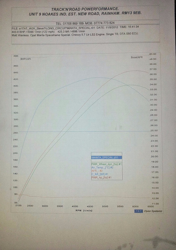

Got thinking about the power to weight ratio of the manta. For anyone who’s been in the Porsche, it's 310 lb ft and 385bhp, 2 up its around 1570kg, assuming the passenger isn't a skinny whippet. The manta has 25% more torque and 17% more power, and with a starting weight of about a ton, approx 26% lighter with 2 terrified occupants. The Porsches power to weight is 246 bhp/ton with passengers, the manta 384bhp/ton, approximately 63% more. And I thought the Porsche was quick...
And it's really quick and easy to get 550-600bhp from the manta engine - basically cam and heads...
That makes it 517bhp/ton with passengers. Gulp.
