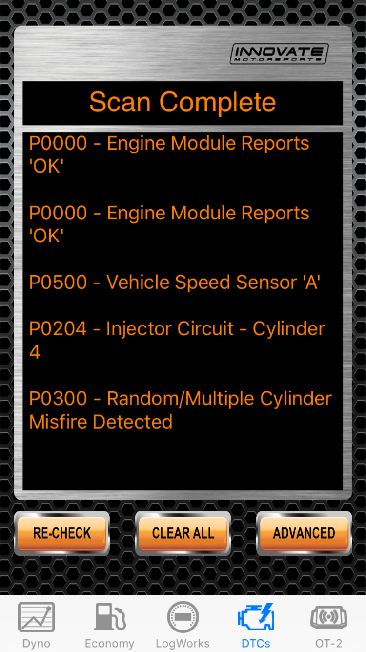

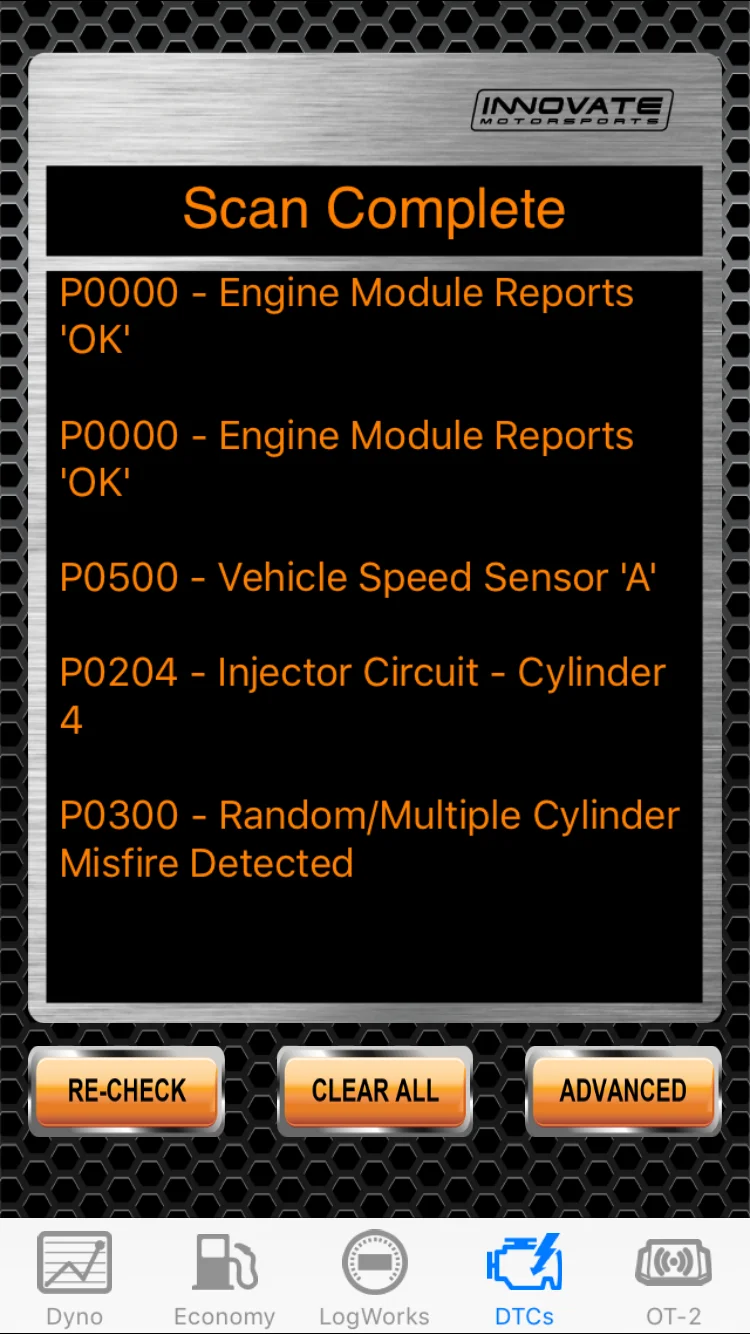

I've got a fault code reader this evening to check it over; it might sound like a silly question; but is it likely to point me to the right thing? As on previous cars (not renaults) it's given me a bit of a duff steer as to what the actual problem is.
So it appears to be cylinder 4; and random misfire.
I've changed to coil pack and no change; so plugs next, hopefully it isn't the injectors.
My 172 had lumpy idle and it was 1 of the injectors, check the resistance of them with a multimeter, I just replaced the faulty 1 and the car has been fine
