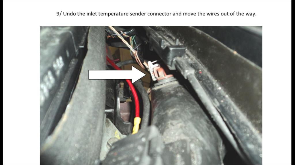

Meganes don't have air temp sensors so maybe it's just a nominal value Renault put on it.
  Megane r26
They do, it's on the plastic boost pipe just before the rubber house that goes on to the thottle body. Air temp sender
Here's a pic
Ahh, when I had mine I never had any of the boost pipework and couldn't see anywhere on the inlet manifold it could go.
