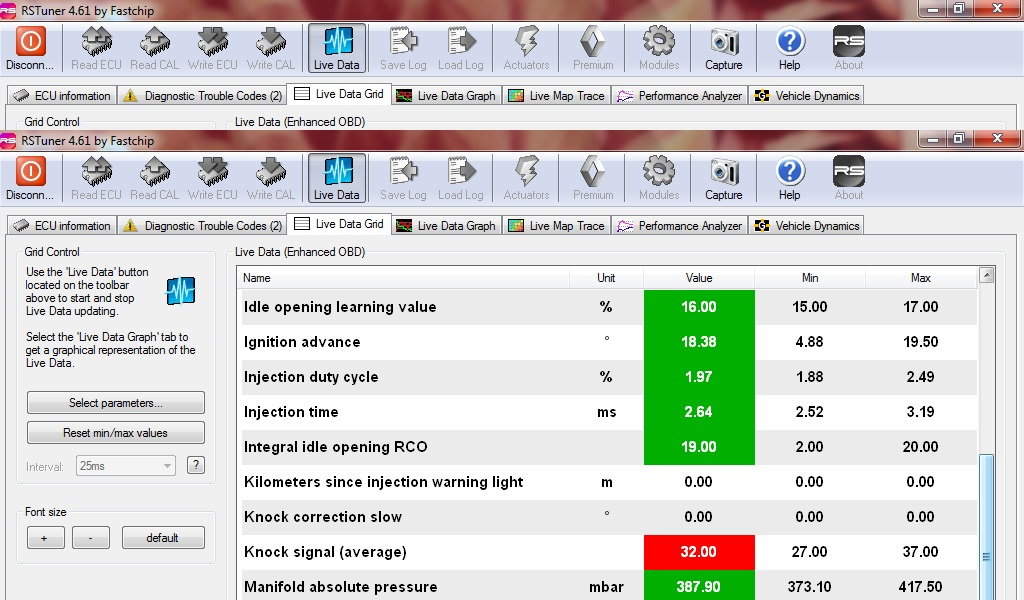

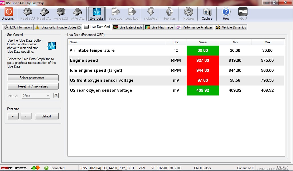

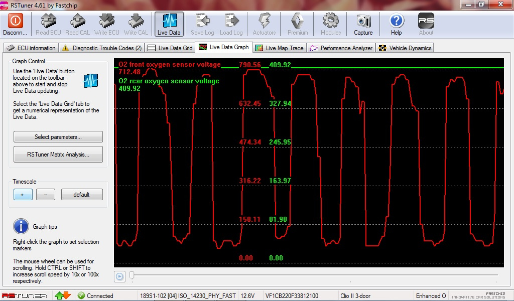

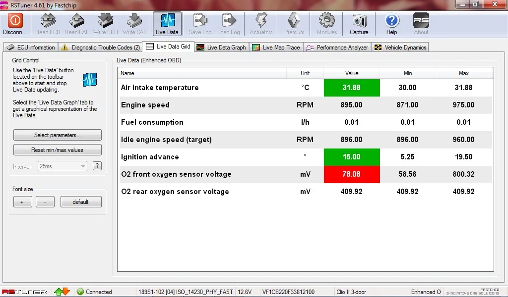

Taken a few screenies of live data etc
o2a by EvoFq3o0, on Flickr
o2b by EvoFq3o0, on Flickr
o2c by EvoFq3o0, on Flickr
o2d by EvoFq3o0, on Flickr
I'm no expert hence why I'm asking you guys for help :) so I really appreciate it, the front o2 sensor keeps fluctuating in voltage, see min and max values.
Not thats its much help but I can confirm the pre cat HO2 sensor looks healthy and functioning as it should. How does it drive as apposed to idle and engine lghts fault codes to lead a clue.
Check other things like engine coolant temp sensor also. check resistance with an avo when upto temp ill check what it is later if you need it.
