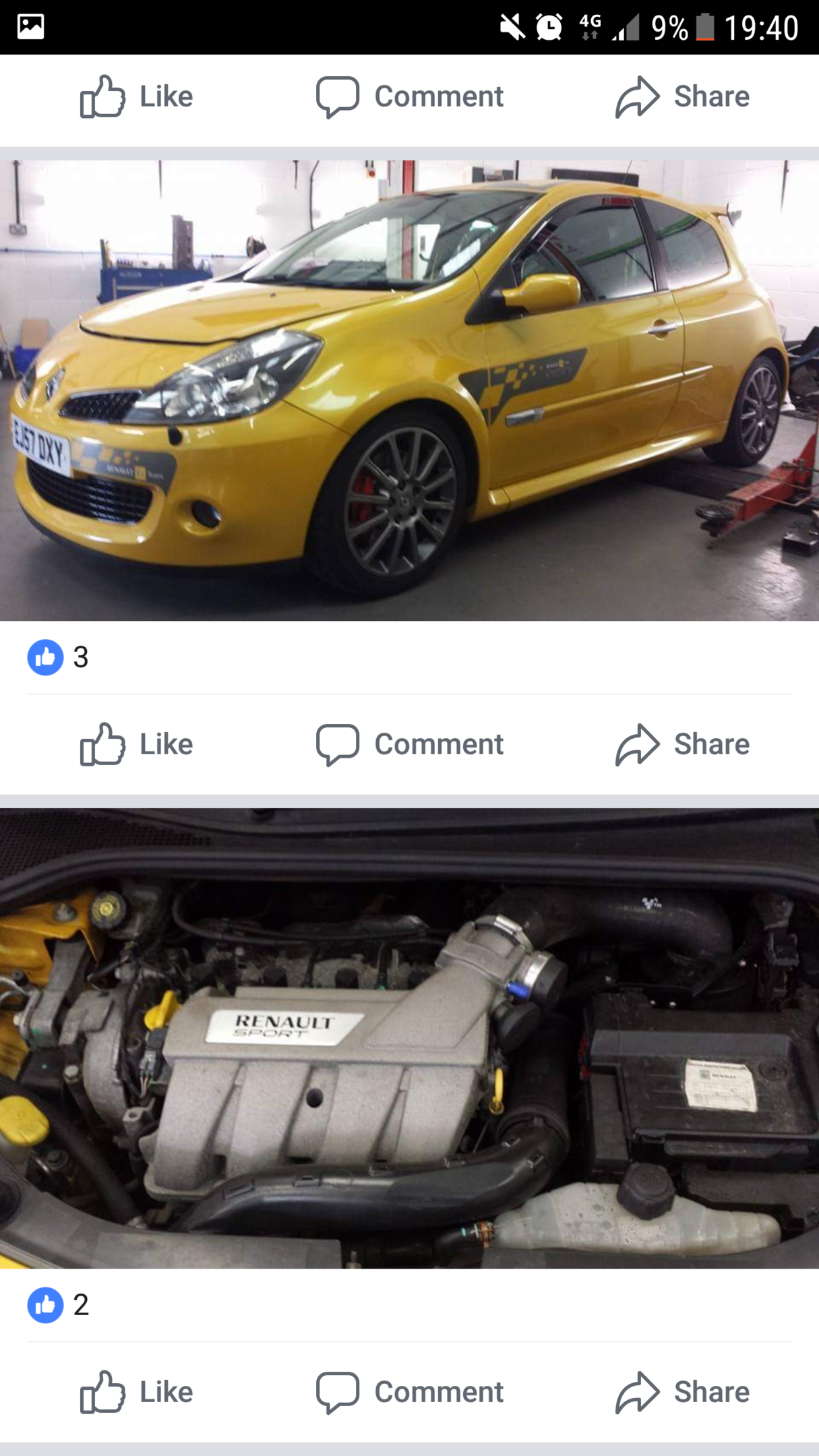

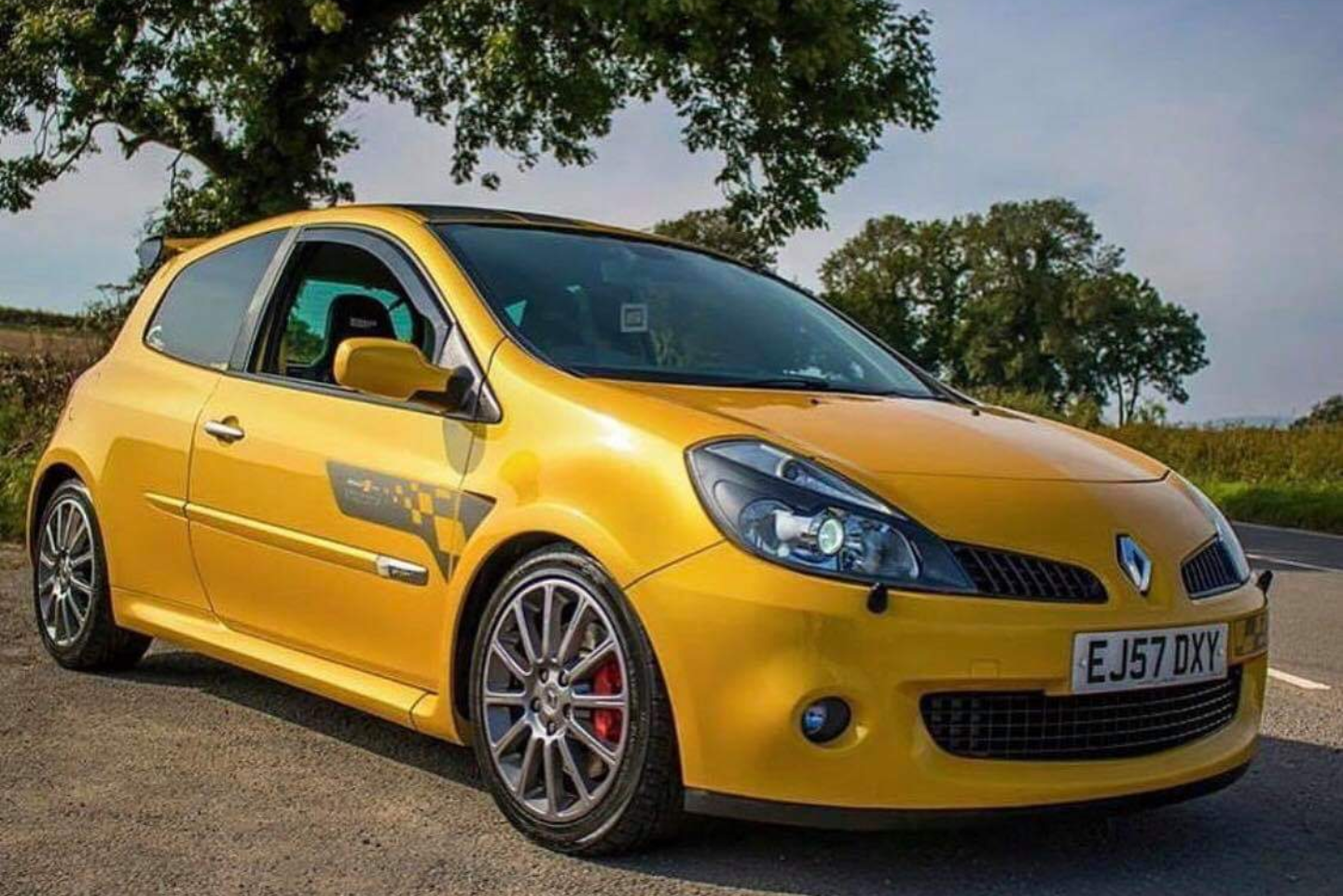

So by some strange fate of luck a friend was selling his 225 converted 197.

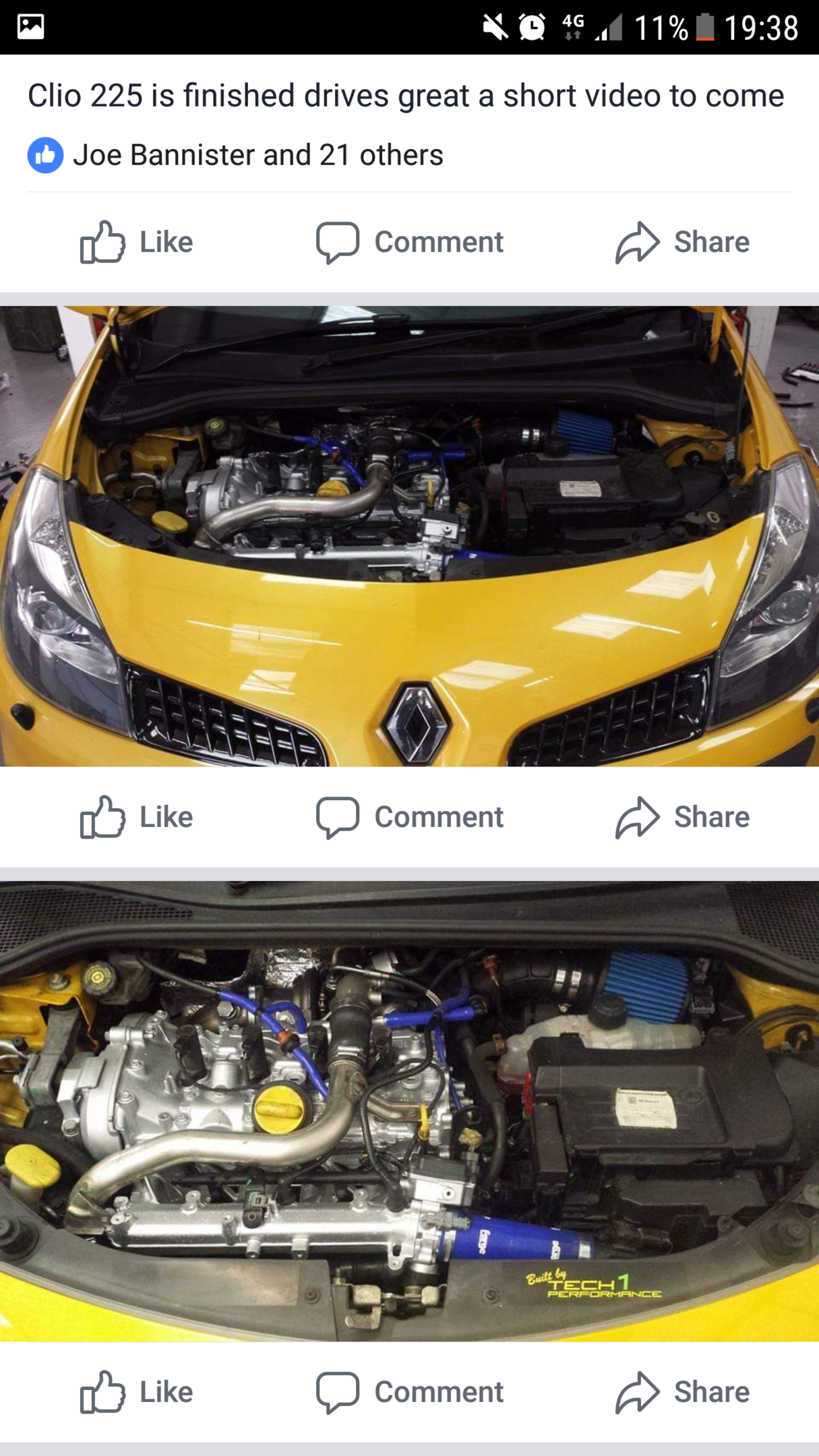

It's been converted for about 4 years and I know he spent a small fortune with Tech 1 Performance to undertake the conversion for him.
Spec was the following when it was converted
Megane 225 engine
250 Turbo
630cc injectors
3 Inch Decat
2.75 Scorpion full system
SMF and R26.R clutch
Remap to 300/300
Sadly it s**t its original engine a few weeks ago so he wanted rid.

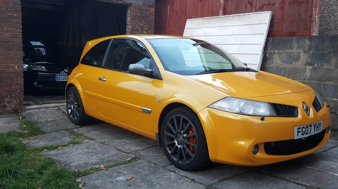

Step in my Cat C R26 to be its organ donor shortly

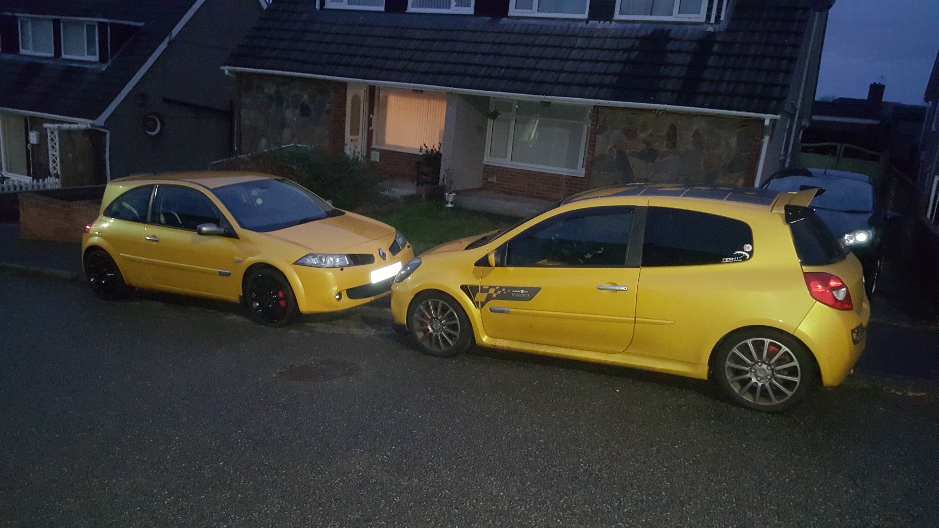

Here's a quick pic of them togther
So plans are simply to swap running gear and gearbox from the Megane with the performance bits off the Clio and make one nice car.

Looks can be deceving. Its a Cat C registered car with 10 owners so sadly not worth a great deal complete but runs perfect so a great engine donor.
