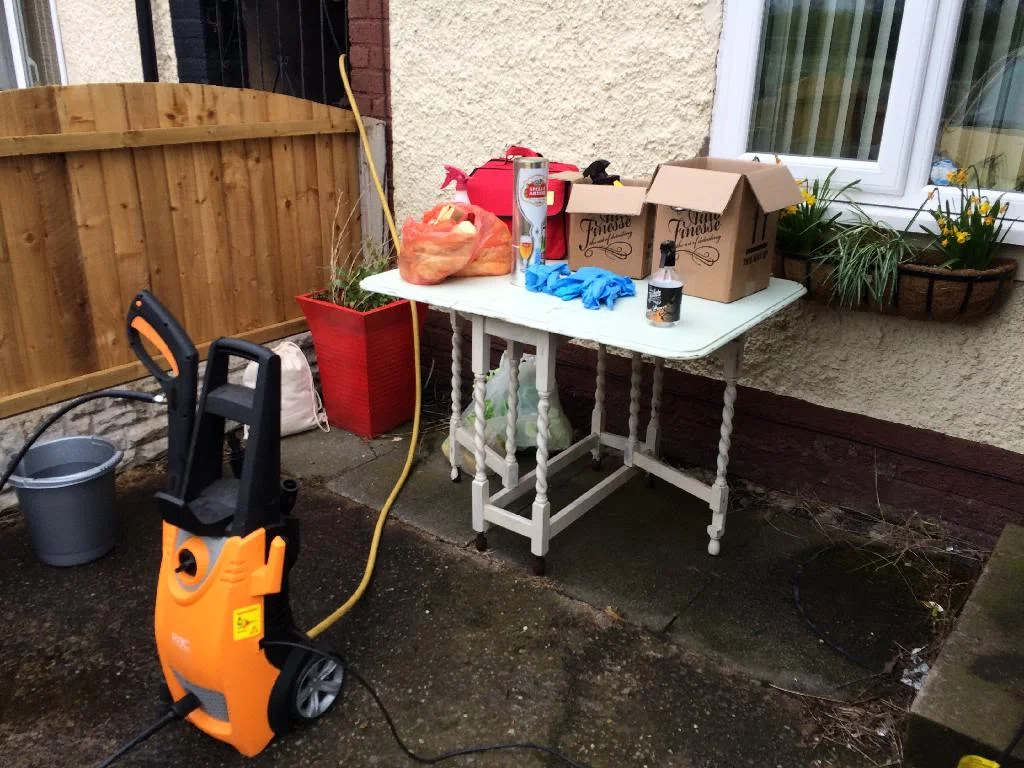

This weekend was the first I've had free and decent weather so I jumped at the chance to give my car it's bi-annual cleanse and reprotection.
I stole my girlfriends fold out table as It makes a brilliant cleaning station :eek:

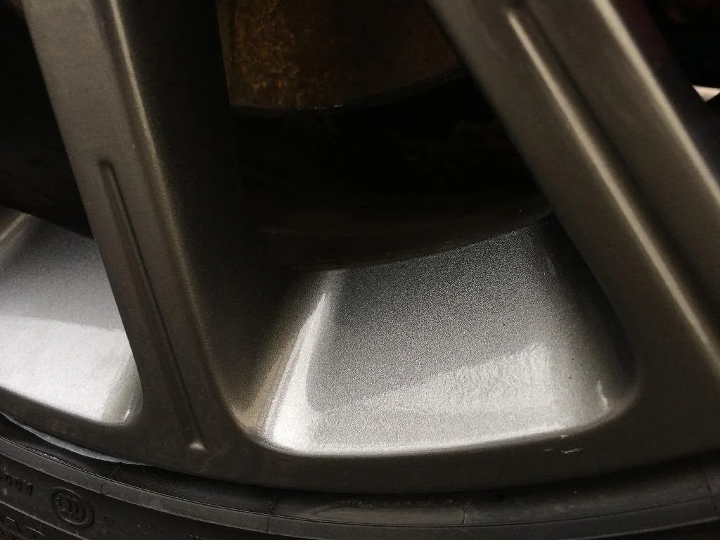

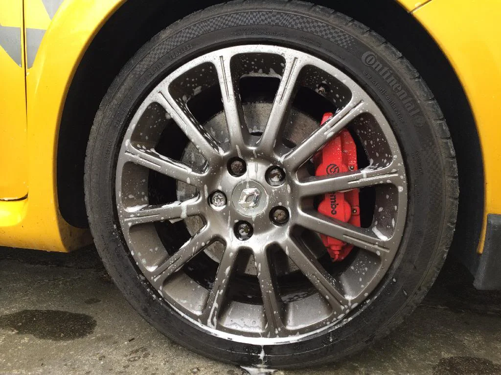

While this was working, I started on the wheels with AutoGlym Clean Wheels... It's nothing impressive, I only used it because I forgot I had a litre and a half of wonder wheels hot wheels.
Dwelling
Agitated
Thanks to the application of tough coat a while ago, CW didn't have much work to do.

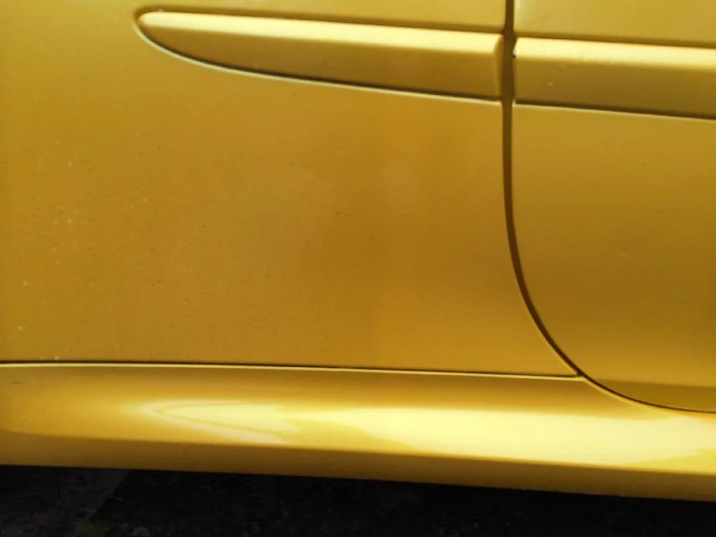

Onto Auto Finesse Lather
I got a bit carried away so didn't get any pictures of its foamy goodness. It's such a lubey shampoo and foams up incredibly well. The smell isn't amazing but that's probably just me.
Rinsed off leaving
The remnants of Auto Finesse Spirit. Not bad considering it was applied in November! Am I right in thinking this is still protecting the paint?

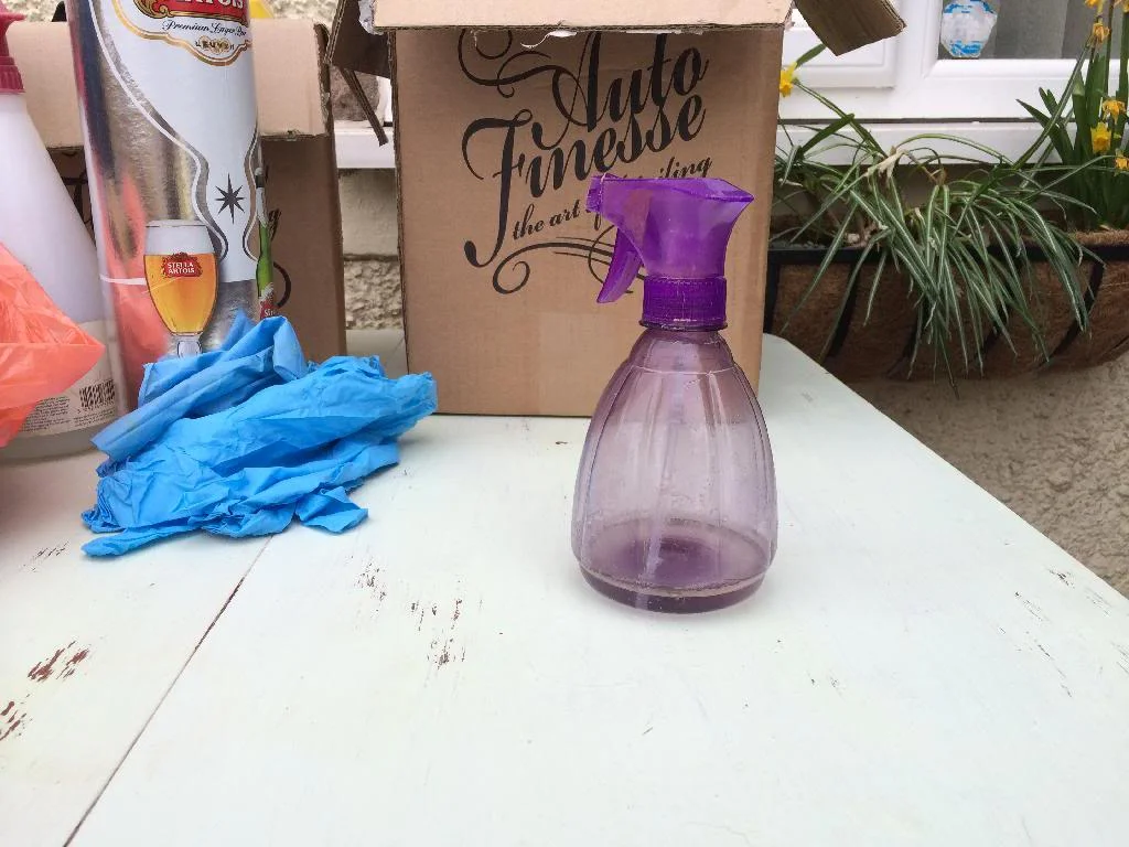

Up next; TARdis... Stole some gloves from work as I'm sick of getting this and ironx on my hands.

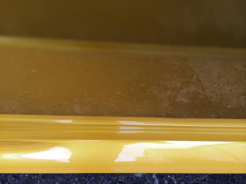

Showing the texture in Liquid Yellow beautifully.

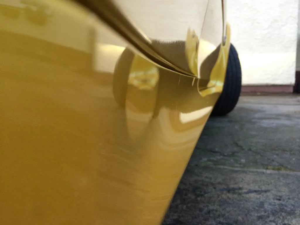

After polishing and buffing it off I got the Auto Finesse Rejuvenate out to lay down a base for Desire.
Now, rejuvenate has a smell and consistency of emulsion, couldn't shake the thought that I was sent the wrong bottle... But carried on anyway.
It's a very nice product to use, very easy on and off.

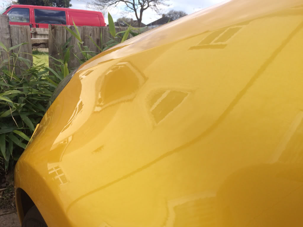

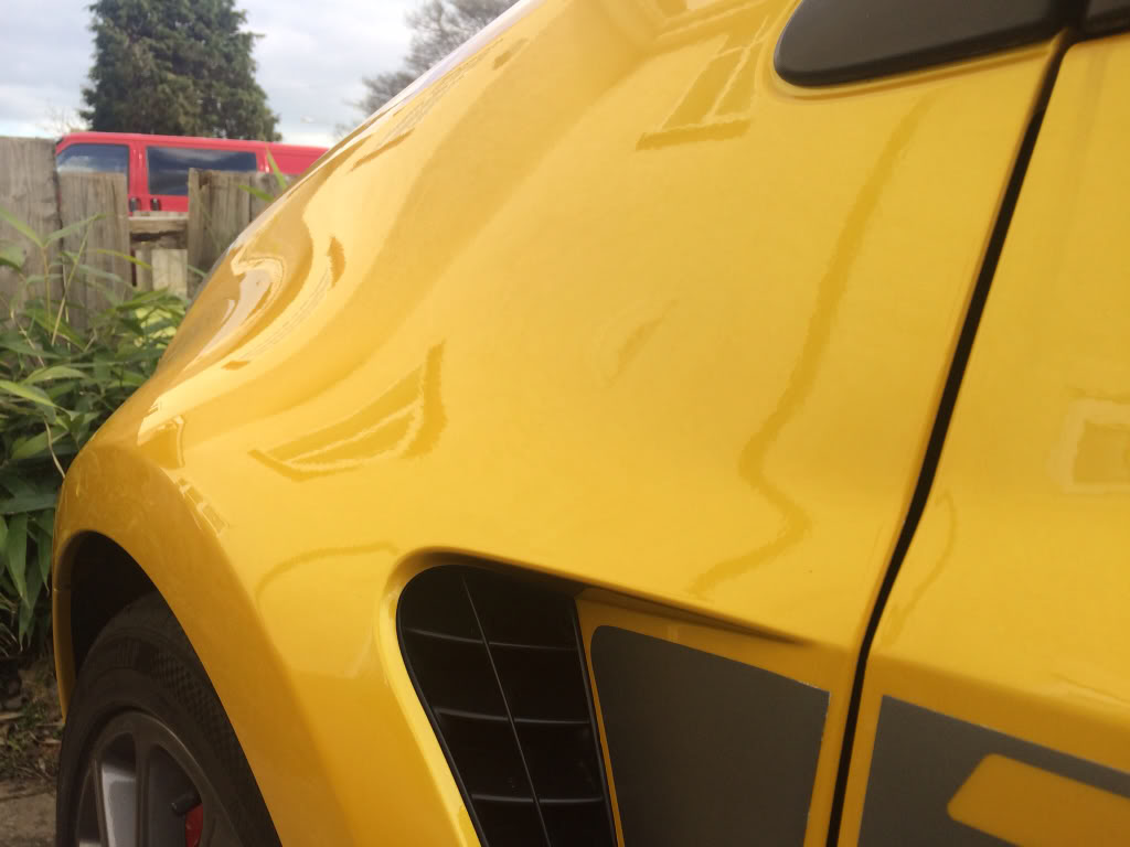

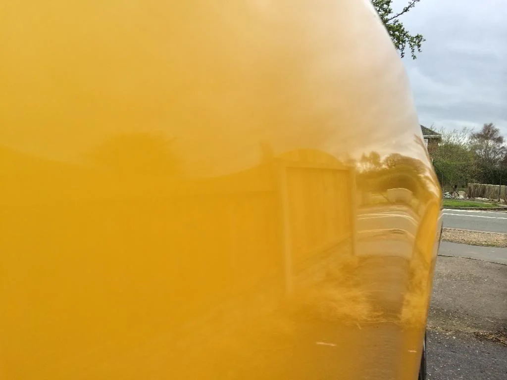

I was over the moon with the state of the paint.
Caught some more texture here
I got carried away with the photos sorry.

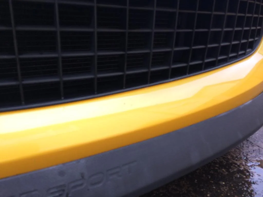

I was very impressed at how far it spread. A tiny dab coated half the bonnet.
The only gripe I had with this was the inability to see where I had applied it. It became easier to see as the micro fibre became somewhat saturated.
It was very difficult to get photos of it curing, but here are my attempts.

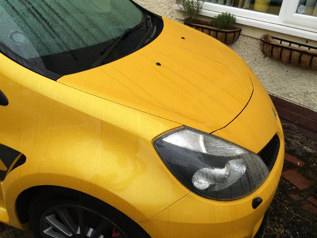

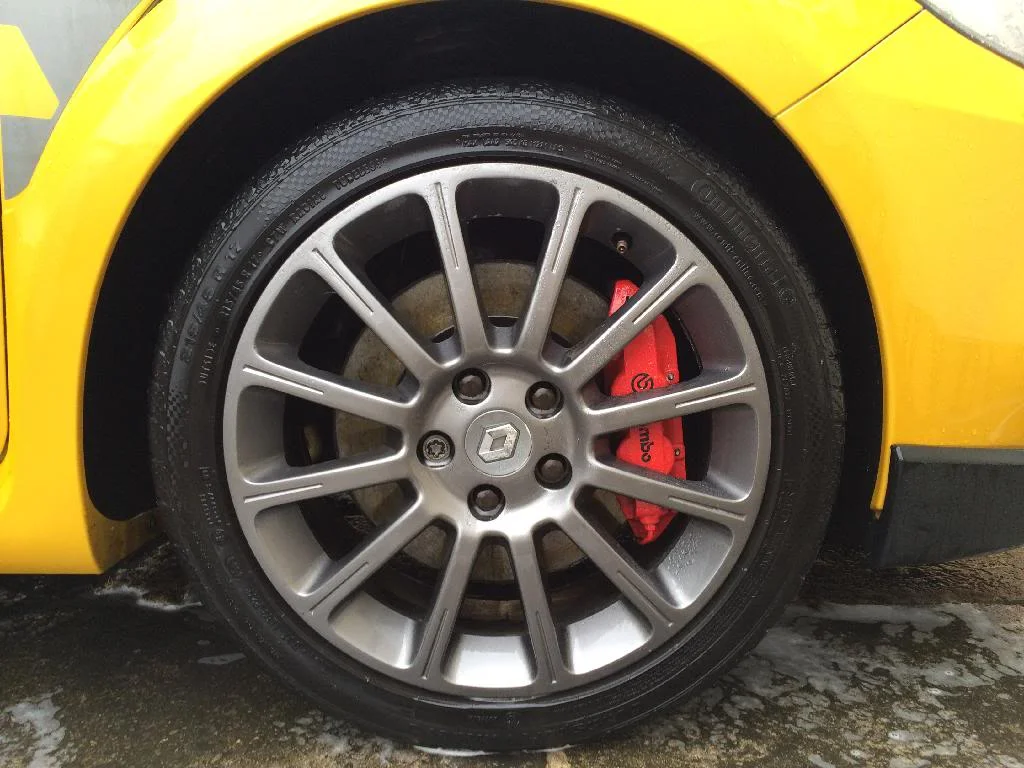

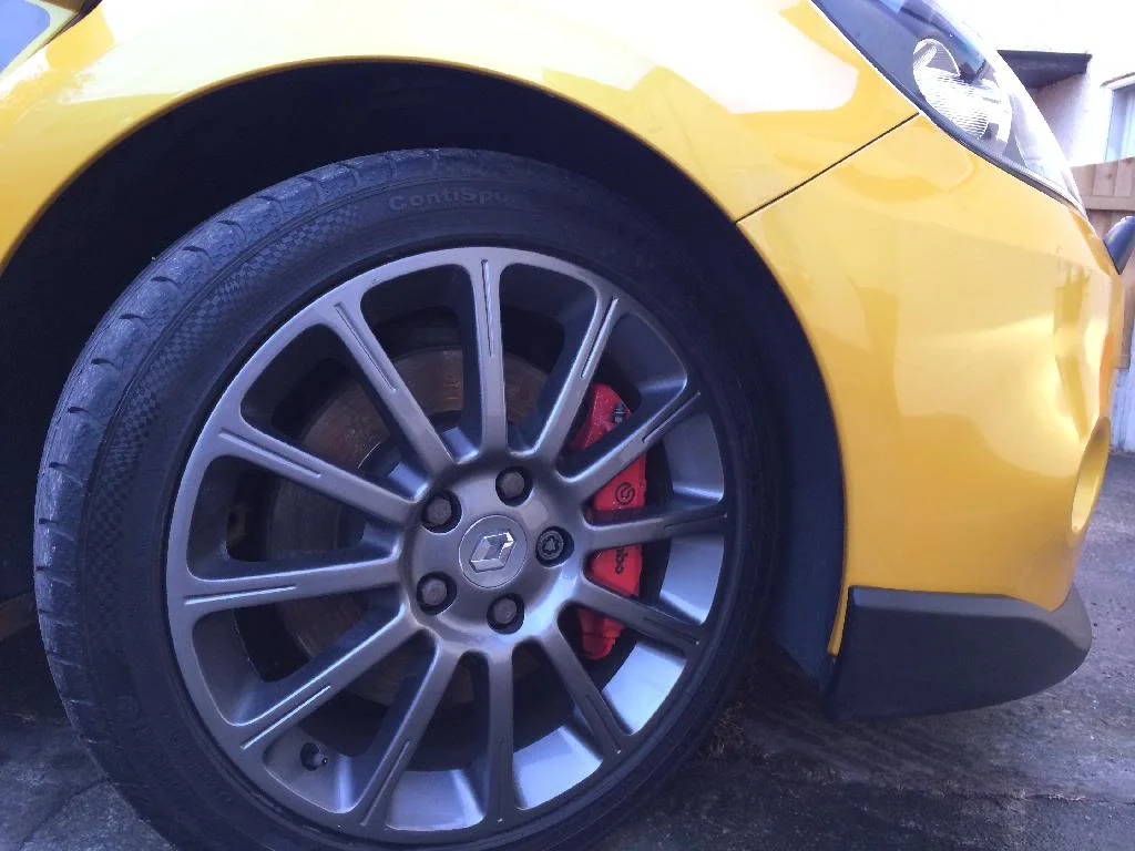

Coated the glass in Rain X and the wheels in Tough Coat
Tough Coat afters

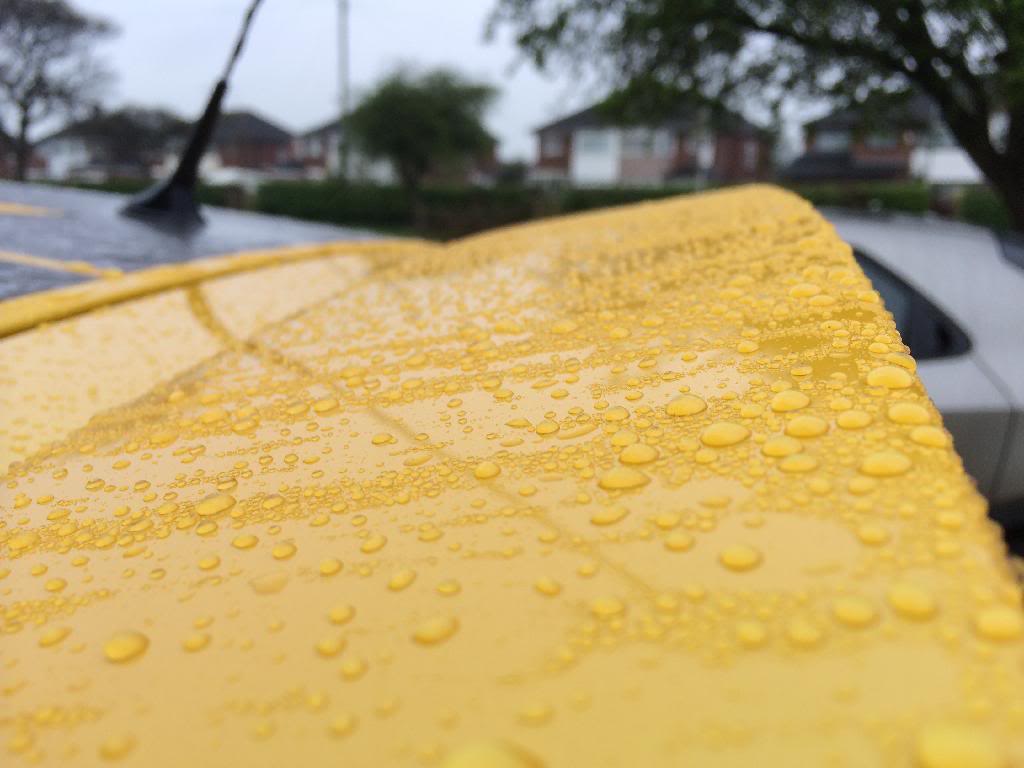

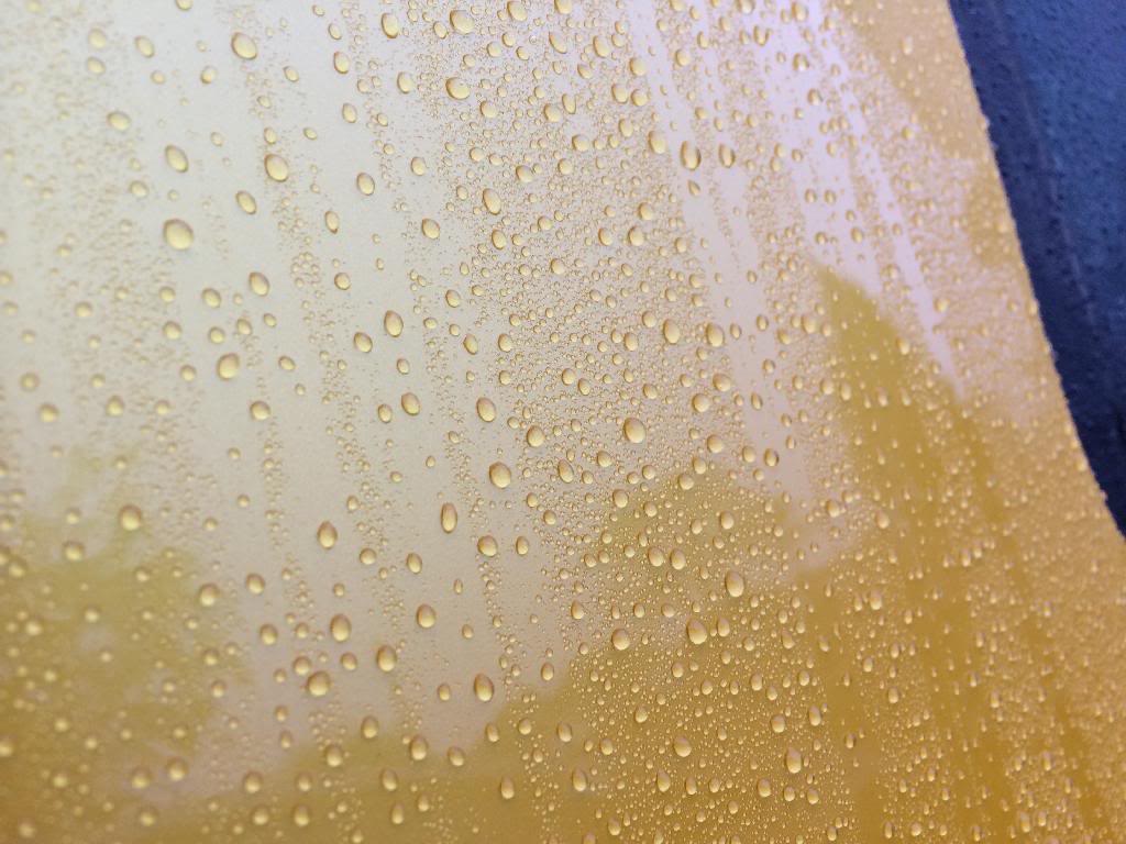

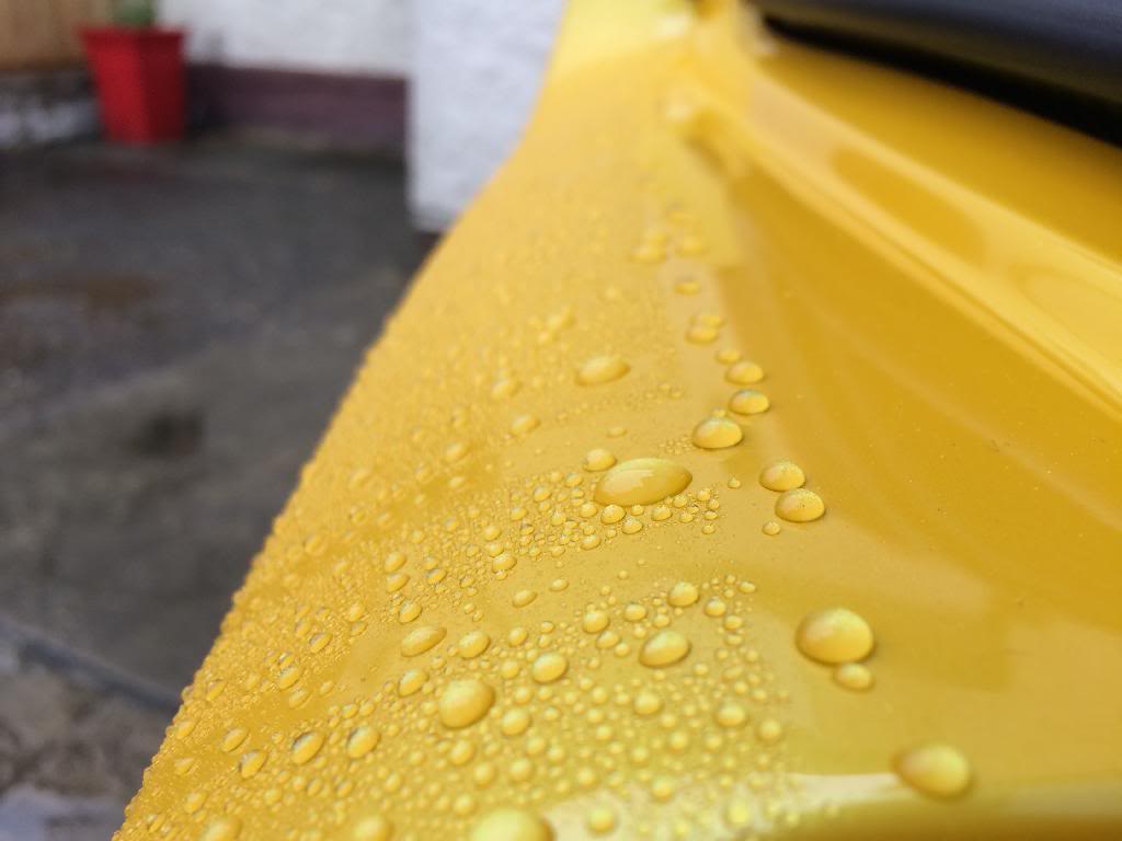

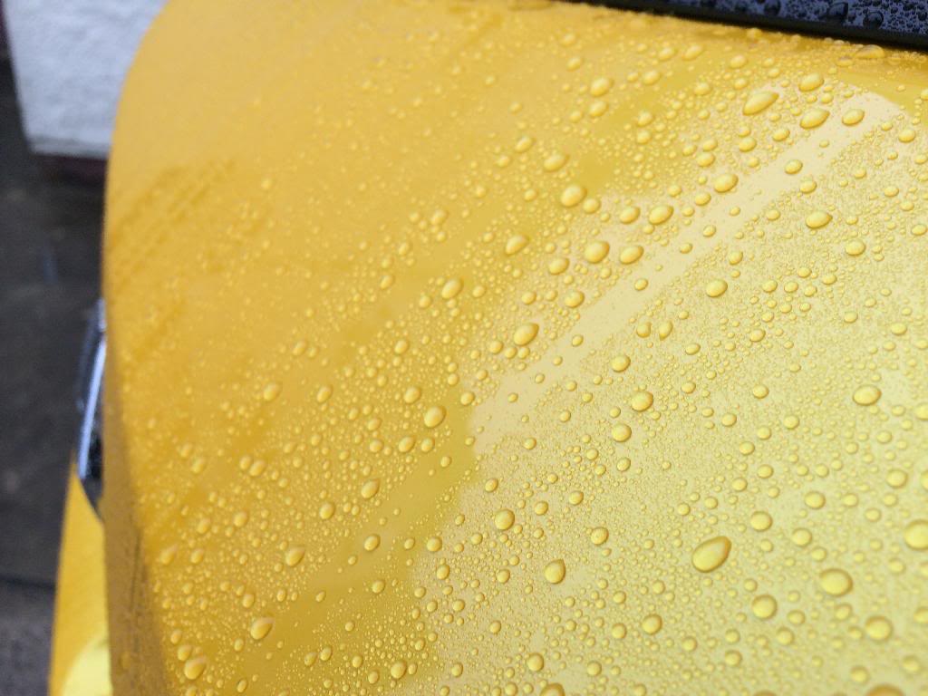

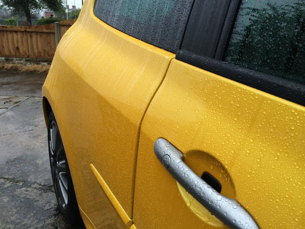

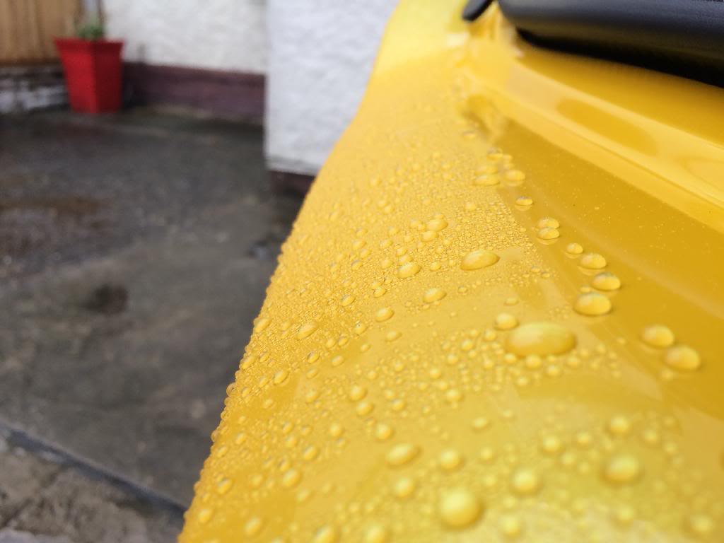

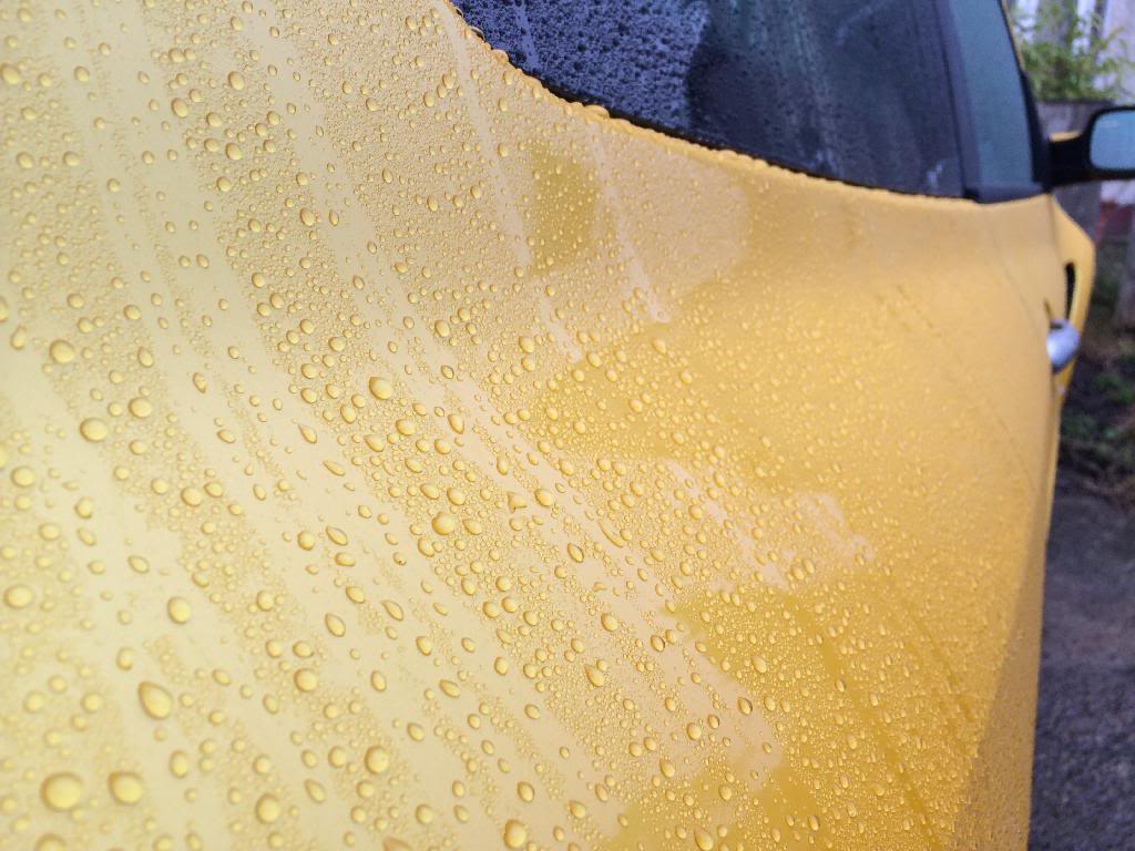

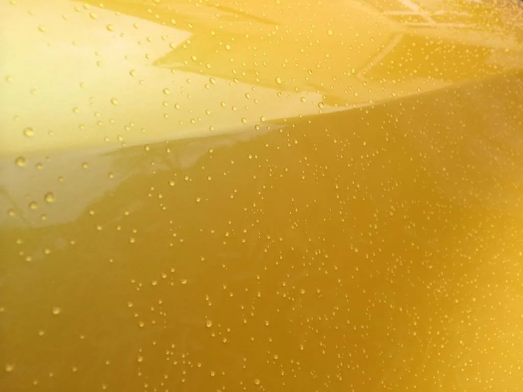

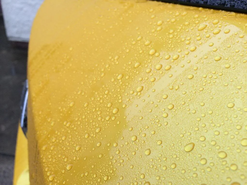

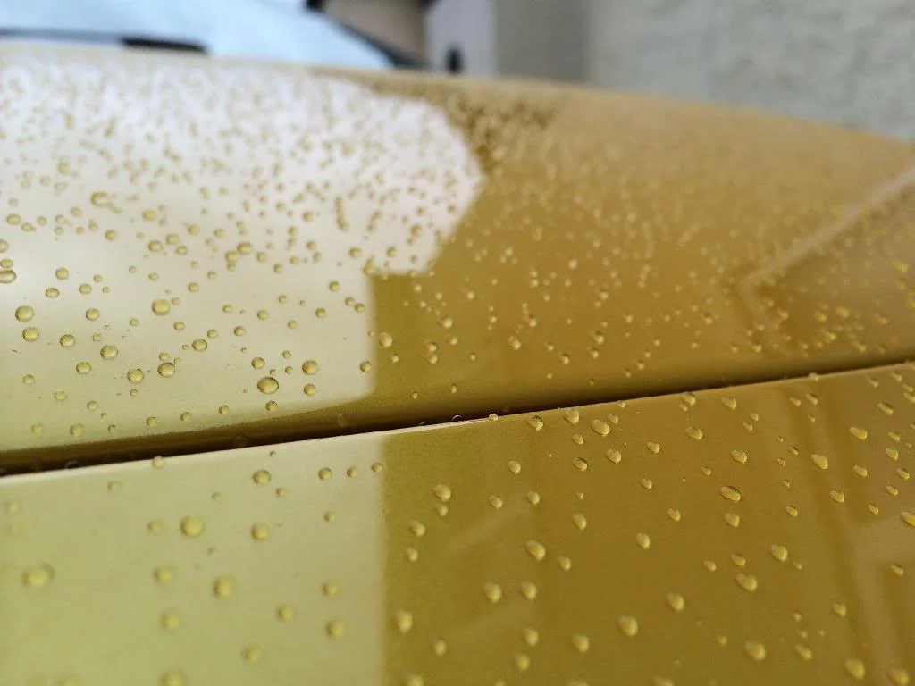

I finished just in time for the rain to start.
Giving some nice beading

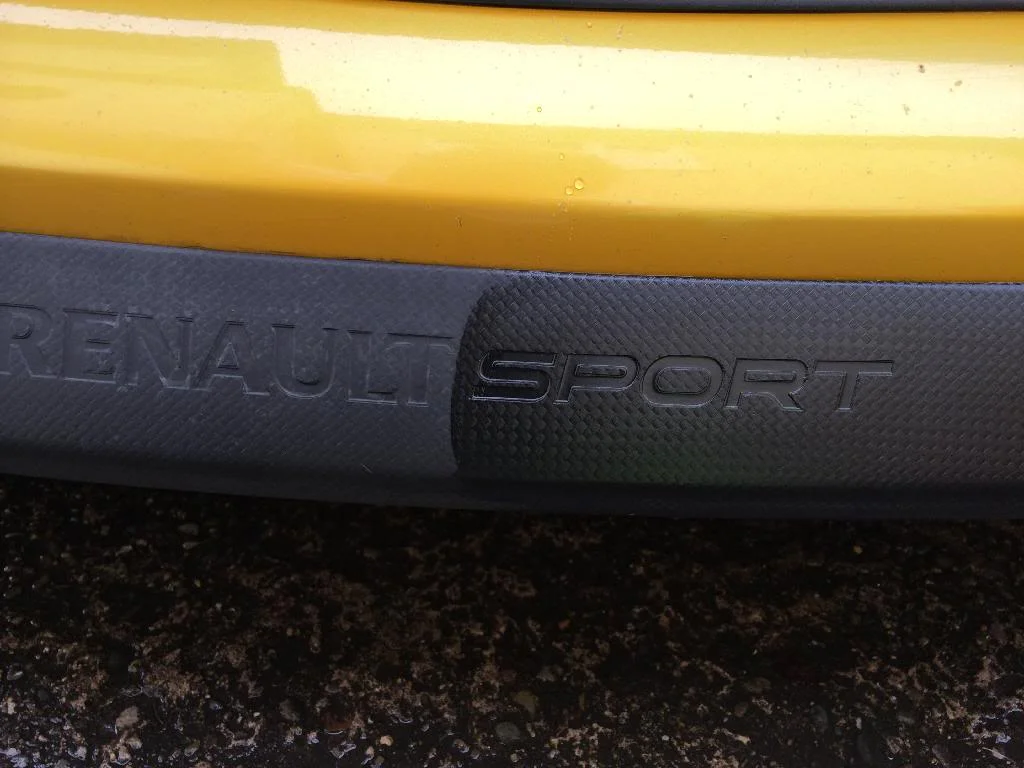

Gave the tyres a going over with the last of my turtle wax bumper and tyre gel. I might buy this stuff again just for the smell.

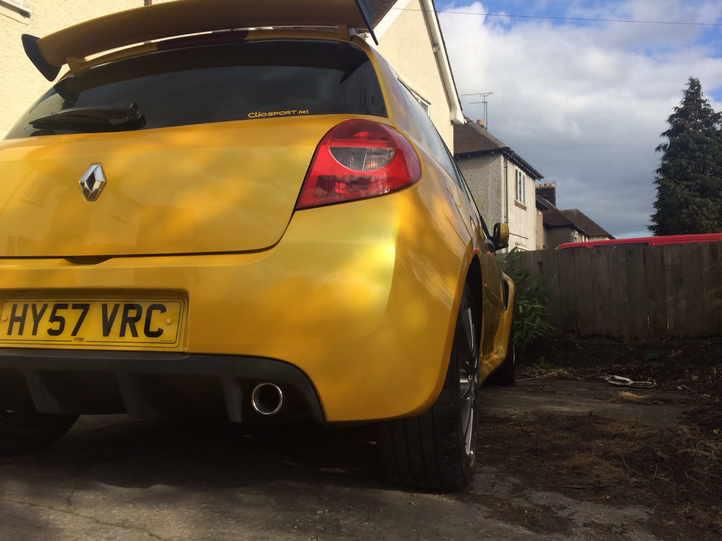

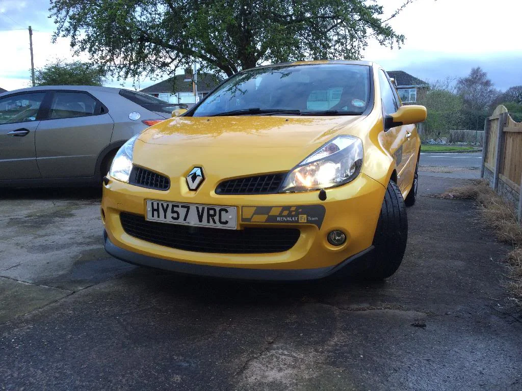

And some afters.
I love the back end of these
