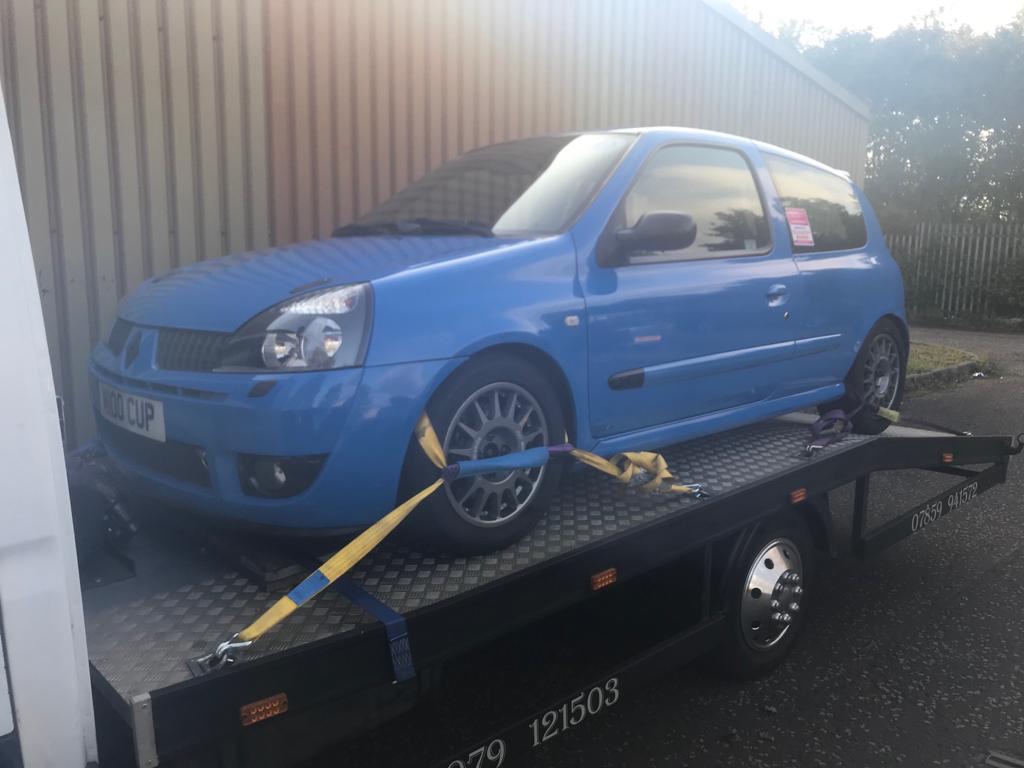

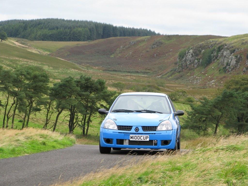

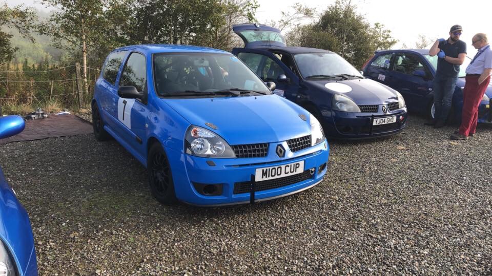

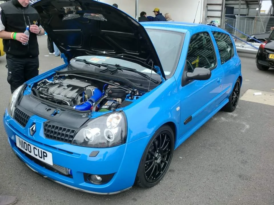

Here is M100CUP arriving at mine after travelling the length of Britain from Devon to Scotland.
I was very keen to try it out. So took the first opportunity to go to a track night a knockhill. The car is fully committed to A2 hillclimb class so this was a bit different for me but interesting non the less and it confirmed to me a few of the changes I wanted to make (you can prob guess from the title its not staying how it is). More in the next part.

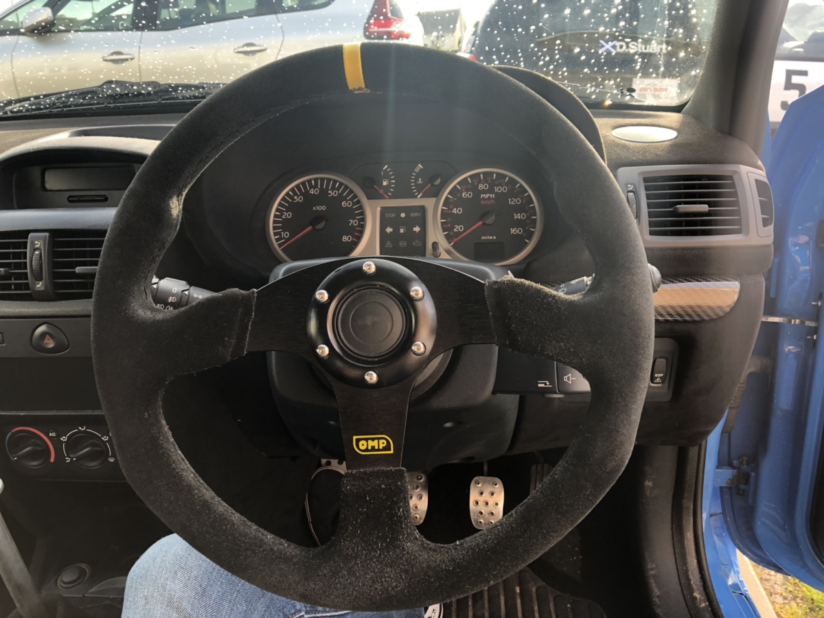

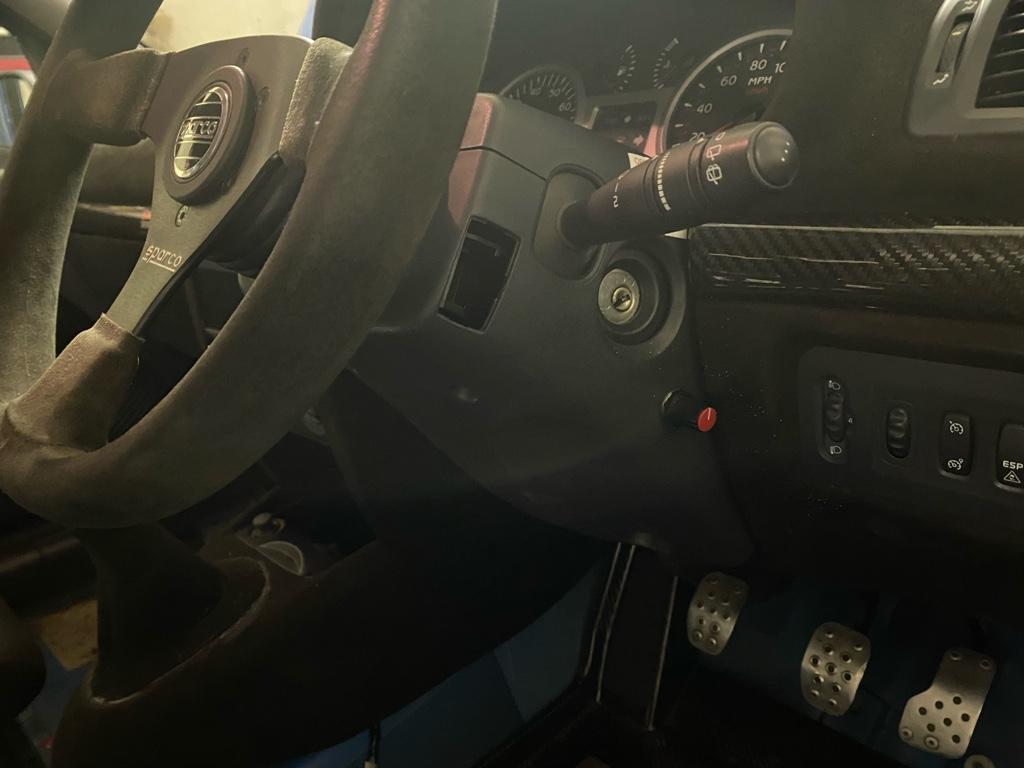

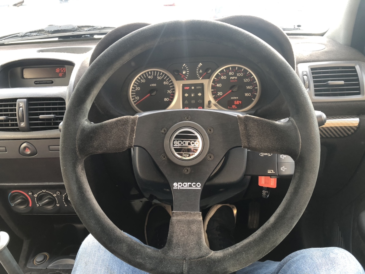

Do I keep the steering wheel or swap. Answer. Swap. The OMP in the clio was a fake Chinese thing that you could flex at the top. My sparco was much better.
Once I swap the wheel I went for a track night at knock hill. A one thing stood out.
The steering felt totally different. Much more understeer and it would have to be looked at.

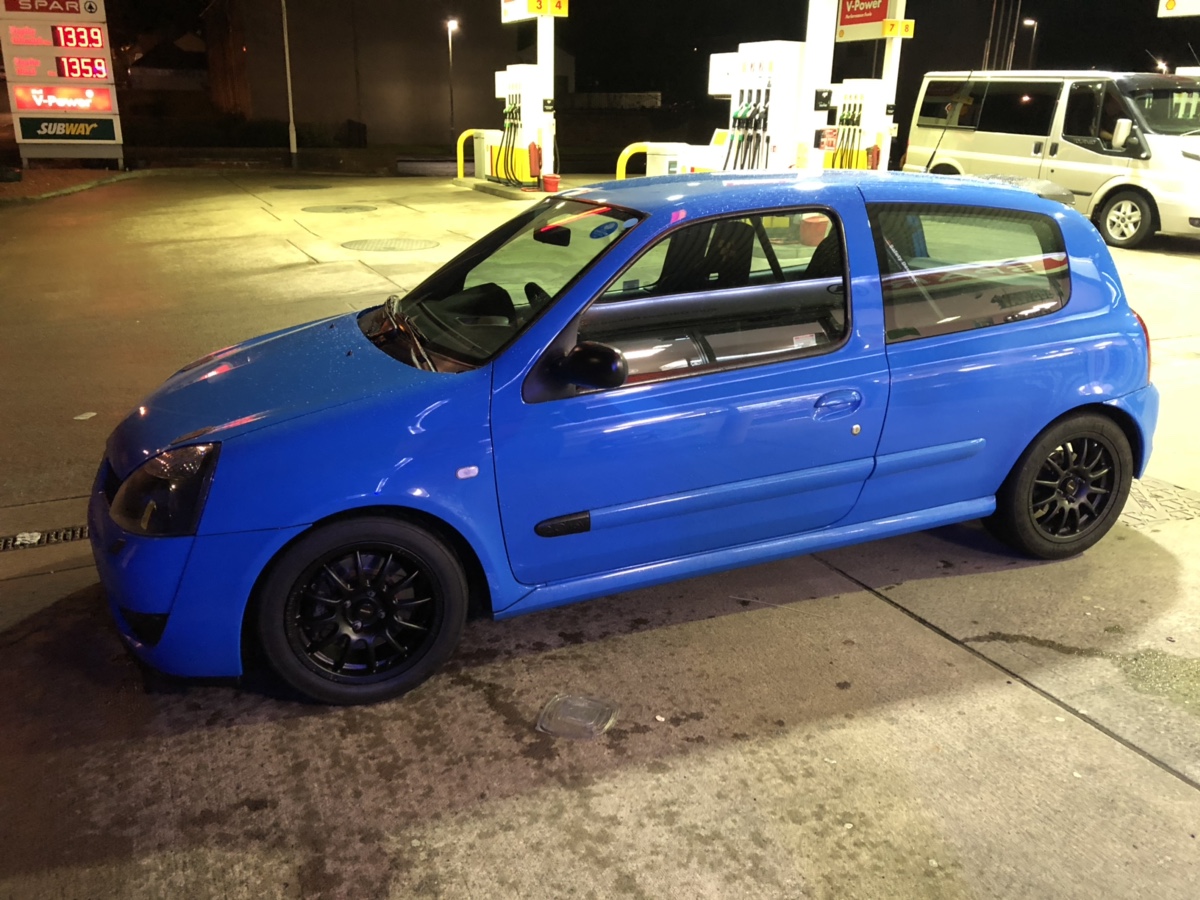

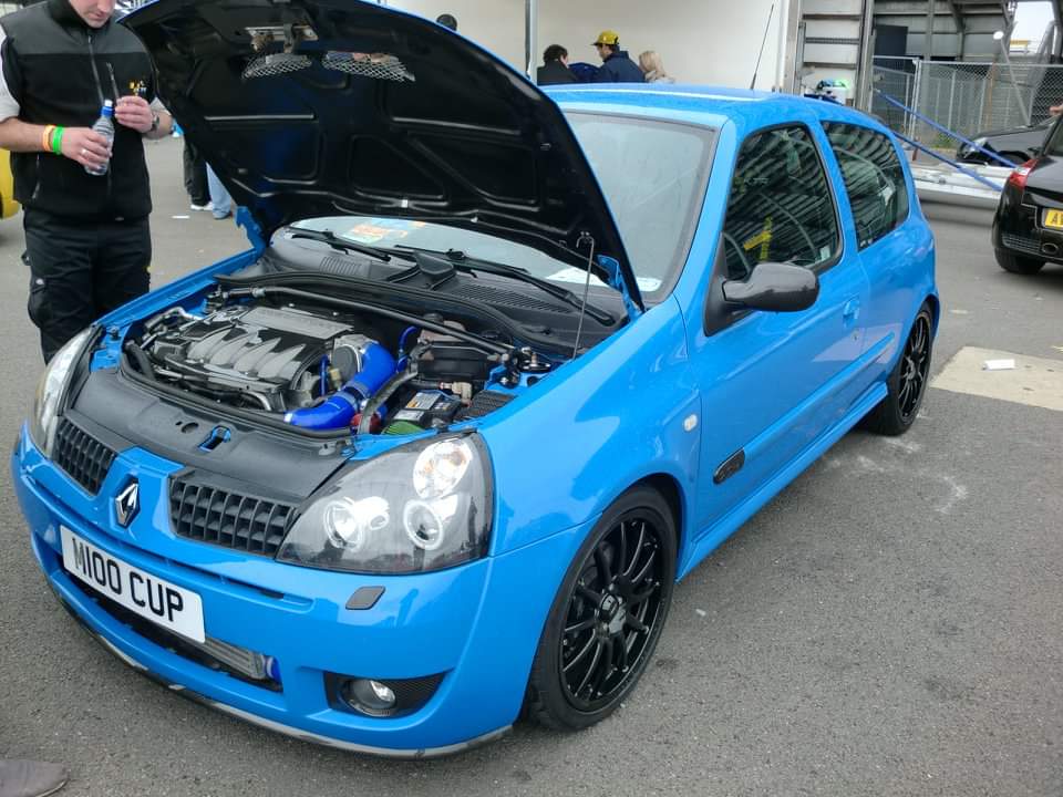

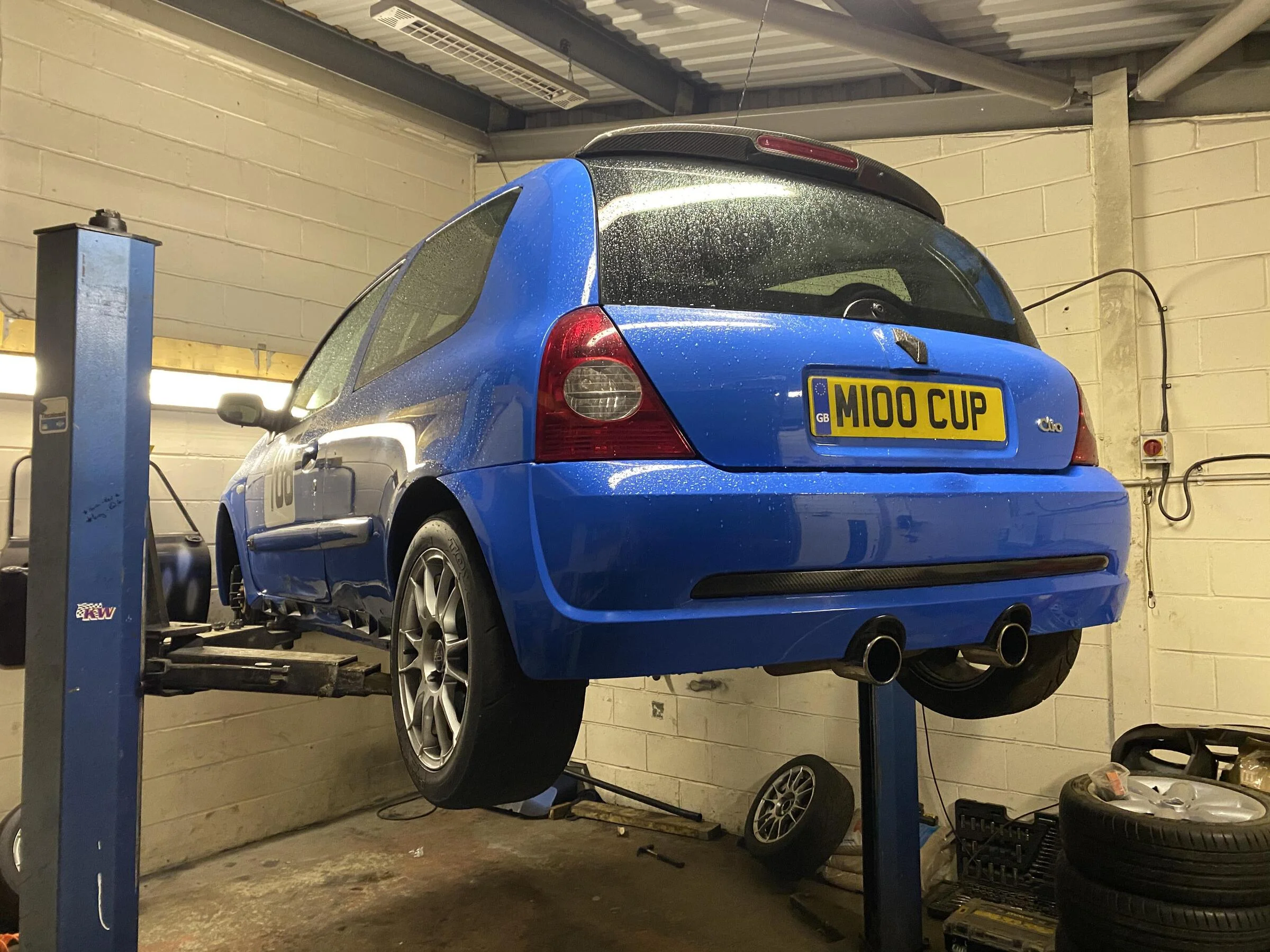

First thing I wanted to try to address this was fit lighter wheels. I know it should affect how the car steers but it did feel very odd in the heavy speedlines.
I had some TD1.2s with soft R888s so those went on.

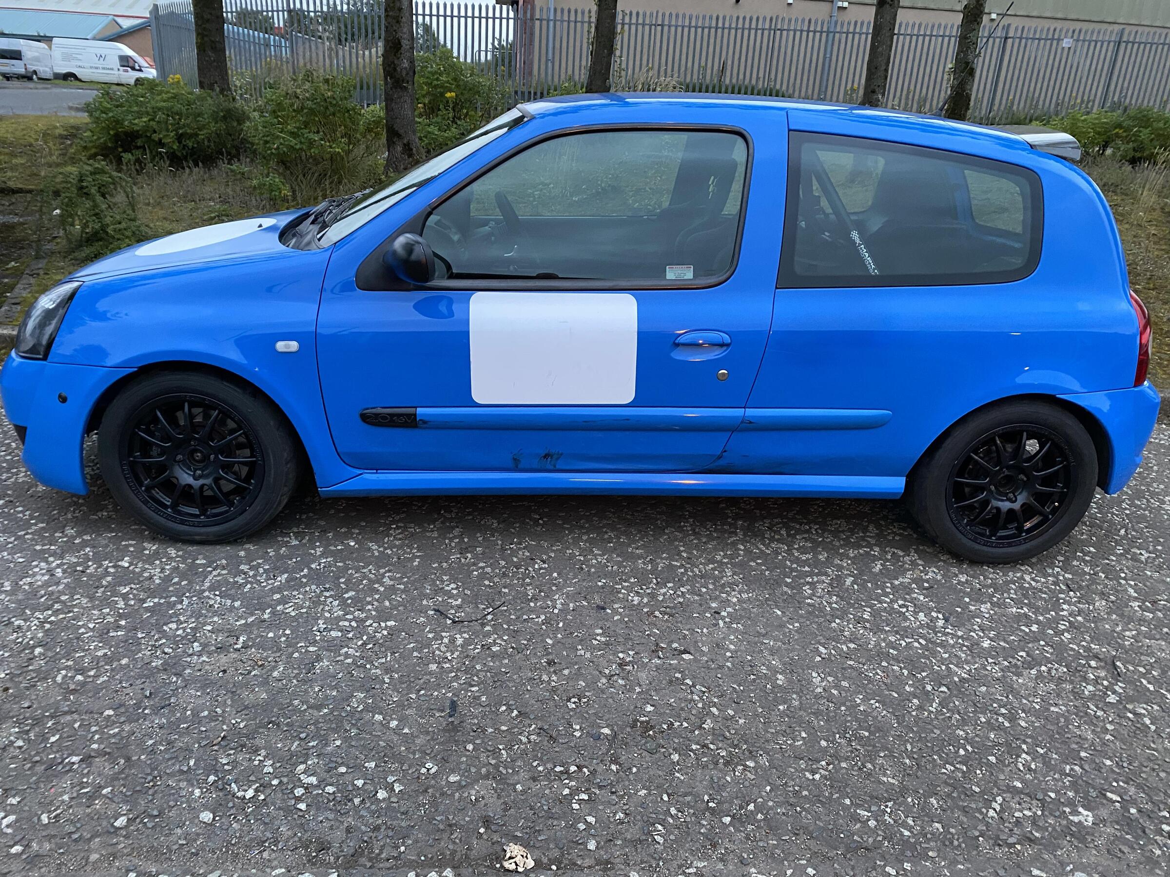

The car was already looking more aggressive with black wheels.
I then fitted a white line ARB which came up second hand locally. I know reviews are mixed on this. I made sure to drive the car on a test run before and after. The steering definitely feels a lot more neutral now.
The car is looking pretty decent underneath actually.
I also decided to remove the fog lights and carbon canister.

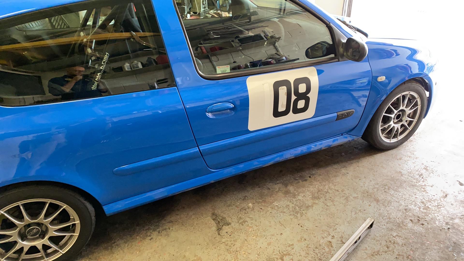

Next was to fit some door squares. I prefer my numbers like this. The car will only be used for sprints and hillclimbs so no point pretending it’s a road car.
Final step was to whip the carpets out and go to my next hillclimb. I had a great day and managed to take 2s off my best time in my old car at Forrestburn. Unfortunately with the level of competition in the A2 class I still finished last by 0.4s

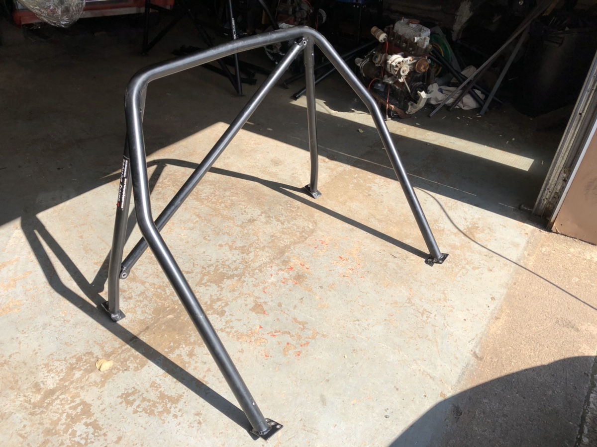

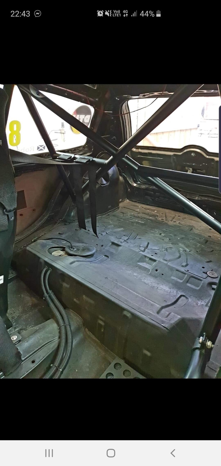

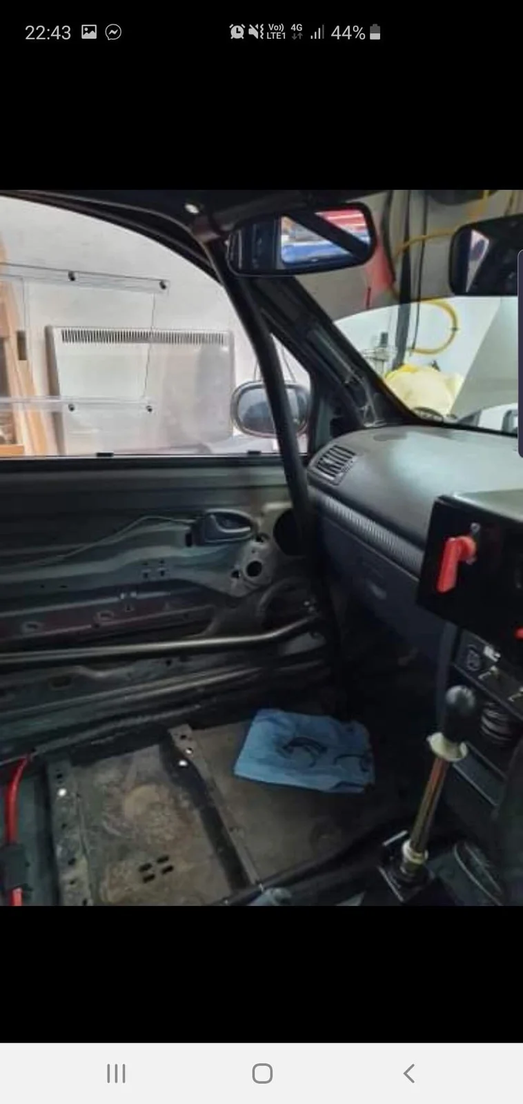

When I removed the carpets you could see the cage wasn’t designed for motorsport. Probably ok in most road applications but ideally I wanted something that has a harness bar and would keep me safe if the worst happened.
Luckily a local guy was breaking his track car with RO17 full cage at a decent price. So I’ve done a buy there and started installing it. To be honest I’ve very totally over the top as well (I did have a long weekend after all).

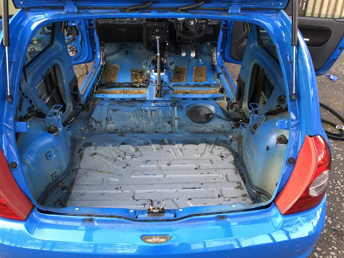

So as well at installing the cage I decided to strip as much weight as I am allowed out of the car. With the cutting and welding required had to remove a fair amount of the interior anyway.
Old cage out.
Interior stripped and some sound deadening removed.

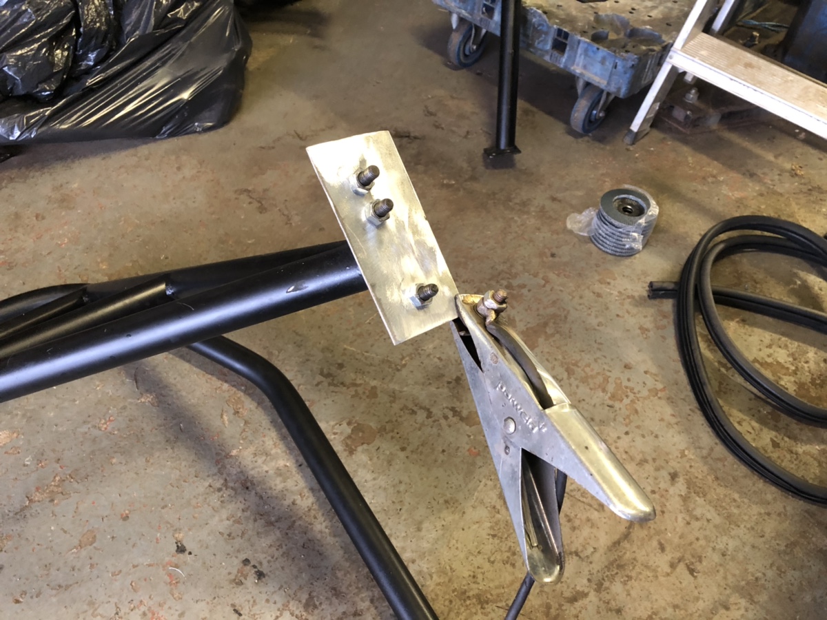

Started fabricating the 3mm steel spreader plates.
And that’s as far as I got. The plan is to finish the job this weekend. Fab up and weld into the car.
Finally I’ll be painting the full floor and boot racing blue to tidy it all up. Progress pics to follow.

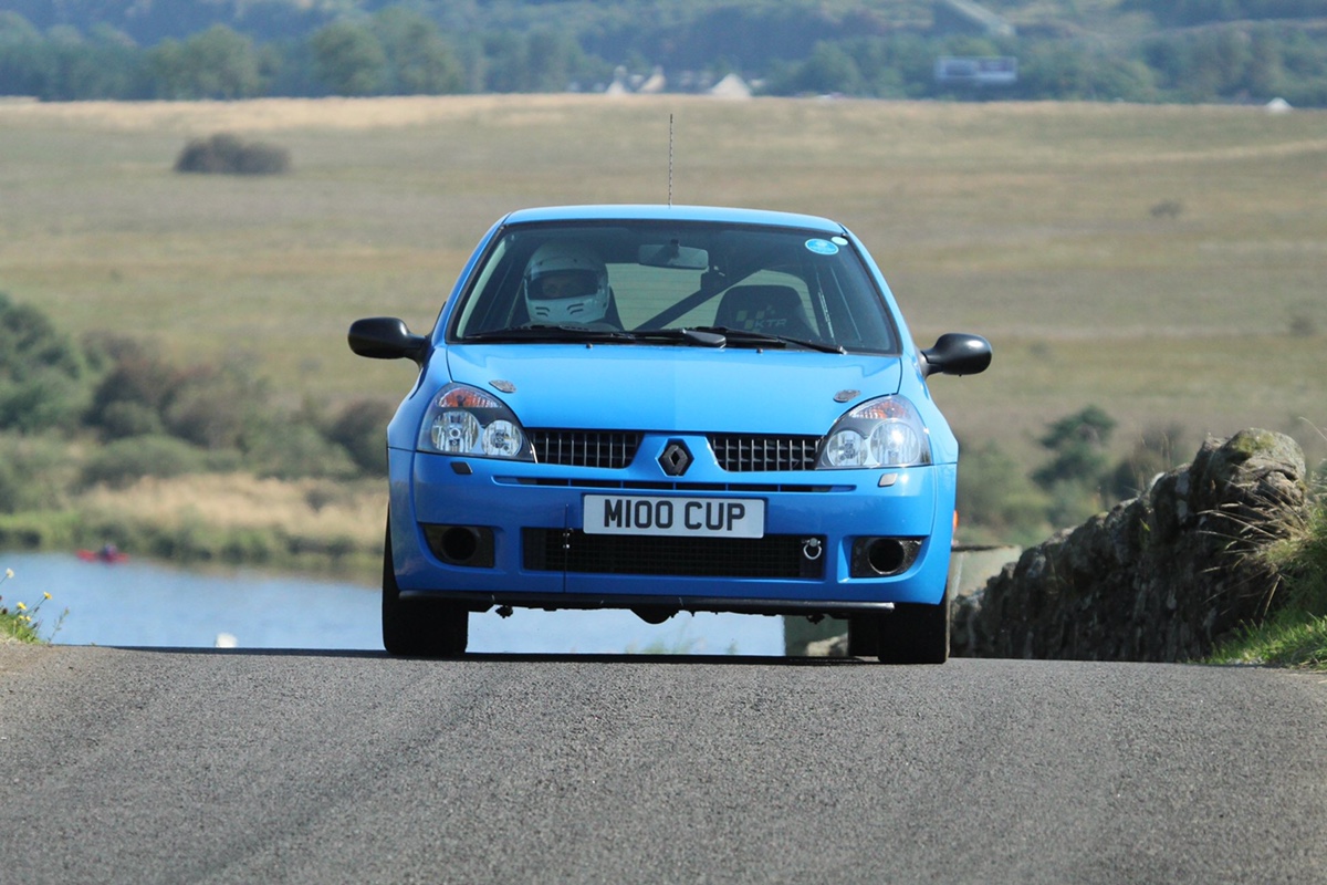

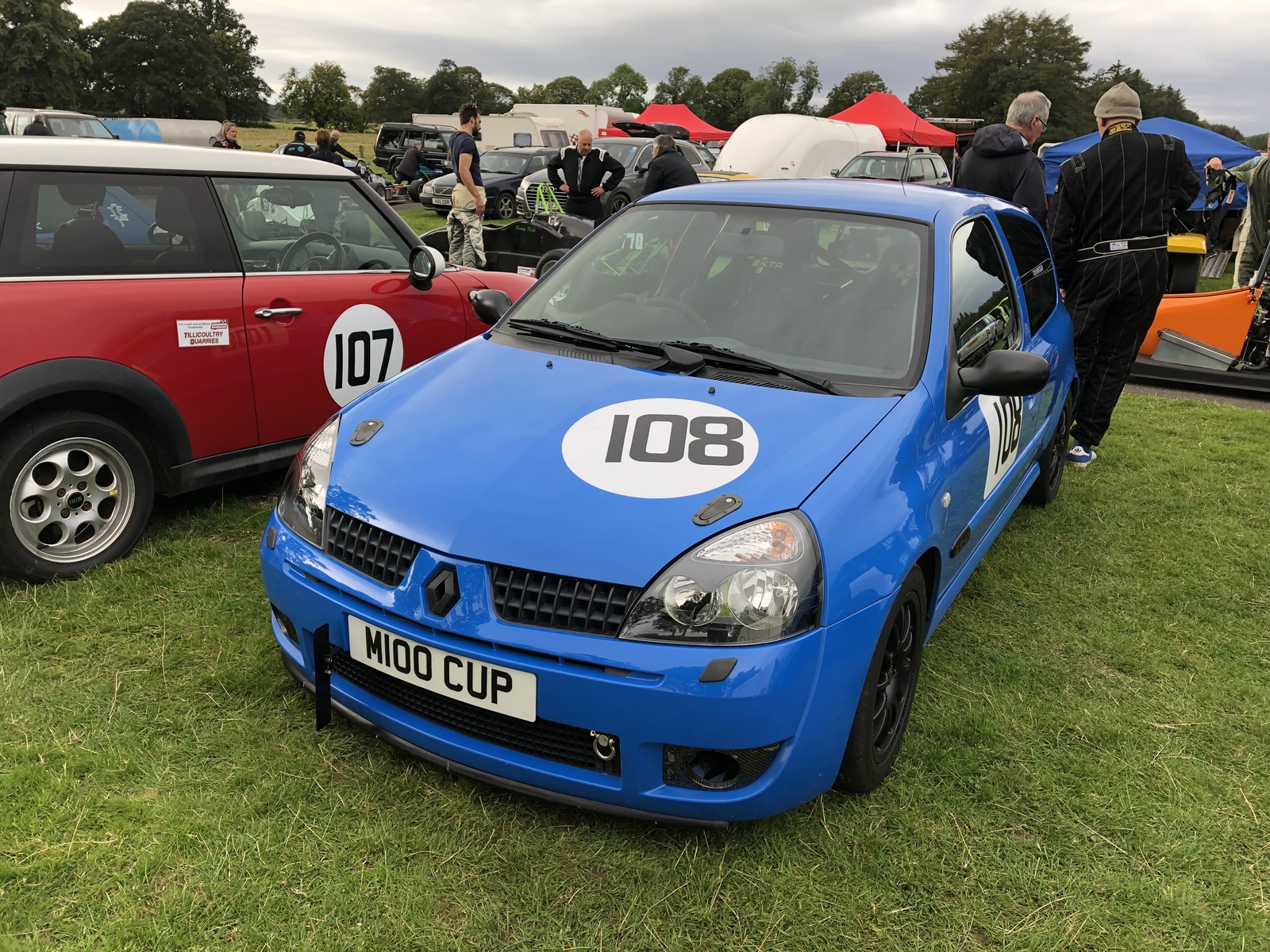

So quite a big update for this. I’ve been holding off posting this since mid September as I wanted to make sure of the direction I was going with the car before sharing.

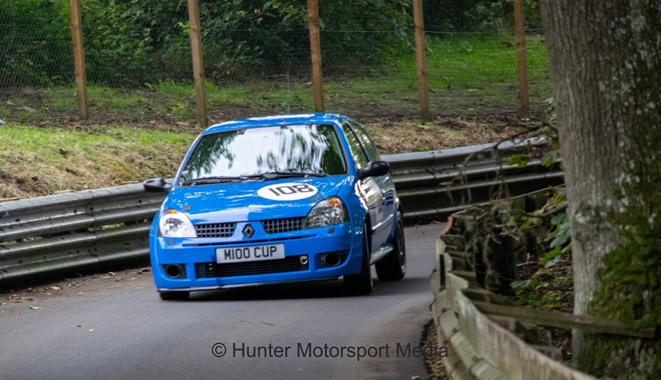

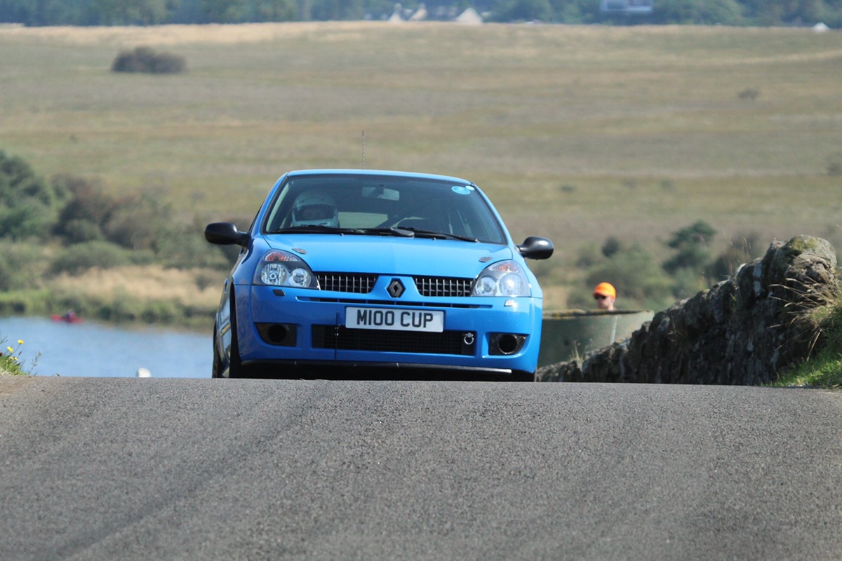

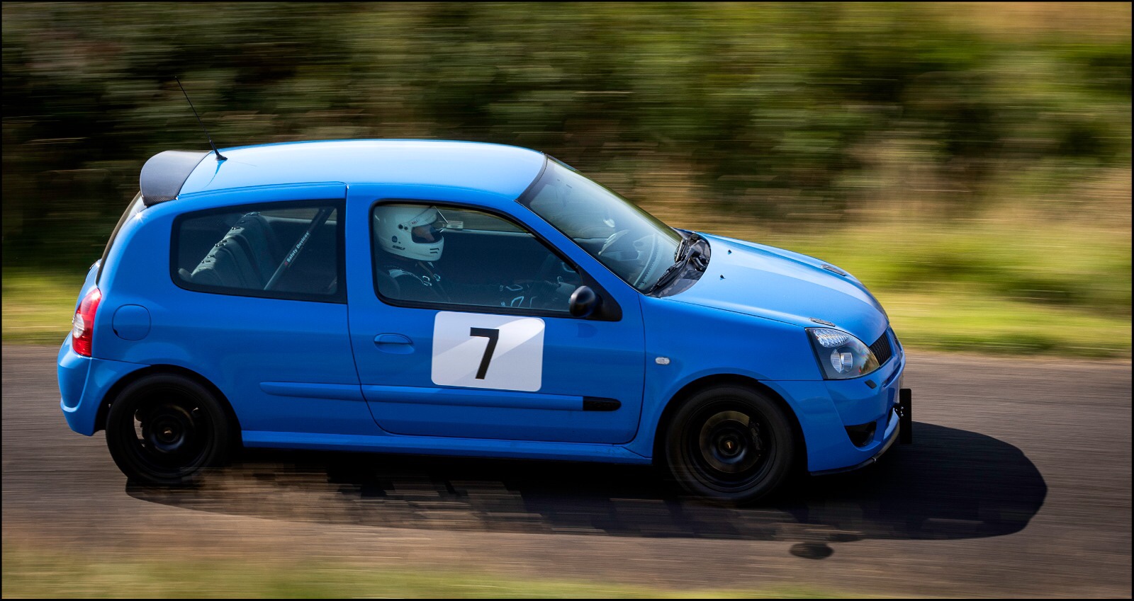

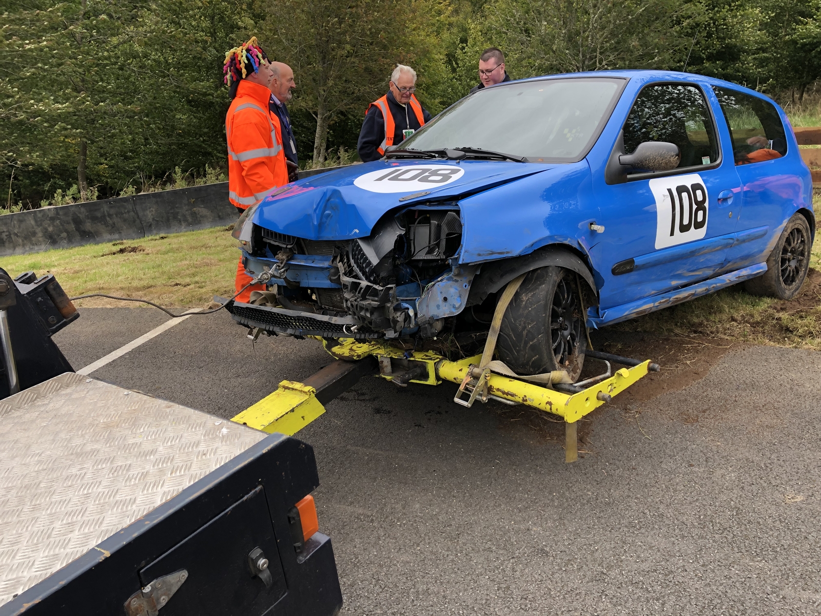

14th sept. First time at doune. Arrived the Saturday morning for the final Doune of the year and my first time. I was really excited, this place has a reputation for being the best in the calendar. Plus with it being a round of the British championship there were some really quick cars there.
I was in the road going under 2.0l class with some other clios. Photo from the paddock.

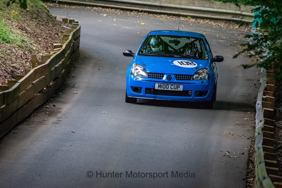

Some others courtesy of Paul Hunter and his better half.
And finally how I ended the day. Touching the grass into meadow I was fighting oversteer and then understeer into east brae and went through the wooden barrier. I’ll post the videos up just now which are quite dramatic.
Thankfully I was ok and walked away with just a sore neck. My initial thoughts were that the car would be totalled. But taking the car home and getting a good look under it the damage wasn’t too bad. Total damage as follows.
Obviously bumper bonnet wings and headlights.

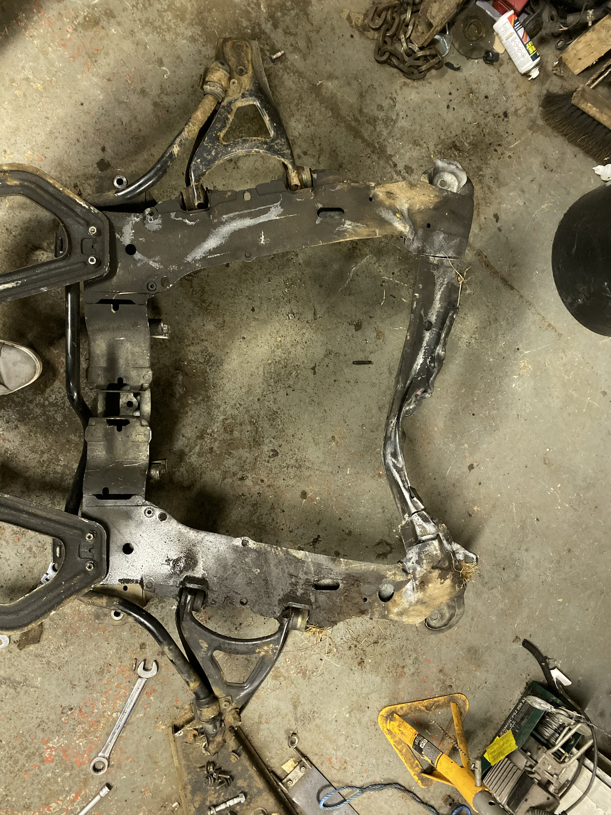

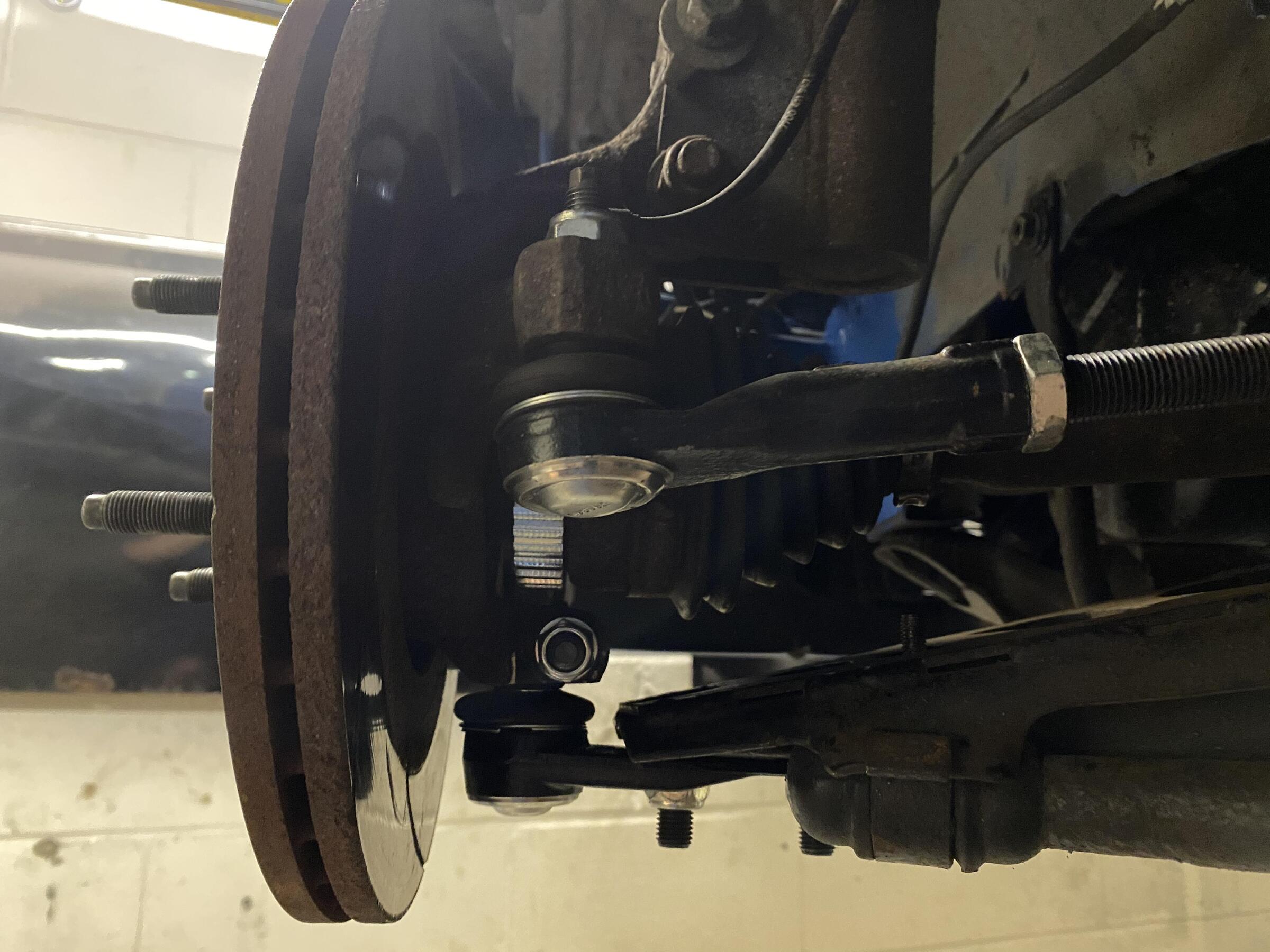

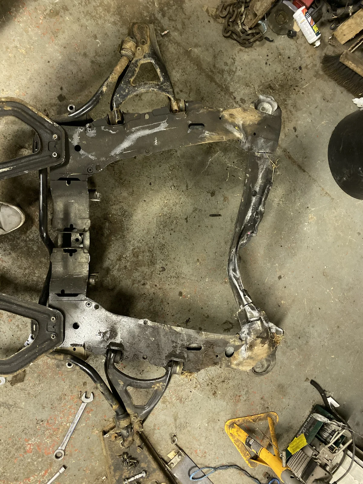

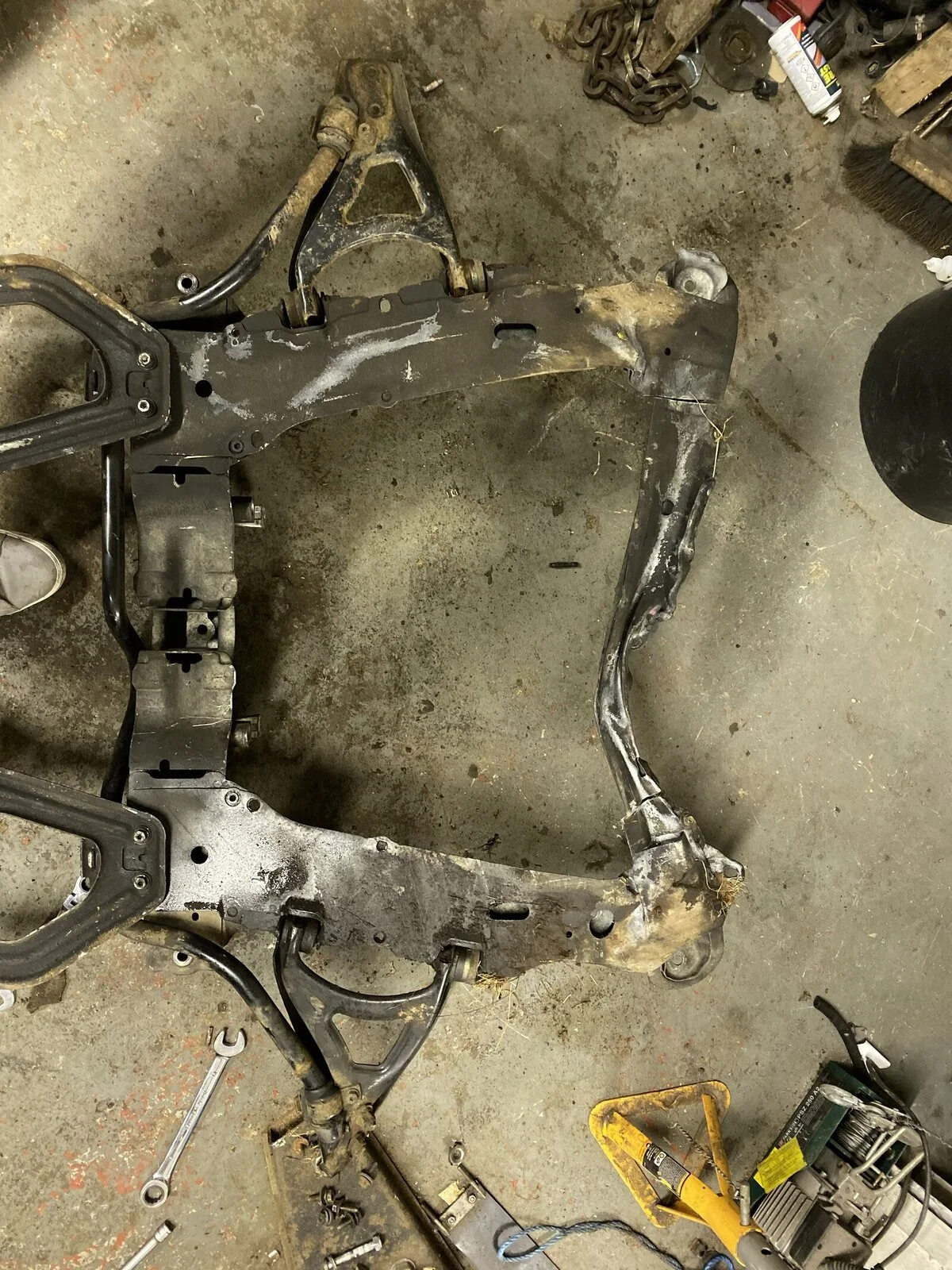

Subframe was bent.
Rad burst in half
Chassis legs were ok but the very fronts were crumpled.

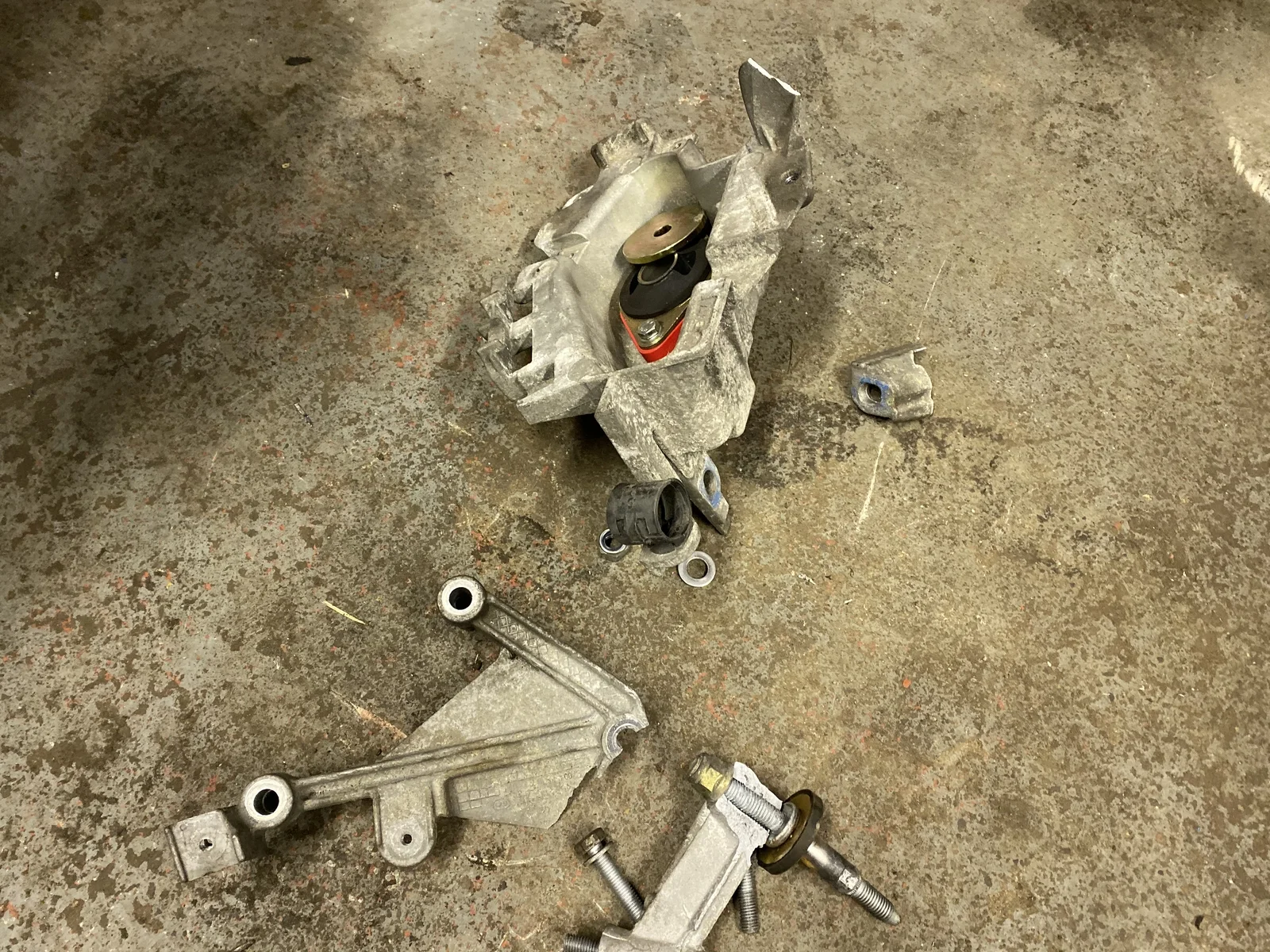

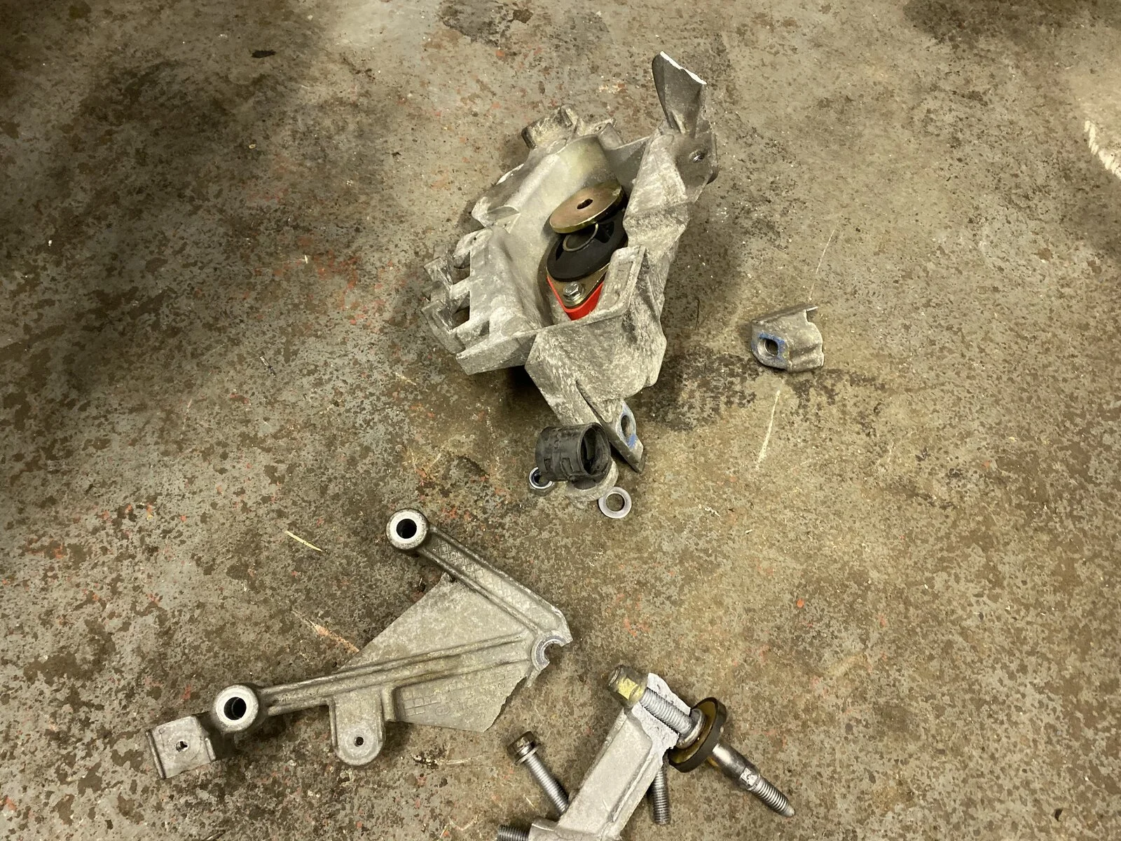

Engine mounts cracked.

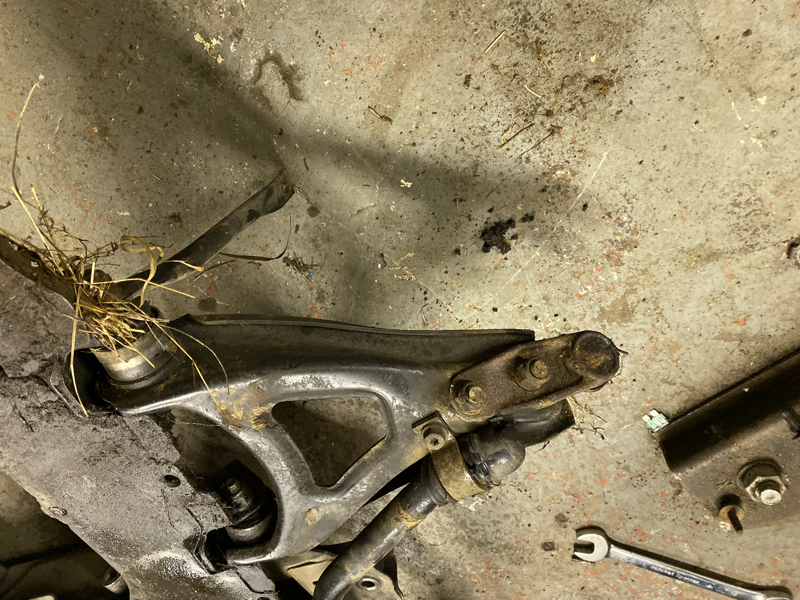

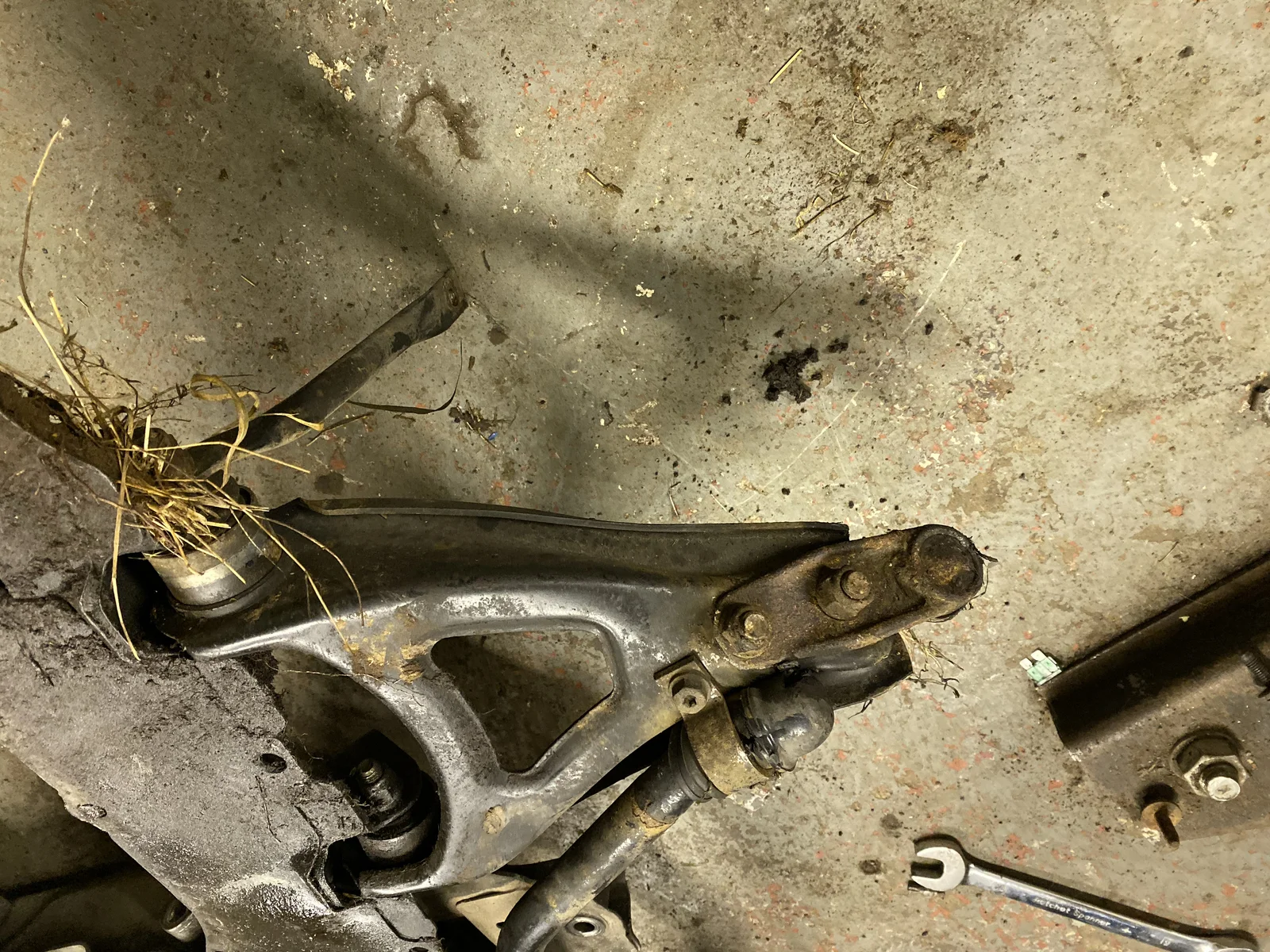

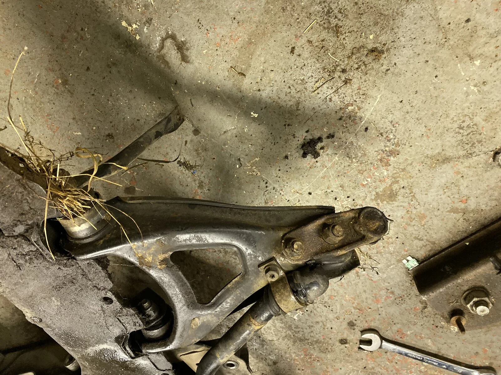

Bottom balljoint snapped
Steering arms bent.
One of the allow wheels were cracked.

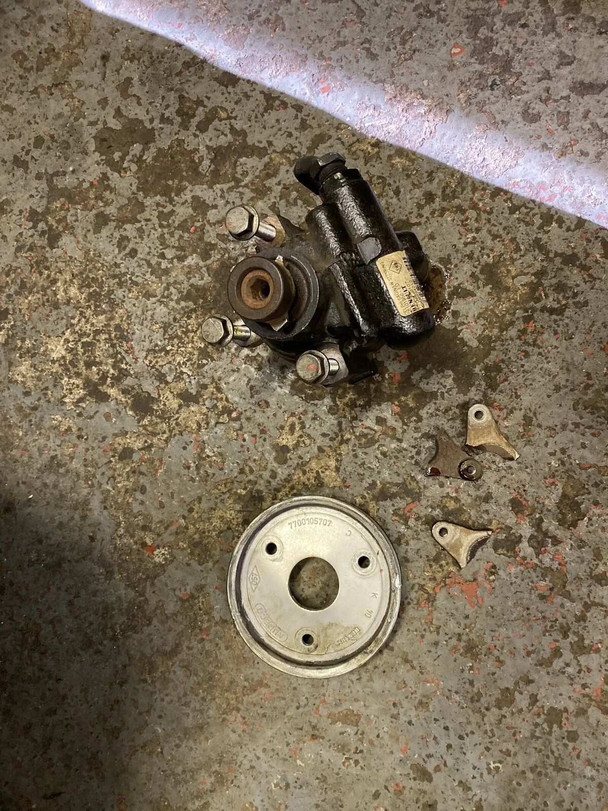

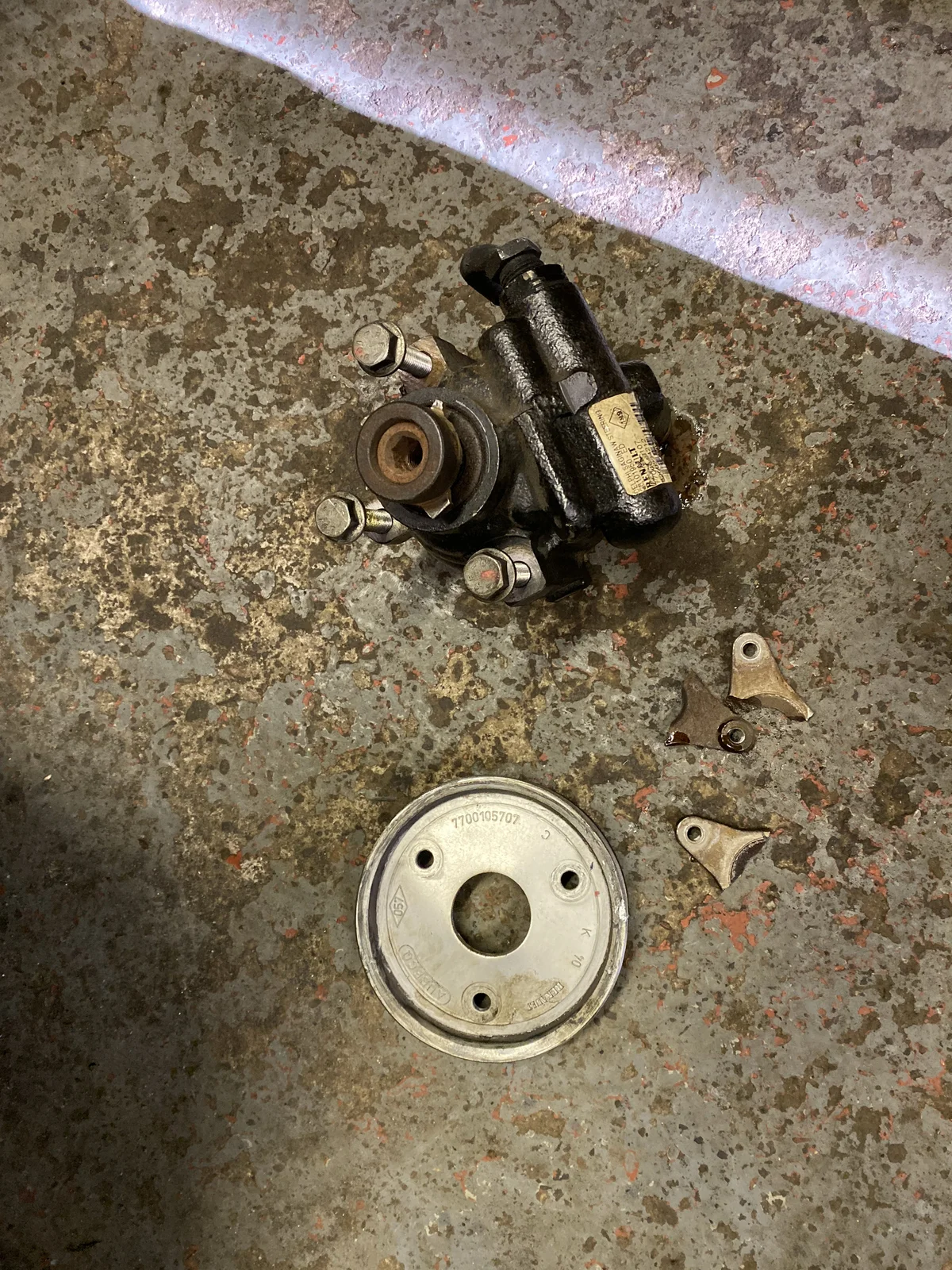

Power steering pump cracked.

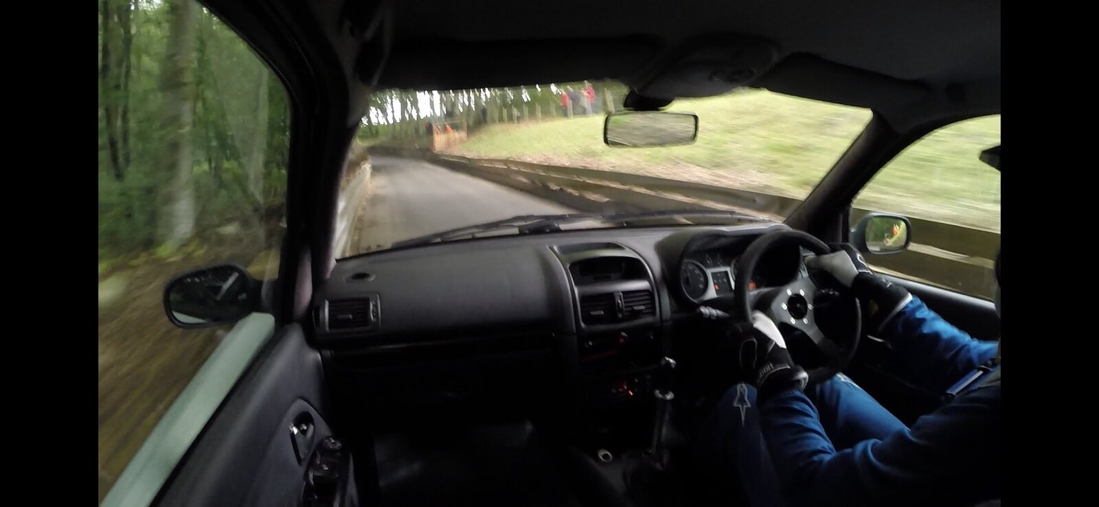

And the in car from the crash.
And the external footage.
Dramatic I think is the word. If you listen carefully you can hear at the end I’ve properly s**t my pants.

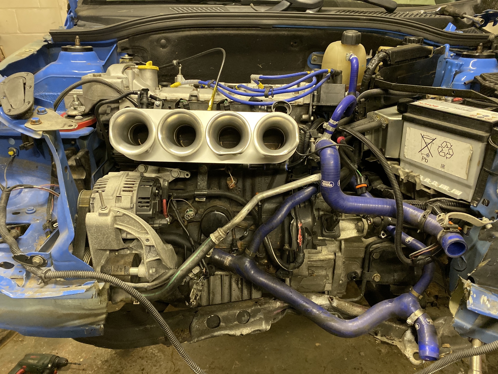

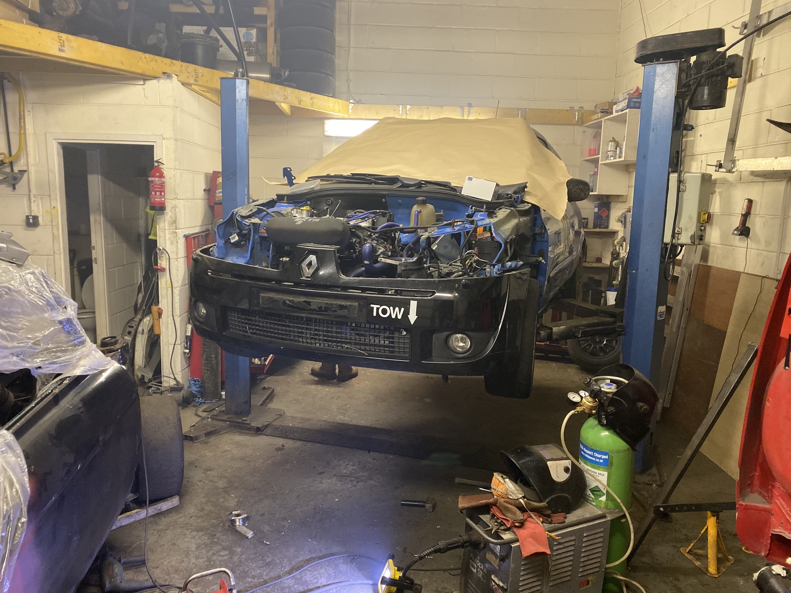

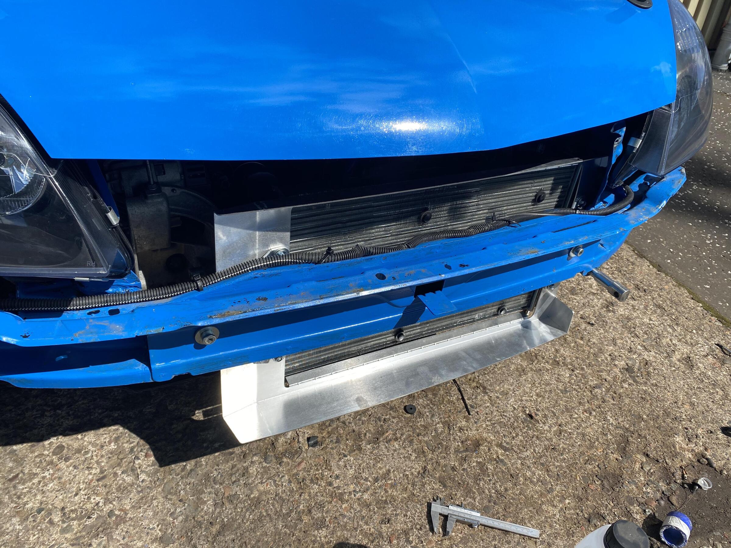

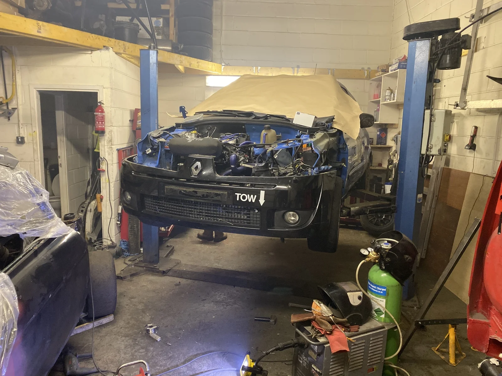

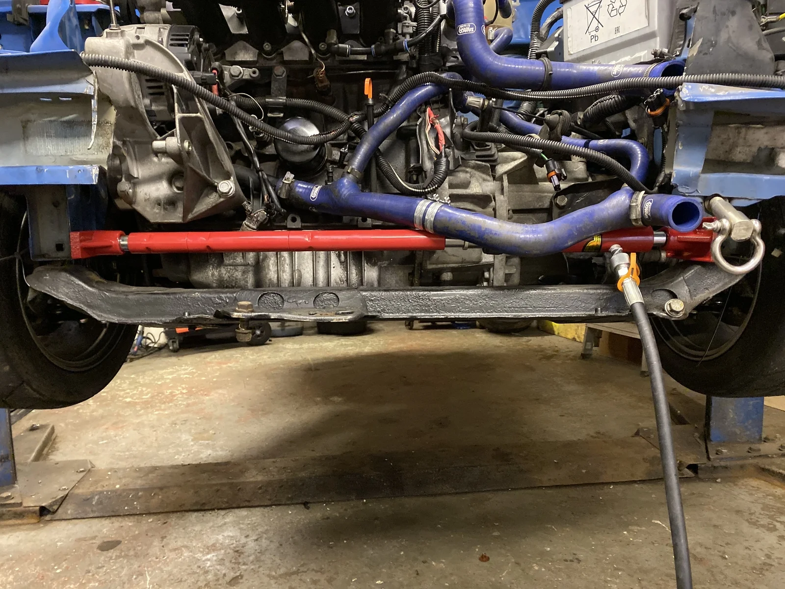

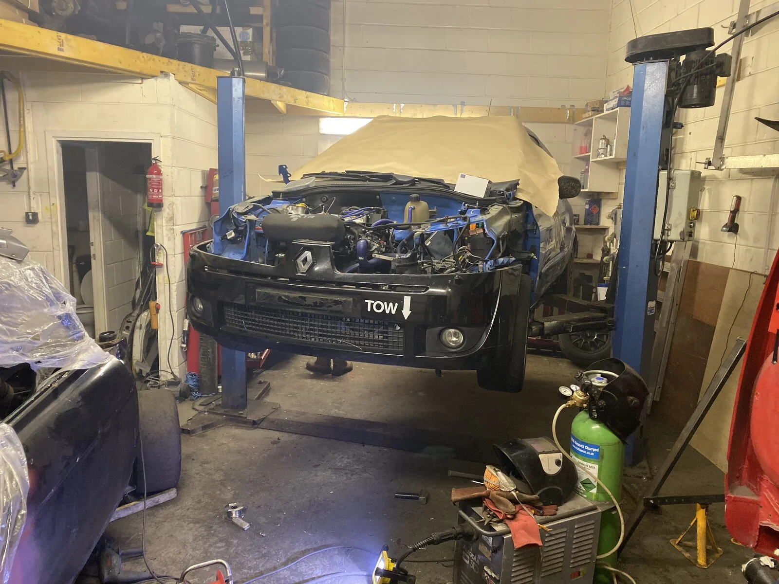

And now onto the rebuild. With the clio being so clean beforehand. I was pretty determined to rebuild the original shell if I could.
Another RB shell did come up local though. So I have bought that with two things in mind. Best case I could use the wings and bonnet. Worst case I could take all the good bits and resemble.

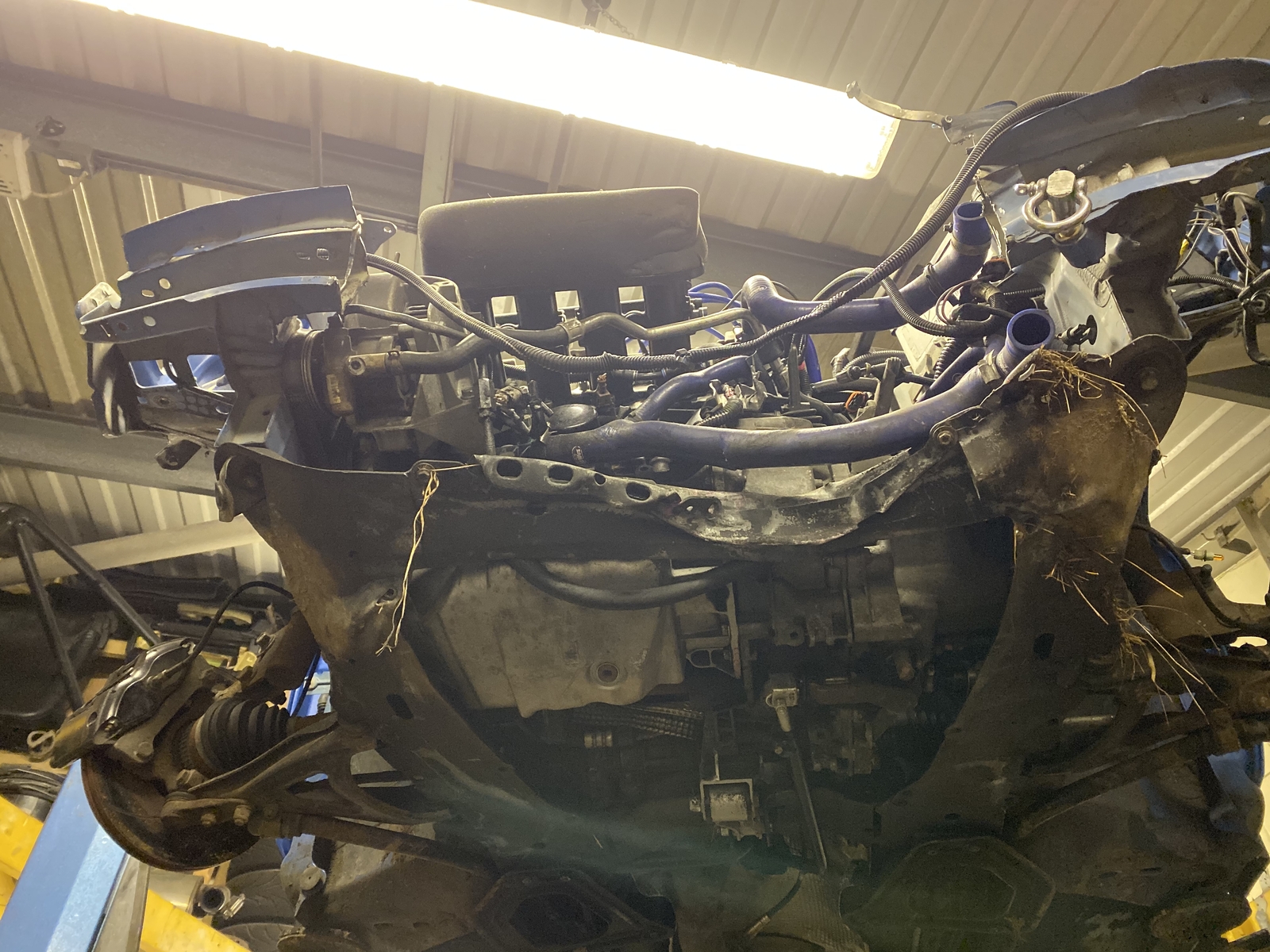

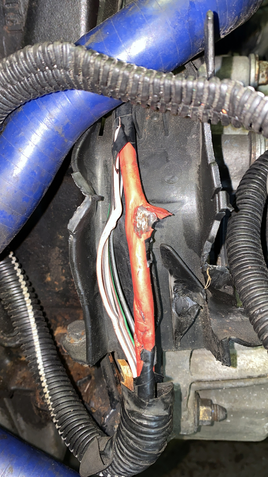

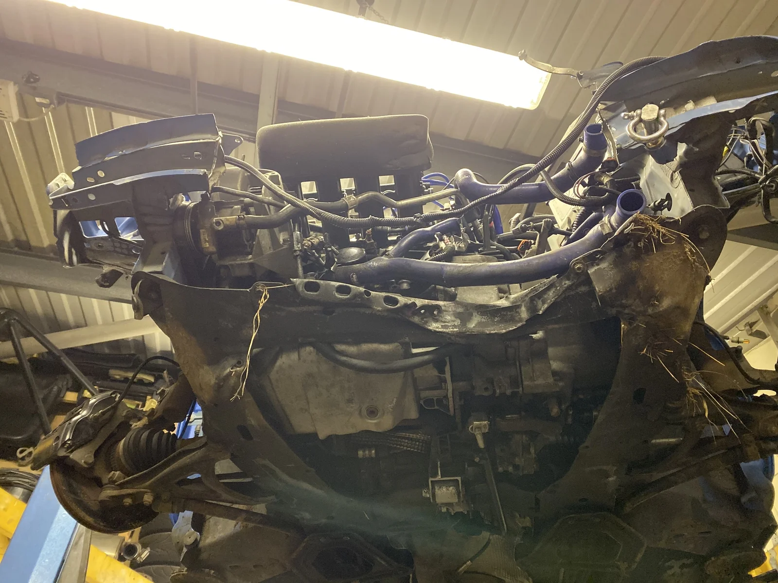

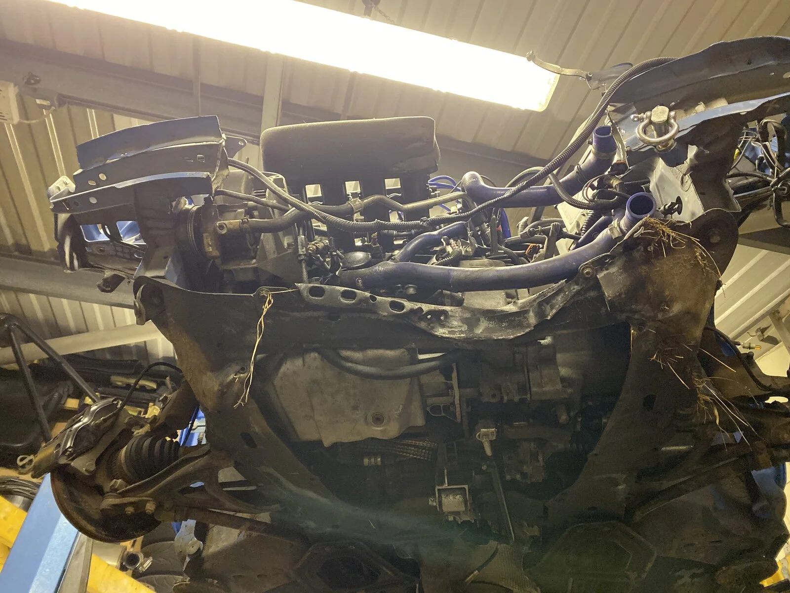

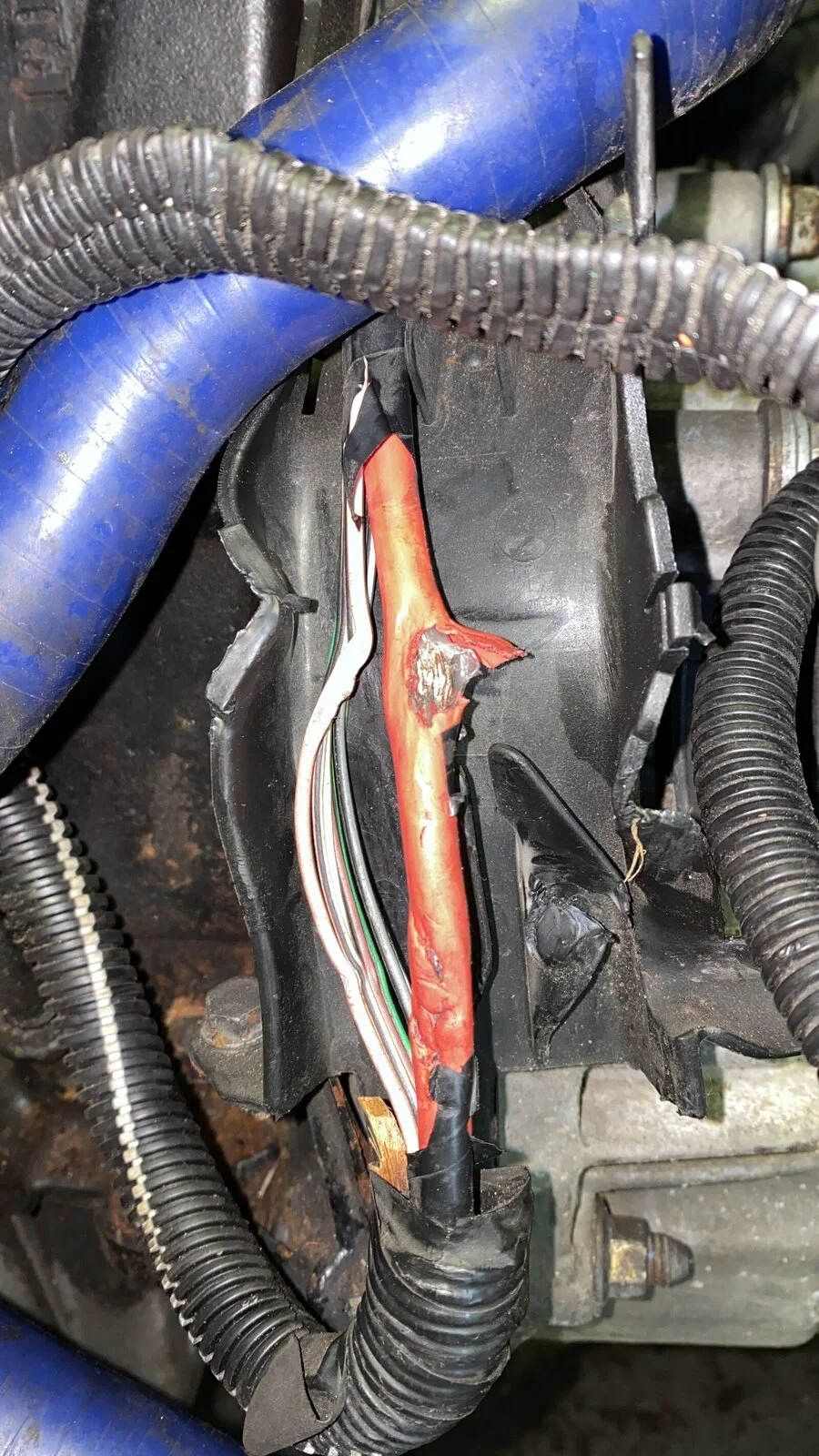

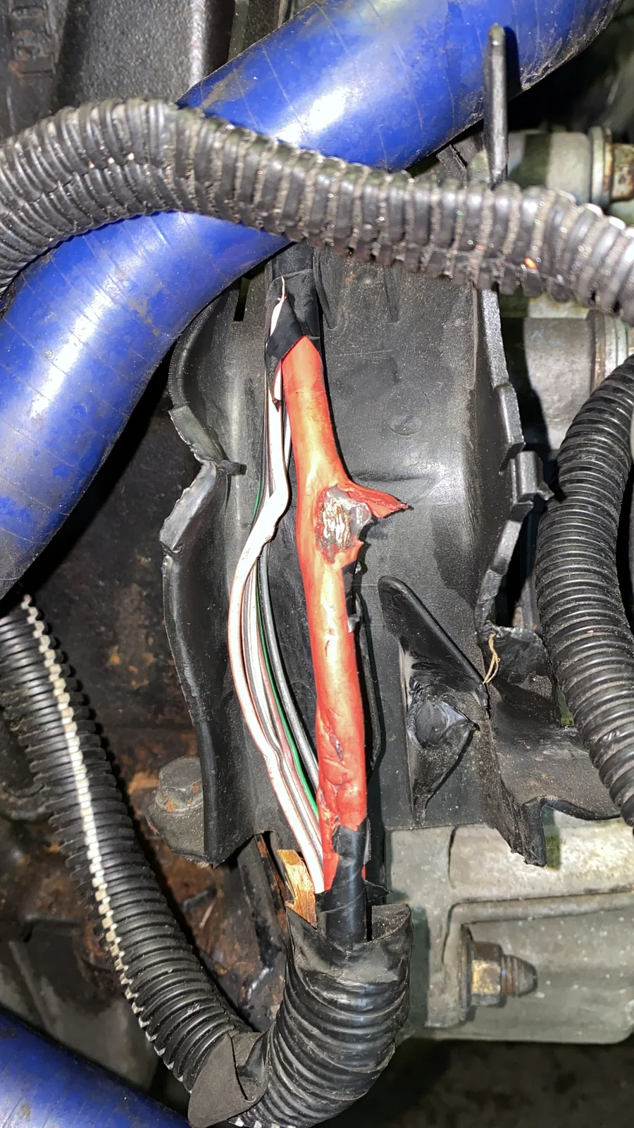

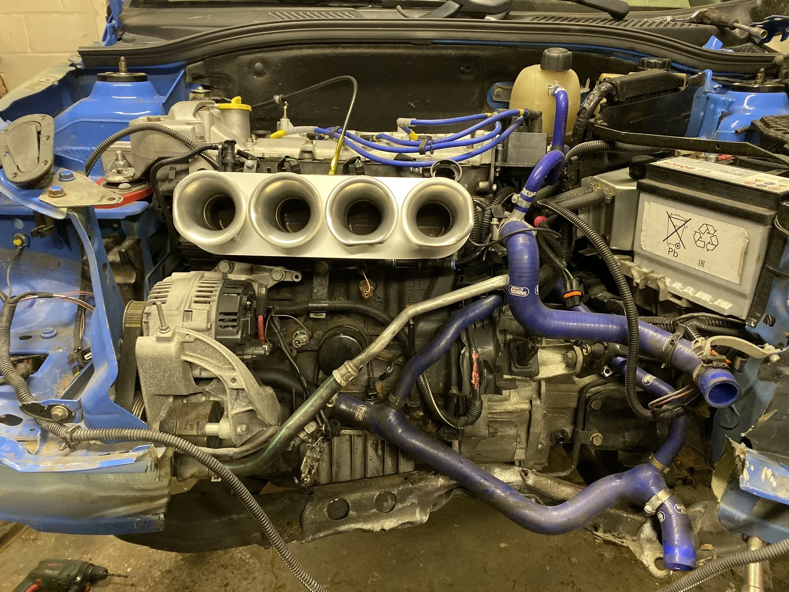

As I started taken the damaged bits off. I was surprised how little major chassis damage there was.
Once I knew there was no real spring / tension I cut the crash bar off.

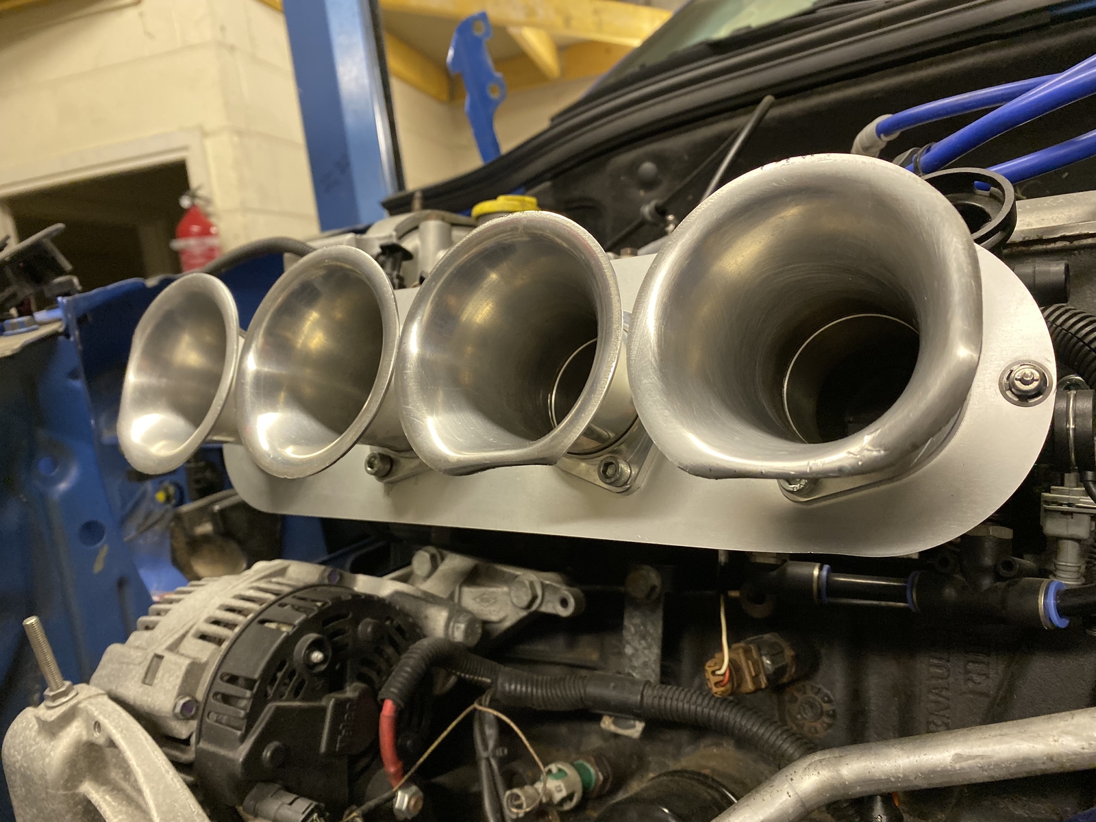

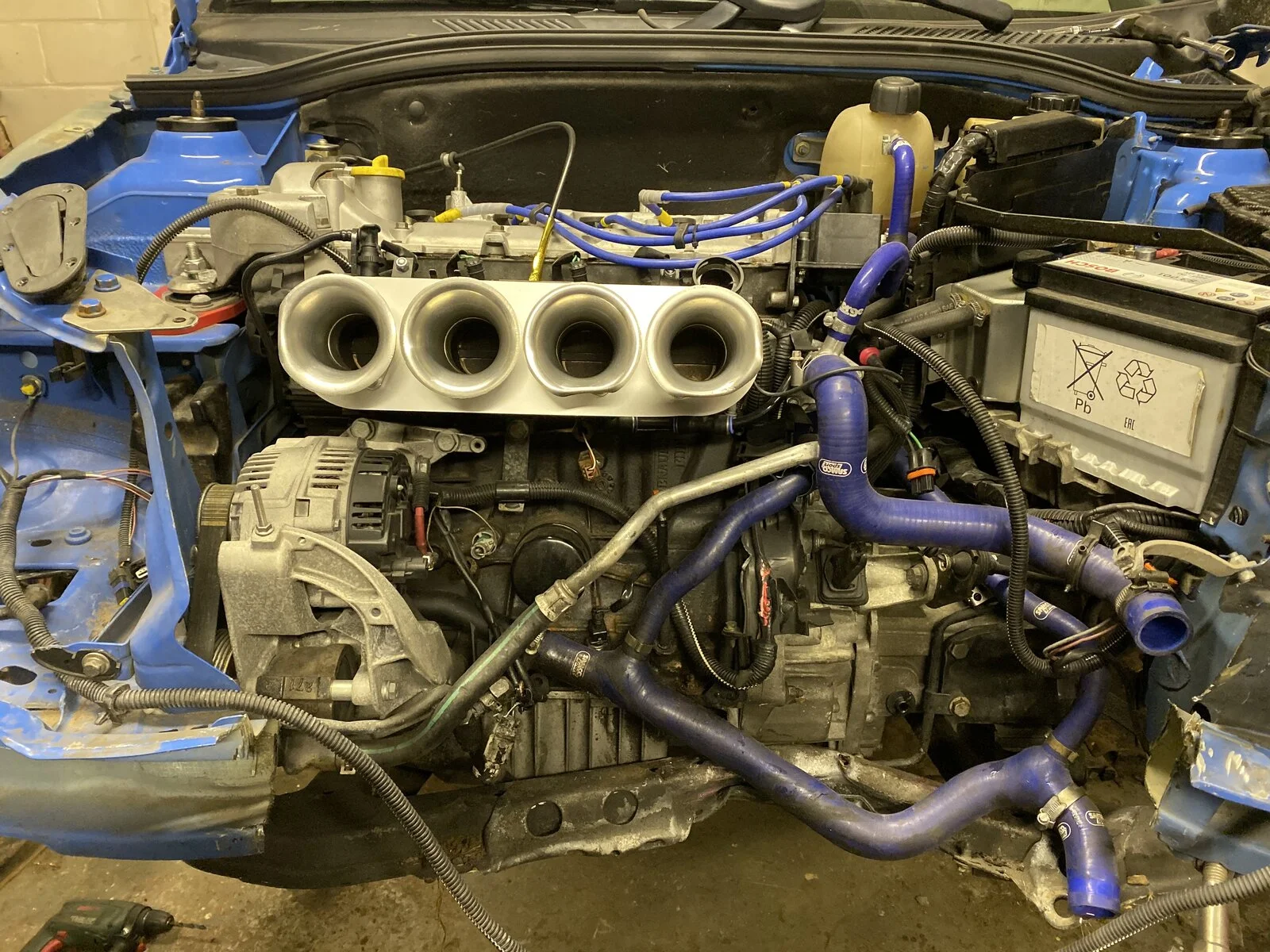

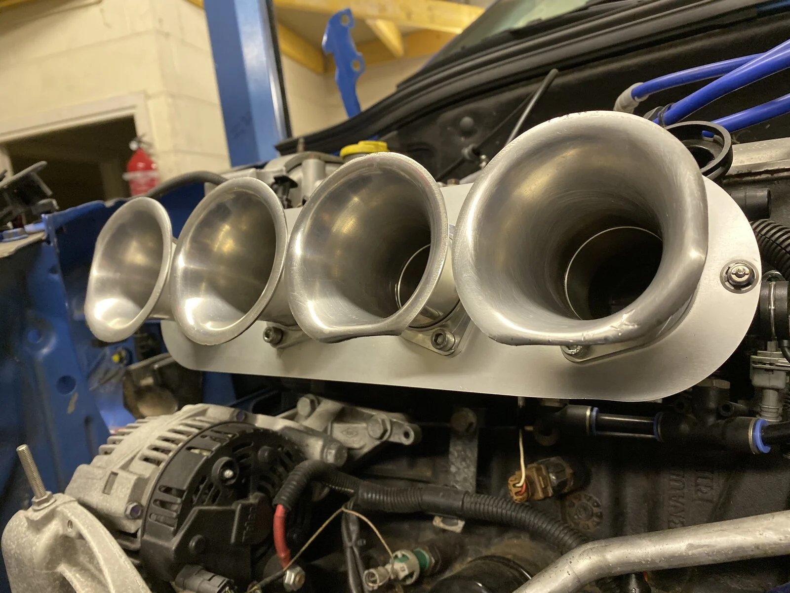

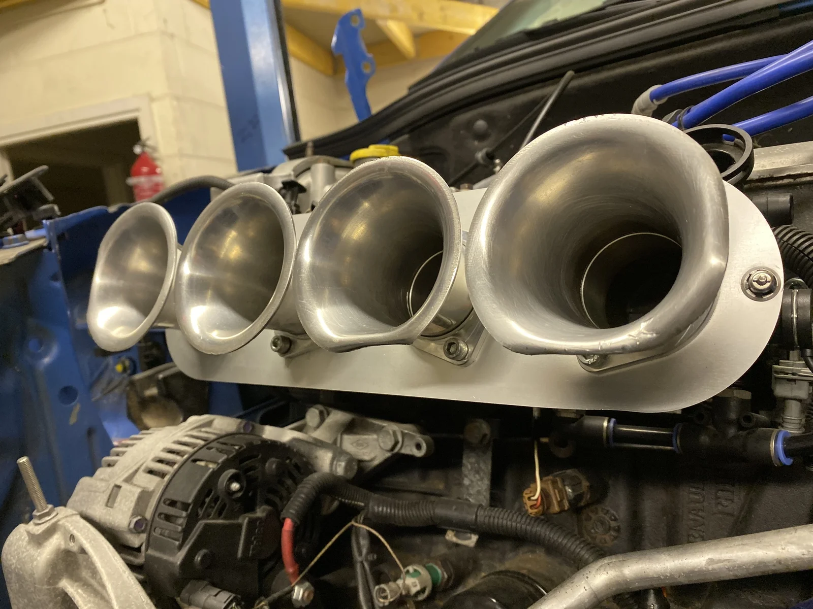

Also very lucky the ITBs escaped without any real damage.

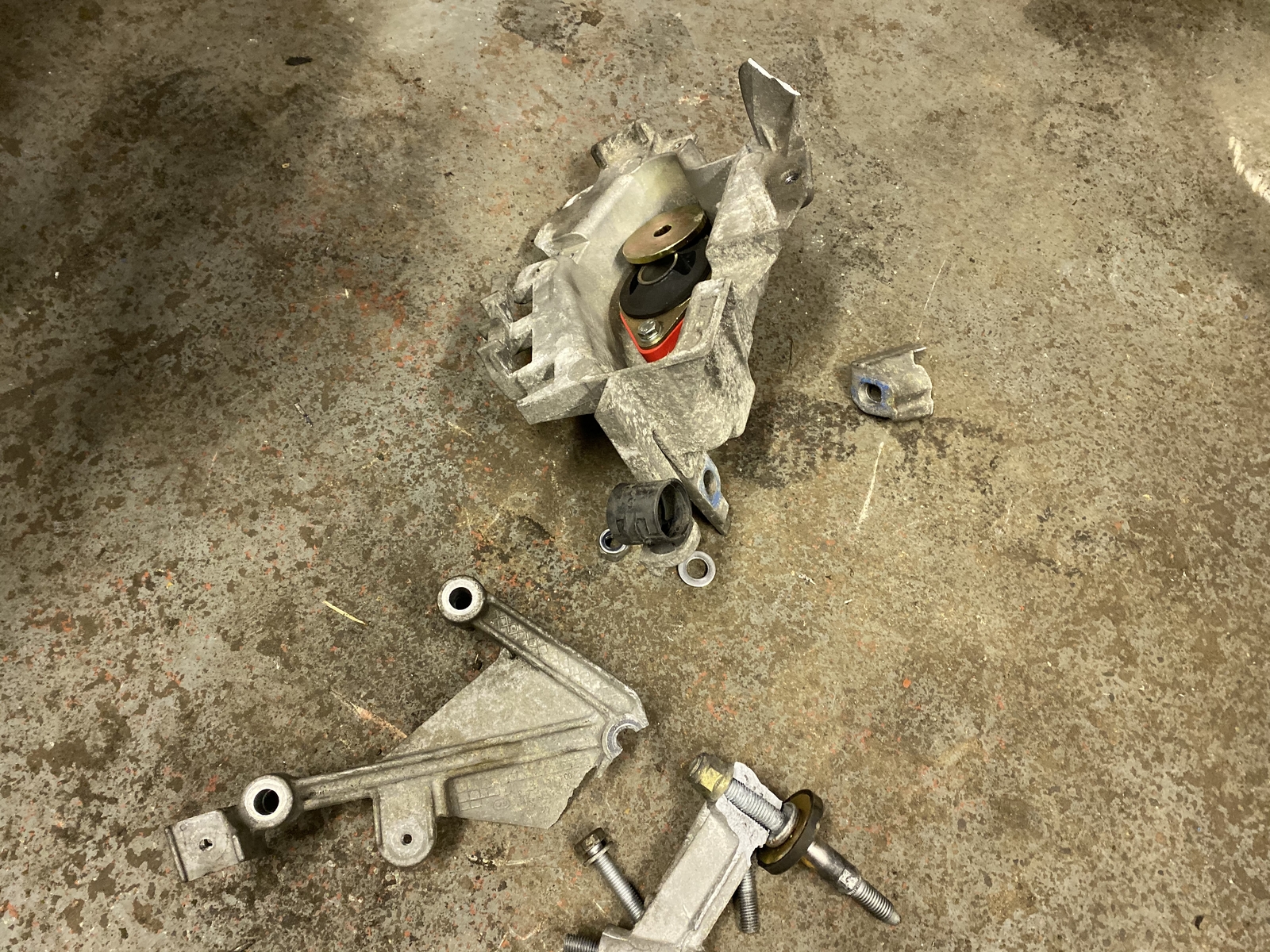

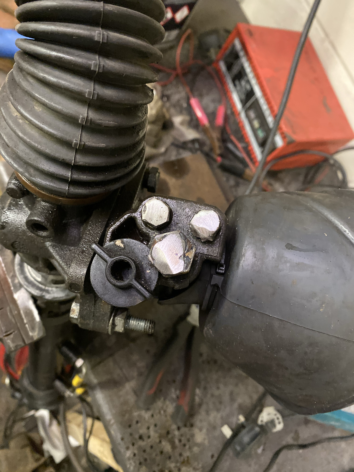

Engine mounts in bits. I think the fact that I hit the post right in the middle and these alloy cast items cracked stopped more potential damage.

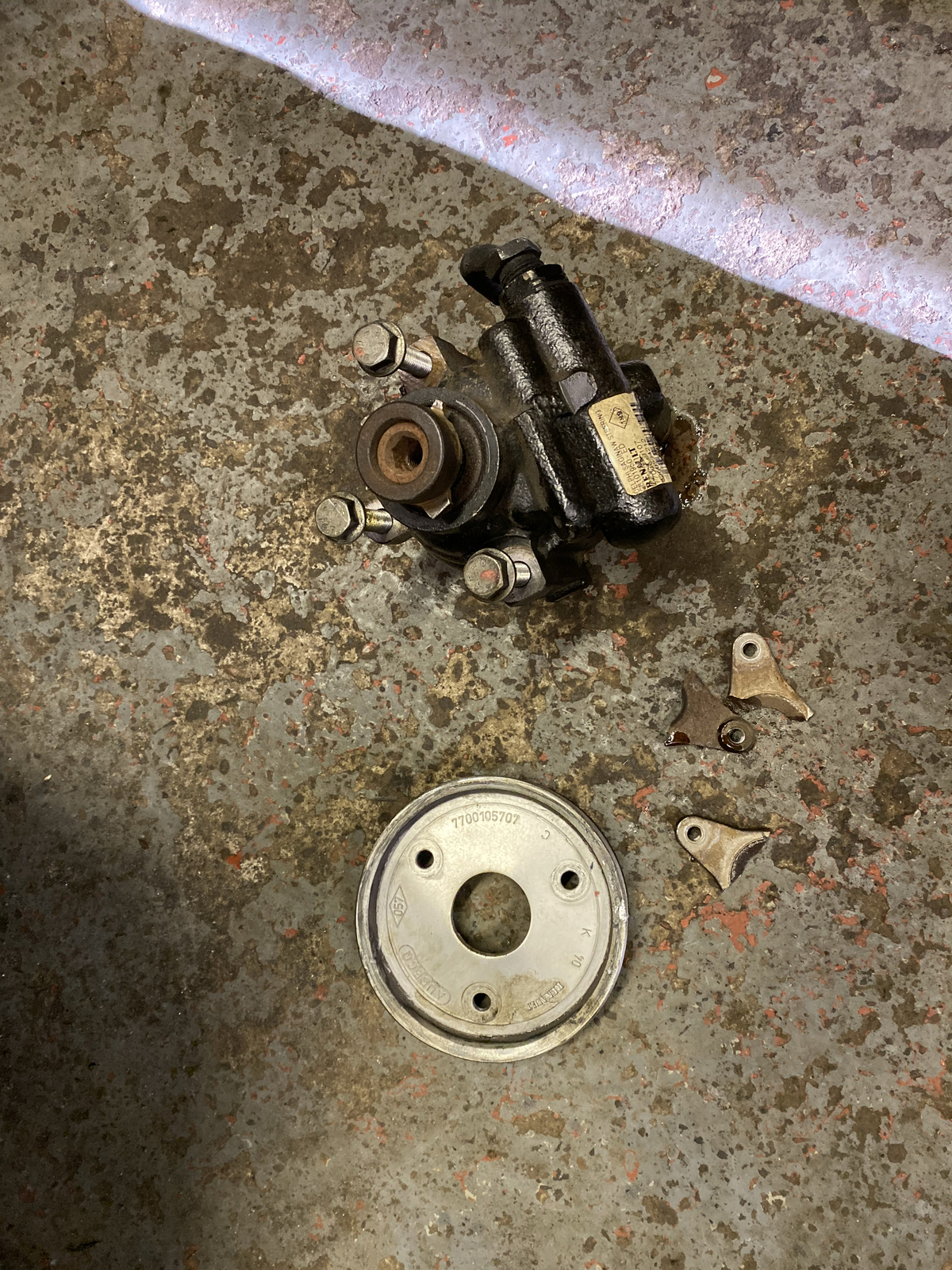

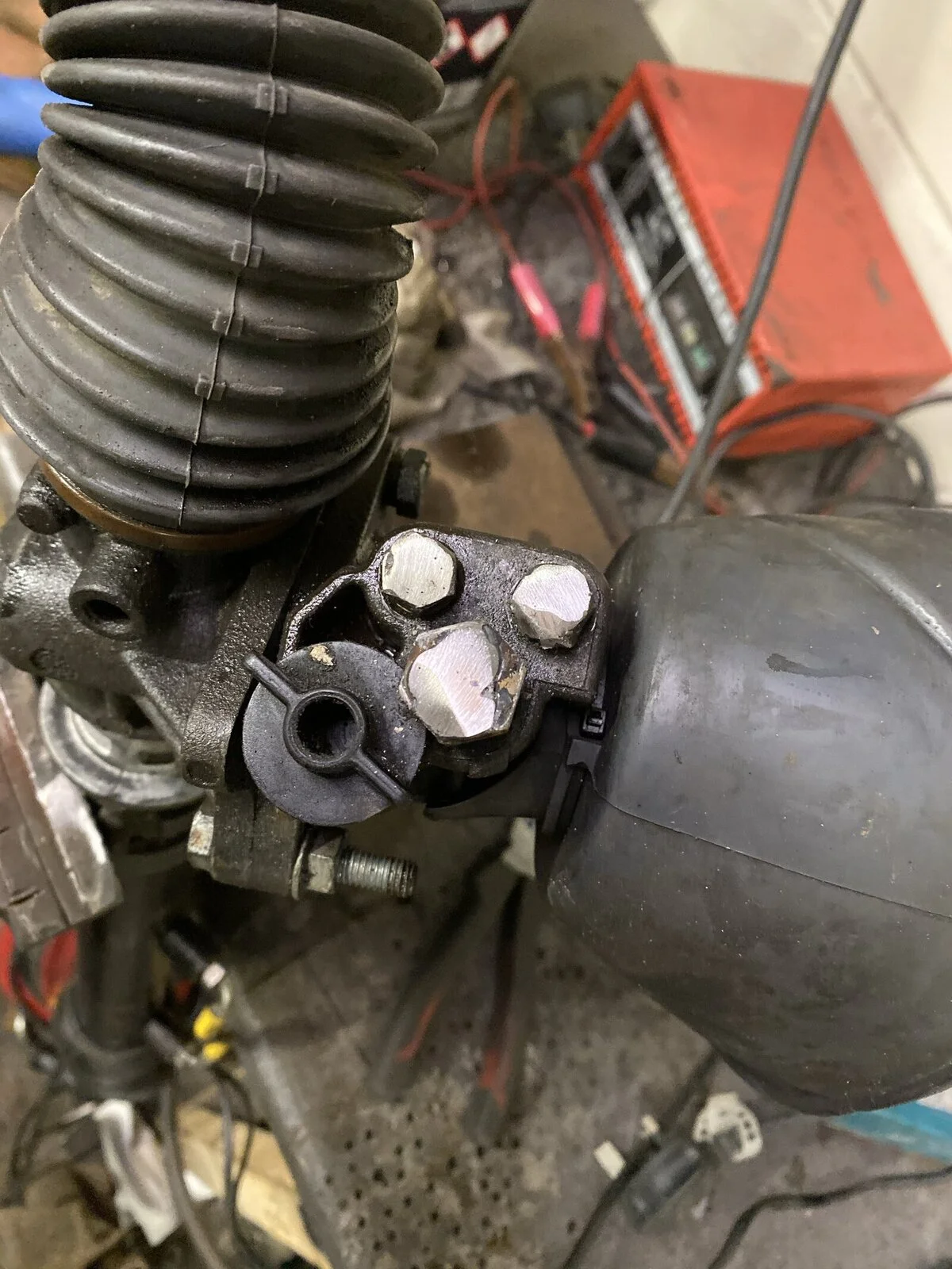

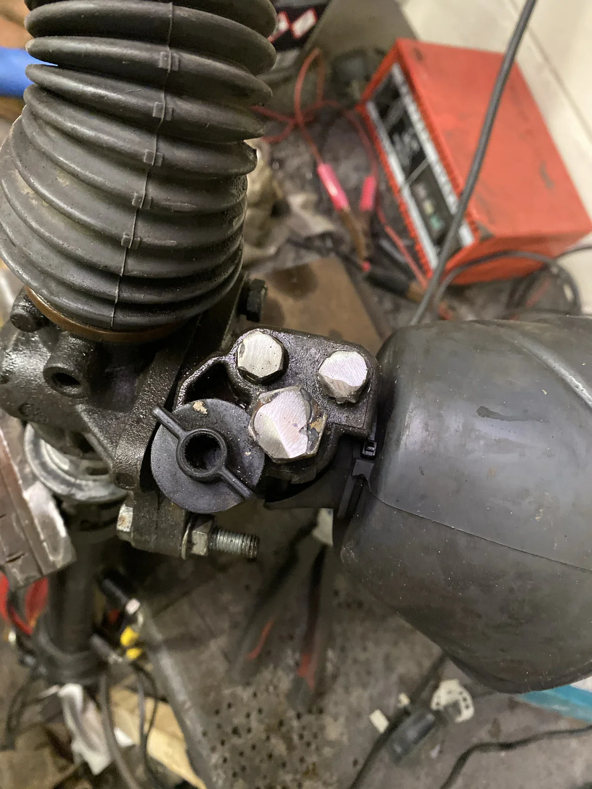

Power steering pump pulley mountings were all cracked.

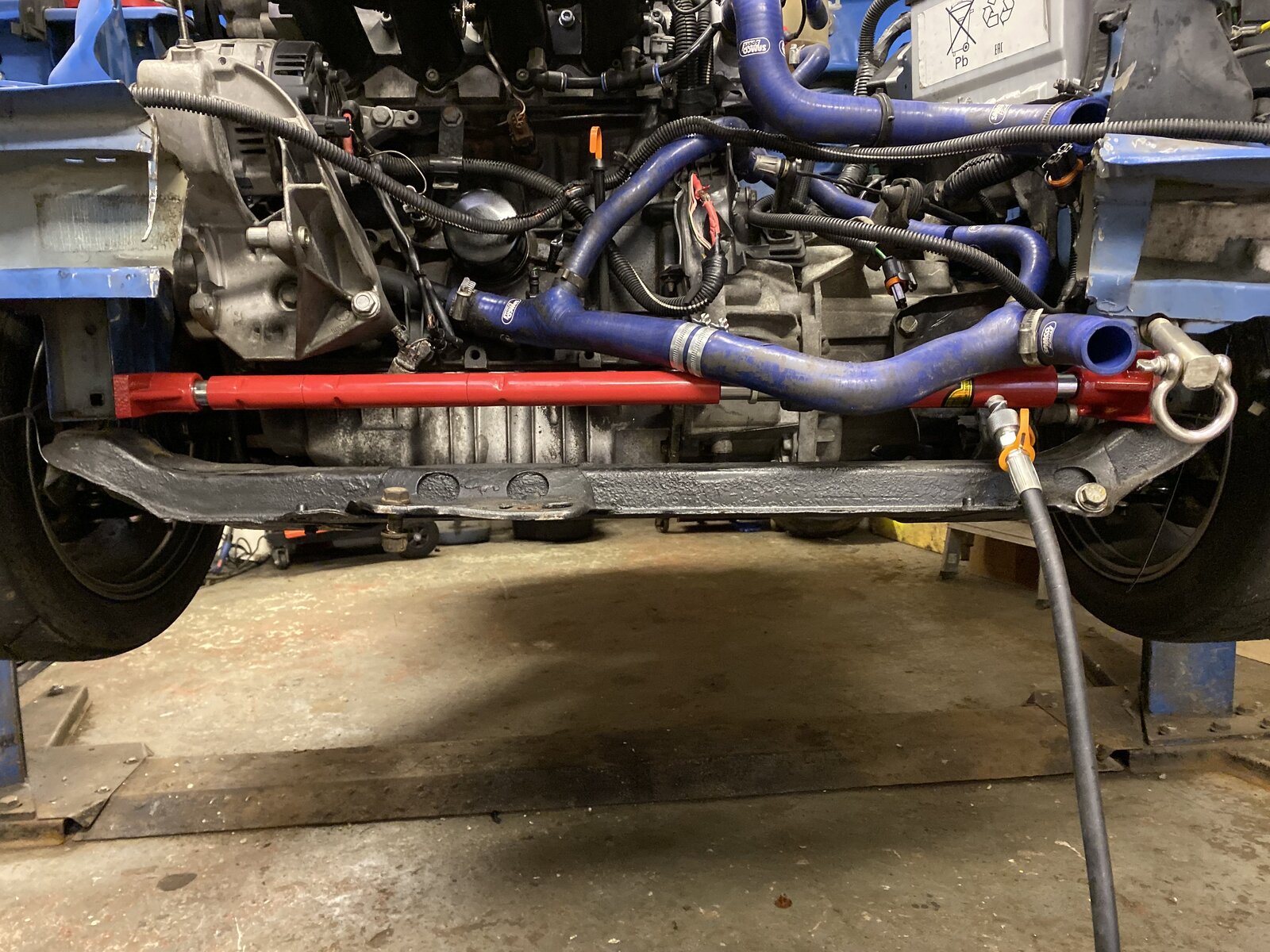

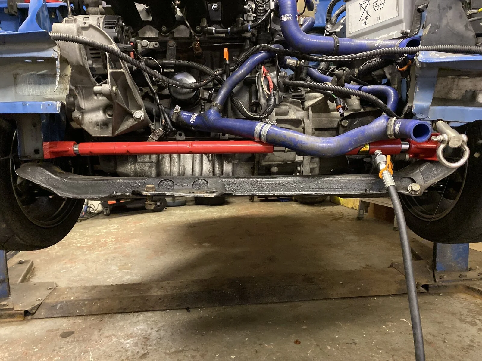

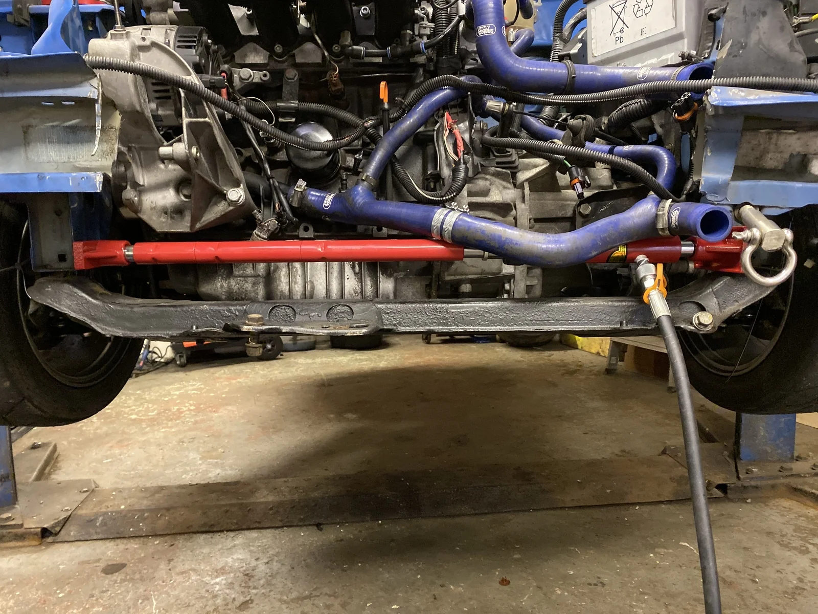

So I have removed all of the power steering lines and blanked the rack. I’ve just got manual steering now but will prob do an EPAS column later. Also a little electrics and a join in he bottom hose required.

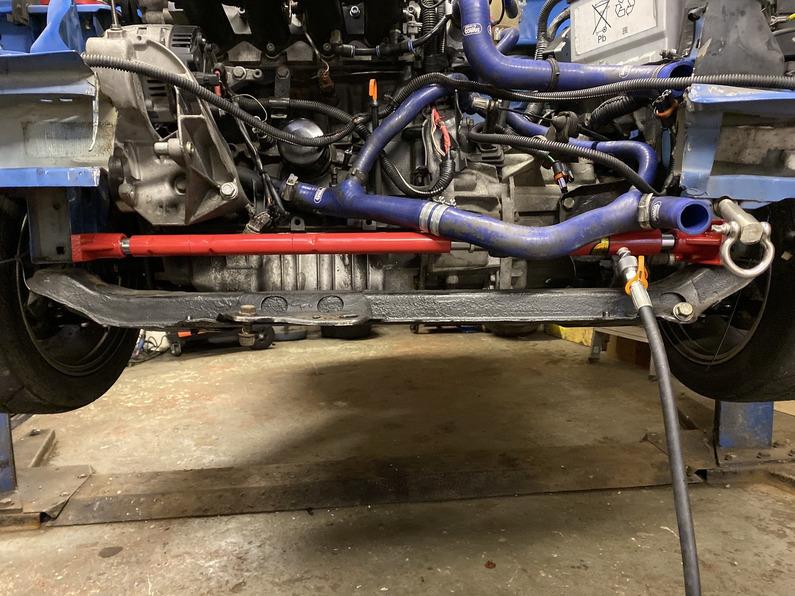

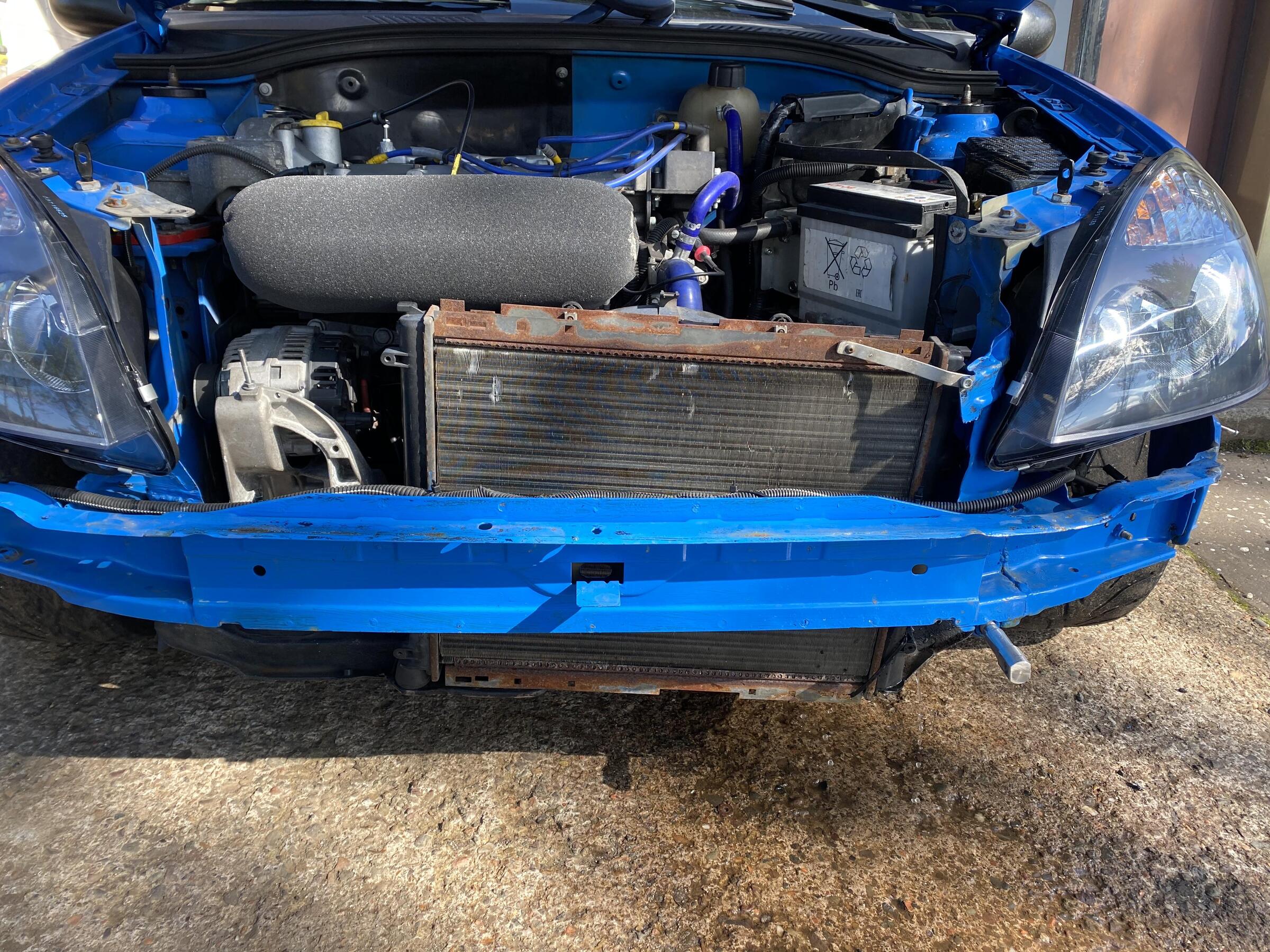

And finally. With a second hand subframe (172 cup one) the bolt holes were very close. Using a hydraulic press to separate the chassis legs a touch and bolt the subframe up.
Now everything lines up I’ve cut back the front crash bar and welded in the crash bar from my old black 182 (this was being scrapped anyway). Black bumper sat on for the photo.
Next time I post it will be a road test once the rad is mounted and all the panels fitted.

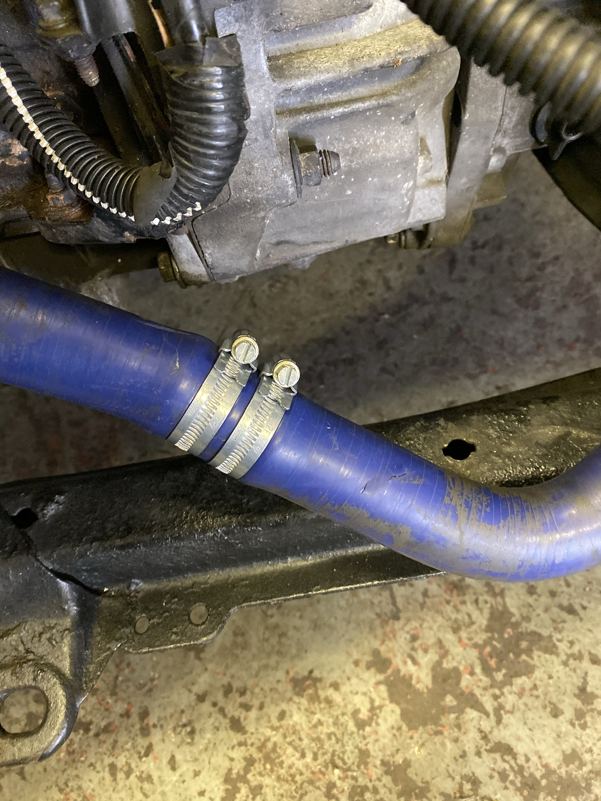

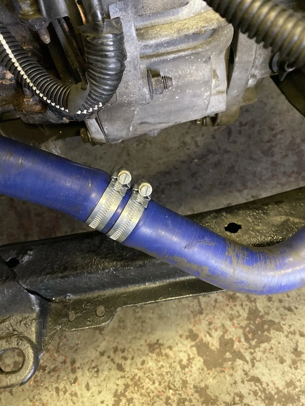

Well that was a reasonable first outing of the year. A little drama with a bit of a coolant leak that only decided to happen after the first run. I managed to keep on top of it all day topping up with water.

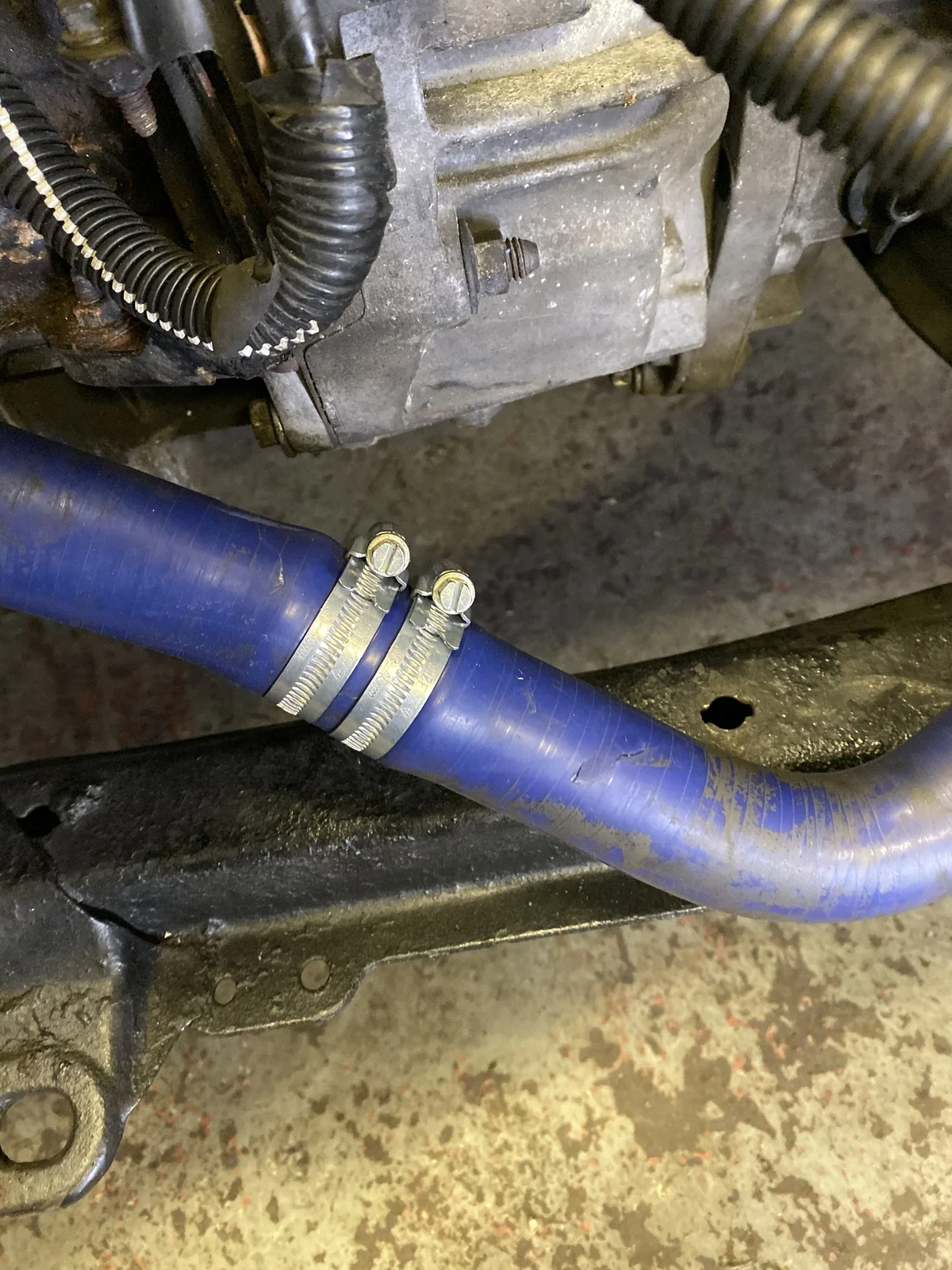

It looks like it’s coming from where to top hose joins the rad. I tried tightening the clamp but I think it’s a small split in the hose. Very much considering getting a new alloy rad anyway so I’ll start researching them.
Also had rather sore arms from having no power steering. I’ve got the old rack looped but you really feel it after a full day. I’ve already got the column and ECU. Just need to get my finger out and buy the £30 kit off eBay and fit it all.

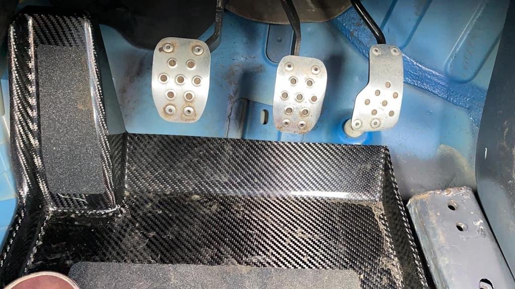

On a plus note. The new throttle pedal and foot rest were good. I might adjust the throttle over just a tad as I was accidentally heal toe’ing a few times when I didn’t mean to.

I had a bit of a coolant leak which looks like it’s coming from the top radiator house join at the radiator. I’ve been considering a smaller alloy anyway so bought this.

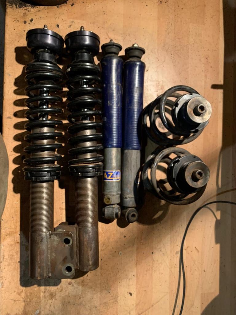

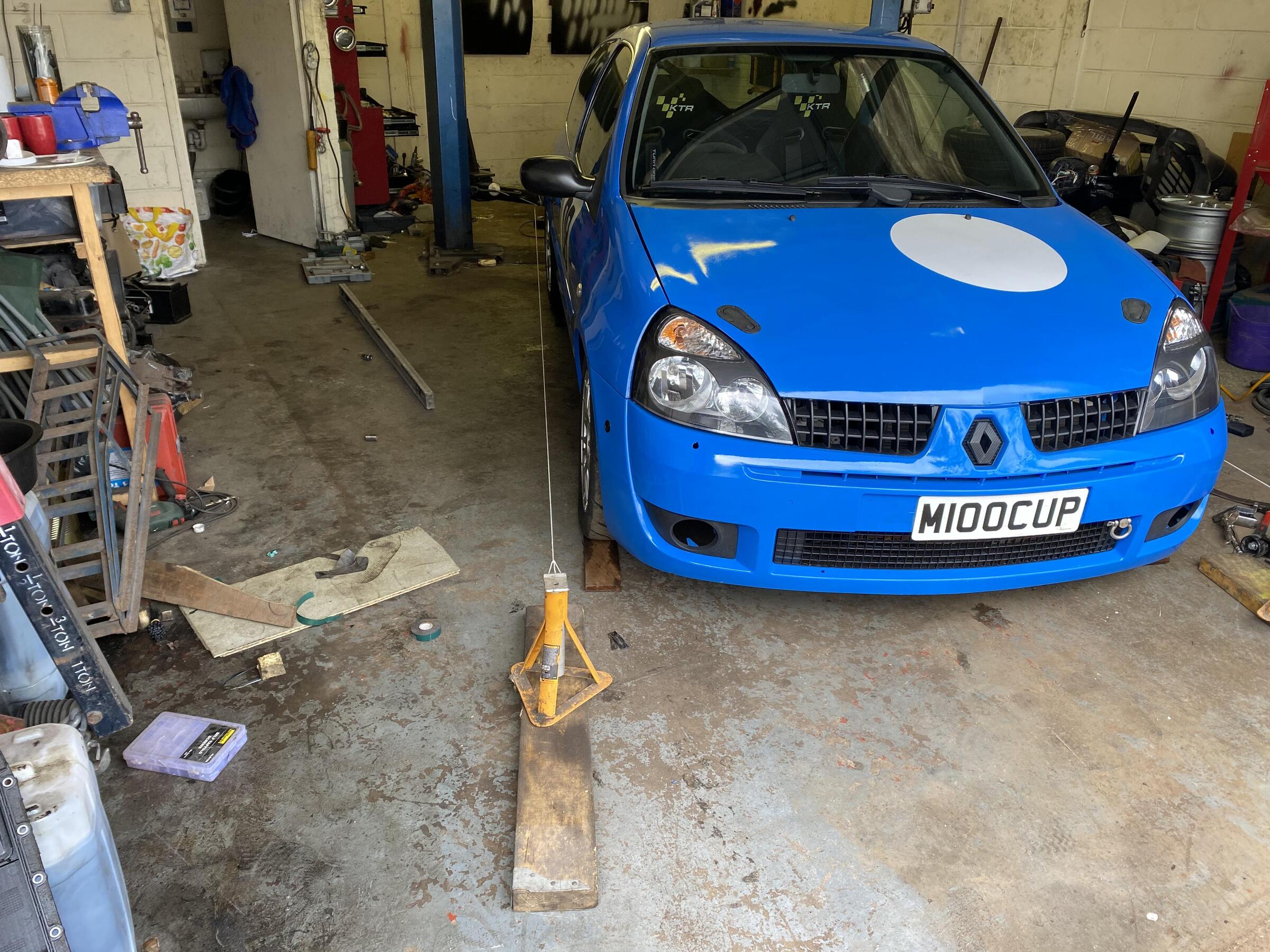

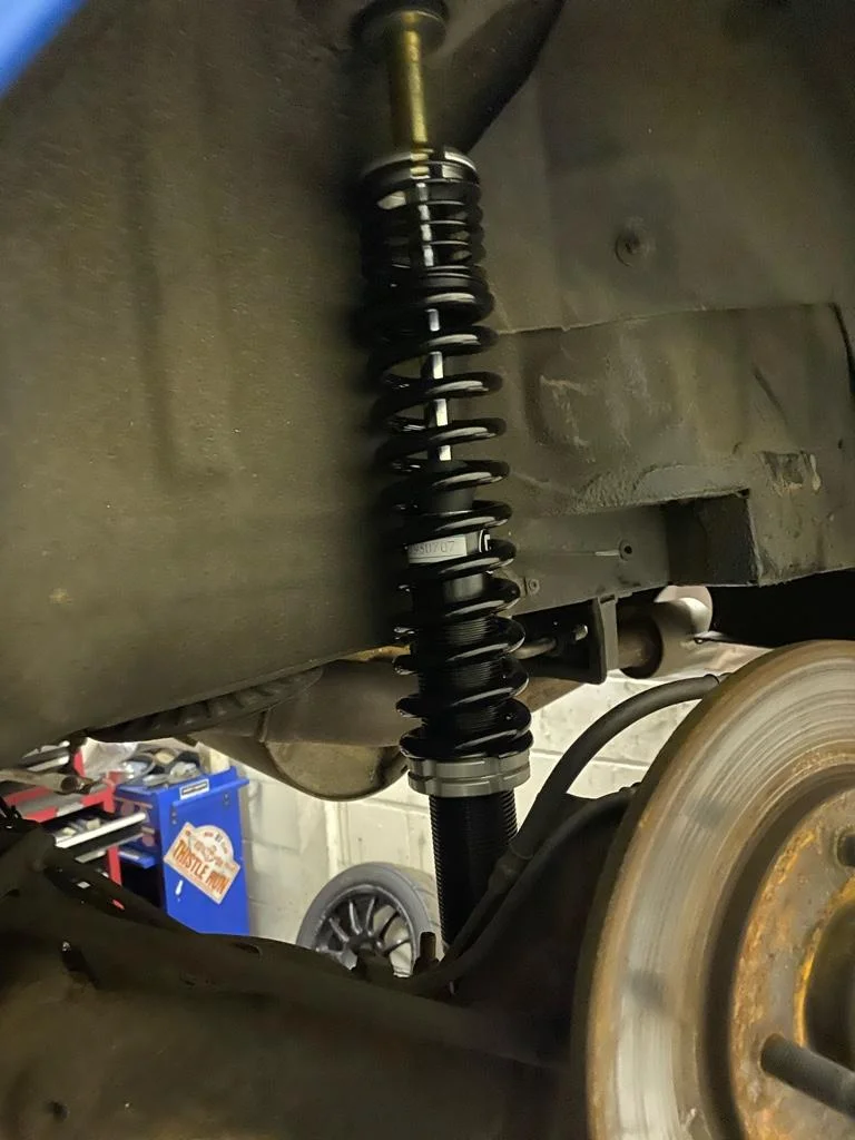

Also played a lot of the suspension setup prior to Kames. Camber and toe where I want it to be but still finding the car understeers quite a lot. Played with damper settings as well and I don’t think it’s something I can work around with the current suspension. It’s running gaz GHAs with 275lb springs up front and it’s just way to soft. So the choice was to stick with these and buy some falkner springs. Would have been about £100 I think. But then I think these shocks are at least 5-6 years old. Possibly more. And also the rear would remain as soft as it is. Also the GHAs are right on the limit of what they can handle at 500lb springs.

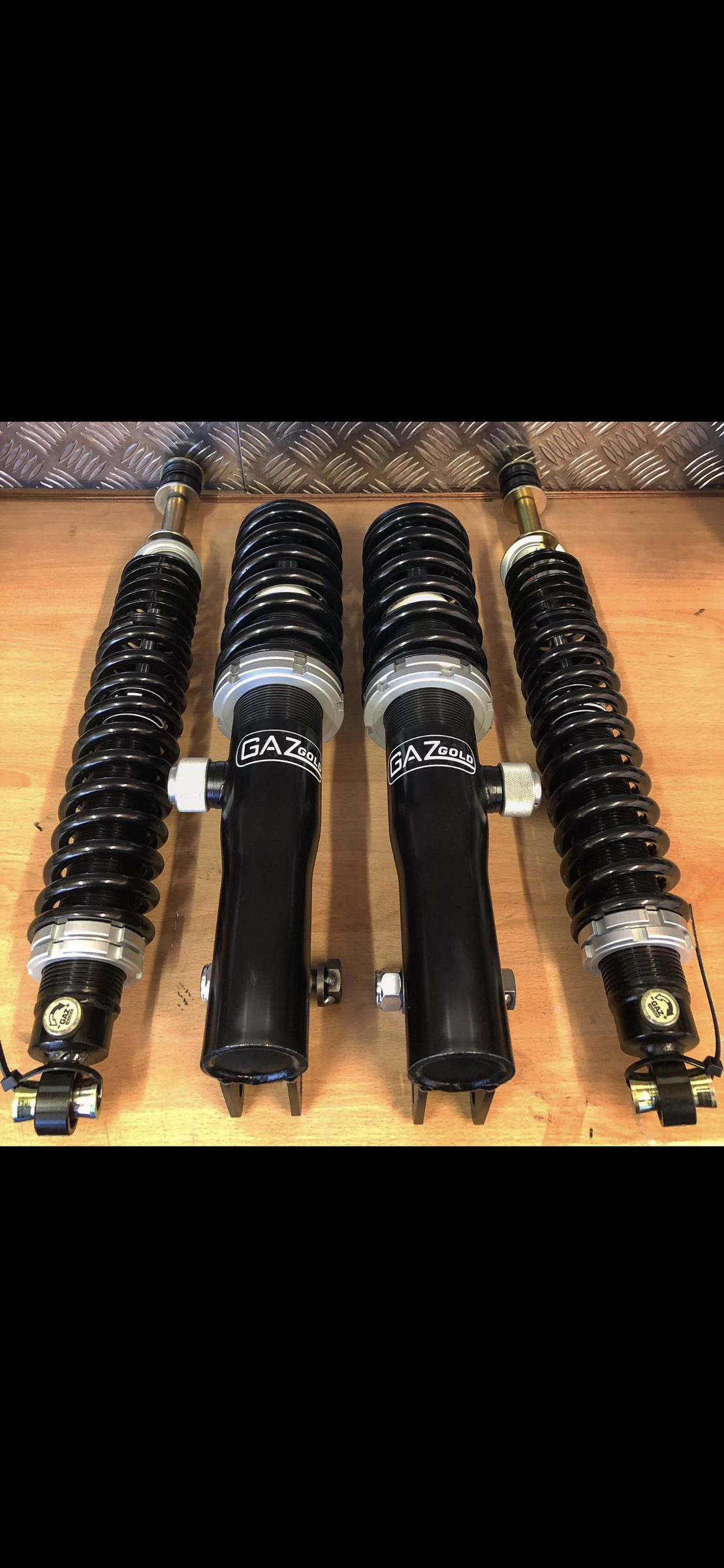

So I’ve decided to upgrade to Gaz golds which I’ve speced with 500lb front springs and 300lb rears. New and can handle the heavier springs better.
I’ve sold my black clio that I purchased to my brother and done a deal to include my old Gaz GHAs to fund the new shocks. Considering what I paid for the clio and what I sold it for plus the old shocks the Gaz Golds only cost me £600 which isn’t bad.
I’ll update once they are fitted and all the alignment is done. Expect there will be a test day at the end of August to try them out.

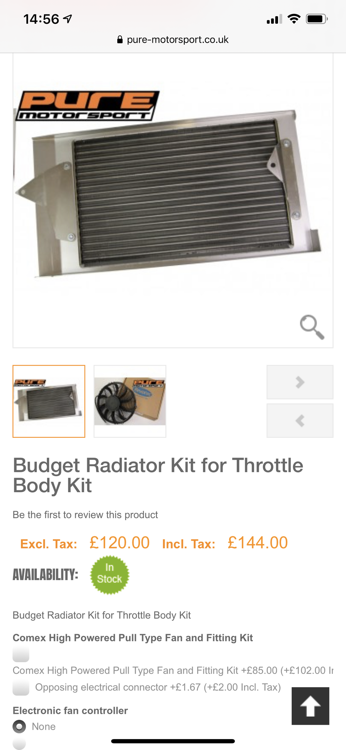

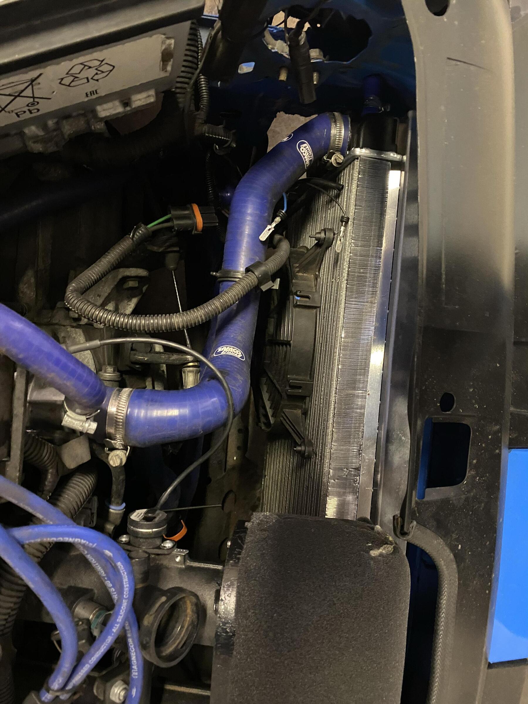

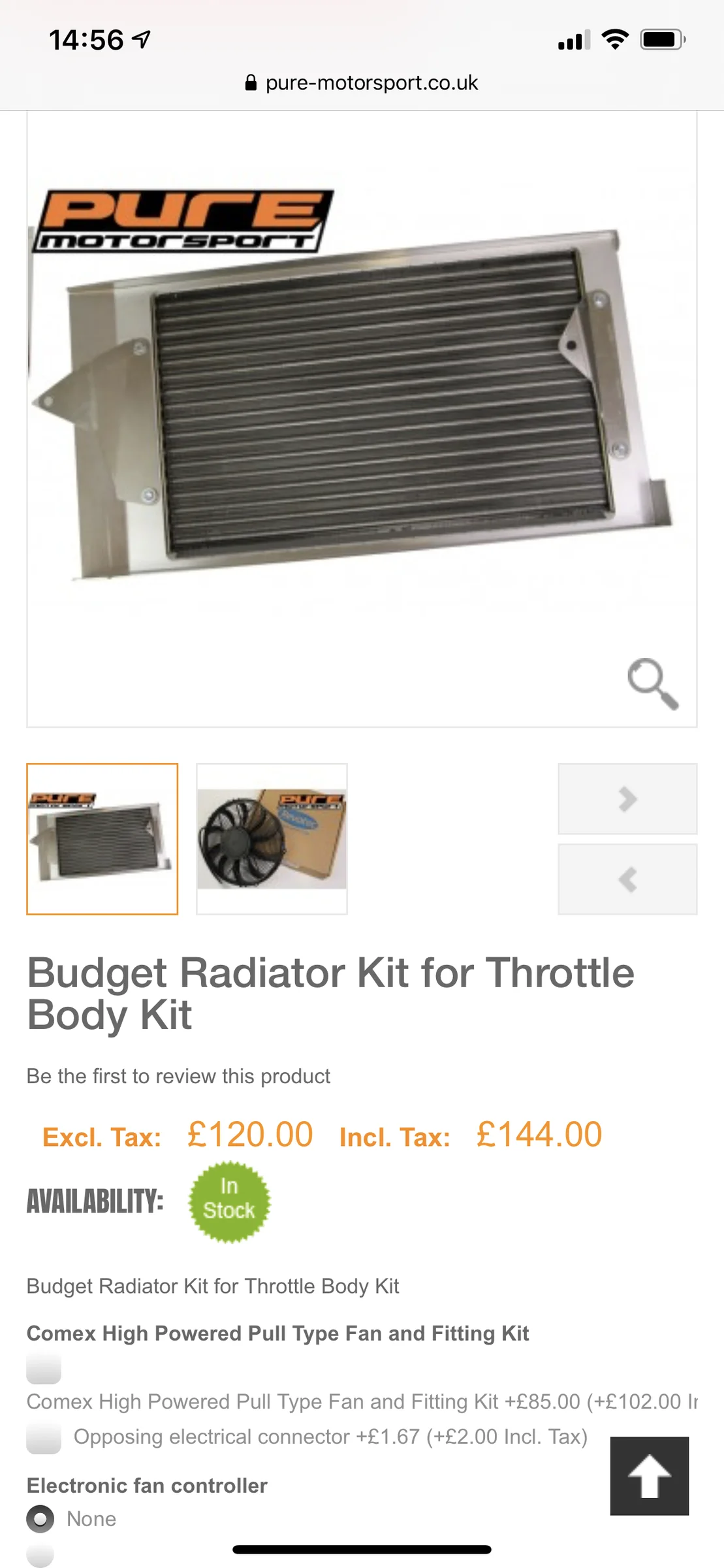

New radiator fitted.
I’ve fitted a classic mini rad fan from a late model. Just need to wire it up now.

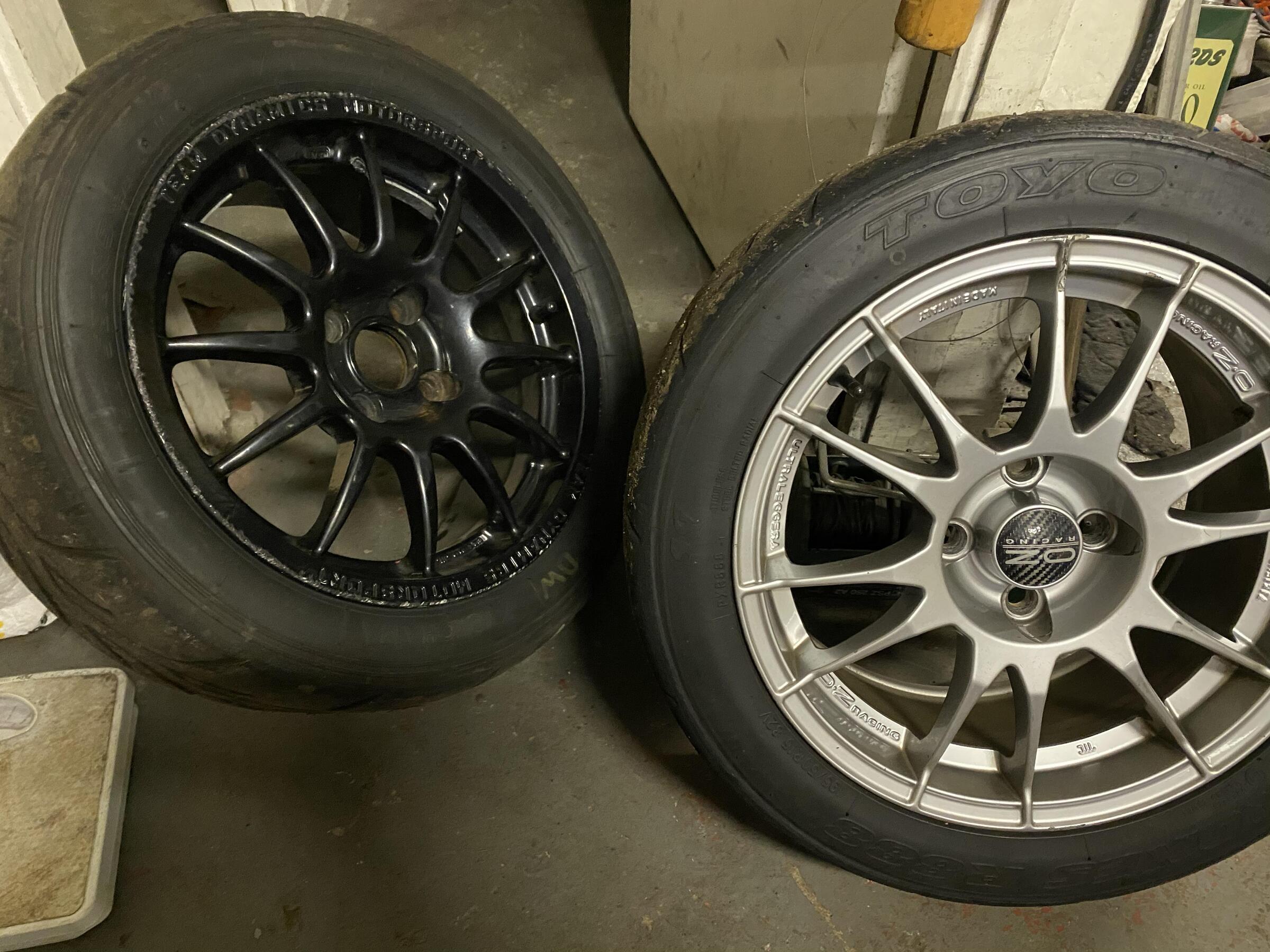

I’ve also swapped the wheels over. The r888s need replaced after kames. So I’ve changed to the ad08r tyres in the team dynamics wheels. Weighed them at the same time.
Wheel and tyre 21kg for the oz and Toyo r888 and 23 kg for the TD1.2 wheel and yoko ad08r.
Might paint the oz wheels while they are off. Think the car suits the black wheels better.
