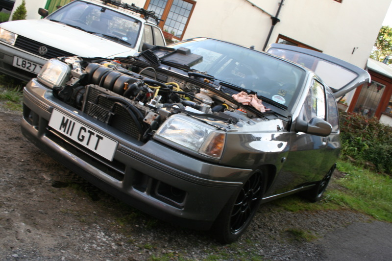

I bought her back in March 2007 and looking like thus:

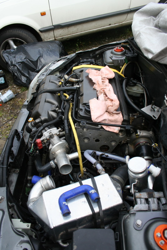

However, after attending the RTOC national day at Mallory Park, old gremlins long since thought as subdued raised their ugly heads. Main straight at 130........popped the header tank clean in half. And then again at Donington later in the year, split a water hose and popped the radiator. So there’s an ongoing pressurisation problem in the cooling system.
I have proceeded to check every know test on a head gasket that is possible without dismantling the engine, and they all come back clean as a whistle, no compression problems, no leak down issues, no oil in the water or vice versa, no combustion products in there either. All very cryptic and this has all lead me to believe that there is a more serious fault, perhaps a hairline fracture in the block or head. Either way something may have to be done!!! .........
...............so i added these..............they didnt fix it! :-( :lol:
The final desperate attempt by me before SORN was to replace the water pump and attempt a ‘do or die’ spin out to test that......however in true clio style she spat the dummy and I ended up with all the coolant all over the floor as it pissed out the radiator...this was the split I must of picked up at Donington and not noticed until now As such SORN was swiftly applied for and this year of boost was brought swiftly to an end, with the car sat suitably on the naughty step!

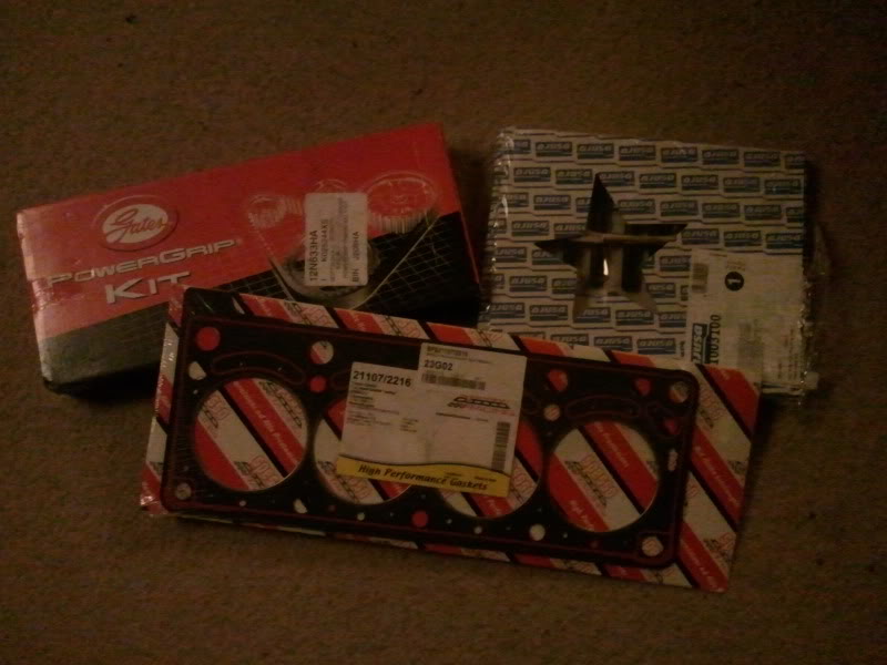

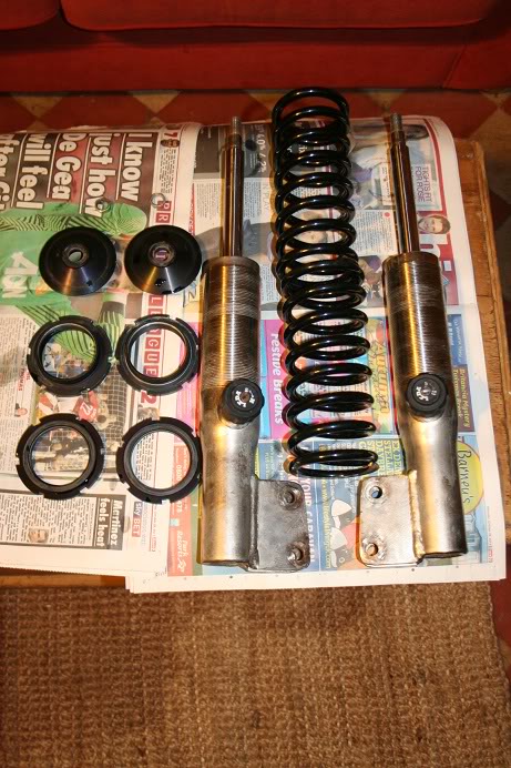

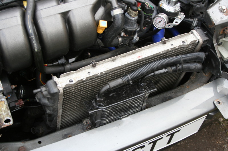

and so far to combat the issue i have purchased the following :)

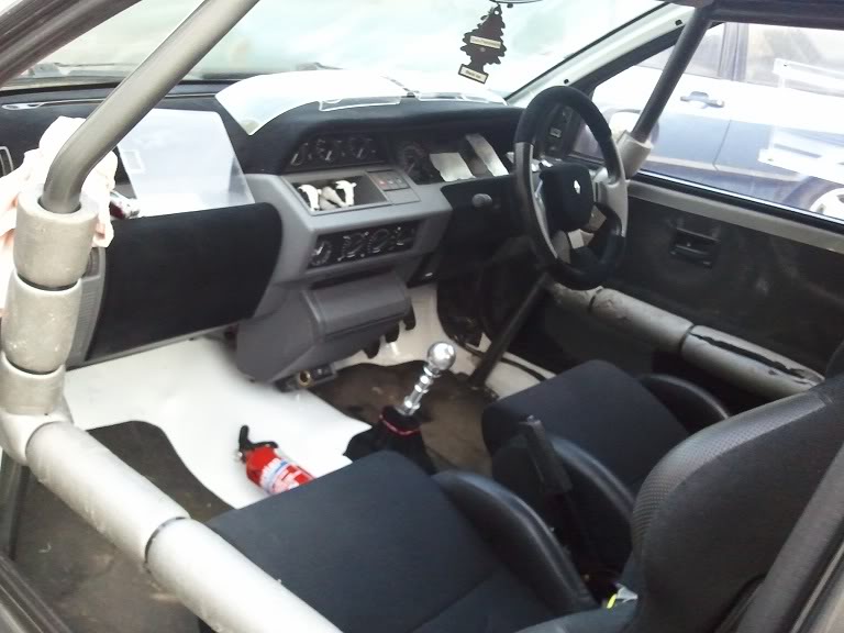

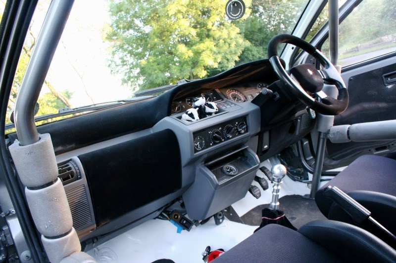

i have decided to have a bit of a change of tact with the car now, i have had it setup for track **** for years. ever since i bought it and as i'm now old and tired its time to revive the car, stick to a similar theme but more of a porsche GT3 RS or megane R26.R theme, so stripped but comfy, useable and a bit more of a road warrior.
the plan is as follows, in bullet point and highly efficient stylee:
- Fit new suspension and raise ride height, use adjustable goodness to soften ride for domestic use ;-)
- Return a fair amount of the front trim to the car and remove the cage sidebars for road use
- Re-fit lecci front windows
- Wind the boost back to a more manageable level for road use, 10psi or so
- Fit road tyres
- Fit a stereo
- Assemble some sort of access to the boot!lol!
- Fit a flexi section to the downpipe and have a stealth exhaust (full system) made up to suit so it hides tailpipe like the original 172's
all the track / 1/4 mile part will be kept for just that, but it'll be a bit more restrained GTT next year methinks!

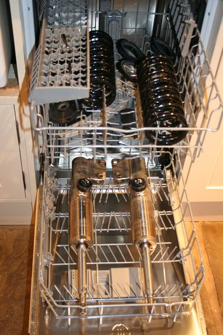

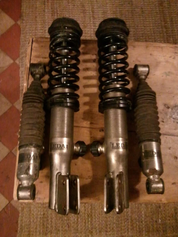

as such i decided to dismantle my LEDA's and clean them up in the age old way i know of ;-)
safe and sound:
shiny.....er ;-)!
sorted

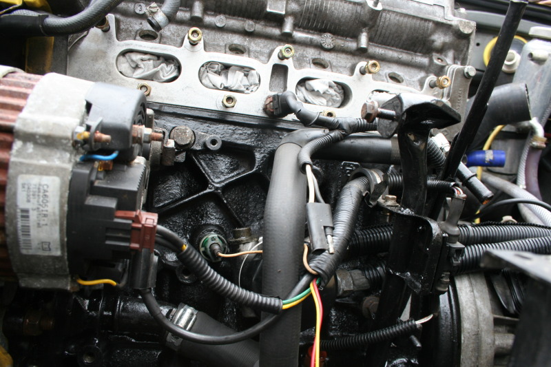

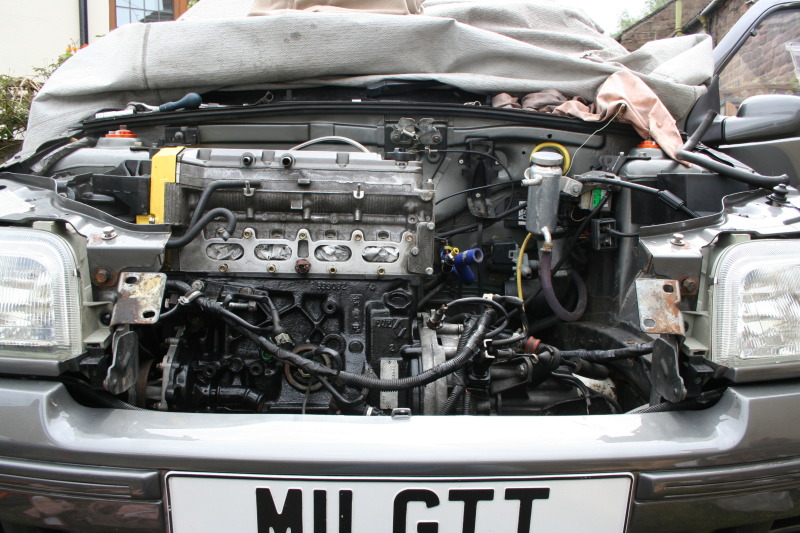

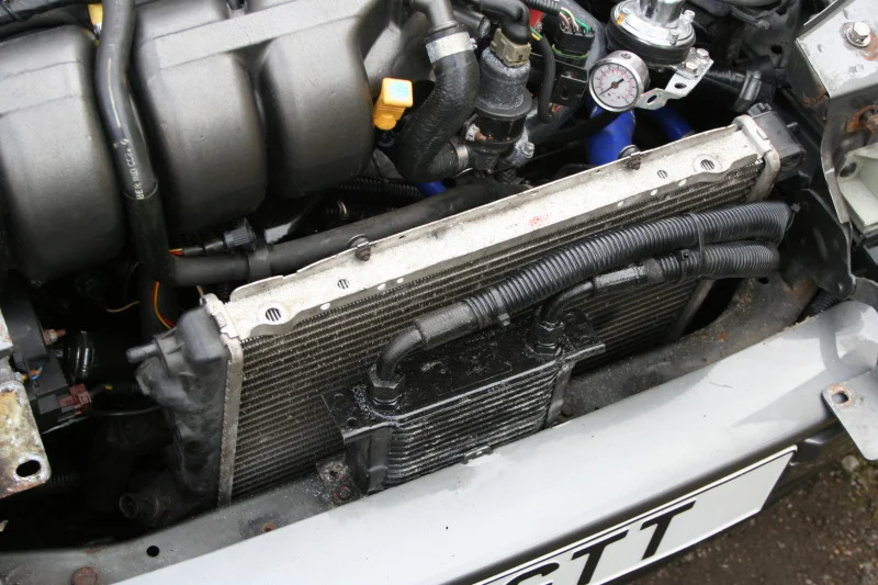

Finally decided to crack on and get the car apart and see whats causing the over-pressurizing issue i've been seeing this season on track.

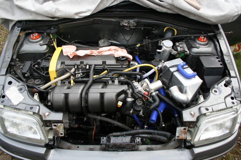

So this is how the car is stood currently, looking a bit forlorn on the 'drive' and a bit unloved
the damps caused a bit of mould inside, but next to none really and i've chucked loads of silicone bags in there to soak up the worst of it, so the interior still looks okay :) really need to get a garage when i buy a house next year though, not happy about damp and old clio tbh!!!lol!!

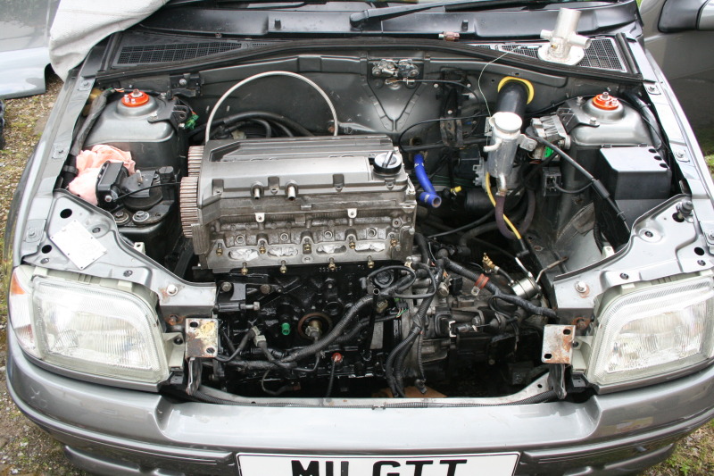

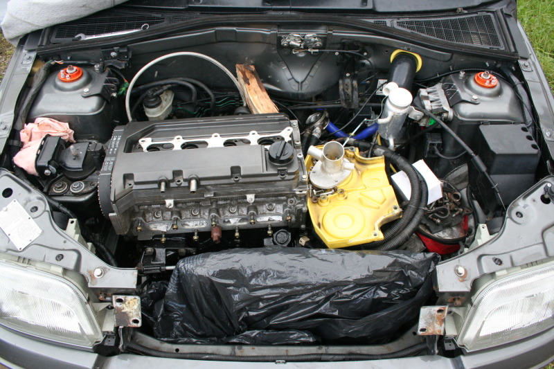

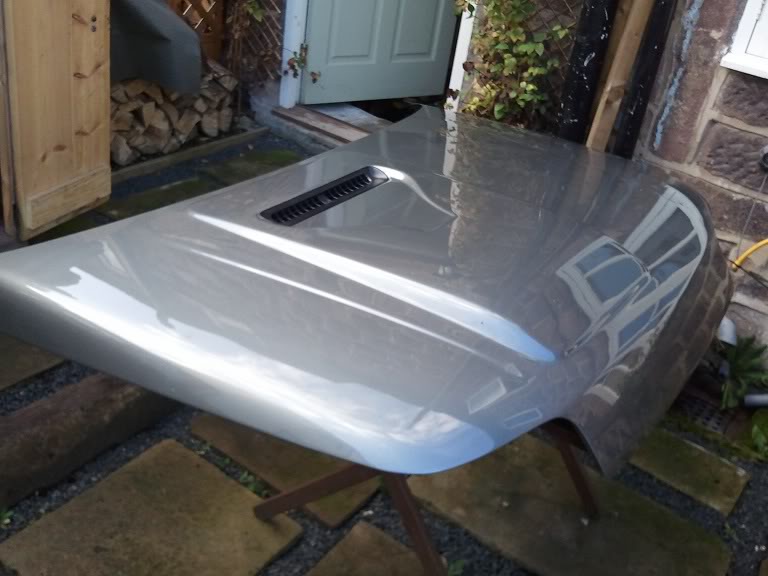

so bonnet off;

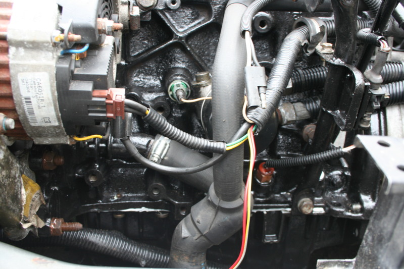

radiator and front coolant pipework out, i will be purchasing an alloy rad and silicone hoses to replace the final ones that aren't silicone yet. This is going to include some custom pipework, which i have made templates for and will be sending off to SFS performance to be made up over the winter :)

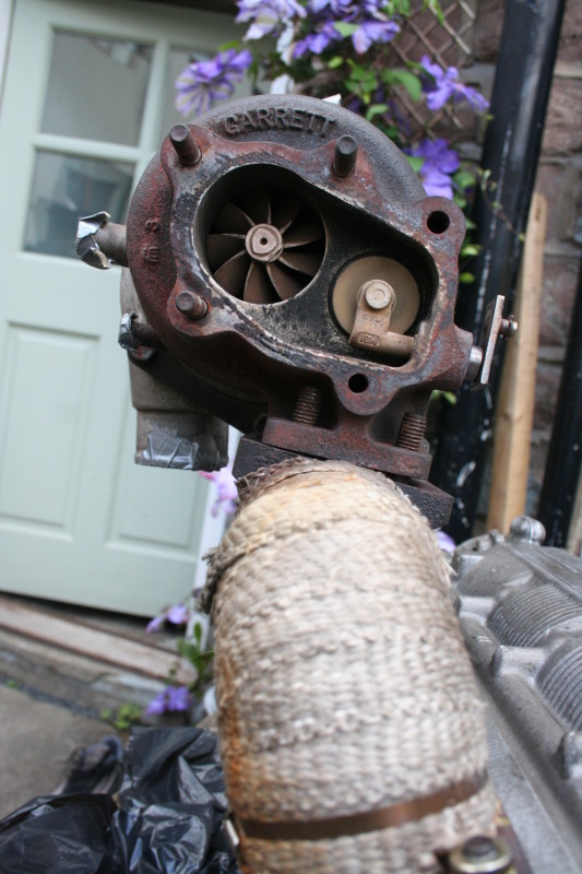

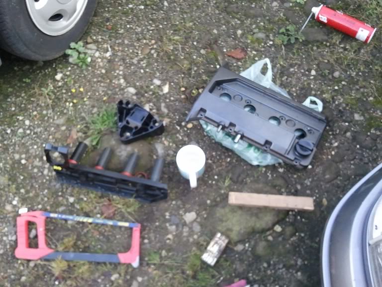

the idea is to remove the downpipe as well as rest of the exhaust system and get a new one made up. i plan to put a flexi section in the downpipe and then get hold of a mongoose or similar and modify it into a full stealth system. all just ideas currently and as such i figured to save scrabbling about on the floor under the car, i'd whip the turbo off the manifold and leave it in situ for now!

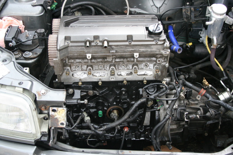

parts pulled off for ease of access

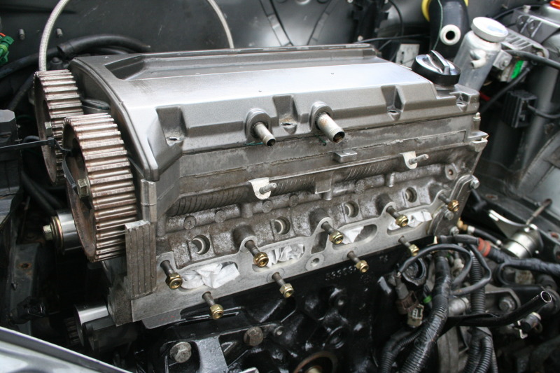

and more bits off to get to head bolts

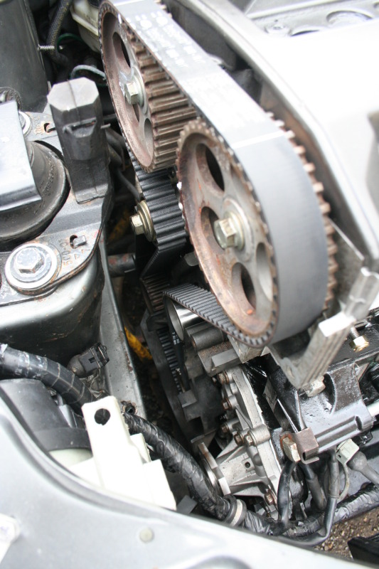

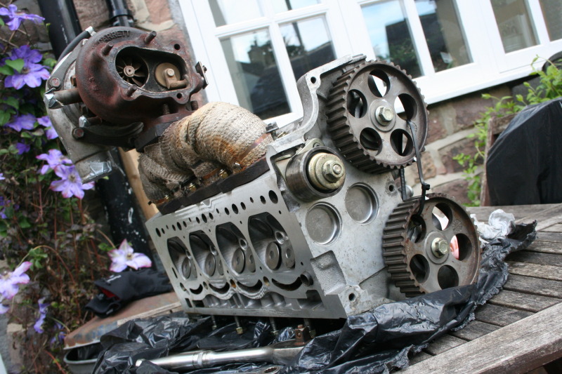

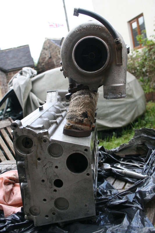

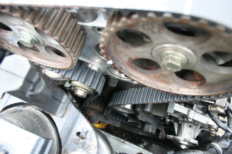

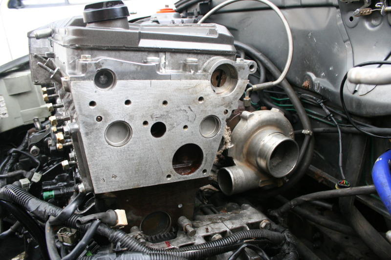

and head off, i cheated and cut the cambelt, hence the top cambelt cover is on ;-)

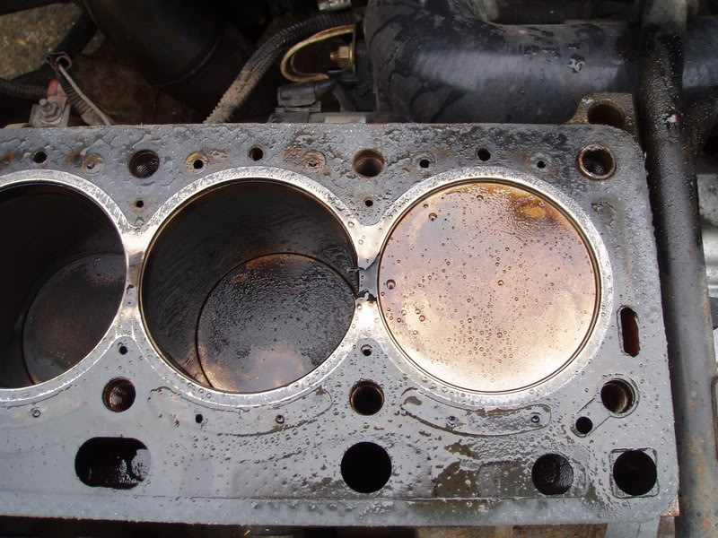

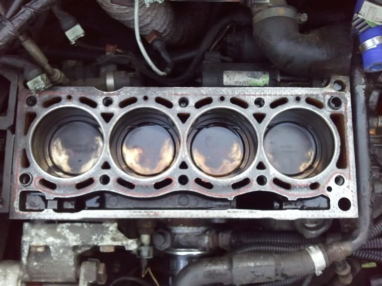

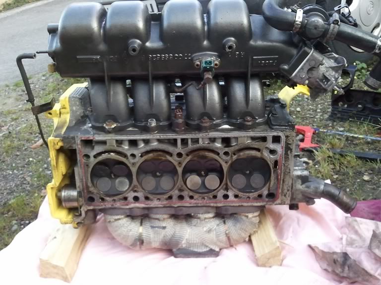

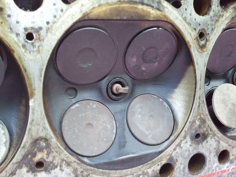

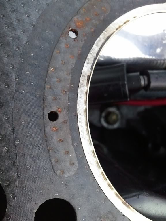

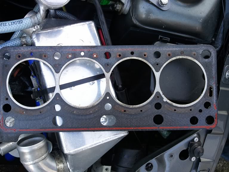

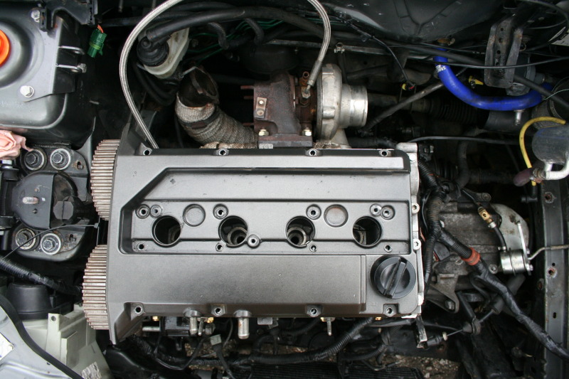

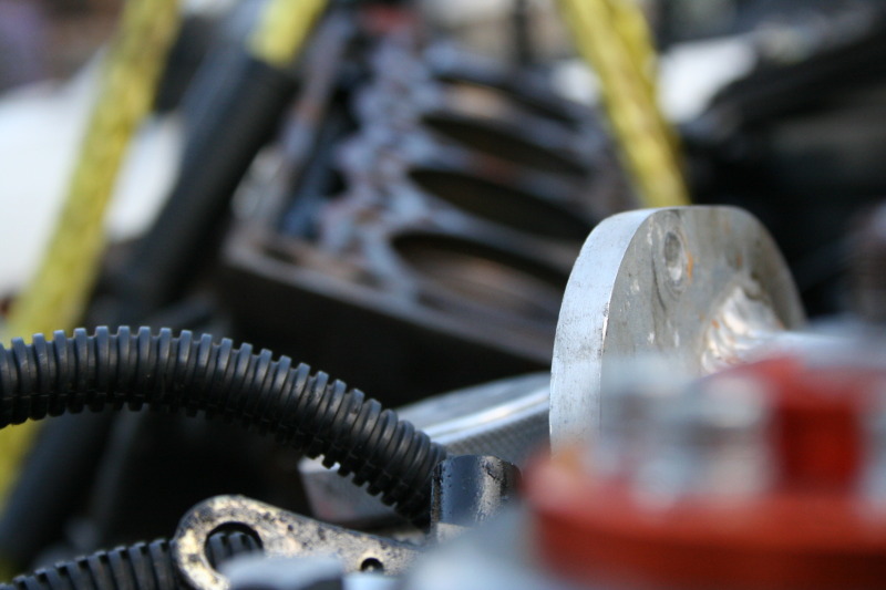

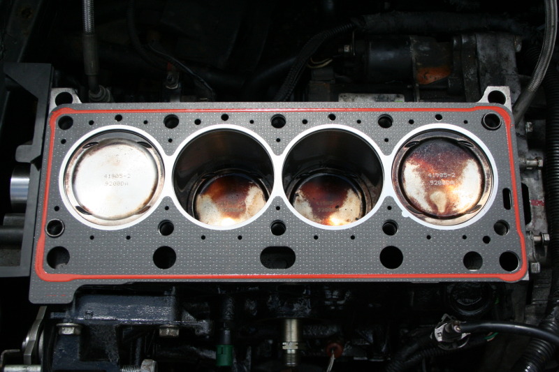

this is the head/valve/combustion chamber area after 4 years and 16k miles on high boost, not too bad me thinks, seems to be running lovely. small bit of pitting on the exhaust valves and some build up on the inlets, but nothing to write home about.

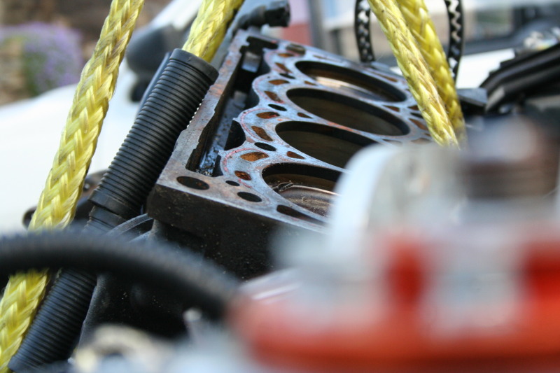

head gasket, still looks fine from a distance........

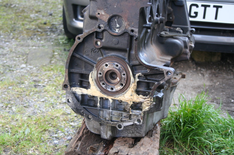

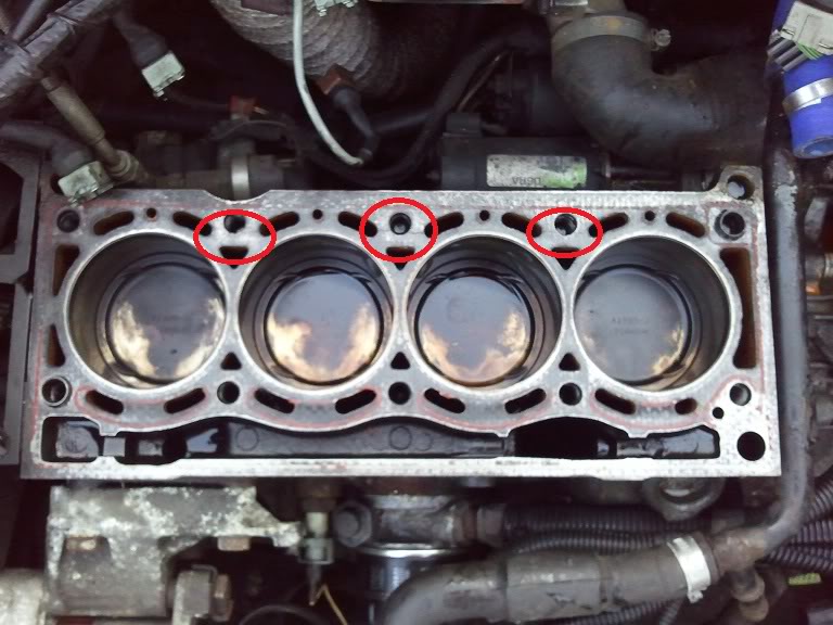

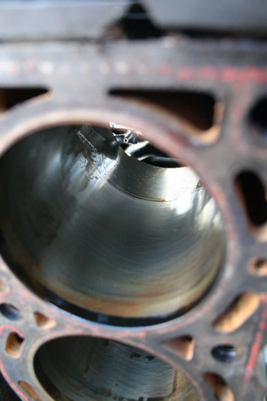

but whats this...............fire rings a bit damaged and theres clearly been some blowby as theres striations all across the fire rings

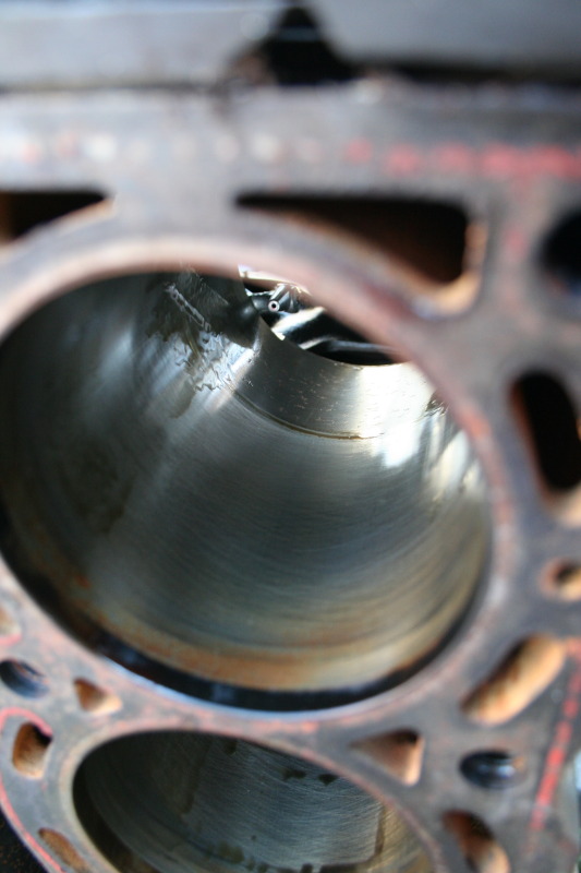

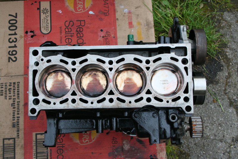

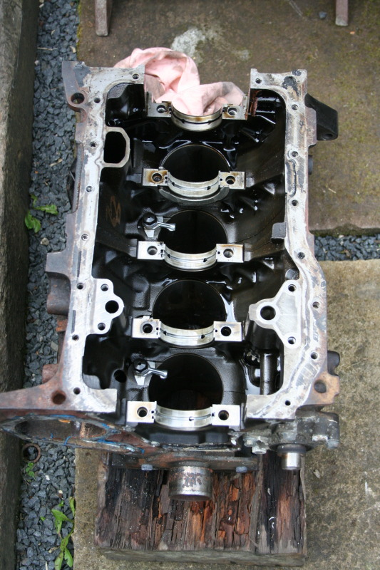

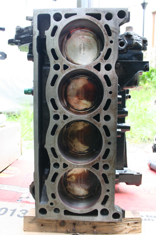

and heres the block.....again pistons seem okay, no build ups and evidence of poor running, and the bores are still lovely.
but if you look closer in the red circles..............cracks........the damn blocks cracked across from the water ways to the head bolt holes.
so it seems that the blocks cracked and the headbolts have lost clamping force, allowing blowby into the coolant system under full boost and as such pressurising the system!
so at least i've found a fault, but its some work now to fix.

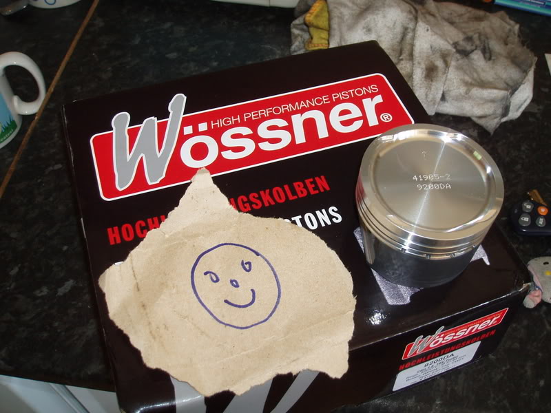

- check new block, rebuild as necessary with my wossener pistons

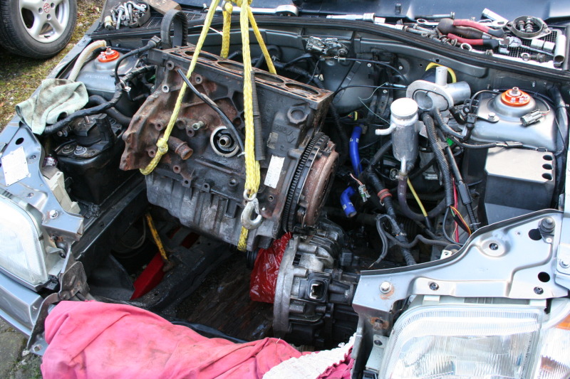

First job was to run up to big rons and liberate his engine crane to return it from retirement in his garage to active duty on my drive! :p
I took way too long gathering stuff and eating pizza upon my return as well, and as such didn¡¦t actually do a stroke till gone 3pm¡K¡Khey ho, am lazy what can I say!! :lol:
Anyway, after hour or so pissin about wrestling with a couple of studs in the block to box union and moving the box itself across as far as I could, I proceeded to rip the bad boy out the bay! I¡¦ll let the pics do the talking from here on for a bit! :)

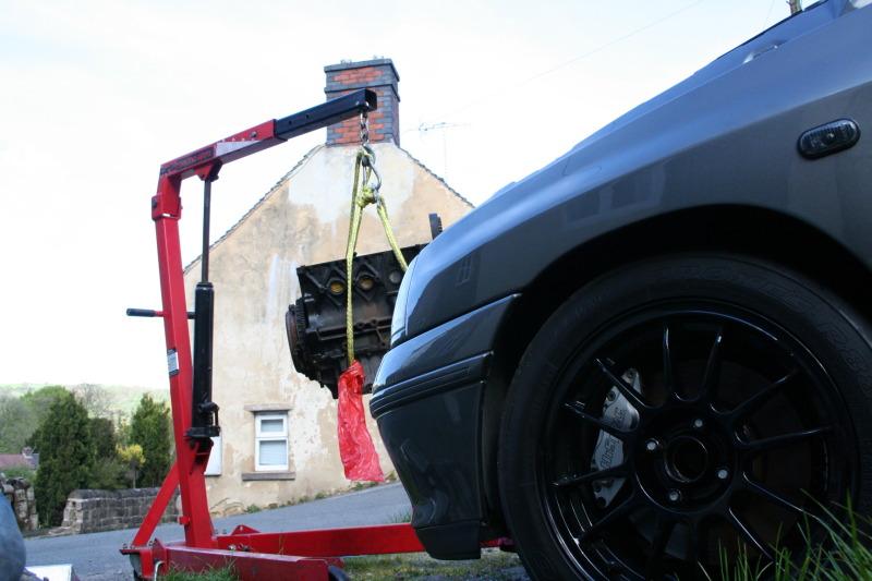

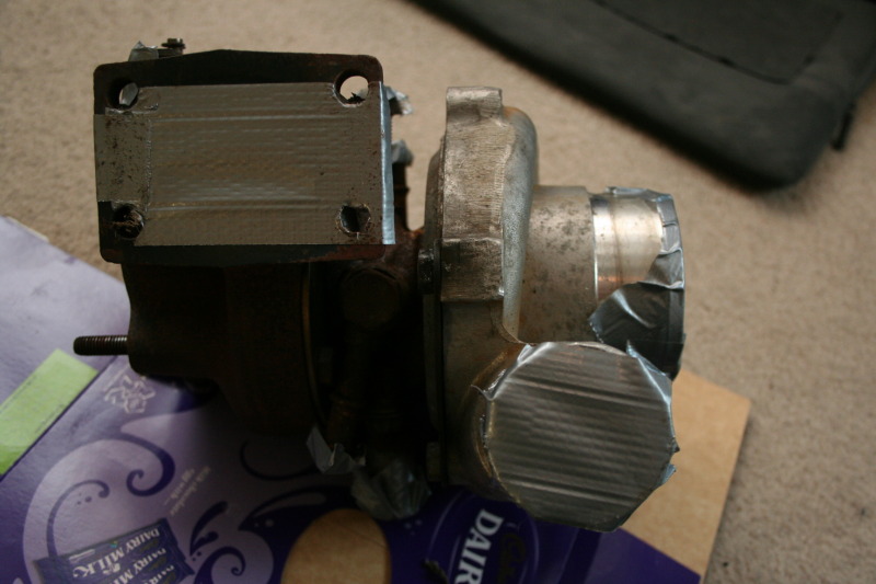

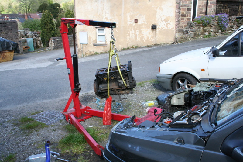

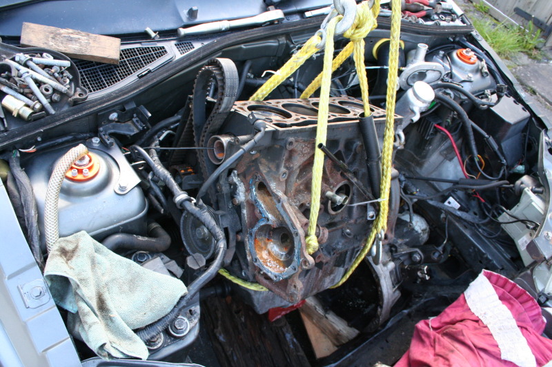

Firstly the poor disco spuddy, been sat taped up like a cheap kinky hooker on my windowsill for months, I think it needs some love, and preferably a load of hot air from an F7P :wink:

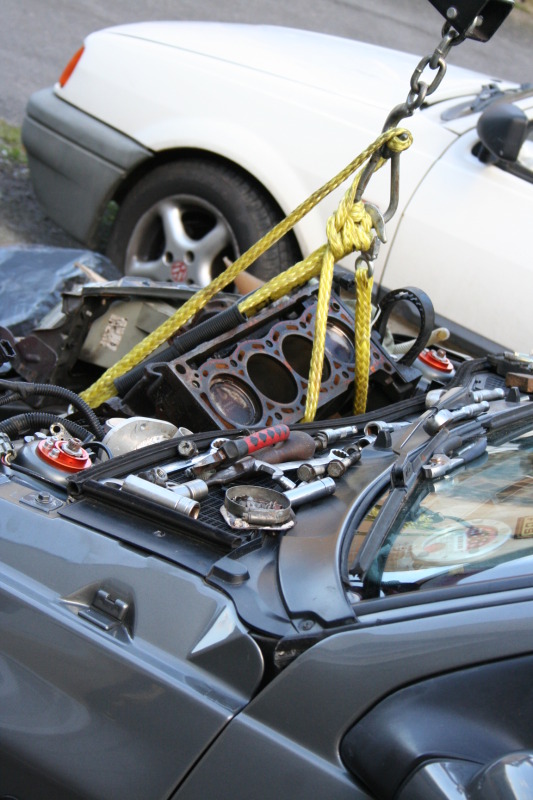

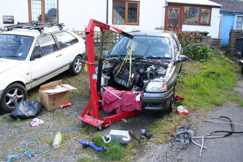

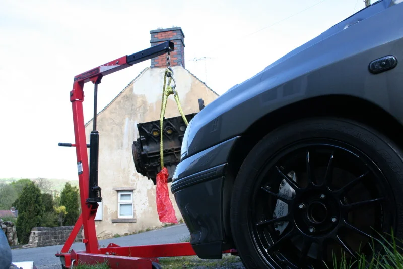

Anyway, in went the crane and up came the block
Teased out inch by inch, like a gentleman¡K¡K ;-)

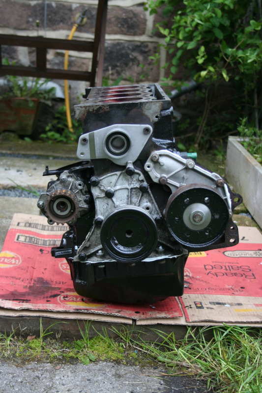

And out she came!

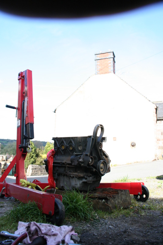

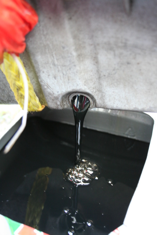

Quick oil drain whilst the block was still up in the air
Then boshed it down onto a block of wood for stripping.
At this point, tea and choccy was called for to celebrate a half a job badly done 8)

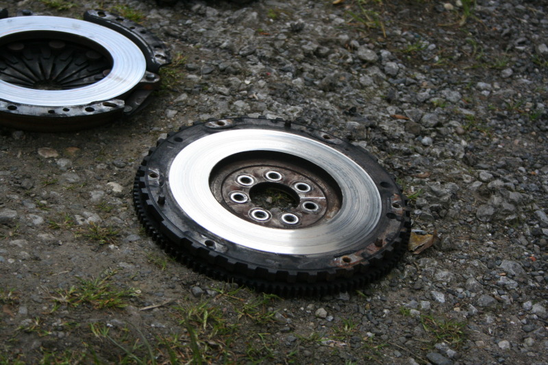

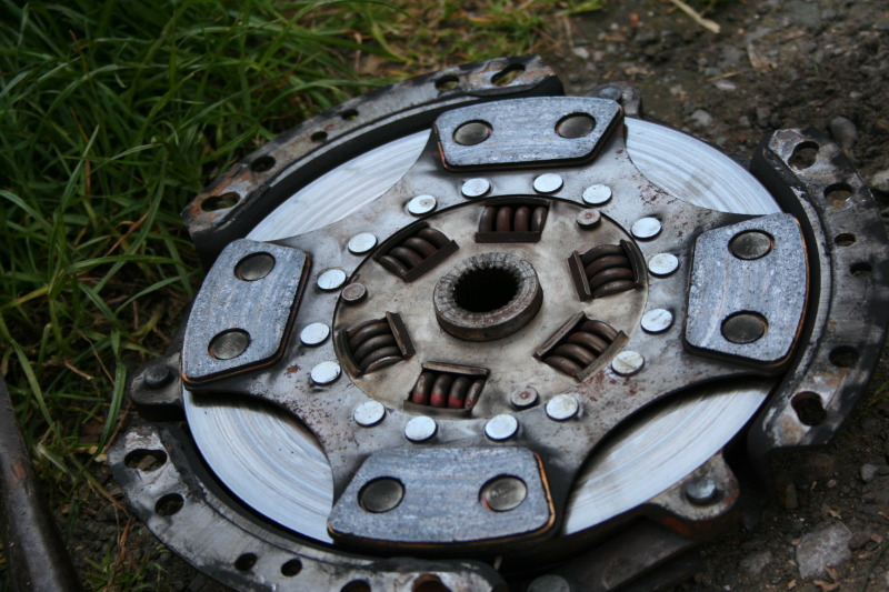

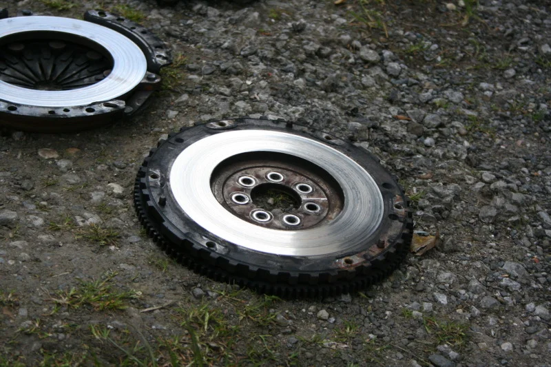

Then onwards and upwards, first to come off was the clutch assembly and flywheel, both of which will be checked and put onto the new lump. Initial inspection is good, everything appears to be in good working order :) good times with weapons for all!

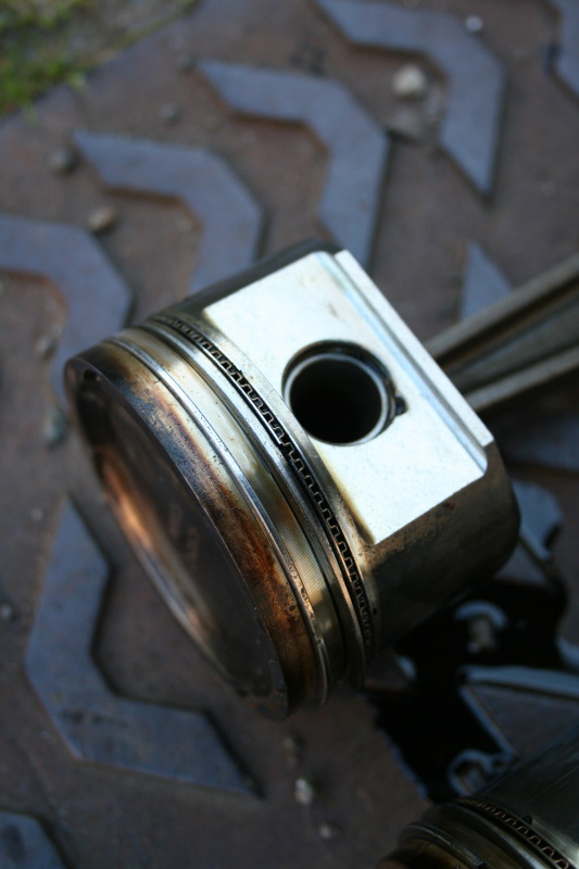

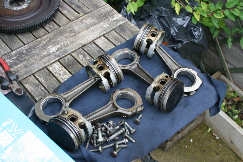

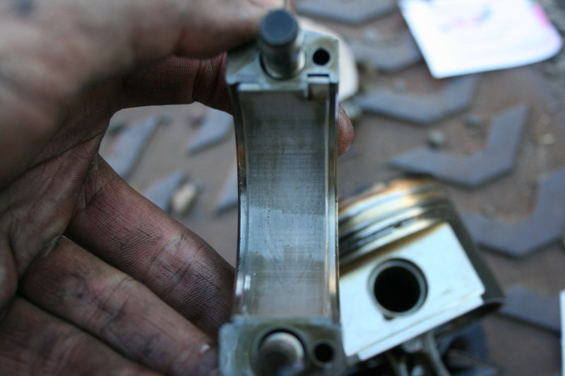

Then whipped the pistons out, still looking okay after many miles of hard work and abuse over the past 5 or so years so pretty happy with that! Again, check over and into the new block they shall a be going!!

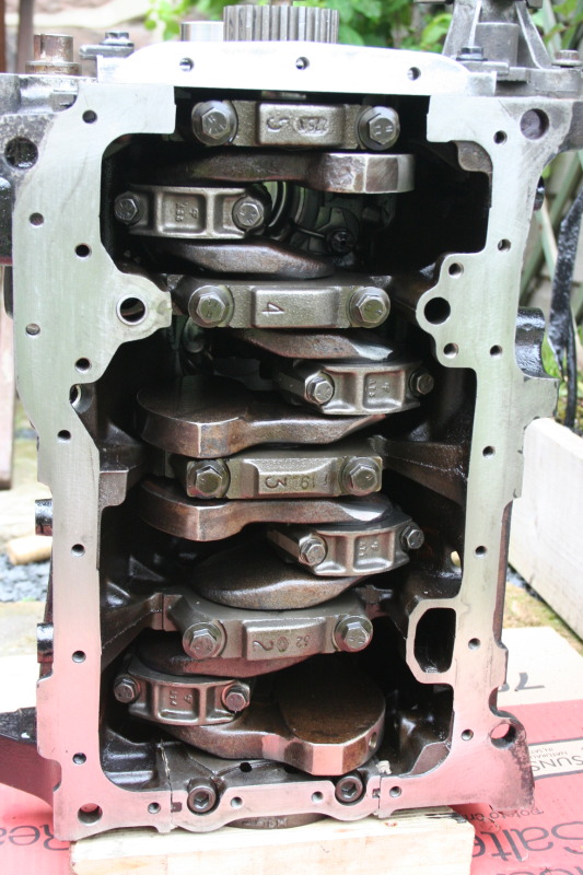

I¡¦m also pretty happy with the bearings, they¡¦ve held up fine over the years and show very little in terms of wear so overall the engines coping well with the power, it was just the headbolt hole cracks that have caused an issue, the internals are all minty mint ƒº

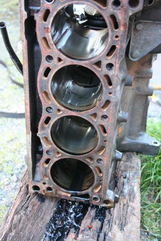

And that¡¦s it, the old F7P is laid to rest, I may pull the crank out as well then I¡¦m scrapping it¡K¡K¡K¡Kor maybe I¡¦ll make it into a table for my shed at the new house! Who knows! Seems a shame to bin it, little troopers seen me round a few tracks and spanking 12¡¦s at pod, we¡¦ve been through a lot together. And it was the cars original engine from the factory, 18 years in its one home, GTT¡¦s bay! :(
The bores looked pretty good too, still see the pikie in situ honing marks from last rebuild!

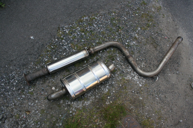

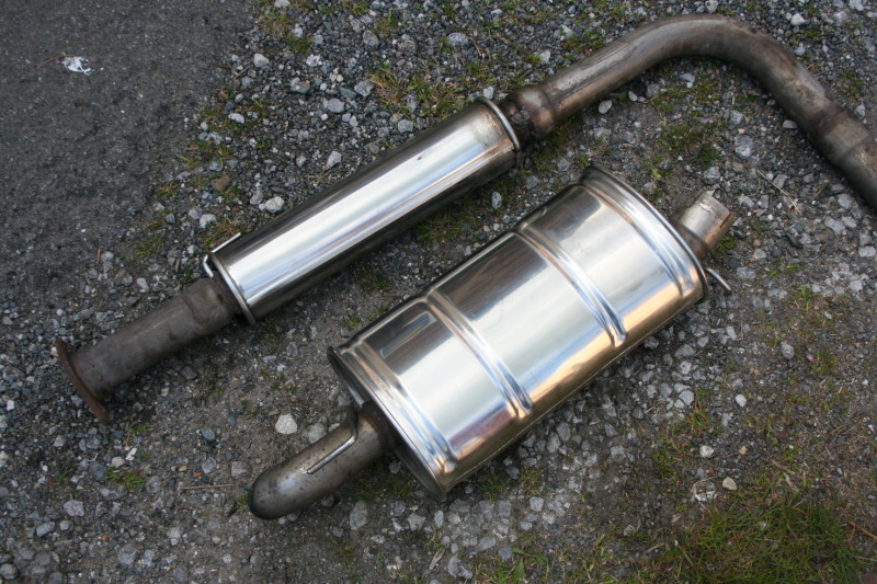

And I have my new exhaust ready and waiting to go on as well
Shiny!

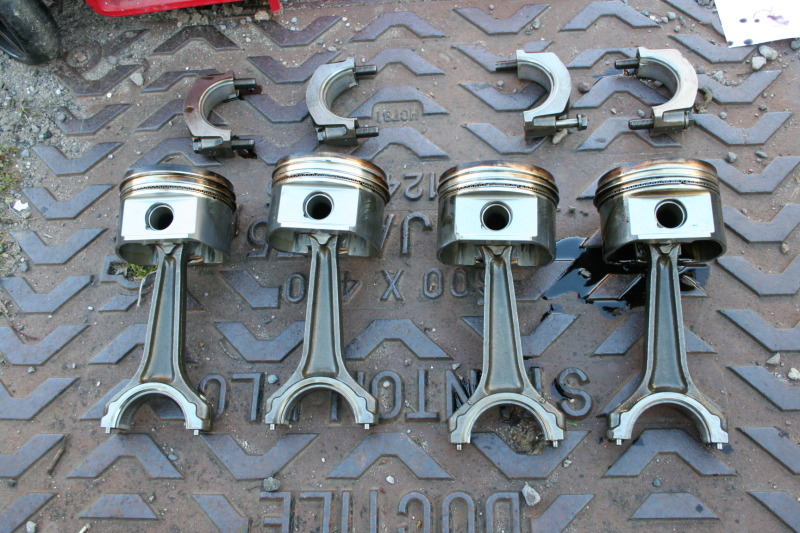

First of all I split the old block down and removed my pistons and rods ready to be fitted to the new block, I also have these standard items kicking about now as spares ļ

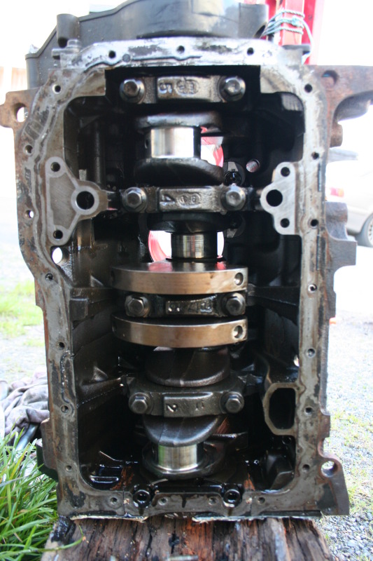

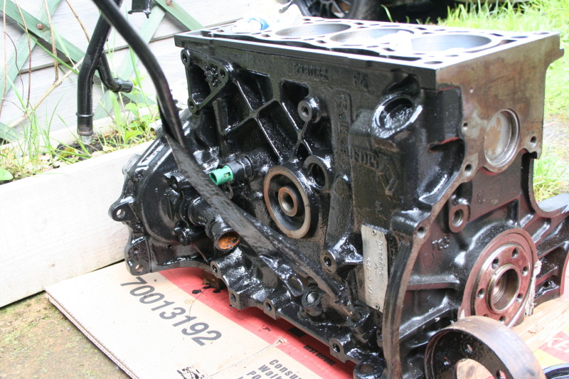

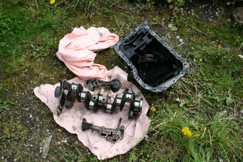

sump off, oil pump out and main bearing caps removed so I could lift the crank out, again I'm keeping this for spares in case I need it as there's nowt wrong with it, good used crank, one careless turbo owner ;-)
and bare cracked block ready for scrappage or ressurection. I really cant part with it so I have a feeling it shall be reborn as a coffee table for the new house ļ

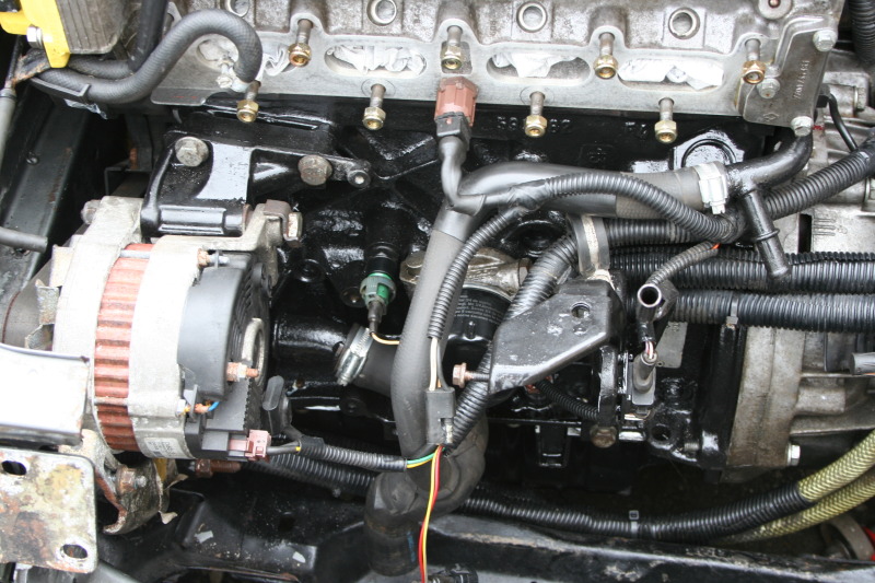

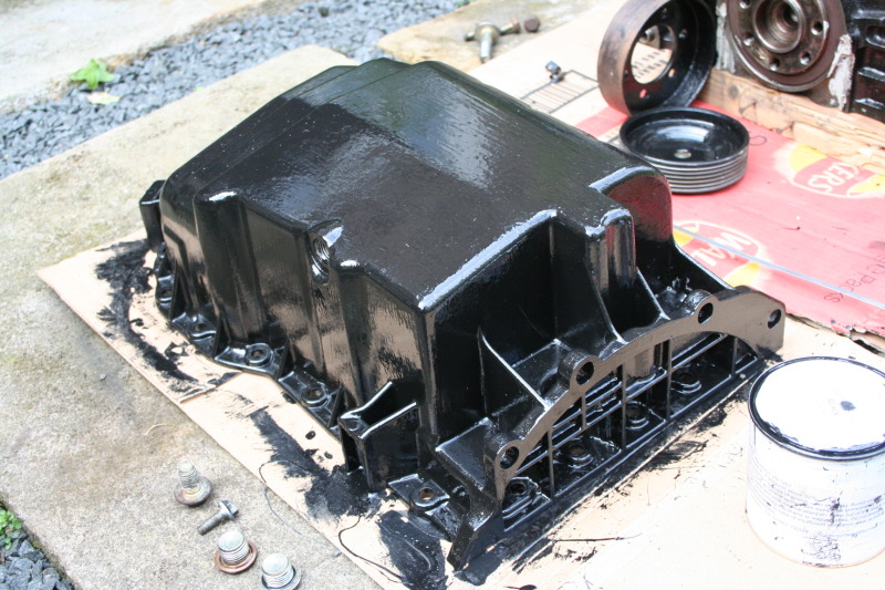

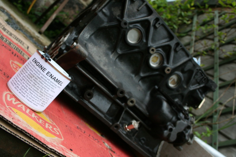

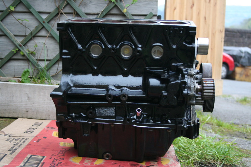

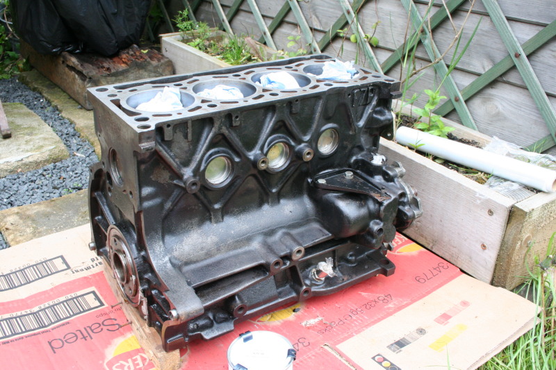

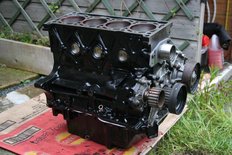

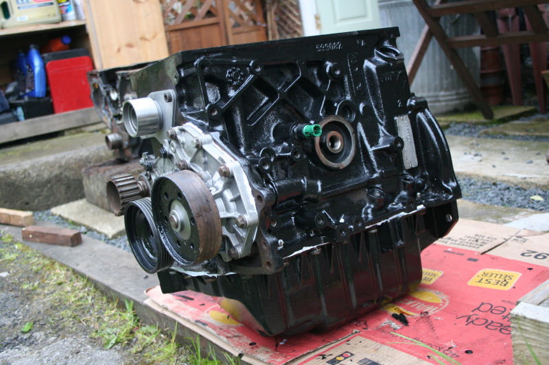

I then set about cleaning up the new block, removed the sump for painting and to allow me to access the crank to fit the rods etc
and the plan unfolds, time for a lick of paint me thinks!
first coat on and done, I ended up doing 2 coats on engine and the sump

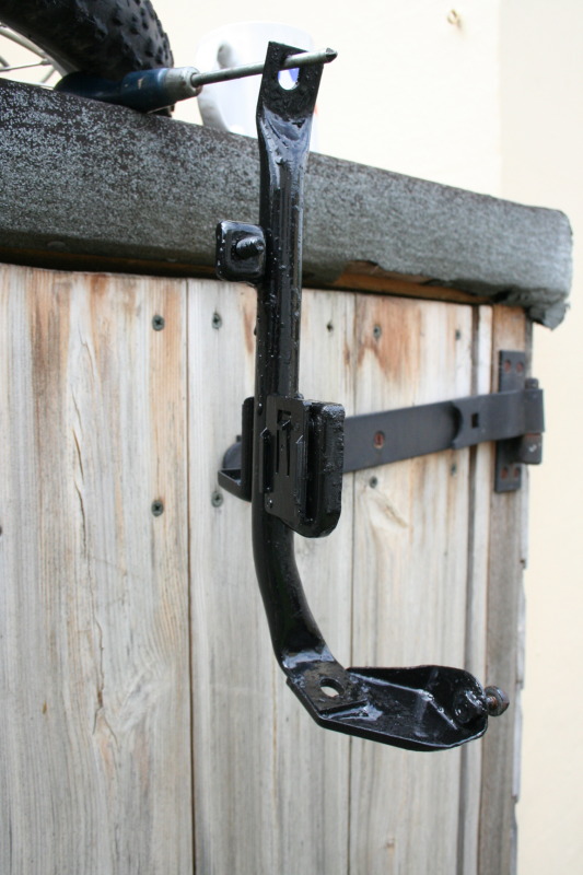

painted some other random bits as well, pic of one here but you get the idea, its all black!lol!

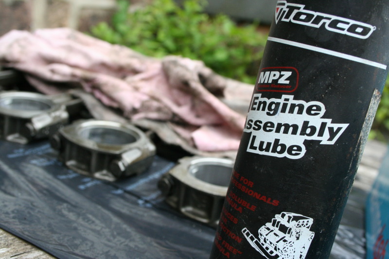

then used this
to put in these... (no wussy ring compressors either, I just used me mitts ;-)
and torqued up the end caps as well after running about trying to find the darn haynes manual!lol!

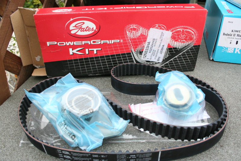

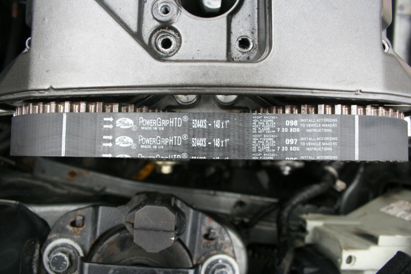

new cambelt kit from which I took the idler pully and affixed it to the block, along with new water pump that was on the old block (did about 5 miles on it!lol)

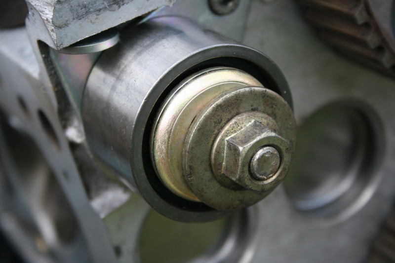

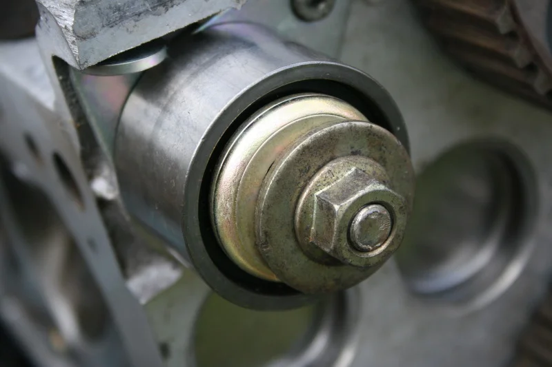

First job, build the head back up, so on went fresh gasket and exhaust manifold, then the turbo. I only put those two on as it means less work once heads on, turbo fitting is fiddly in situ, and by leaving inlet off I can have freedom to move engine about a lot in the bay to do the cam belt and also fit rest of the front of the car in, pipes etc :)
Fitted a shiny new tensioner pulley from the cambelt kit.

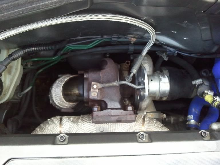

Proceeded to then fit the turbo oil feed/pressure sensor assembly and connect it up and also the oil return. I had already fitted the starter motor and slotted the downpipe in before the head was fitted. Also connected all the rear wiring loom up before head went in and popped dogbone mounting plate half on to give me some wiggle room.

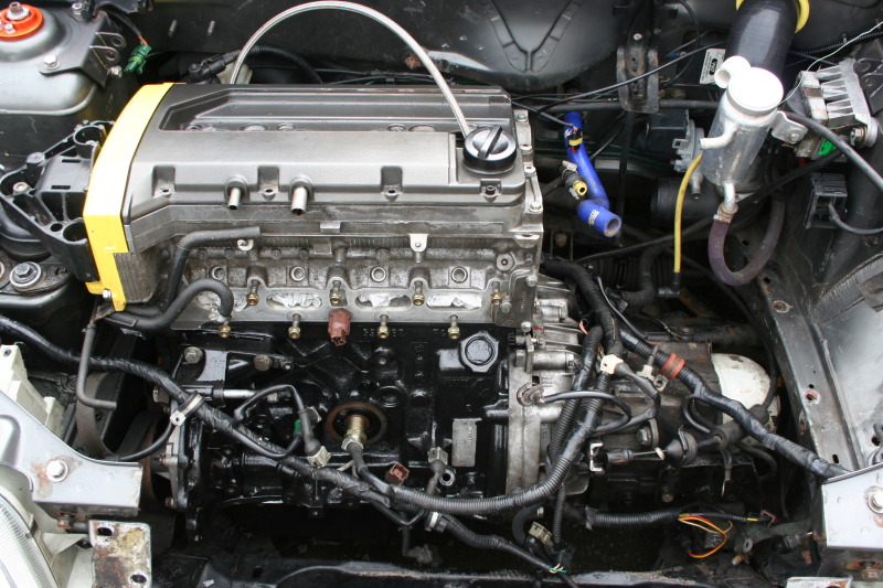

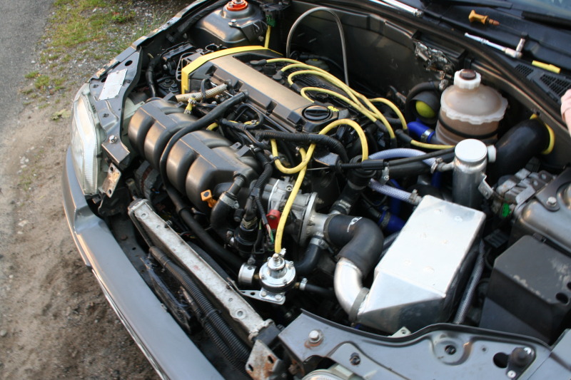

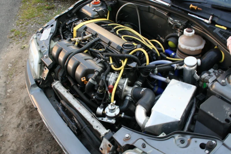

right, she lives!
spent most of today running about acquiring the final bits i needed as somehow i misplaced my stat housing and some other bits, but Dan helped me out with the parts i needed :)
so after a run up to his i started about 3pm with actual work, cupla hours later she looked thusly
so time to crank it over and make some pressure in the oil system..................................fail.........couldnt get it to take for love nor money, no oil through the pump pickup.
big ron was over as well and after attempting to back fill the pump through the turbo oil feed and an hour or so of messing about i gave up :-( Ron went home and i packed away........
but couldnt resist, so i splapped the king lead on and the fuel pump feed and just fired it up.....for a millisecond and turned it off. repeated it again and second time the oil warning light flickered off....YES!!!!
so whipped king off and fuel pump and cranked it, and low and behold i got pressure in the system in a couple of cranks after the fire up!
vids of fail then win!lol!!! had to jump it as the battery was totally dead, excuse the loudness, no exhaust system atm so straight out the downpipe!

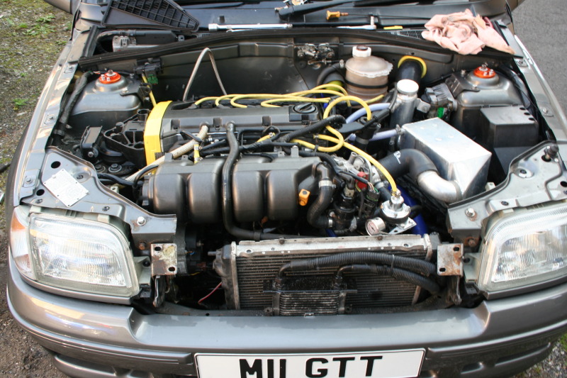

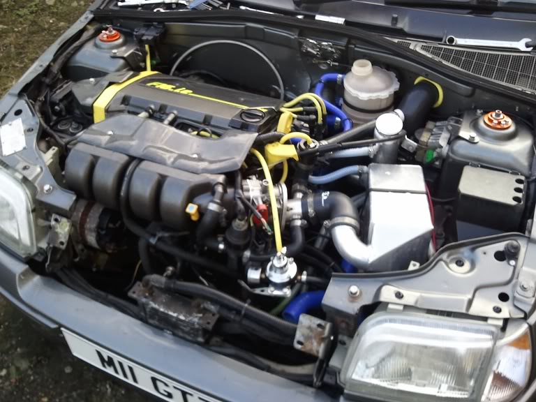

and this is how it stands now
chuffed its all running, had a bit of a fail as my oil cooler sandwich plate pipework was pissing oil out, nipped up and sorted, but i still have a water leak to find and fix but overall its working! got clutch and gears and brakes as well.
so few more hours tinkering and sorting stuff and it'll be MOT time :)

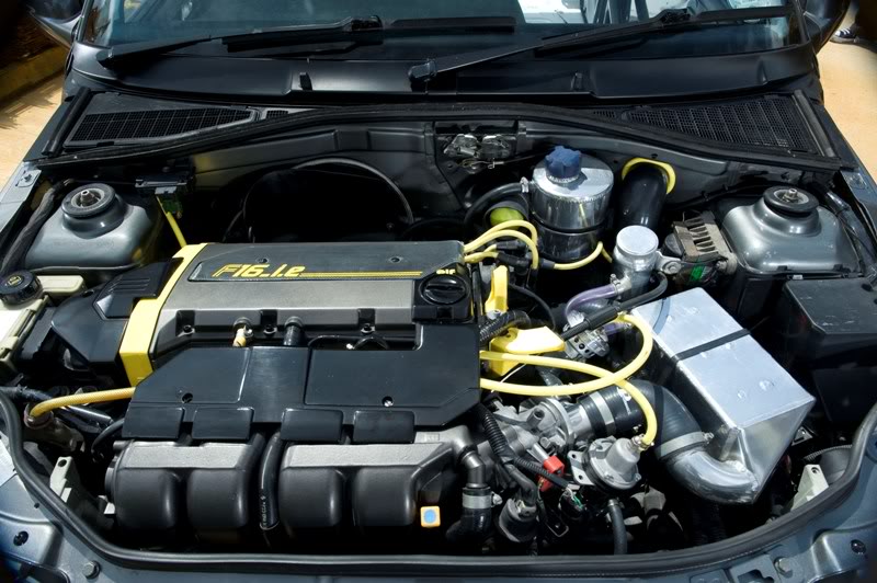

Right and that's it! Cars been running a dream for a while now, did Blyton park last month and it ran faultlessly all day bar boiling the brake fluid a lot!
pulled 258bhp on the rollers on the same day, literally drove off track and onto the RR, so car was a tad warm and I think its an underestimate as it feels as quick as last year. Off to pod on sunday, so we'll see I suppose!

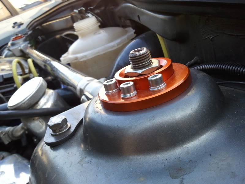

Small update
since Blyton park earlier in the year the brakes have felt awful, so this weekend I decided to investigate. firstly the rear bias valve was set completely wrong, slack as anything meaning little to know rear brake effort, enough for MOT but insufficient for what I want, so I stripped, cleaned and reset the adjustment assembly and regreased the arm on the valve itself so it was all nice and free.
secondly, I took out the old front pads, which pretty much fell apart upon removal, then popped some cheap as chips Volvo ferodo standard pads in, for testing. result is the vibration is still there so thinking I warped the new discs at blyton. as such I will order some decent front pads and new discs again next month
and finally, I found some dot 5.1 fluid in the shed, so I will do a brake fluid service sometime soon as well
whilst the wheels were off, decided to pop on the silver superlegs and clean up the black ones, so turb's will be bopping about on these for a bit :)
cheers
