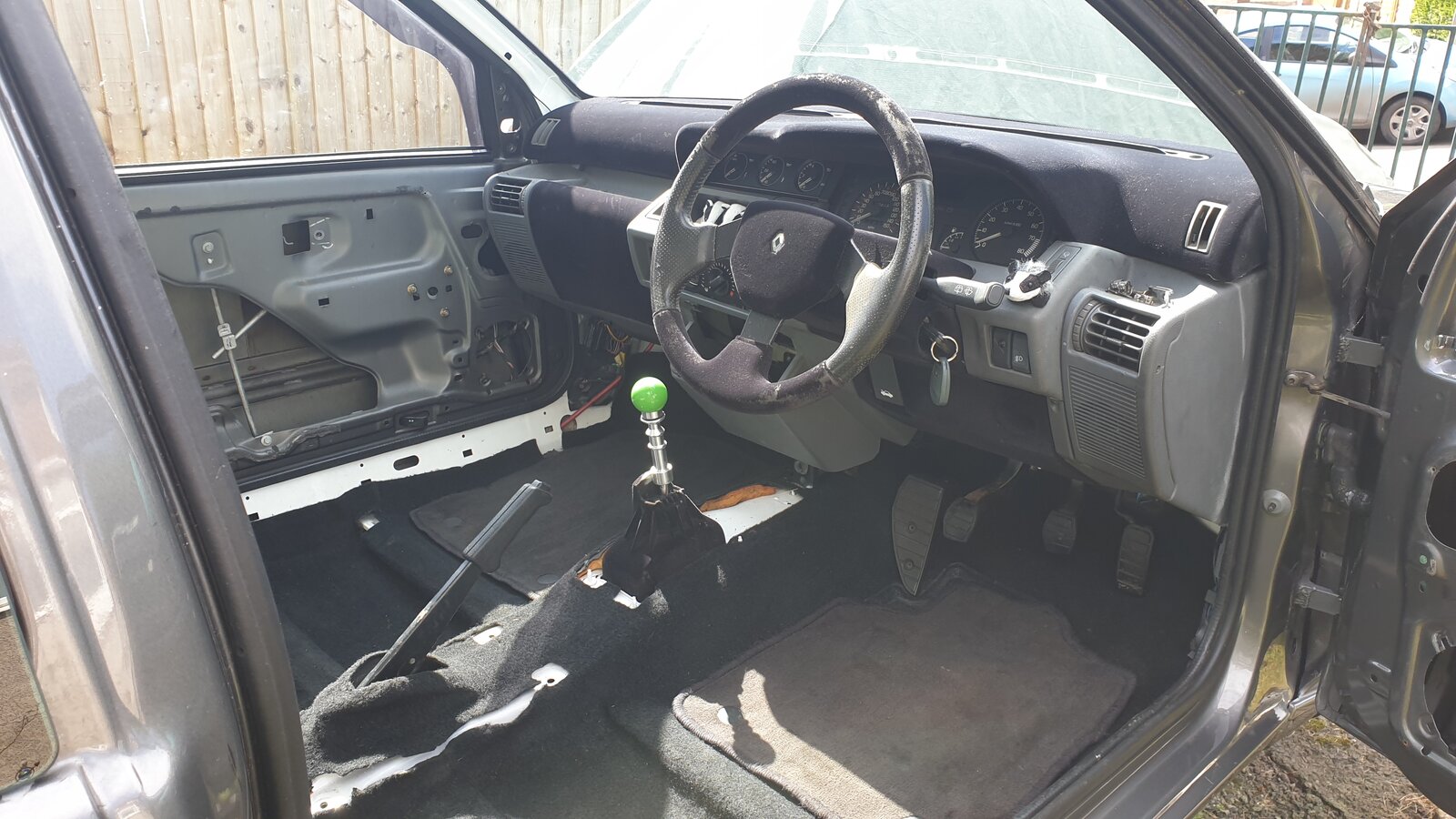

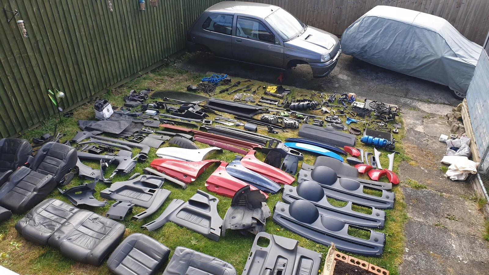

Right, time to start this one again. Unpacked the shell for first time in 5 years, inventoried everything and reorganised into stuff I need and stuff that's not currently required.
Dug out the front suspension stuff almost in it's entirety and will make a list of stuff I need to complete the job this week.

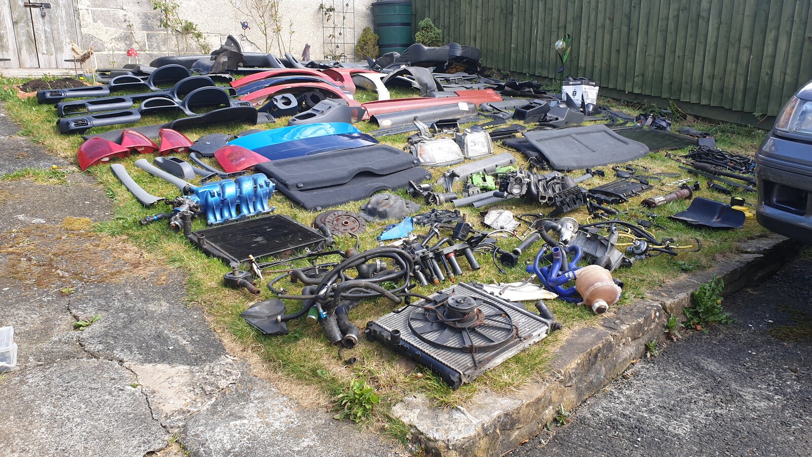

Few pics of progress, firstly dug everything out the car and laid it all out on the lawn to see what I have

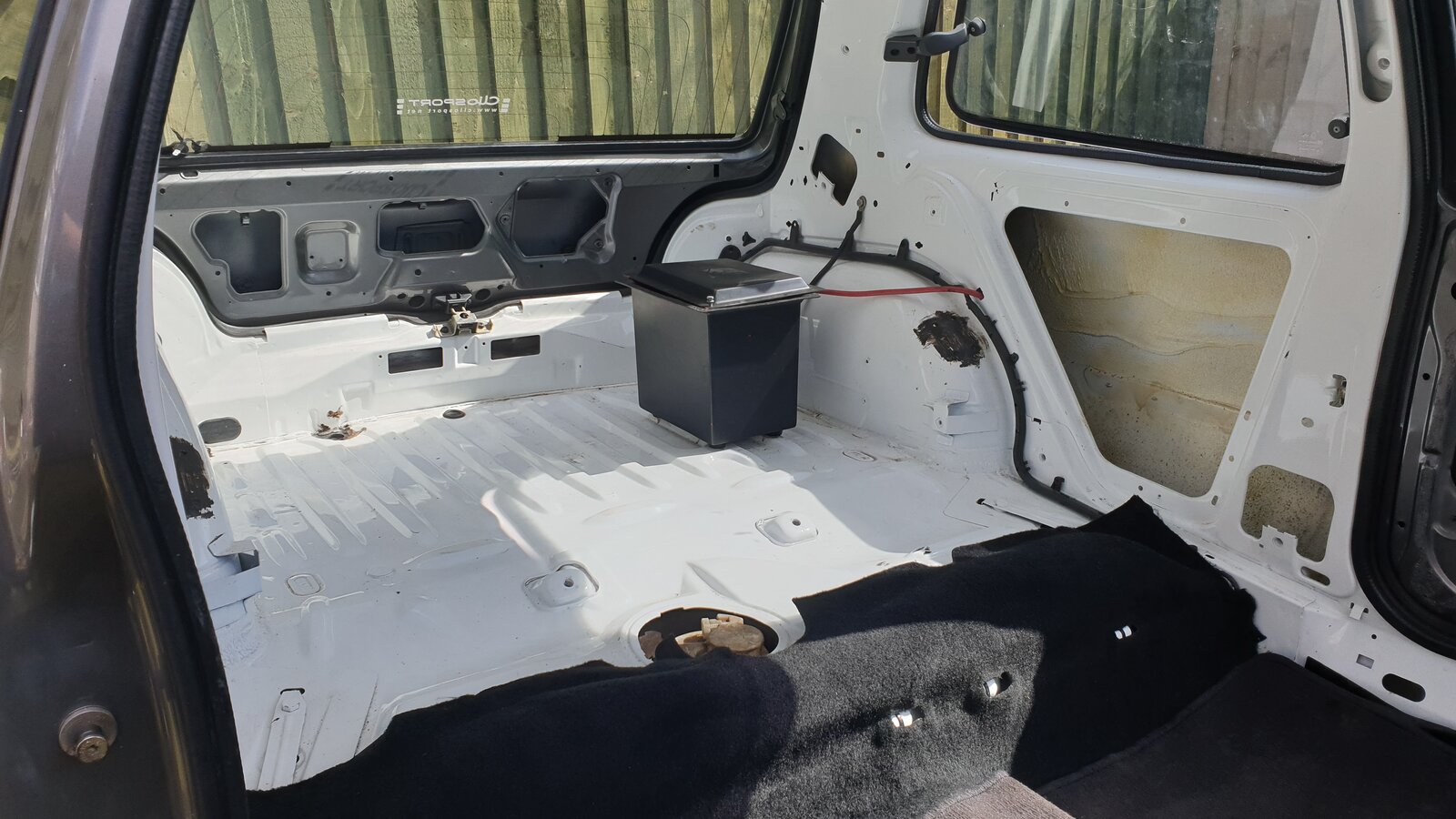

Then cleaned the interior up

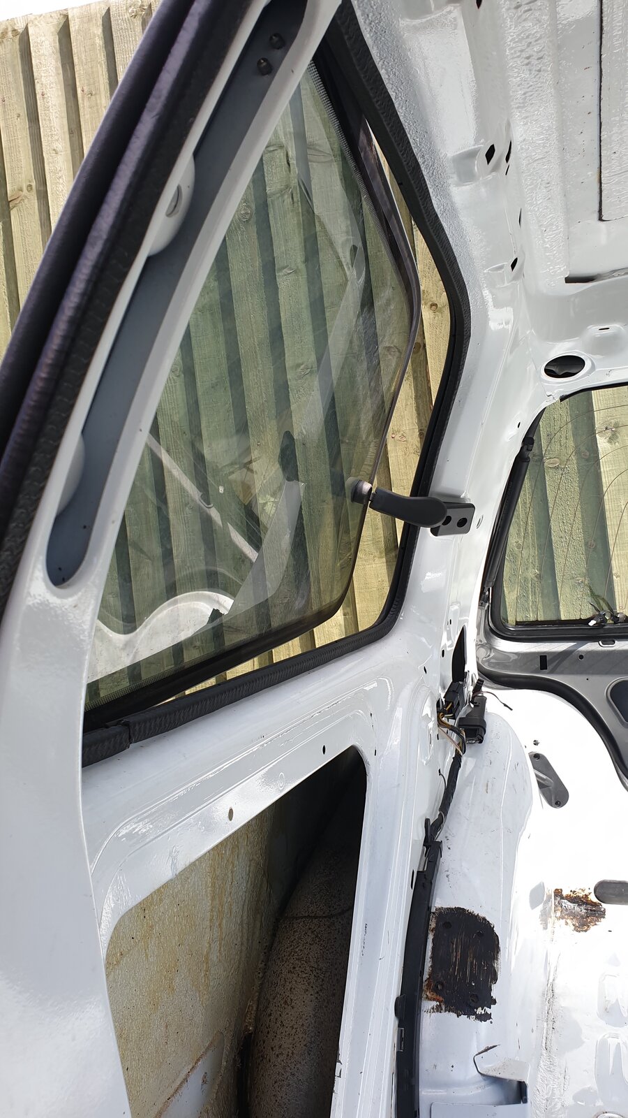

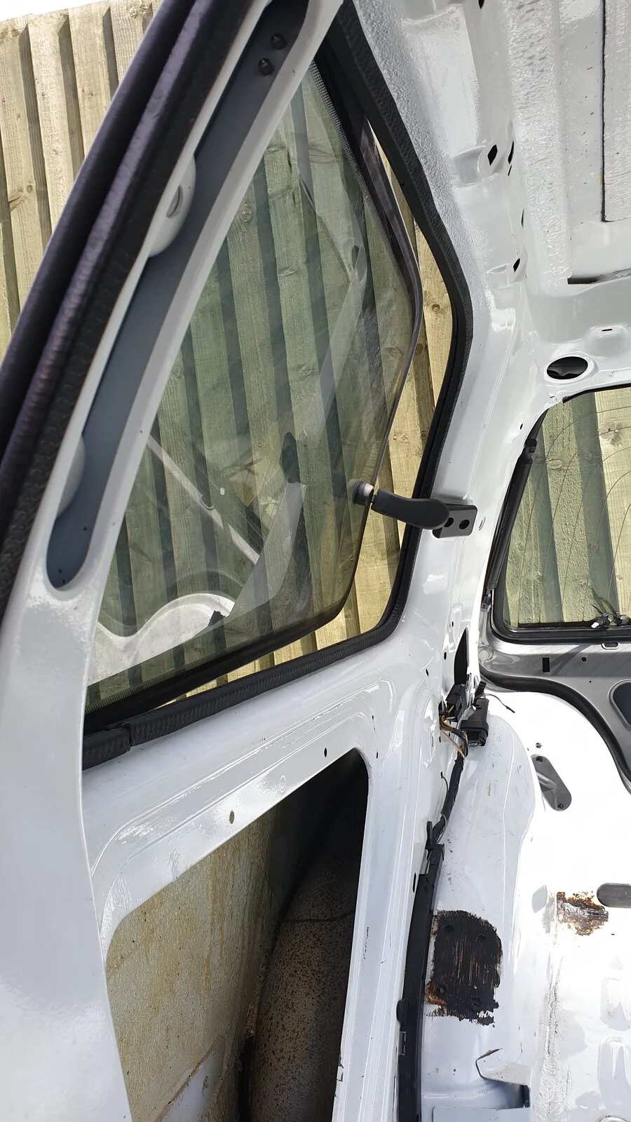

Pop out rear windows, one of my favourite mk1 features, old skool cool

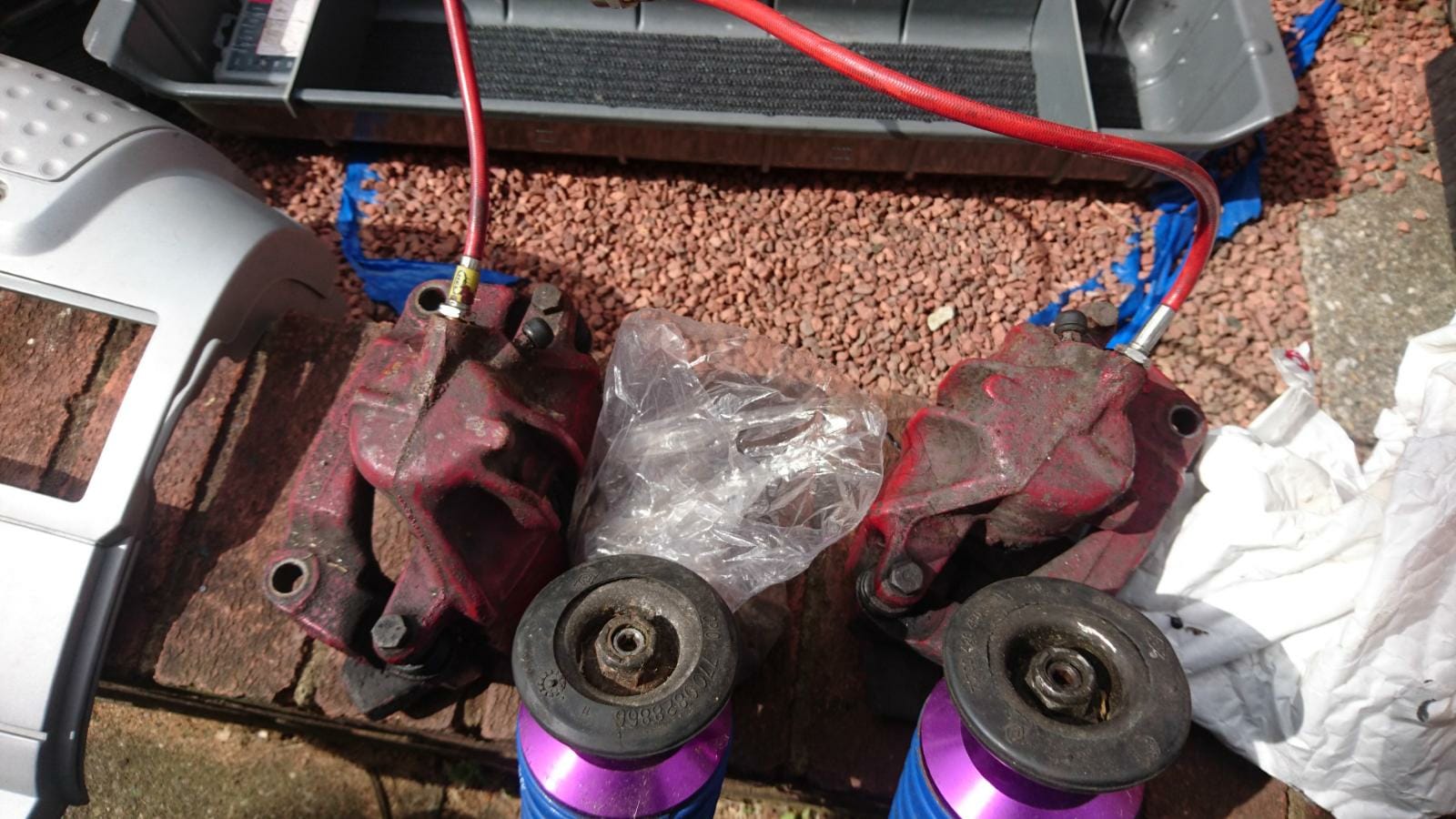

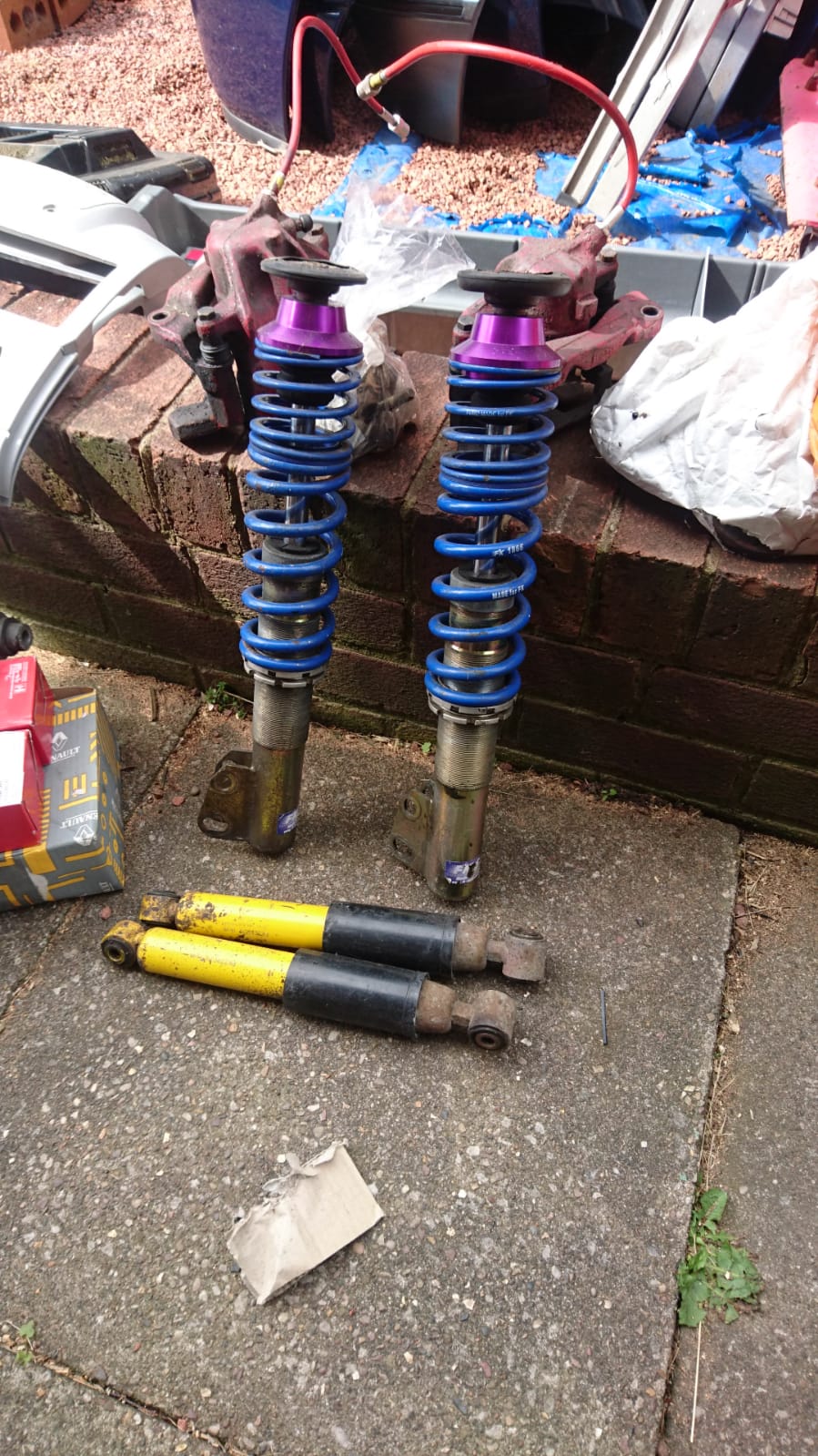

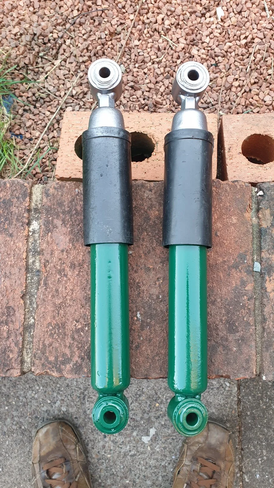

After sifting through all that lot I've found most of the bits I need, then I delved into the sheds to get the shiny bits for the front end build.

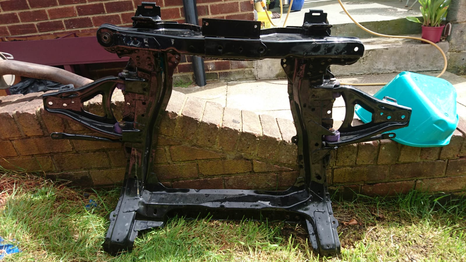

Powdercoated subframe with 172 arms and arb (not in pic), powerflex purple bushes all round
FK coilovers
ACS roll correction kit

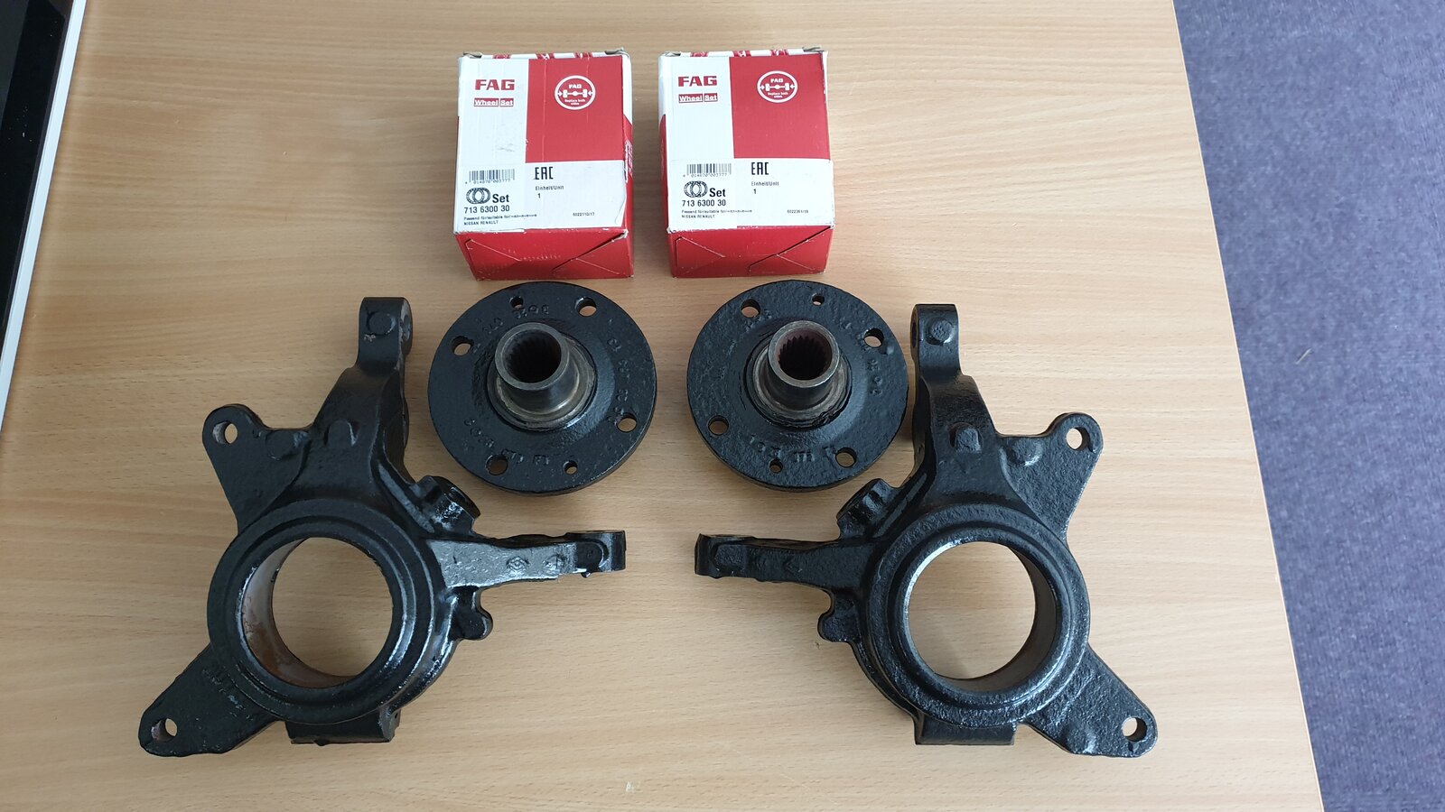

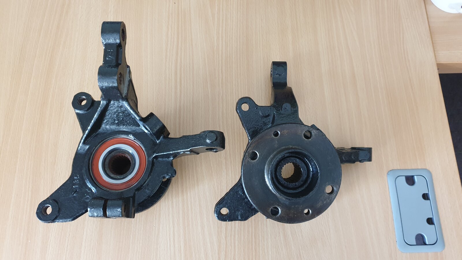

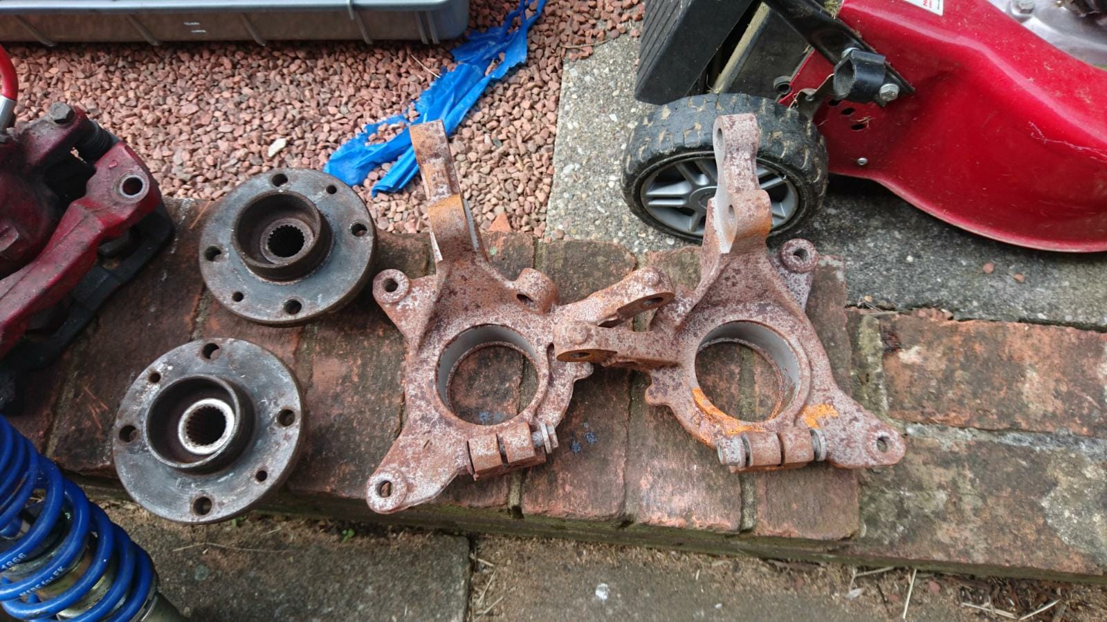

172 Hubs with mod to fit mk1 struts

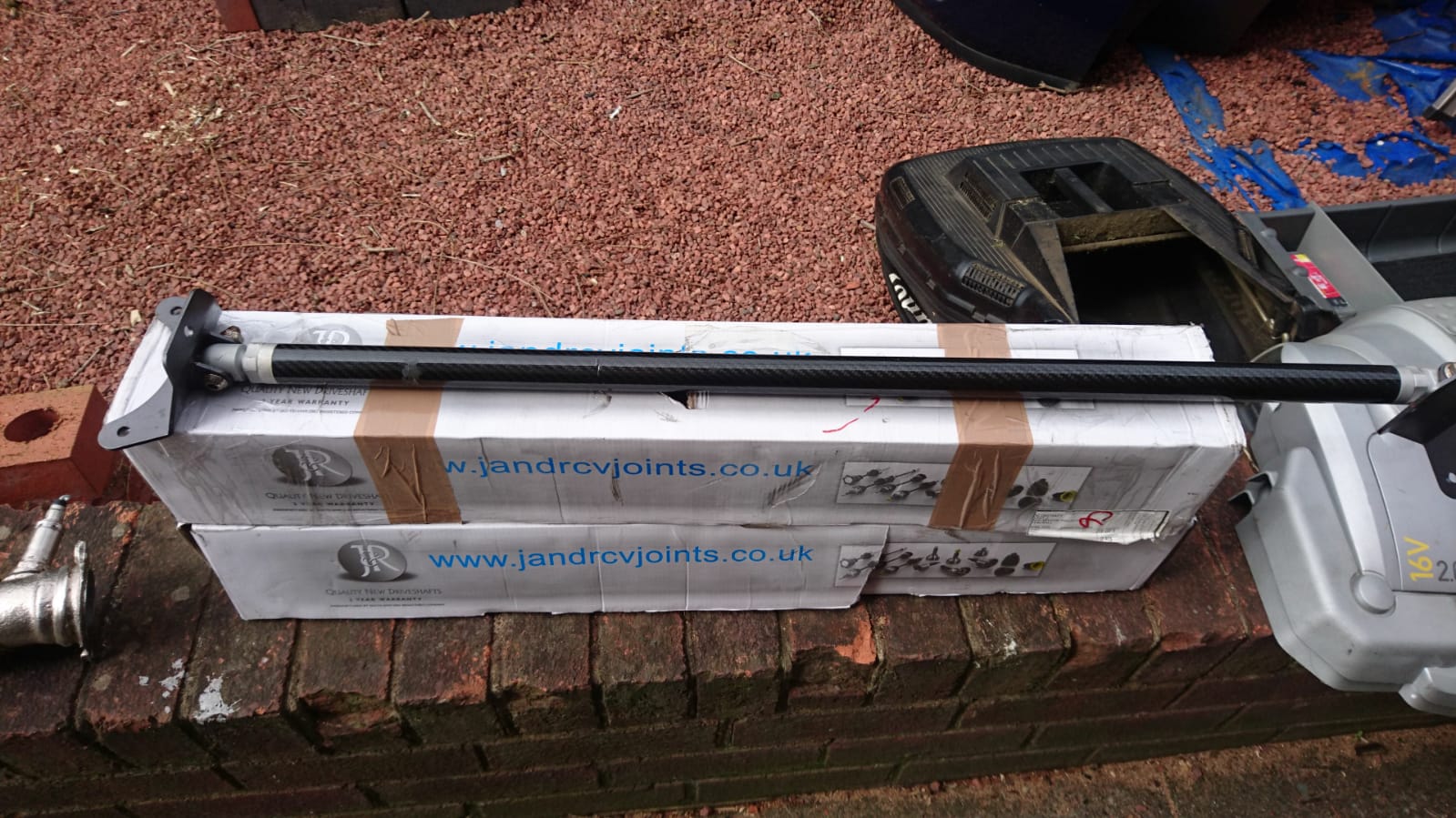

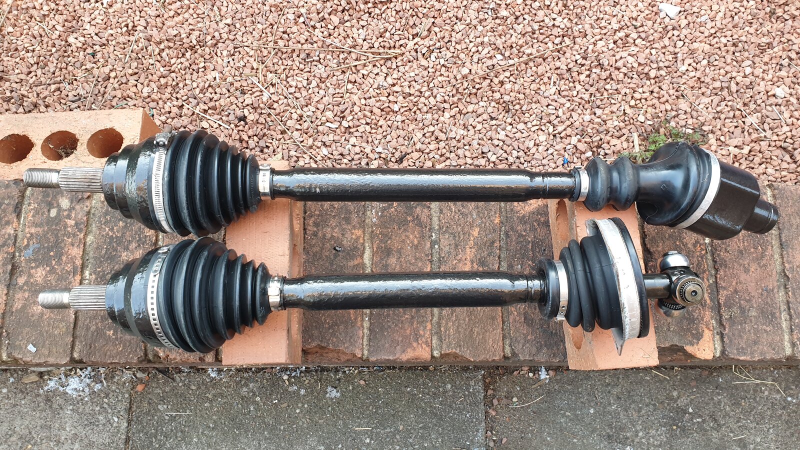

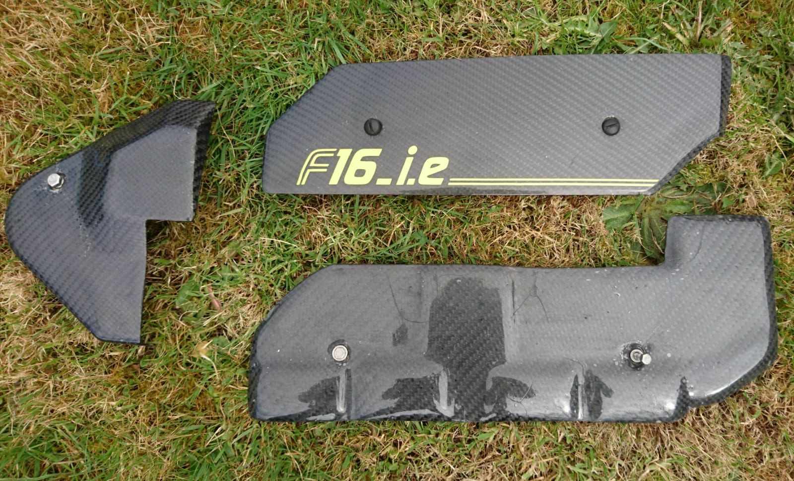

Phase 1 172 Driveshafts (and carbon dress brace)

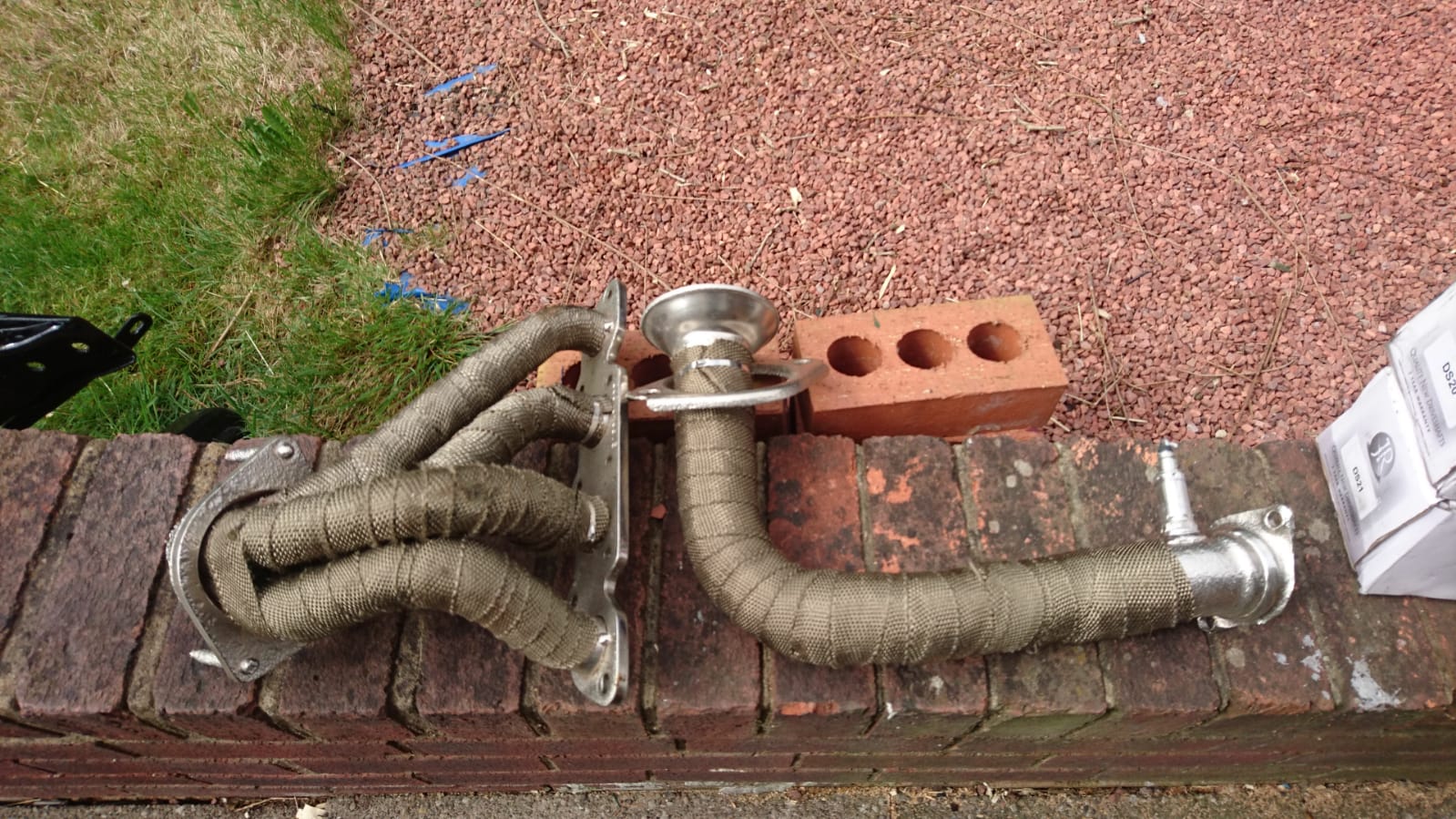

William's manifold and downpipe, coated and heat wrapped

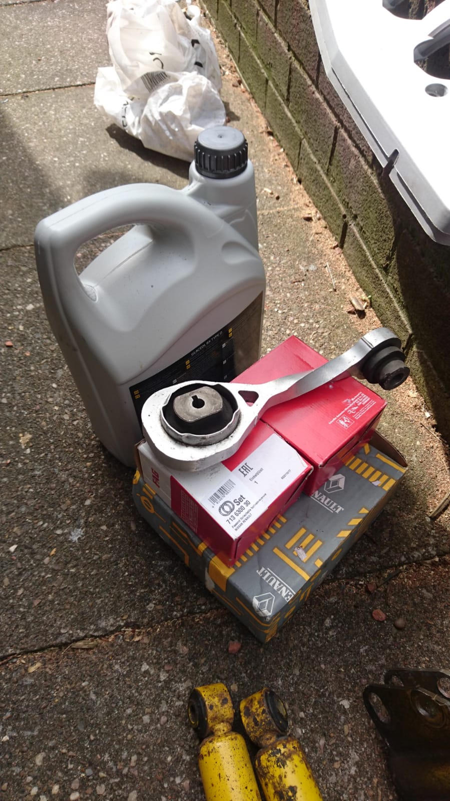

Cambelt kit, front wheel bearings, 172 dogbone engine mount and type d coolant

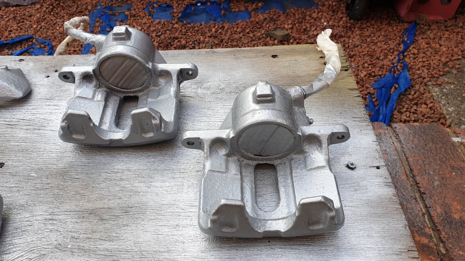

172 calipers and HEL braided lines

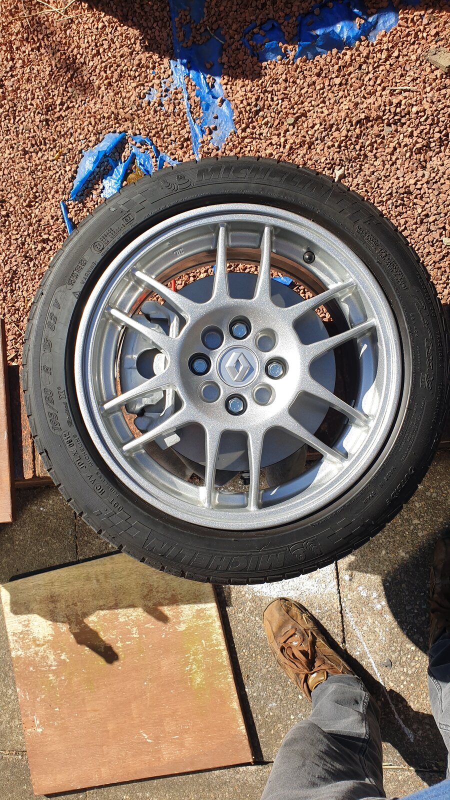

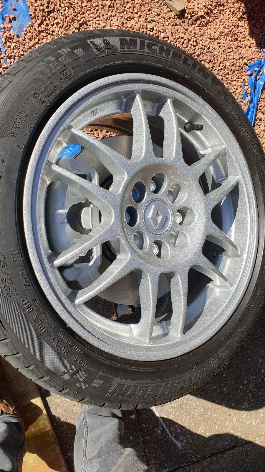

Sheila’s’ Wheels’
  Whichever has fuel

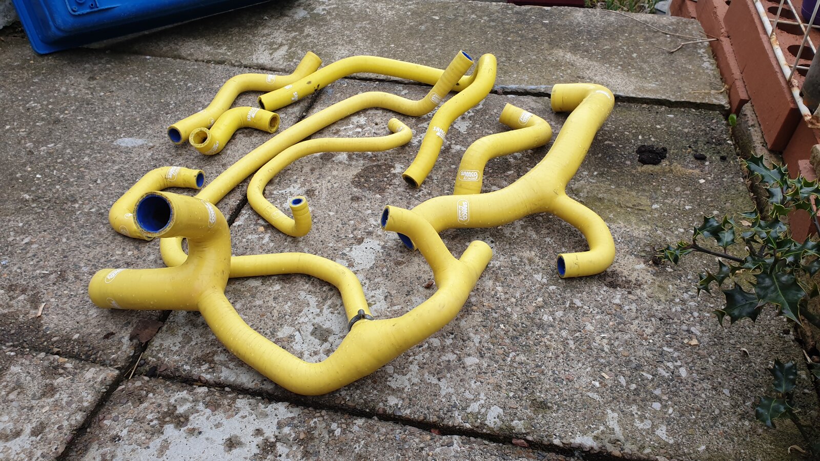

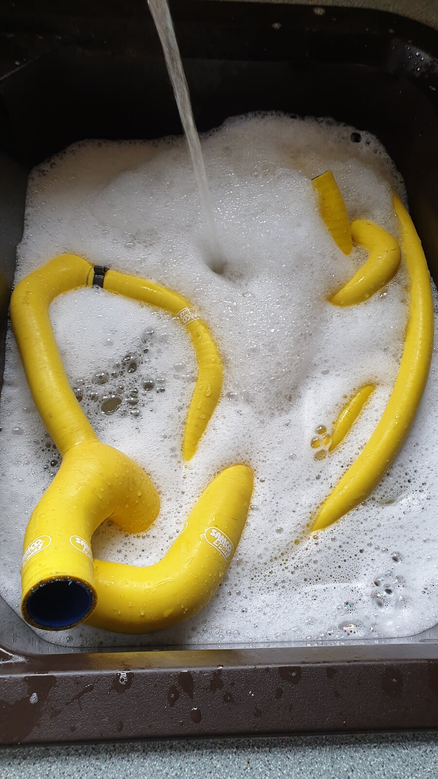

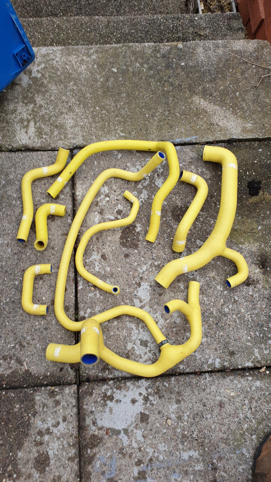

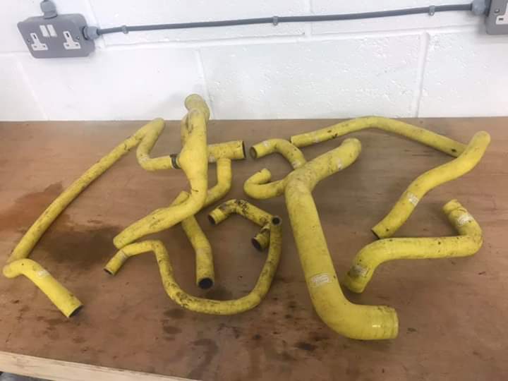

Bit more progress, cleaned up the bargain samco hoses, autoglym engine degreaser first, then soak in washing powder bath and quick scrub. Then many many rinsings
Come up lovely

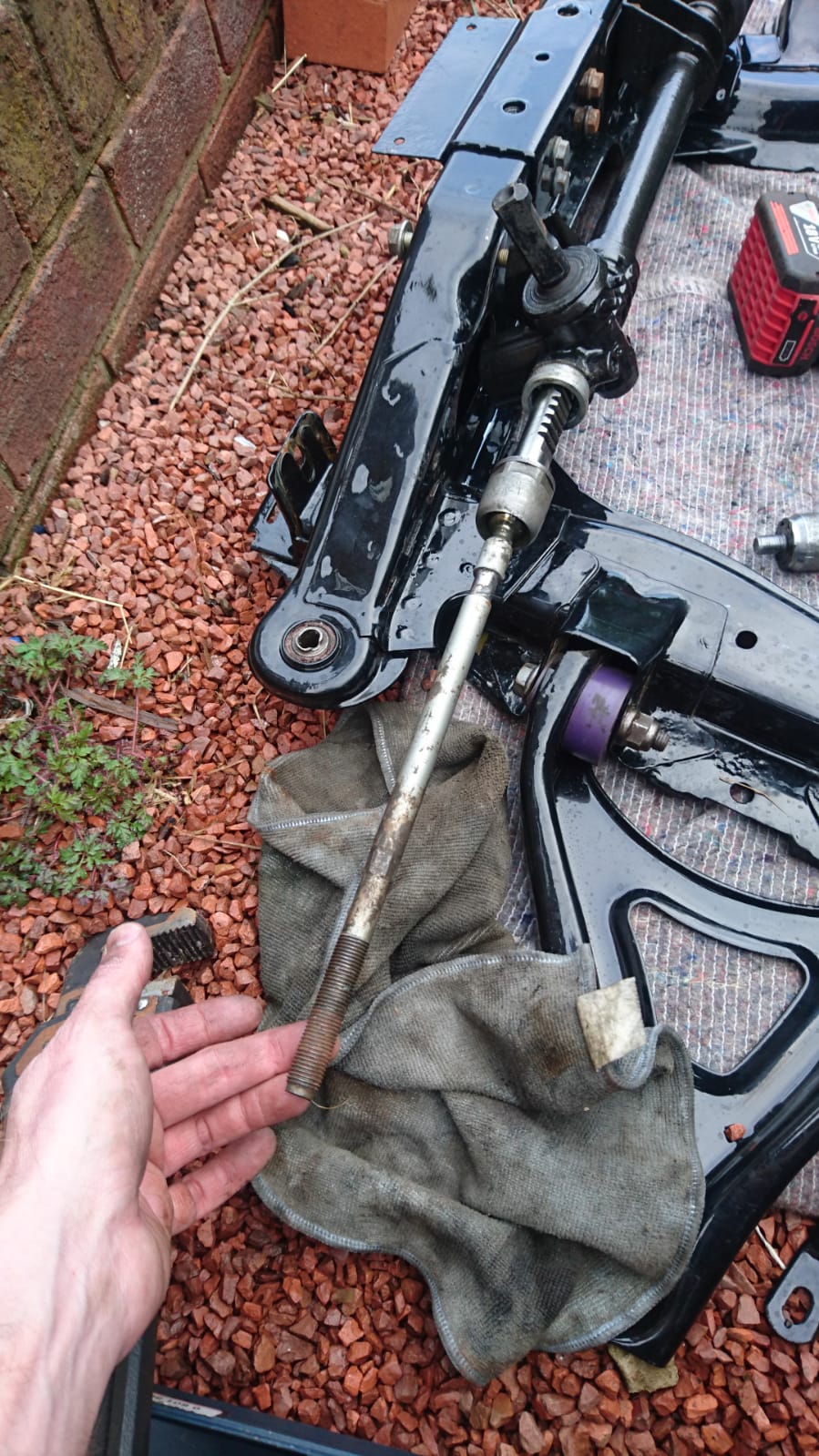

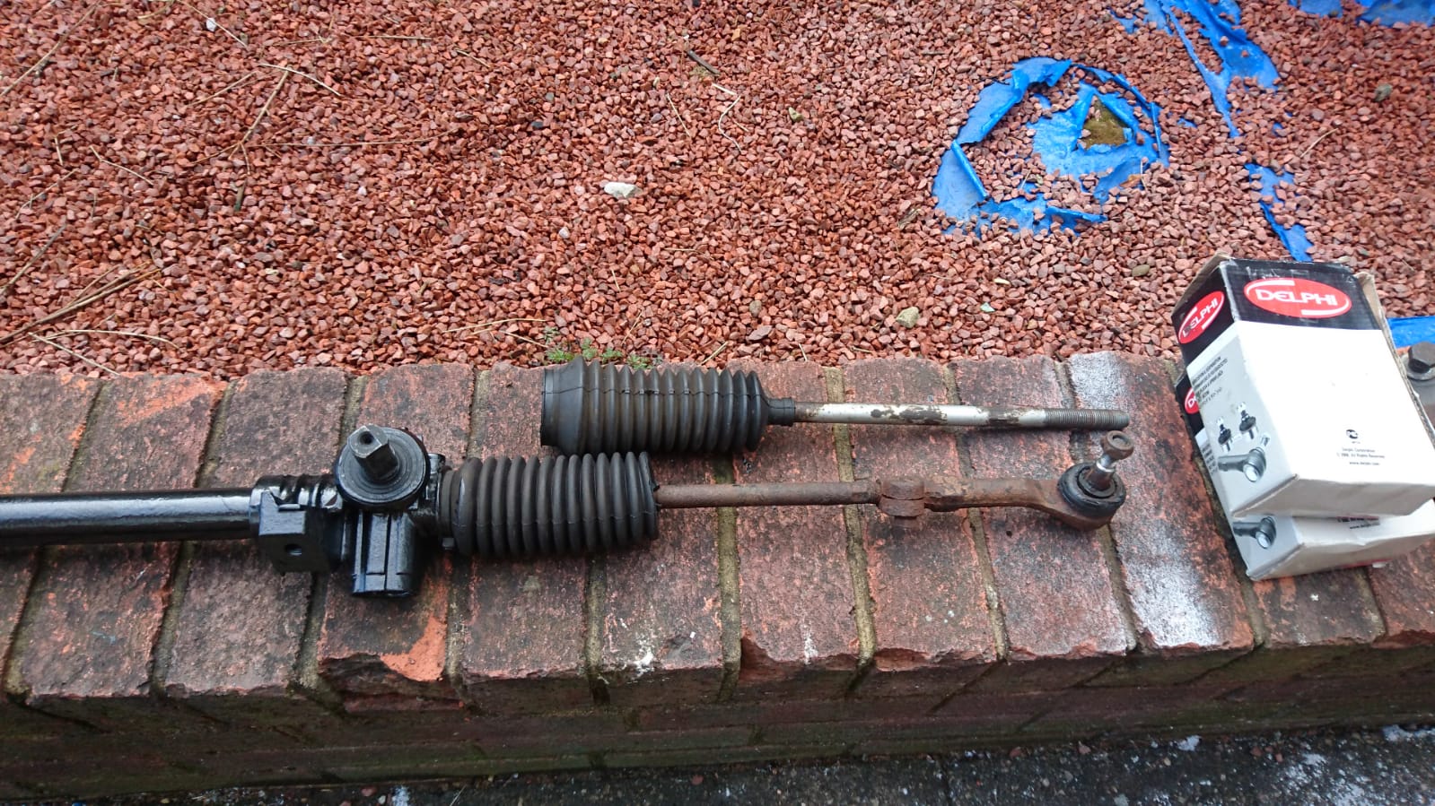

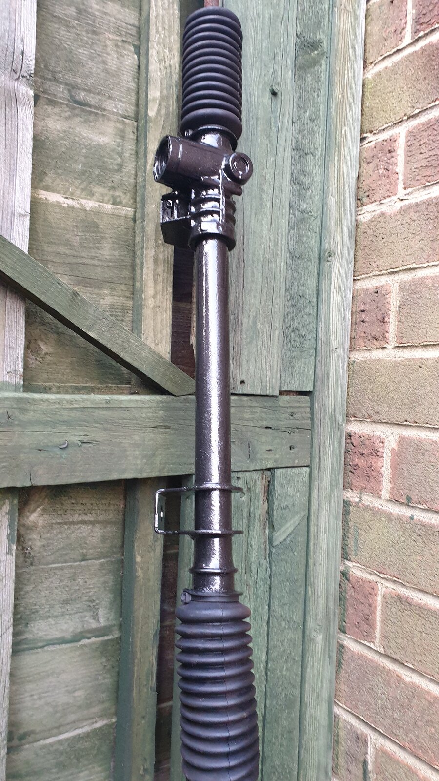

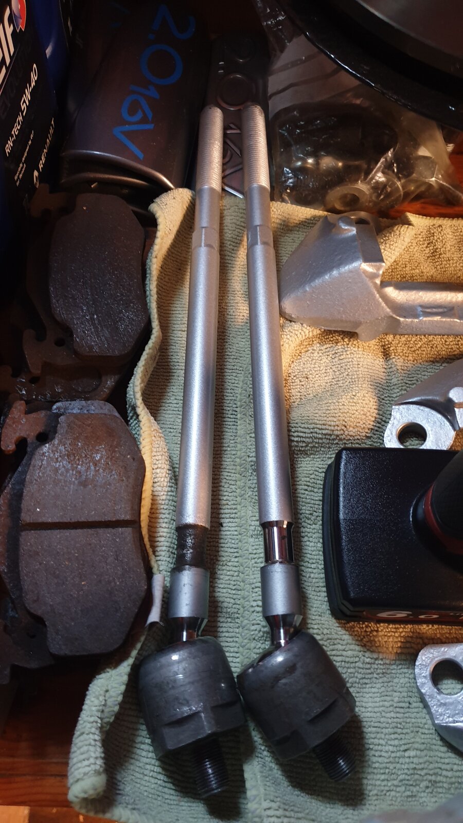

Then trial fitted the 172 inner rods to the mk1 manual rack and all good, so just need to acquire some new boots and then I can mock up the roll kit and check lengths to ensure it'll track up right.

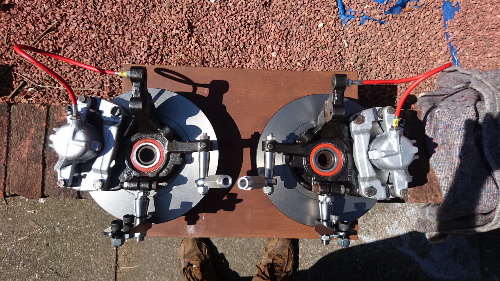

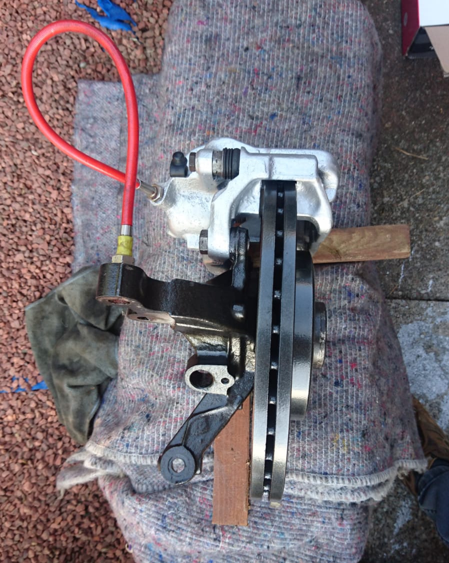

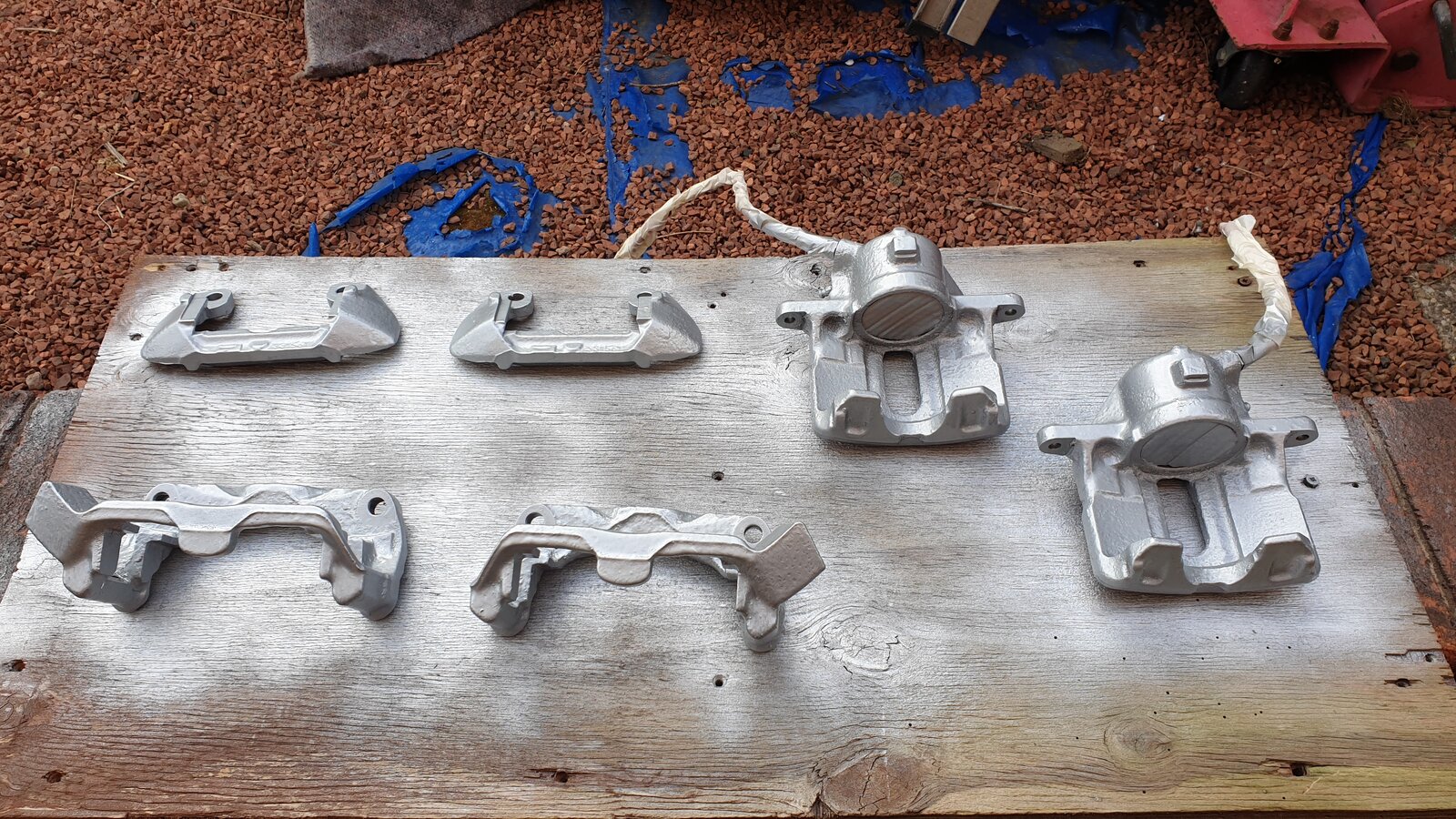

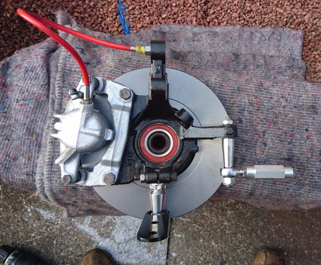

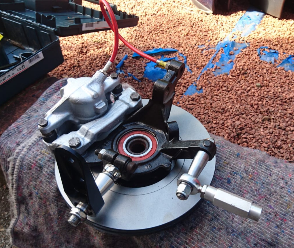

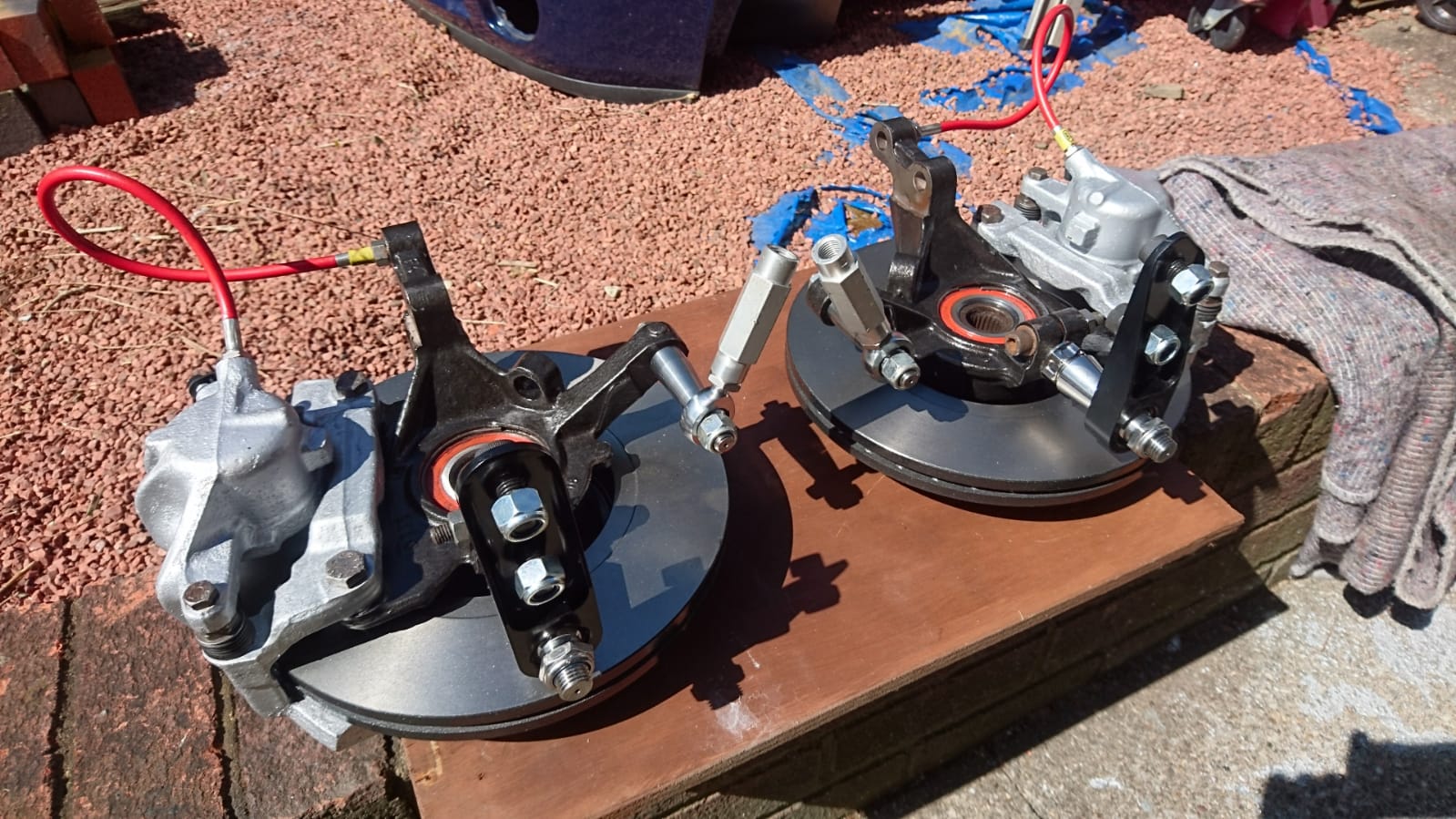

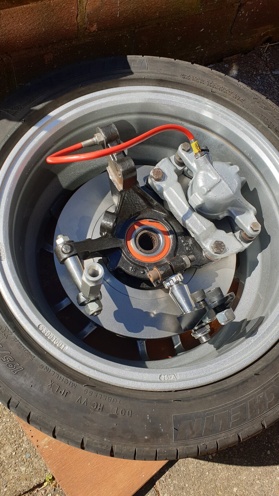

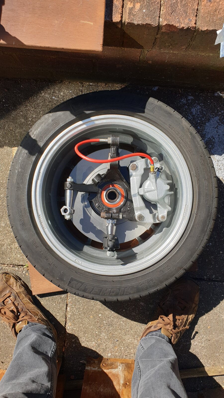

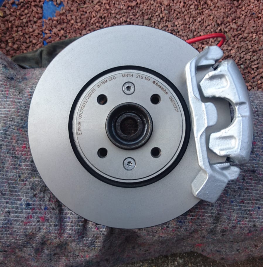

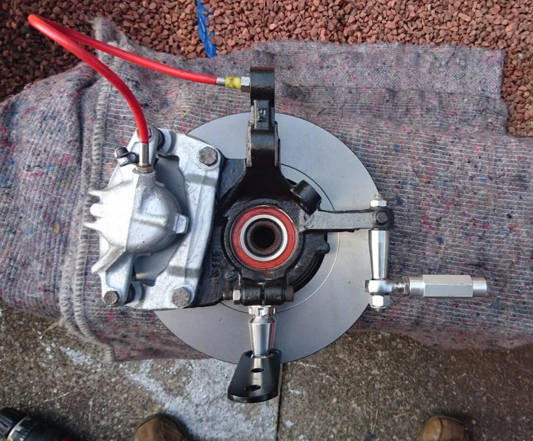

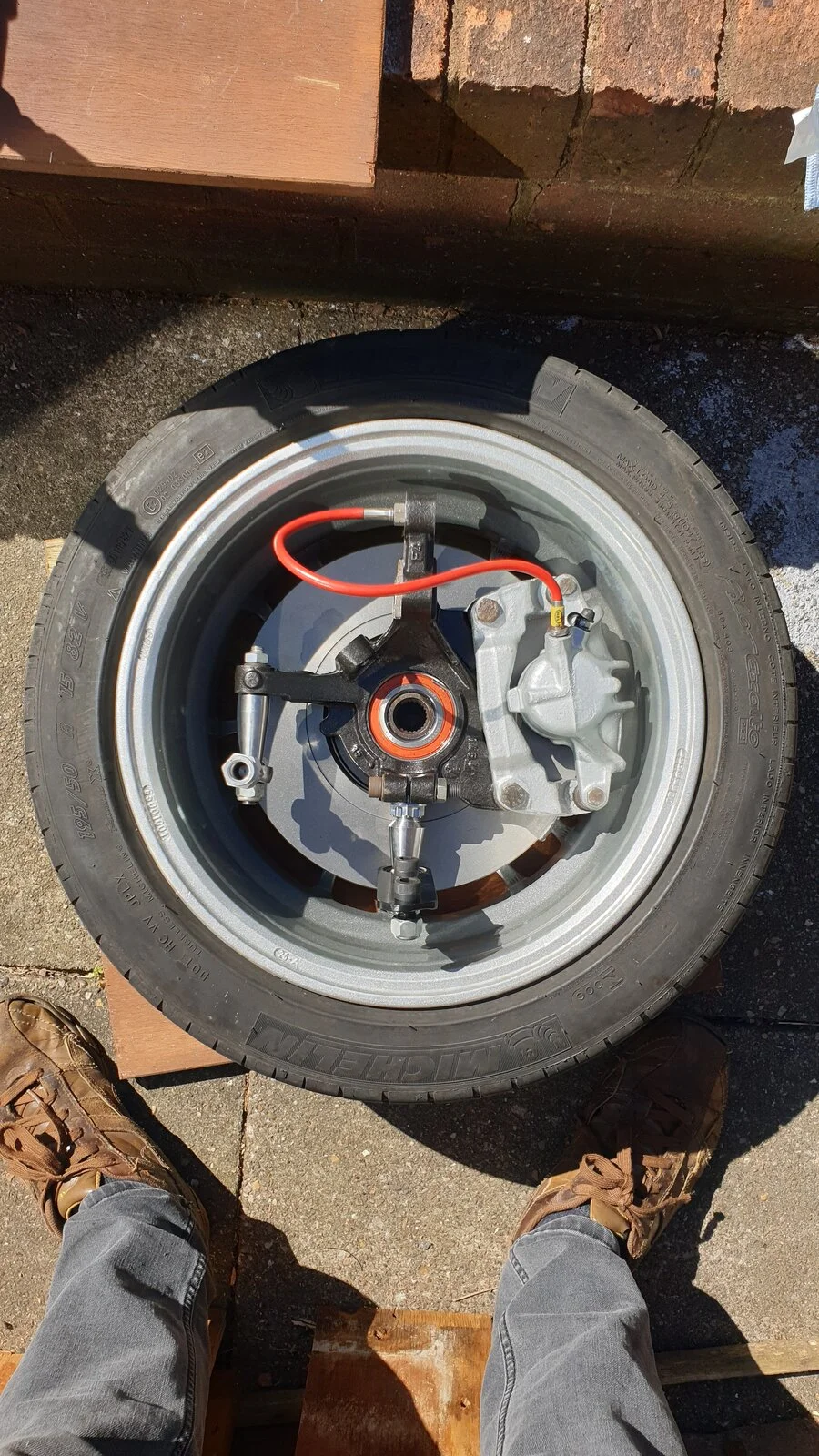

Built up the front hubs with calipers, discs, roll kit etc etc to test fit it all plus easier to store now too!

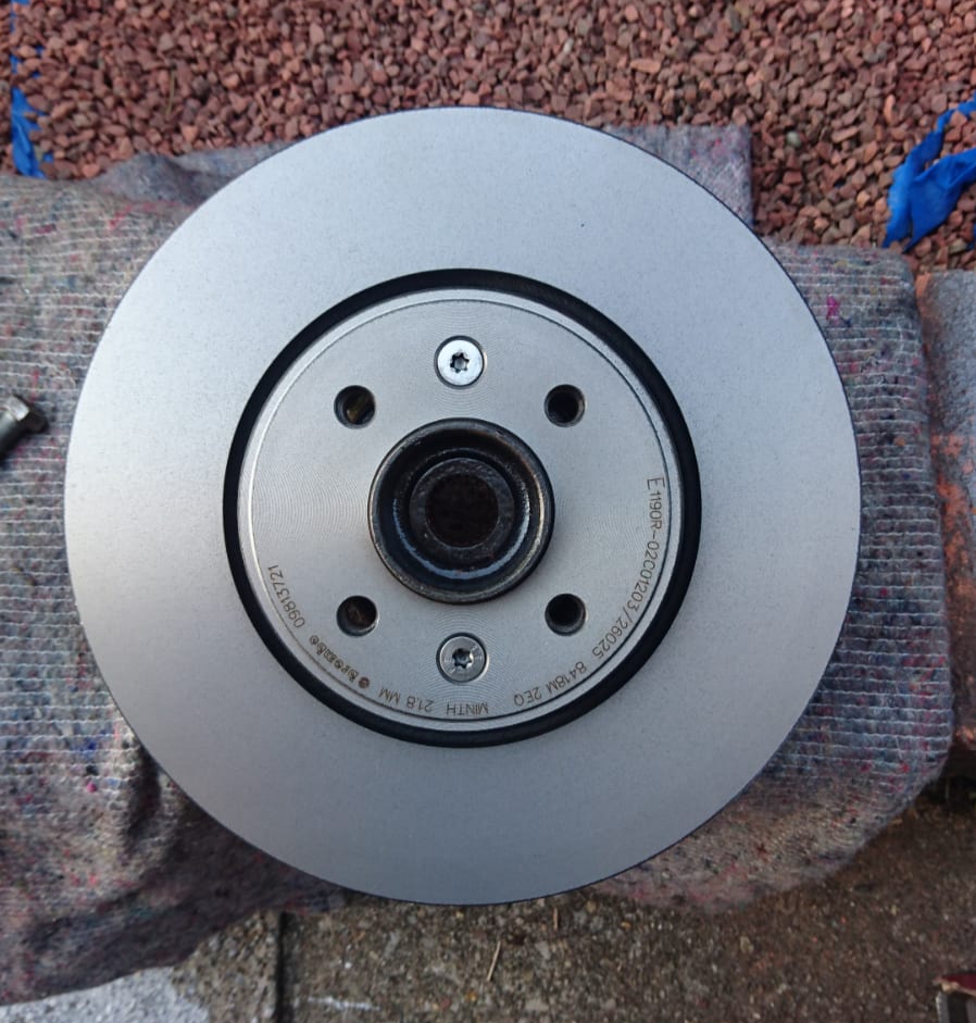

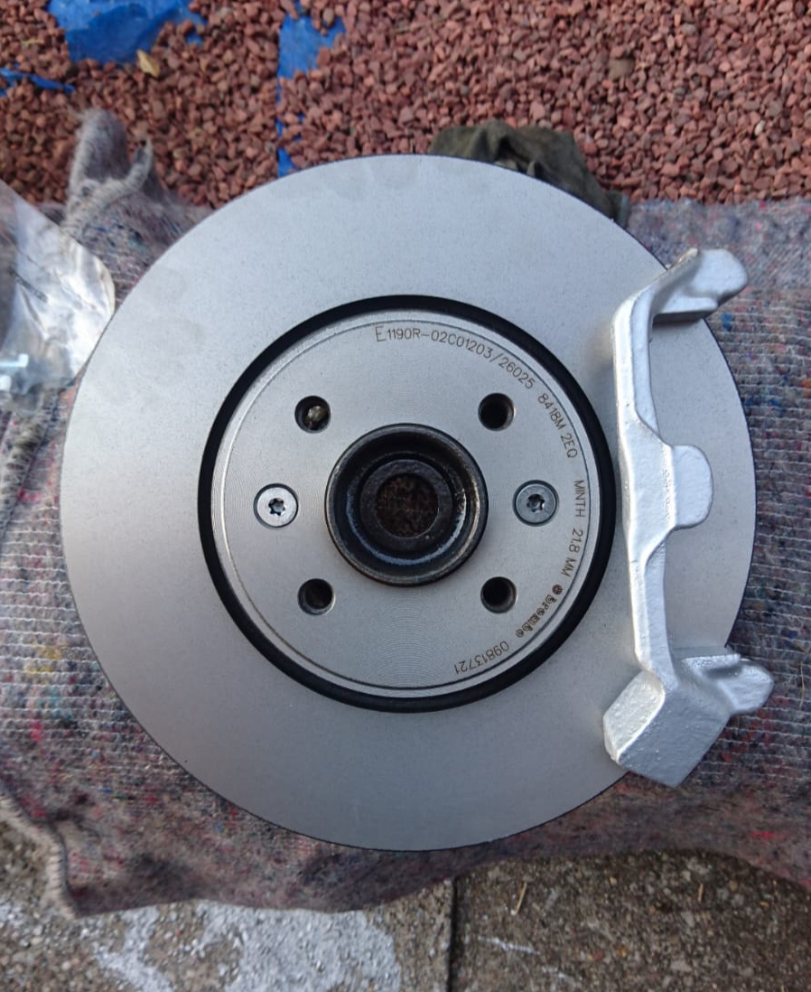

New Brembo disc fitted to hub, and cleaned up the grub screws
Caliper carrier fitted, cleaning up bolts and thread holes as we go

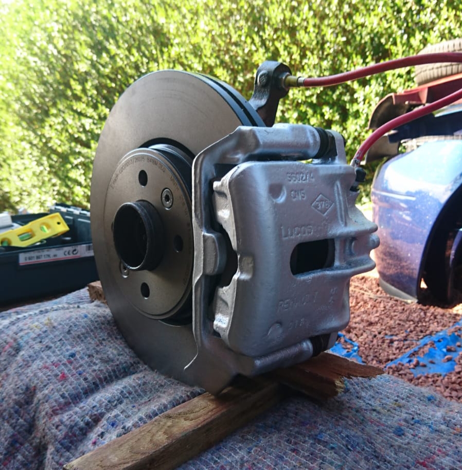

Caliper bolted up, sliders etc all cleaned and regressed

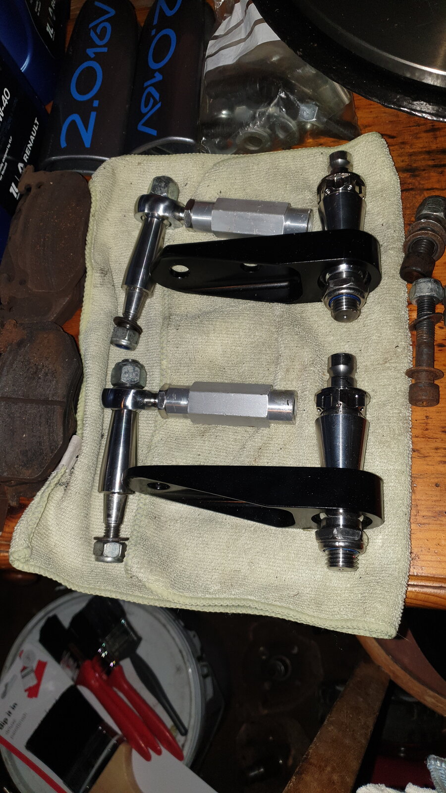

Then mocked up the roll kit onto first one hub..
And then both.
Ordered two new rack boots too so they should be here in the week along with the subframe bush......hopefully !

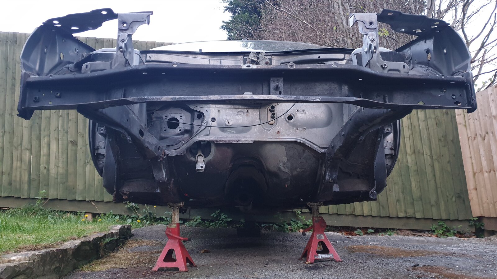

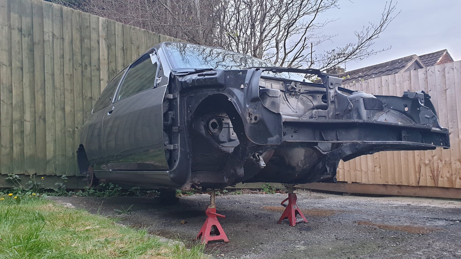

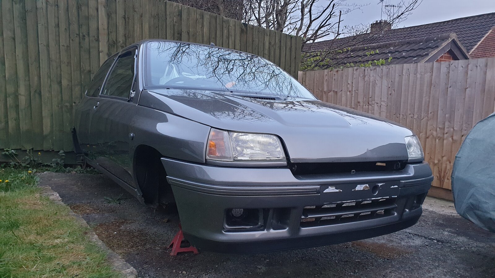

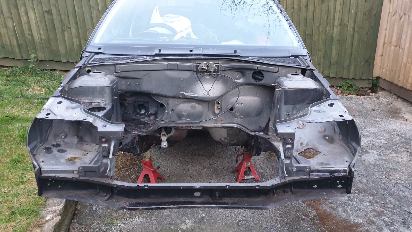

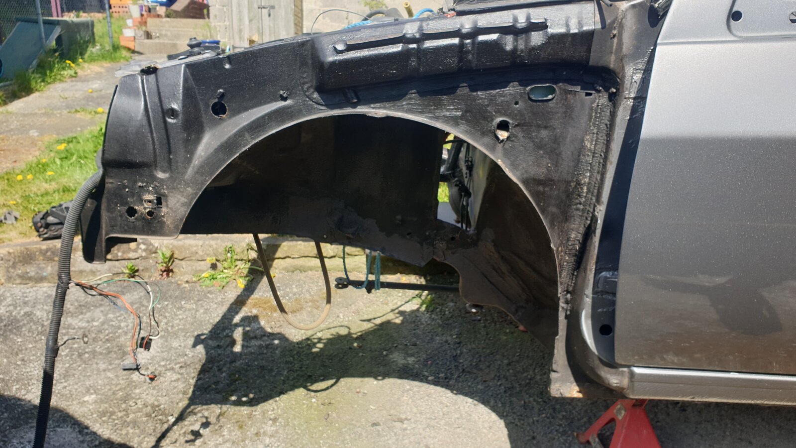

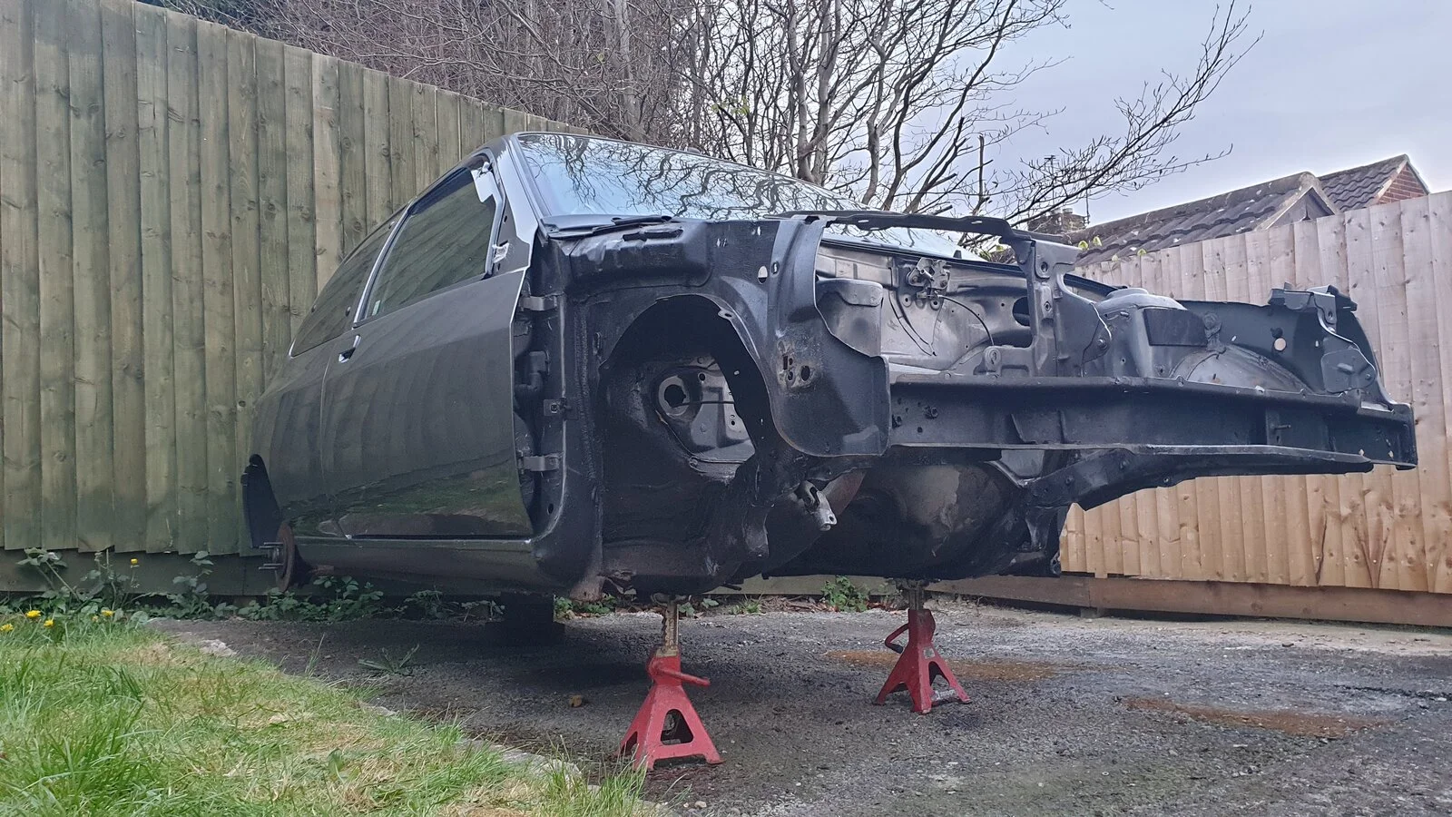

Right, reality just came and slapped me right in the f**king plums. The underside is just not pretty at all and there's little point going any further until it's sorted. I was getting too excited about refurbishing and buying new bolt on parts when in truth I was avoiding what I knew deep down awaited me 😭
As such, quick chat with mate about it and he's going to sort it.
Plan now is strip the entire underside of the car, remove rear beam, fuel tank, all lines, heatshields, everything.
I'll then refurb the beam and get the chassis rolling before sending to get sorted. Phase 1 will be engine bay and underside, then get her back, get her running and road legal. Then following at some point cosmetics on the rest of the chassis/panels.
I know I'm mad to even consider fixing it really, it'll cost waaaay more than its financially worth but the car means more than that to me, so it's getting done.

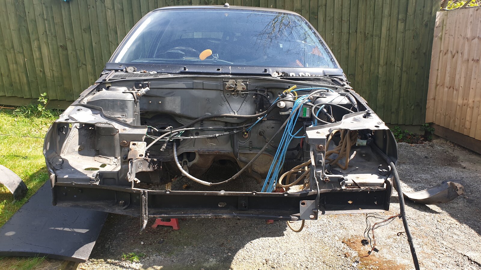

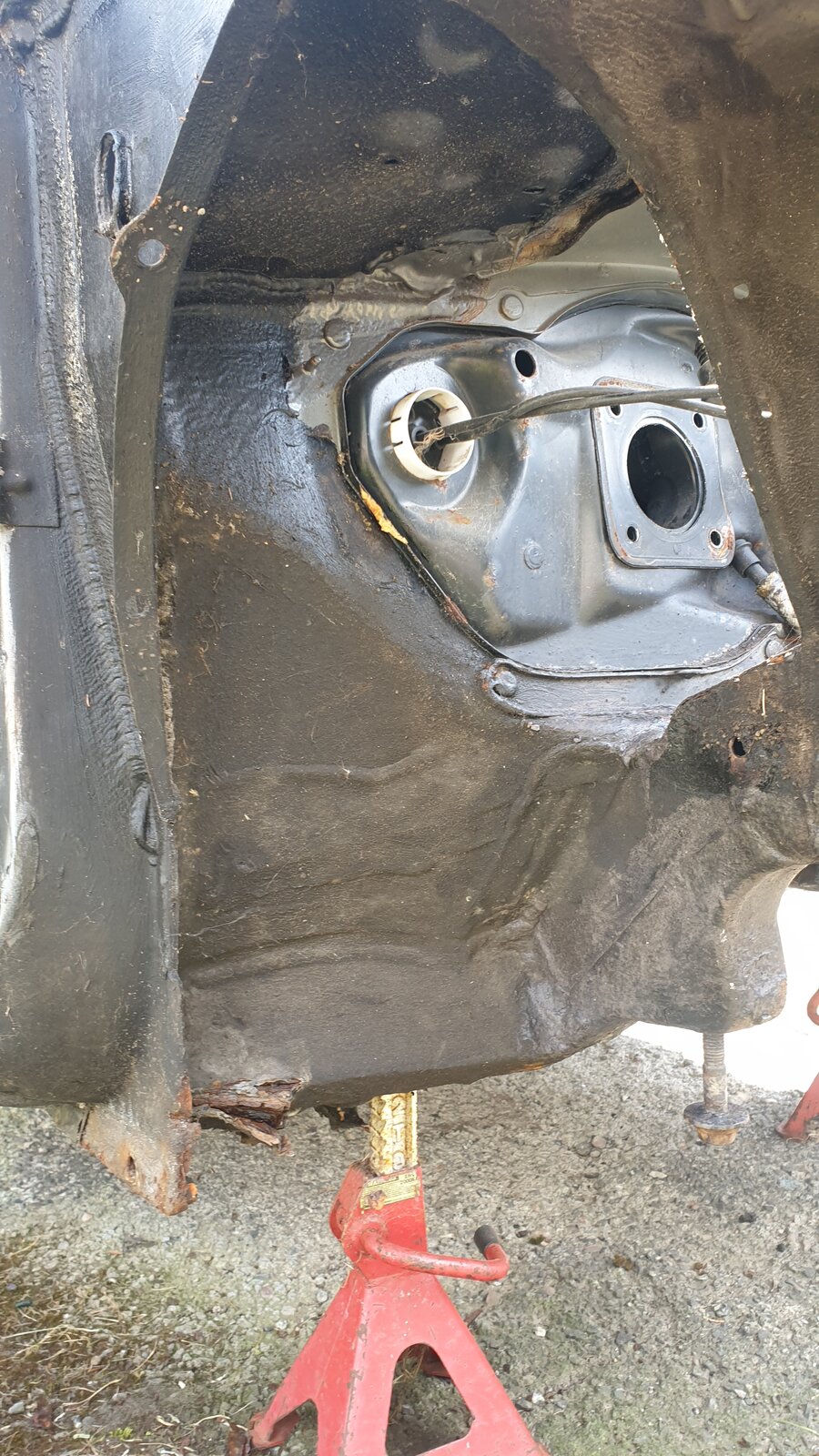

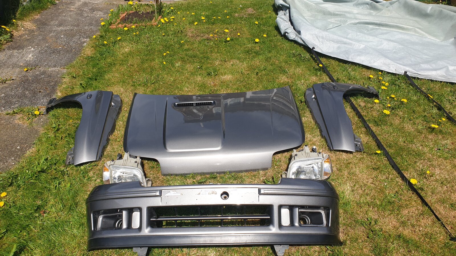

Anyway, here's some pictures from today's poking that led to this rethink on approach.

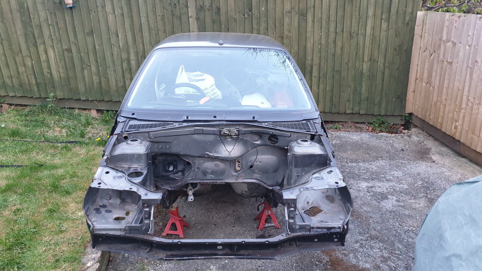

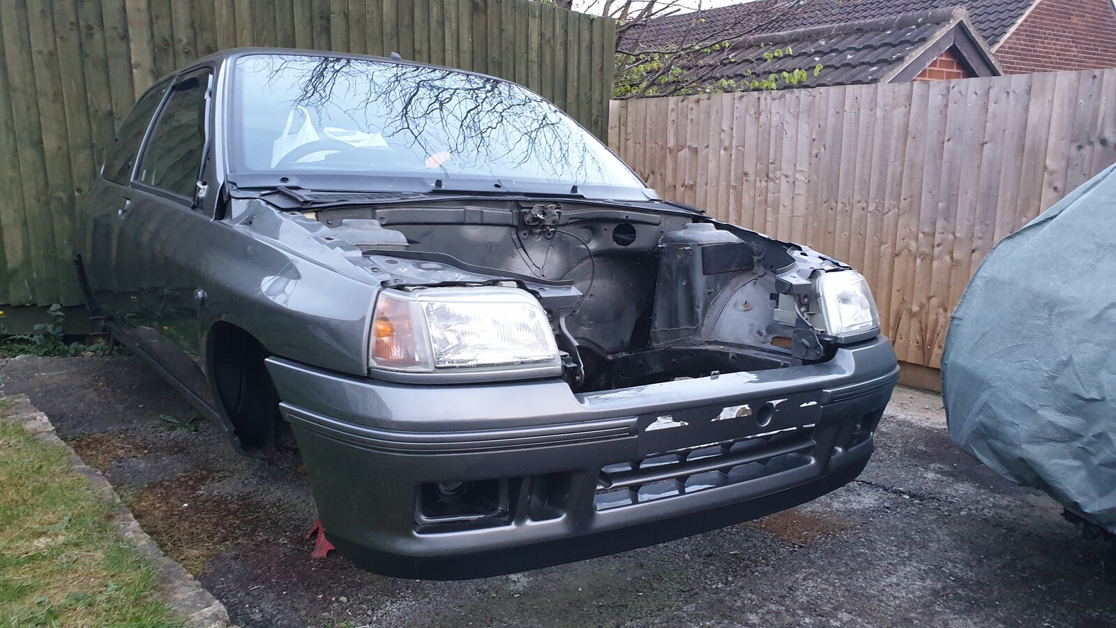

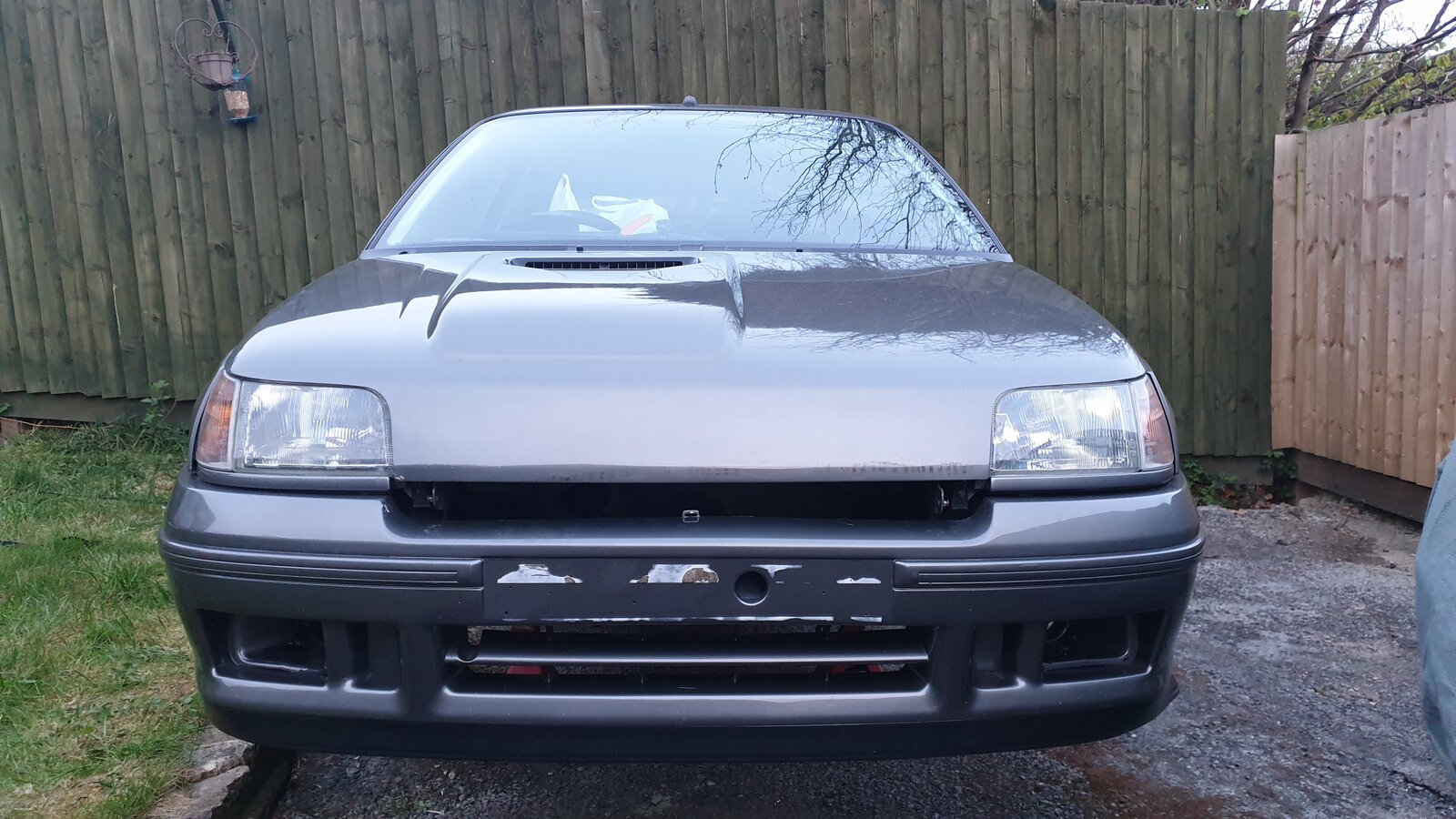

So panels off
Bay area still relatively full of crap

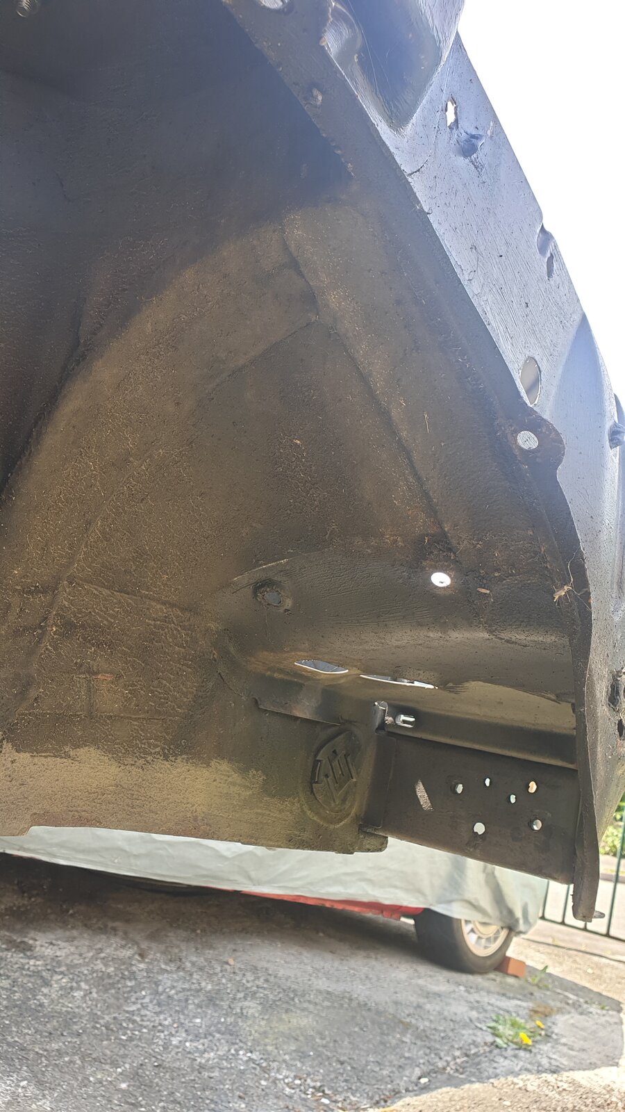

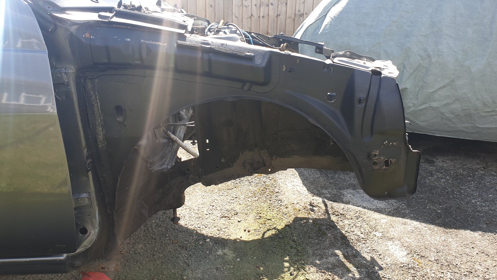

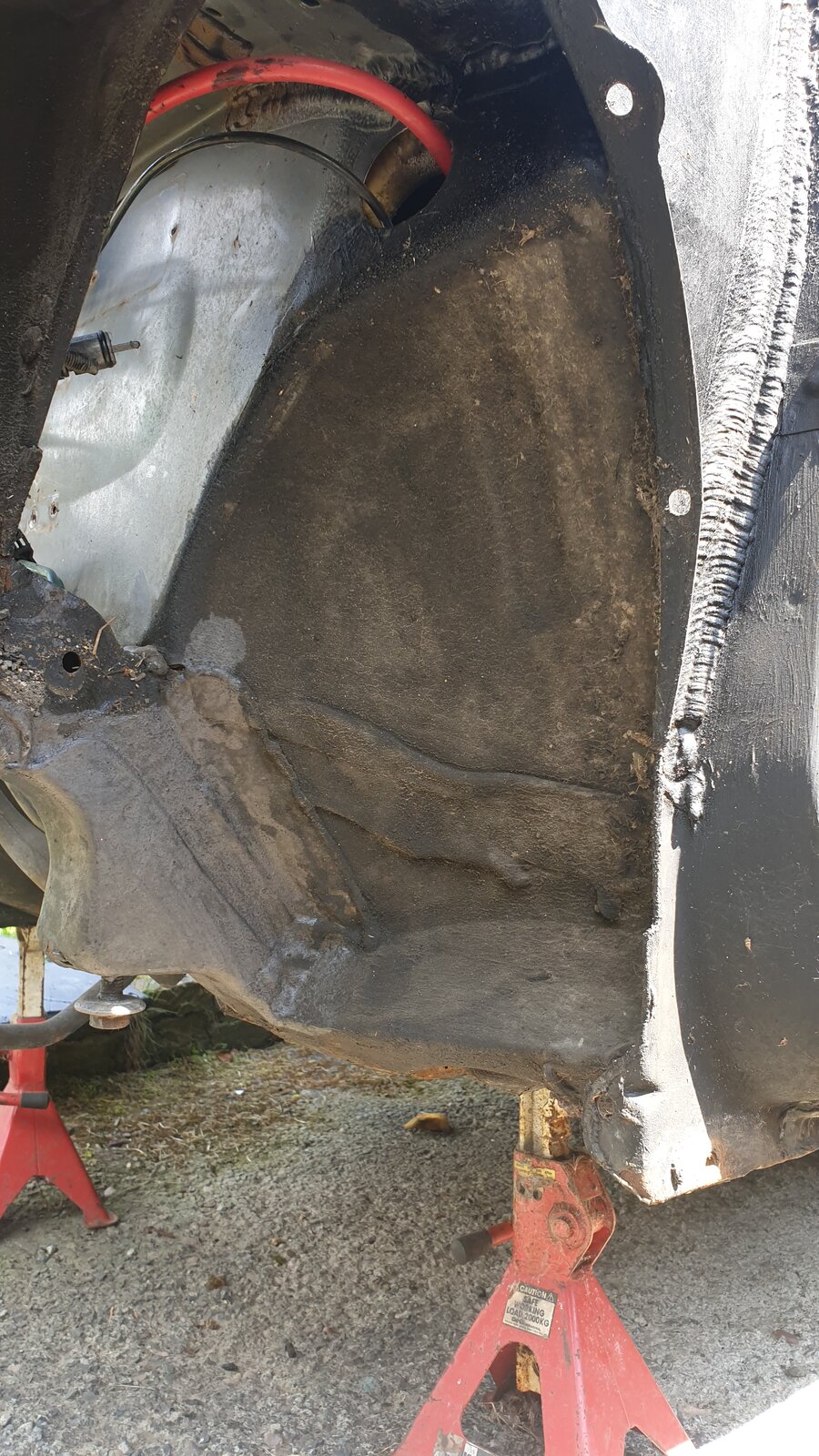

Front inner arches I painted up with waxoyl a decade ago still pretty good
Little patch on front cross member on passenger side, not too serious and easy patch up

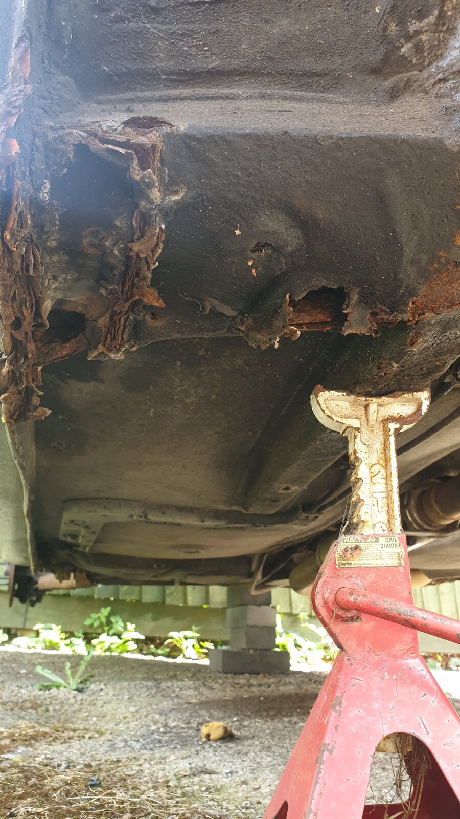

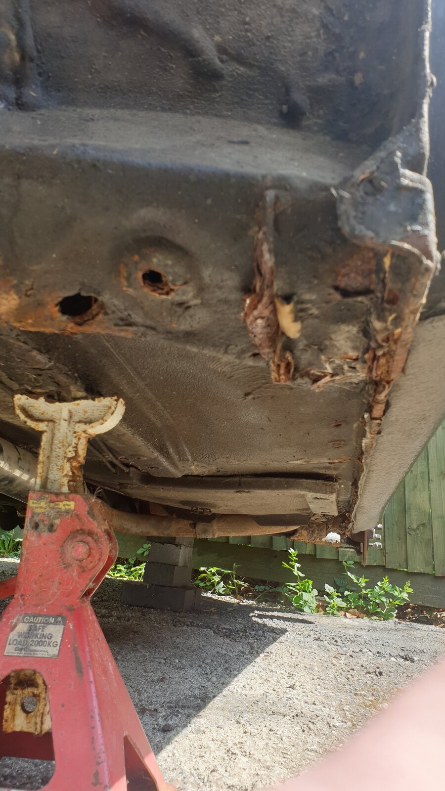

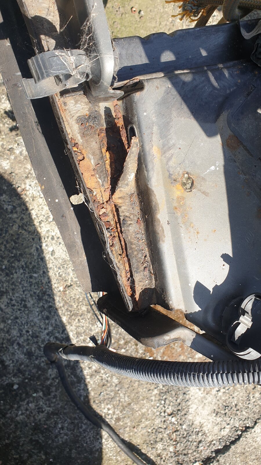

And then the real issues, front jacking points gone, taken floor with them and substantial amount of sill gone too, more than likely including inners.
Coops Mk1
  Lots of Scrap...

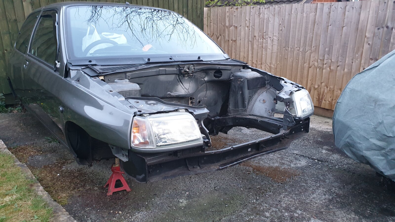

So proceeded to pop everything out the bay
And that's progress so far, rear end and underside next to strip.
So refitted the lights and panels so the cover doesn't snag, wrapped her back up and went in for a consolidatory beer...... and a cry
Things are about to get pricey.....
