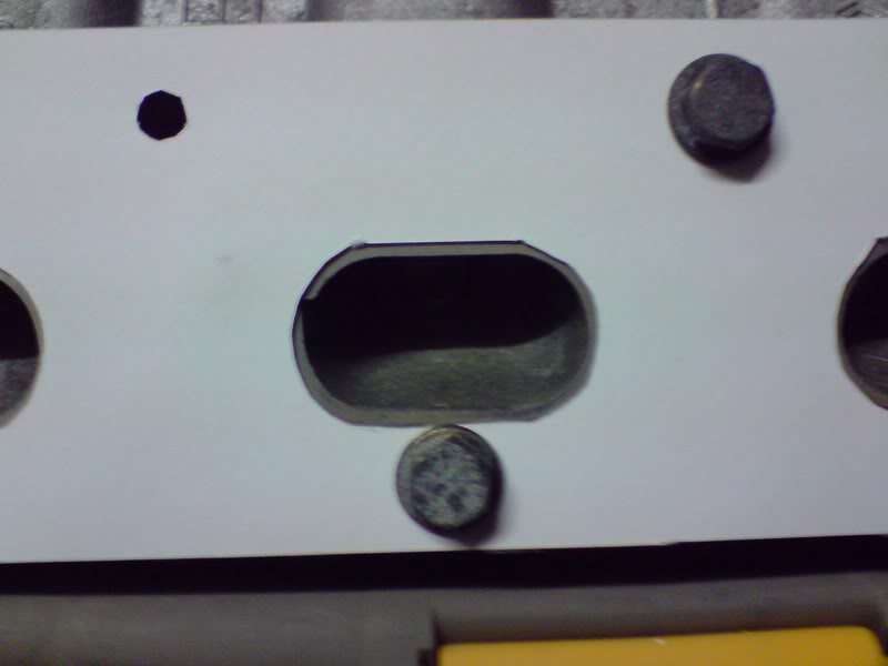

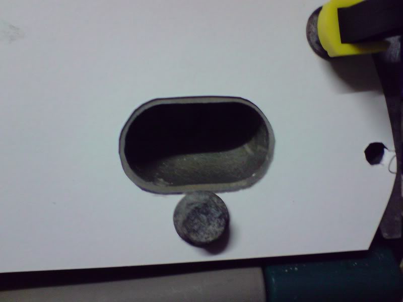

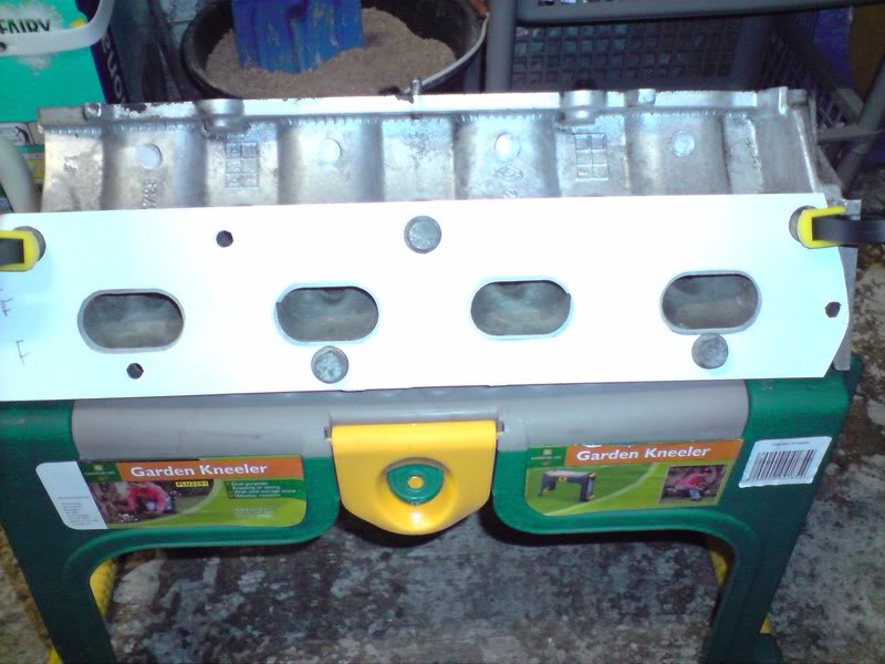

i'm about to machine my inlets and just want to confirm that the amount to be removed is about right.
and what would be the best bit for a rotary tool(dremel) to do the work.

what the f**king hell have you bolted to it!
ive not bolted it to anything they were used to help align the template then clamped on
yes but match it to the gasket
isn't the gasket is to big.

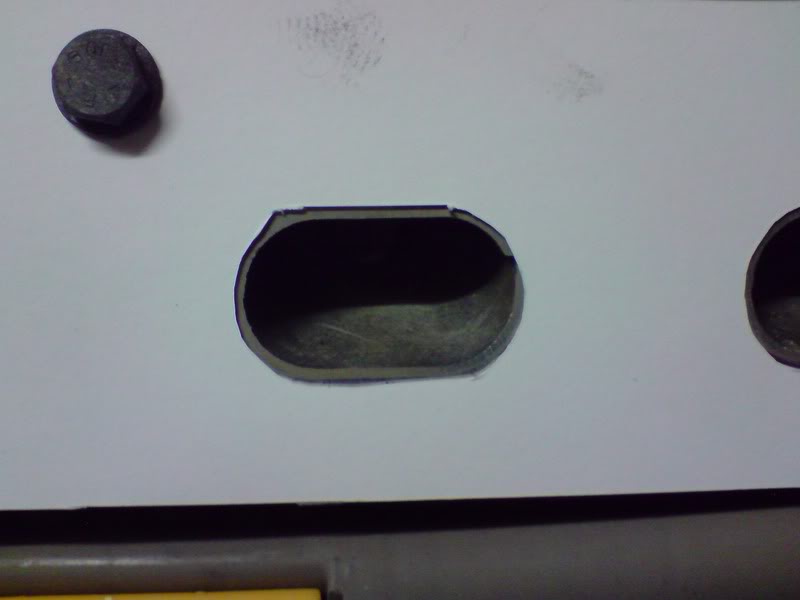

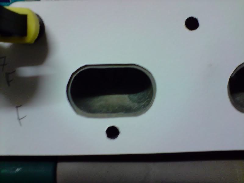

it was a rough template.
I masket the ports, cut it out to the ports and bolt holes. then transfered them to the card. there a bit rough cos i needed to change my scalpel blade.
wilky19
  Leon FR 184
i think with a bit of work i could get them to be reasonable/allright lol. ive seen worse.

To be fair mate you might aswell have a go yourself. The pros will make out its some black art that you'll never get right with a dremel, but thats b****cks.
From the pro ones ive seen the inlet should be matched slightly smaller than the gasket, and you dont need to go any further up than the injector hole.
  Megane 2 GT 165
Ports are 50x30 if I remember correctly.
Basicly draw two circles of 30mm diameter 20mm apart and you have a perfect match. (almost)
The gasket port size is at least 1mm bigger than the ports size on the head.

Tempted to do this myself too. Just remember it's easier to take a little more off, and practically impossible to put metal back. Take it slow and steady. Using a spare gasket is probably £6 well spent.
  ph1 black 172
i have just done this. for the head side i used the gasket and kept to 1mm inside the gasket mark. put it back together on friday night. works perfect.
for the top gasket i used the gasket.
dremel all the ways. 60 grit at about 4000 rpm. got through about 15-20 sanding bits though.

that doesnt look like a good template if im honest :D
thats cos its not at the moment the second version will be better;)
when i get spare inlet i'll do it then.
