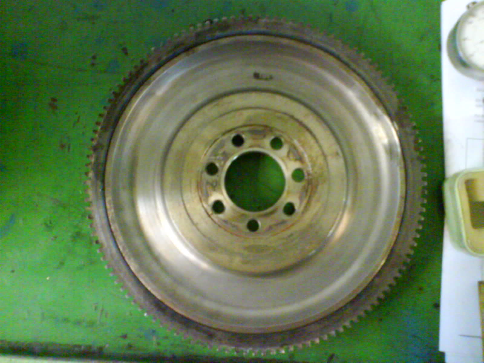

Machining the flywheel
  Rally Clio N3 Mk2
Anyone tried this, how much weight could you shave from the 5.3kg stock one?
It seems the K-Tec is 3.7kg
I did some reasearch on here about lightening the standard flywheel and there was quite a bit of advice not to, as they arent the strongest once machined apparently!
I was told you could take a max of 1kg really off it by rik wood.

4.45kg, good weight that. 1kg off the standard roughly.
Ktec is alluminium isnt it?

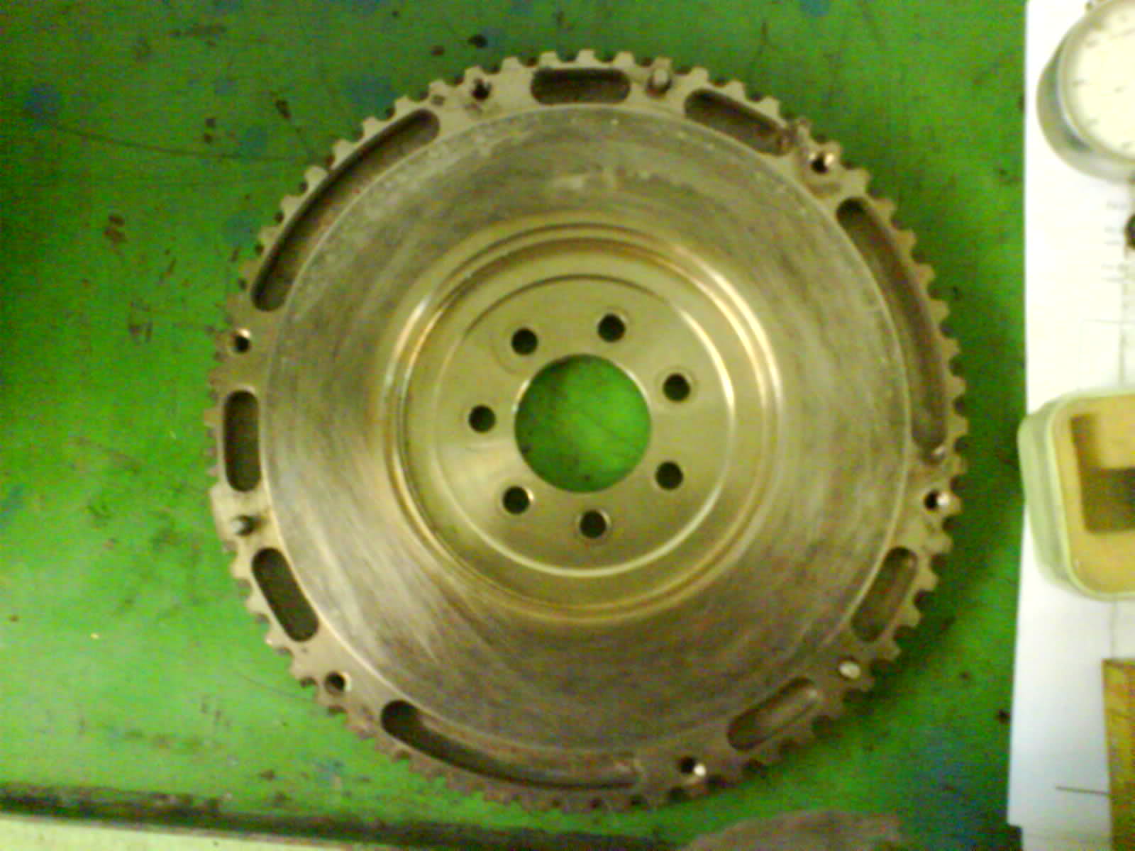

Weight can even go down a bit but then there is a issue with safety and reliability as my car is a daily driver and I would not like to have any engine bits goring through my cabin :D
I dont know what material Ktec uses but it can not be OEM one as it is impossible to reduce weight to 3 kg using standard material.
This is the final product. It is crucial to point out that lightened flywheel MUST be balanced prior to installment. This process is relatively cheap but it is important to give this work to somebody who is reliable and who will get the job done in the best possible way.
