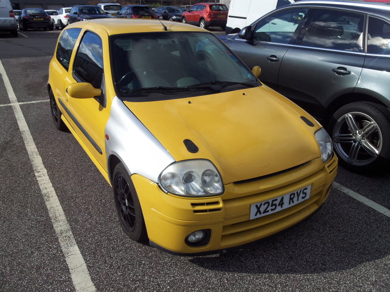

I set about trying to find another 172, and i knew i didnt want the common silver, or black. I wanted it cheap as possible, probably needing abit of TLC which i would do before i put it on the rd
I looked at a few other flamers, but then this one came up, needing TLC and it was the most uncommon colour you could get!

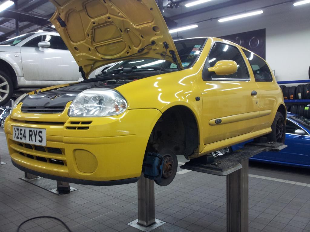

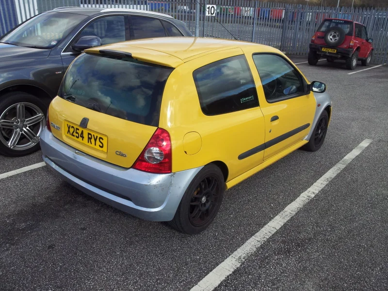

So, here she is
Spec is 2001 X 172, 76000 genuine miles, bit of history, owned a few times on here, part worn Parada Spec 2s, RS Tuning 'pop and bang' remap, KTec full stainless inc decat, no tax, no MOT, 6 yrs and 20k since belts done, and needing some love!
I went upto Newcastle, and handed over the £notes, totaling £600 and i was no the proud owner :)

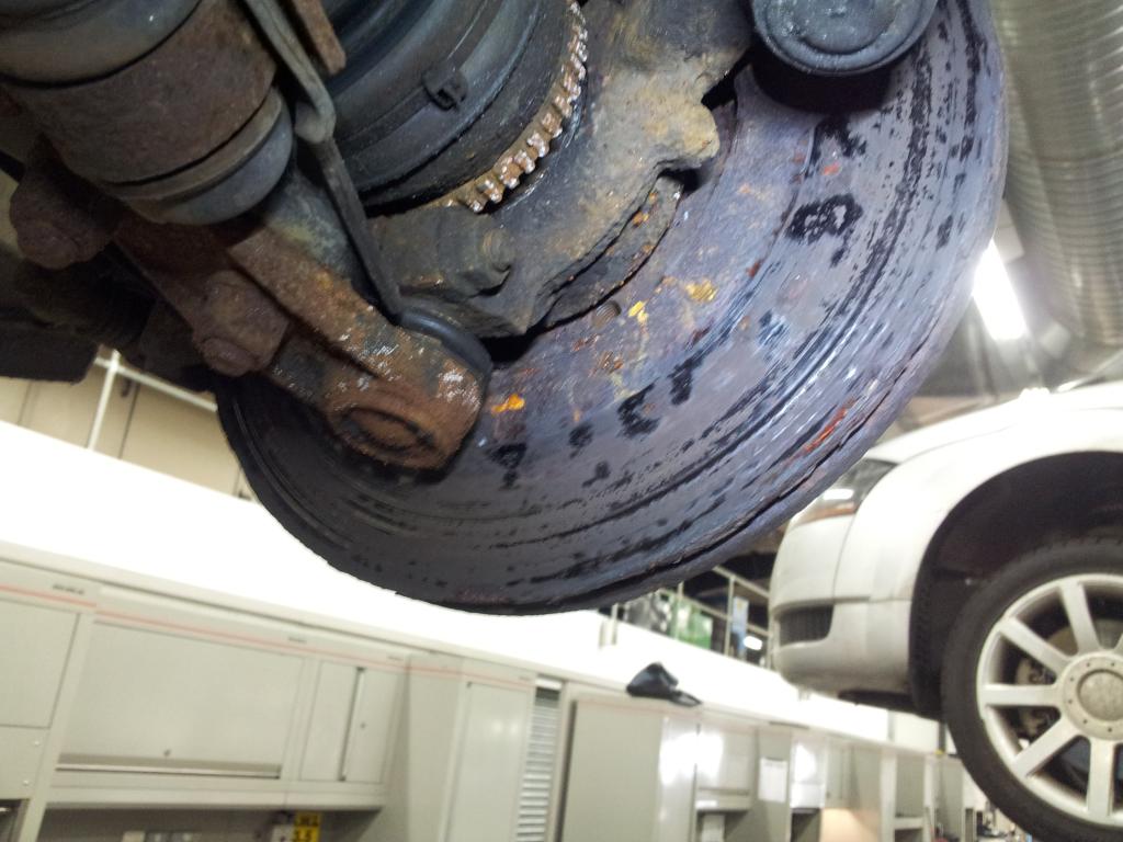

I was pleasantly suprised - it needs a CV boot, a steering gaitor, and to make it perfect, two track arms
Few niggles include these two things - nice way to stop the blow, but not ideal!

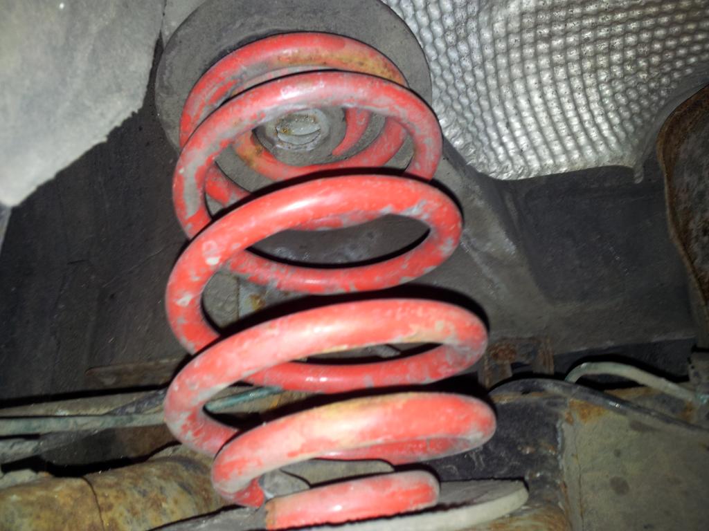

Also, the rear springs appear 'aftermarket', and the fronts stock, although theres no obvious height different when on a flat. Does anyone know what make these rear springs are?!

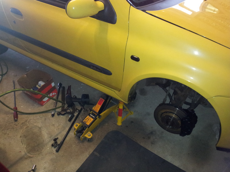

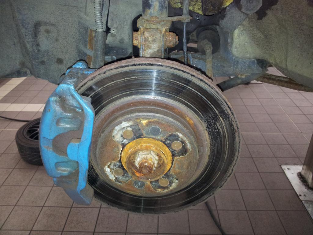

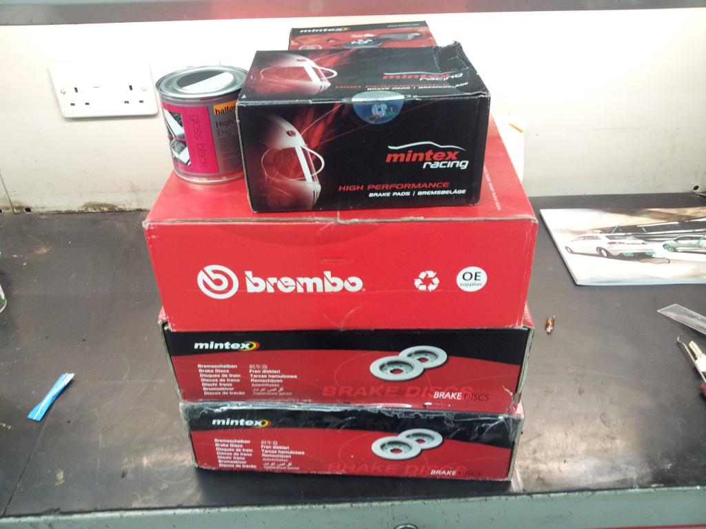

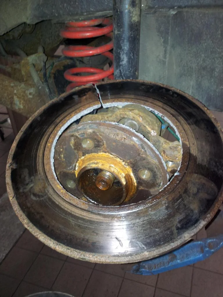

Id bought some brakes off G172 (Top guy), but driving it yesterday to work on trade plates, i thought that maybe a few runs would clean the old disks - hmmm maybe not...

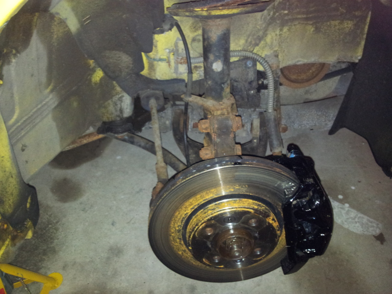

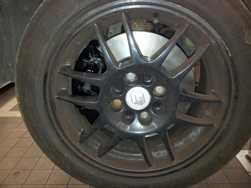

I set about fitting the new brakes

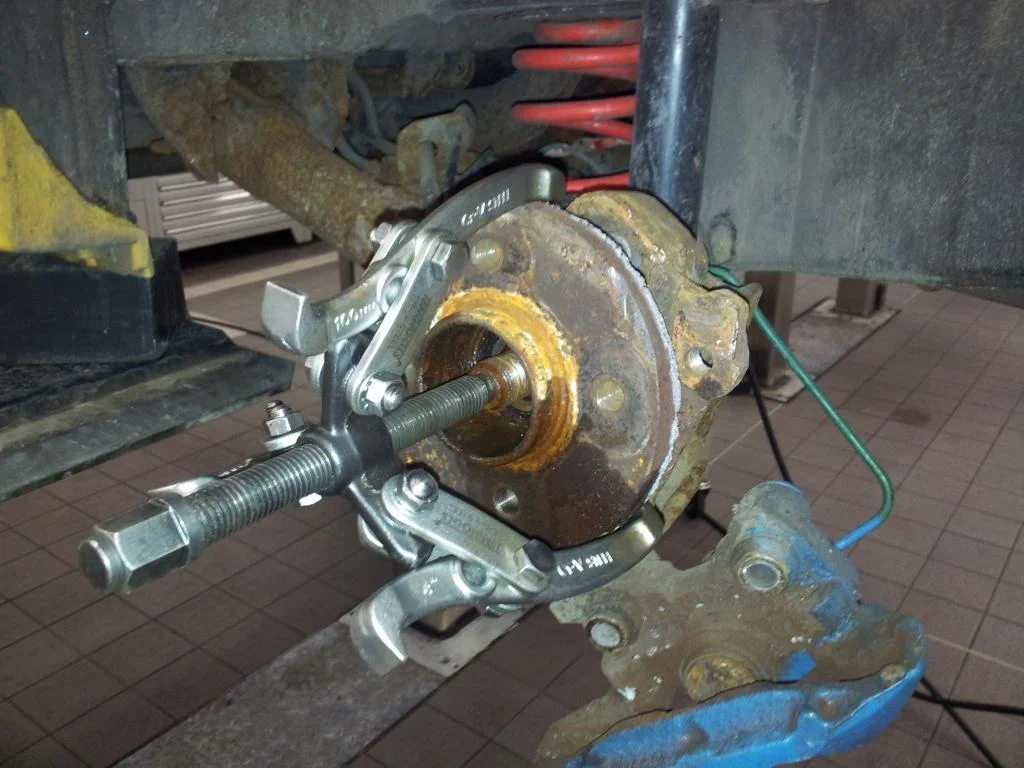

The rear disks were seized on via the bearings, either the disks were thin, or im strong

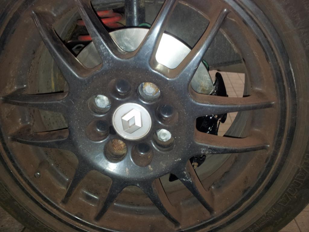

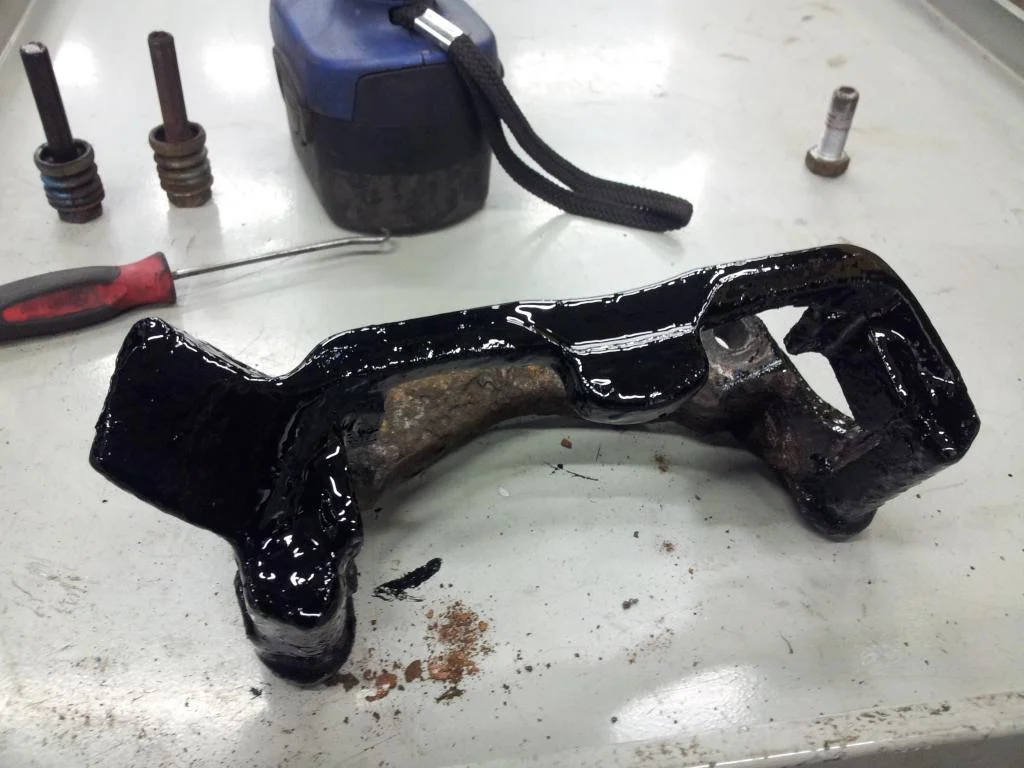

Also, painted the callipers to get rid of the blue - who thought blue looked good?!
And the final result

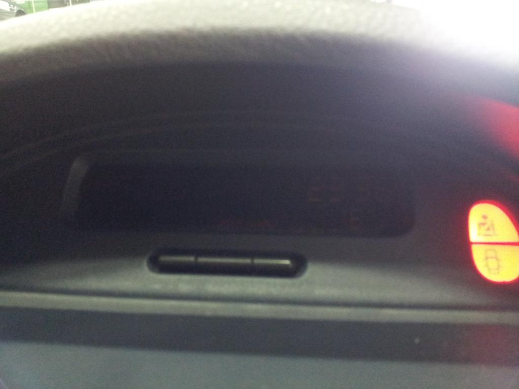

One more thing i noticed, the clock/cd display doesnt light up so you cant see it - not sure if this annoys me yet, time will tell...

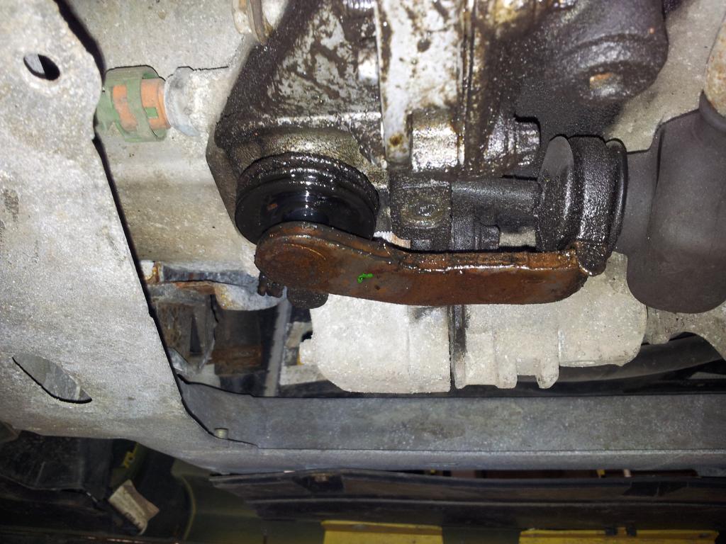

There's a spring missing off the bottom of that gearbox btw. Incase you didn't know.
Part number if you need it is 7700110500.

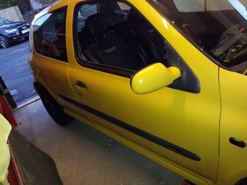

My main aim was to make it as 'standard' as possible, although the wheels will stay black. It had poorly painted rub strips on, so i got hold of a set of standards and fitted these

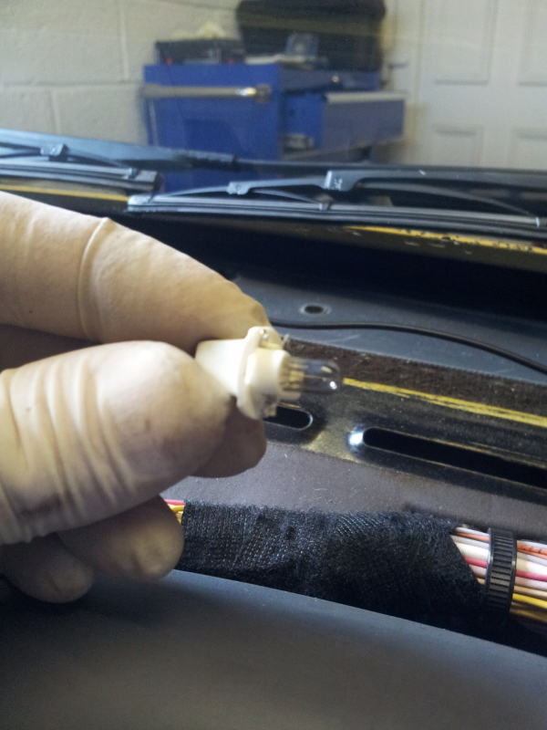

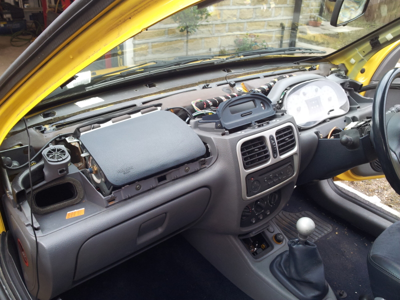

Now i decided that the radio/clock display not being lit did infact annoy me, so having rear the guide on here about how easy it was to remove the top dash, i gave it a go - it took literally 5 mins to remove (i realise it has been off before as its had a flocked dash in its previous life) Removed the clock unit, and found the culprits

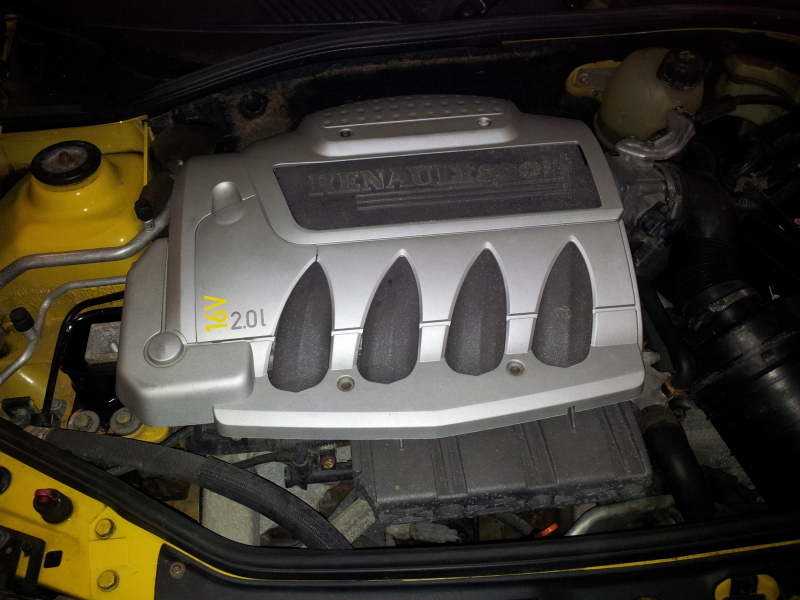

Also bought an engine cover, as it was missing

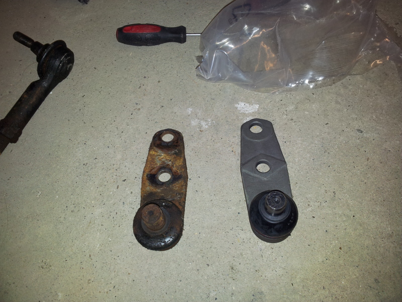

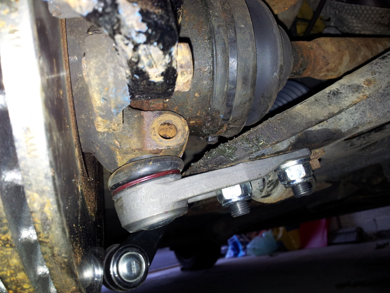

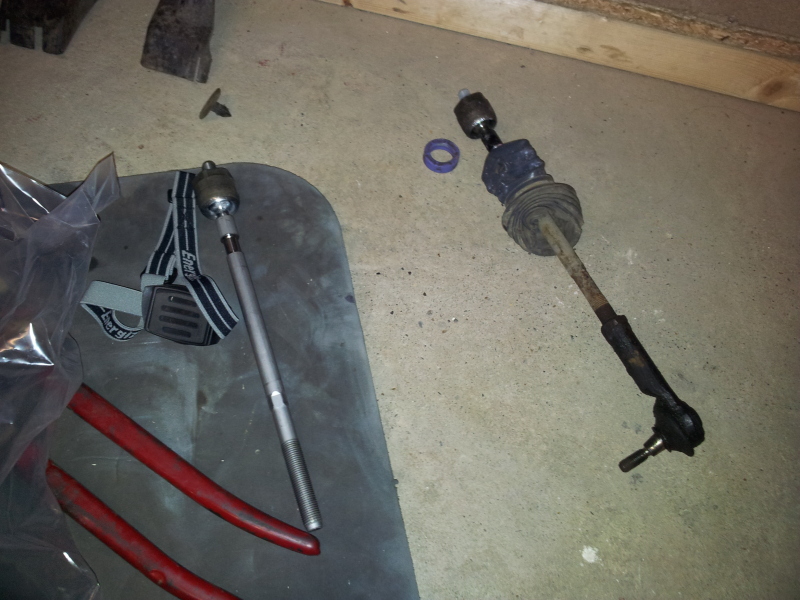

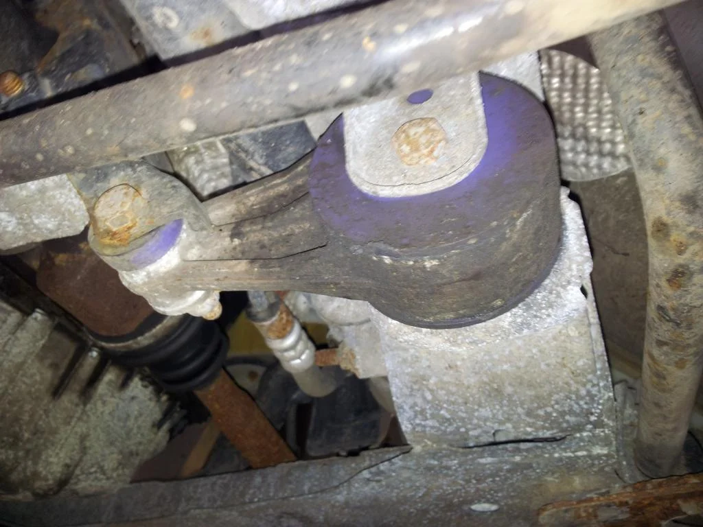

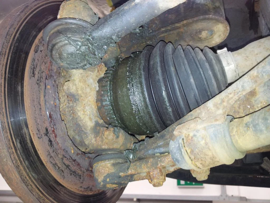

I bought the car with the hope to do a few track days in it, and when i'd had it on the ramp and done a quick healthcheck, there was abit of play in each track arm. I'd also noticed a knock on the passenger side front, so i decided to replace both bottom ball joints, and both track arms and track rod ends. Ive used genuine Renault track arms and TREs, one because ive had previous experience with non gen track arms, they never get me the right part - they're always too short, and two because i needed new gaitors and these come in the kit. The downside of genuine parts issss kerrrrrching!!!
So, i set about the job
My little helper

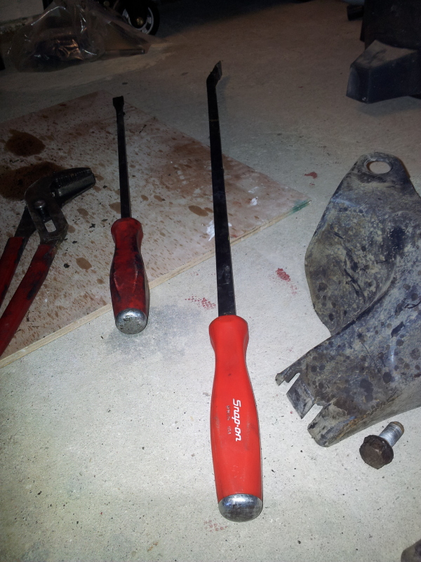

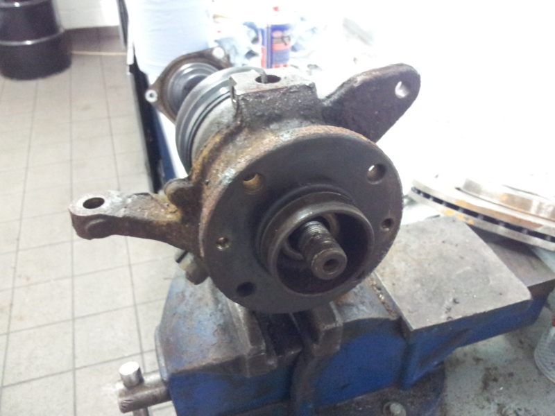

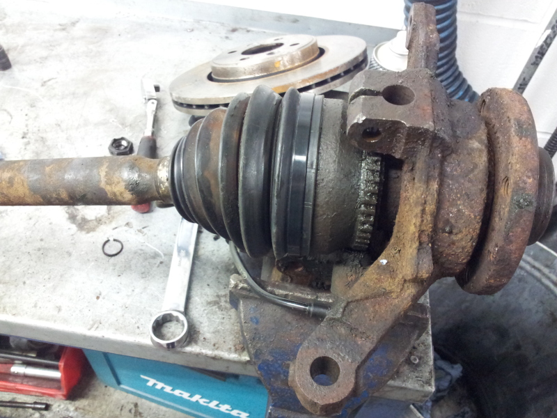

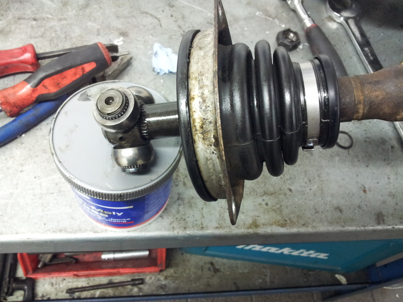

The ball joint was abit of a bar steward to get back in, id bolted it to the arm 1st and then tried barring the arm down enough to slot it into the hub. Obv the ARB is very tight, so i enlisted the help of the 'daddy', and also a neighbour, and managed to bar it enough to slot it in

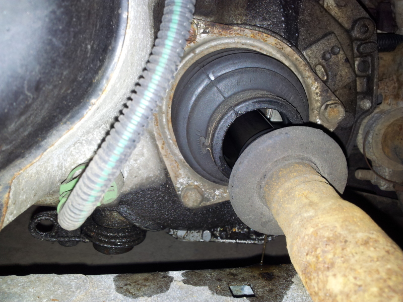

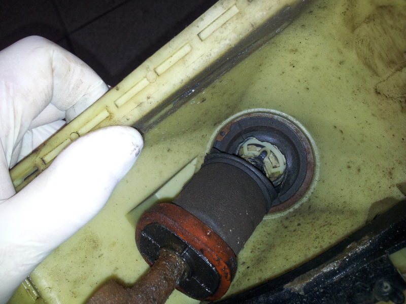

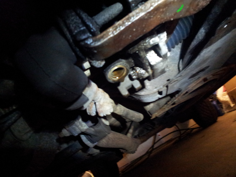

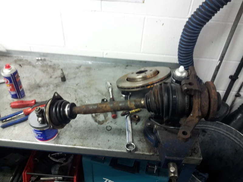

The NS one was going well, until i heard a 'POP', and then this...

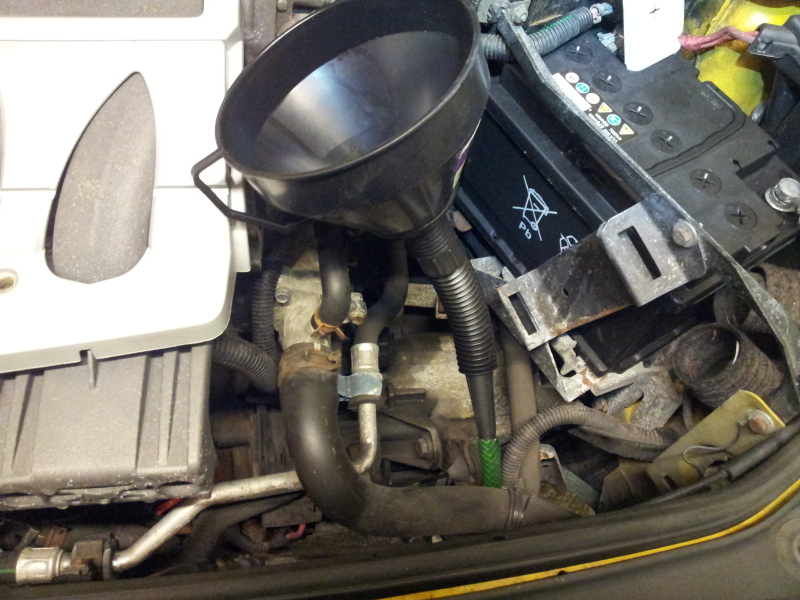

It'd dropped all its gearbox oil all over my garage floor, the inner boot had popped off. I had planned to change the gearbox oil, but id of preffered to catch it!
I decided to remove the shaft, as the outer boot had also come off and spread grease everywhere, but the cv joint was seized.Instead i removed the whole hub, and attempted to press it out at work - it was so seized it started to distort the hub! Scrap that idea, i just cleaned the boot up, filled with fresh grease and sorted the inner boot out too
I build the ball joint up differently, this time putting it in the hub 1st, then using a jack i lifted the hub upto the arm - much easier

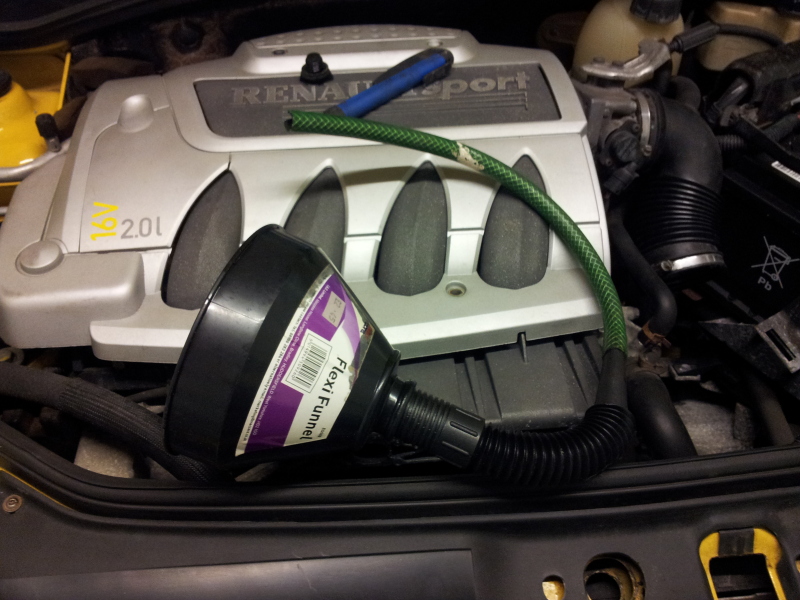

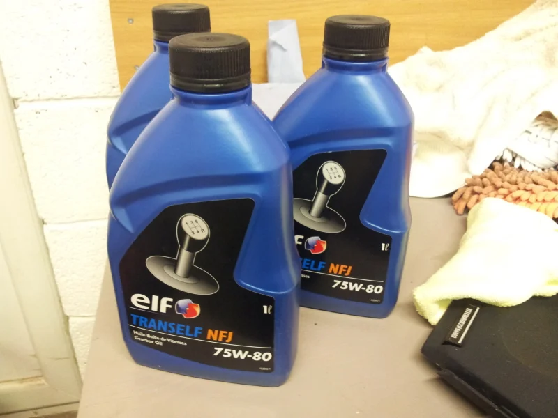

I then drained off the rest of the oil, and using a funnel and some hose (a perfect fit for the refill hole), i filled the 'box with Elfs finest
I haven't driven it yet, so not sure if the knock is sorted, but the ball joints were shot!

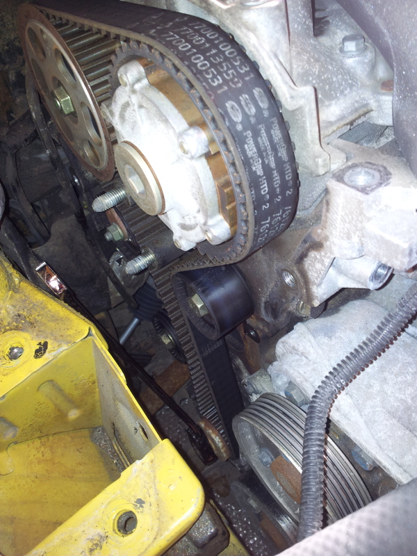

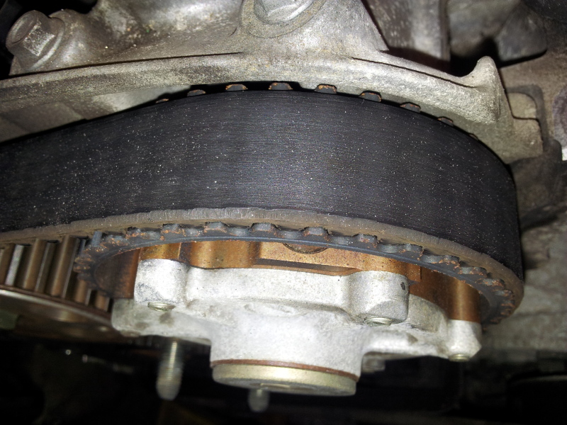

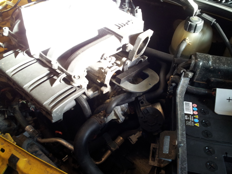

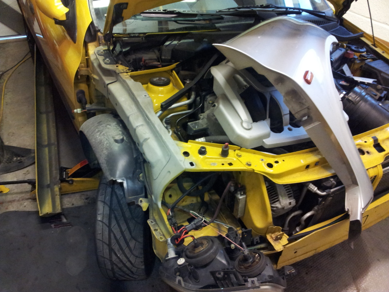

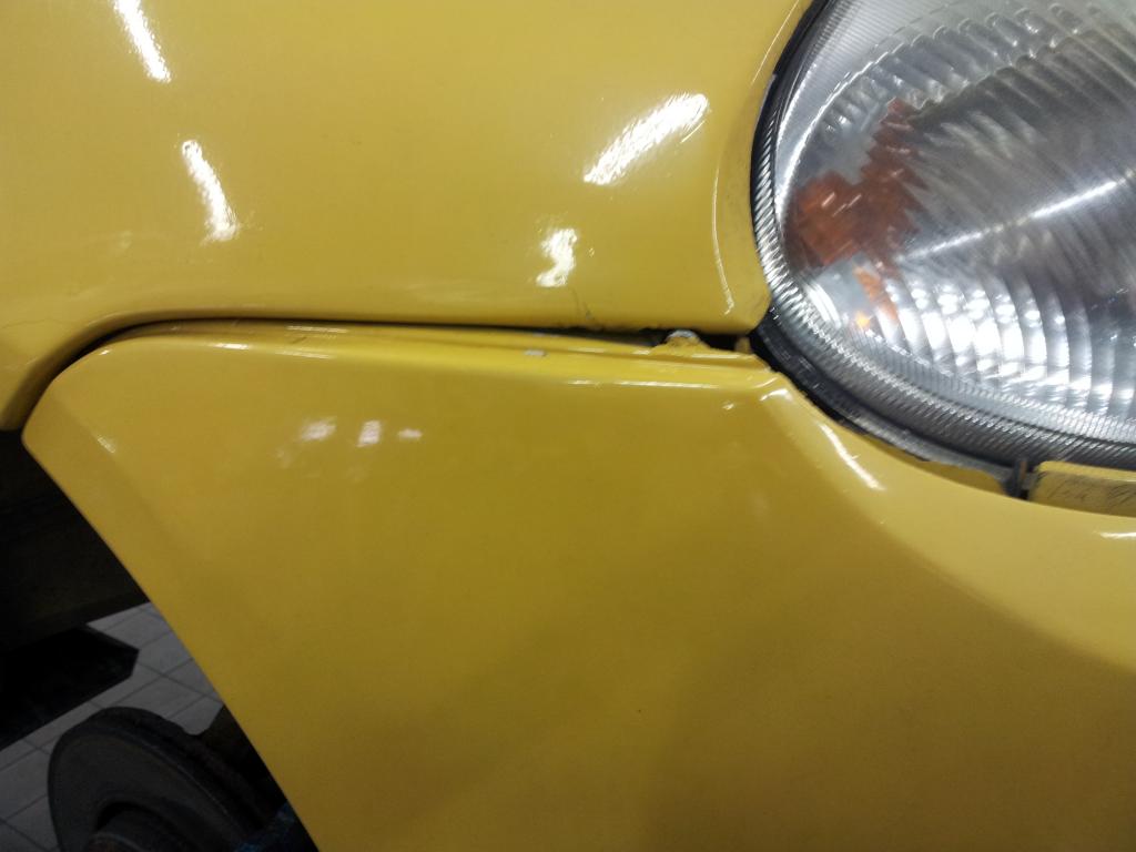

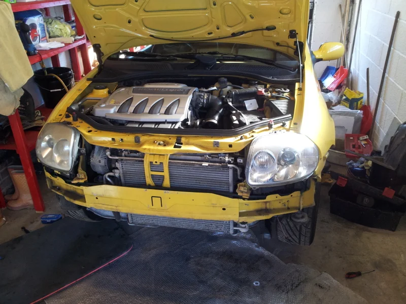

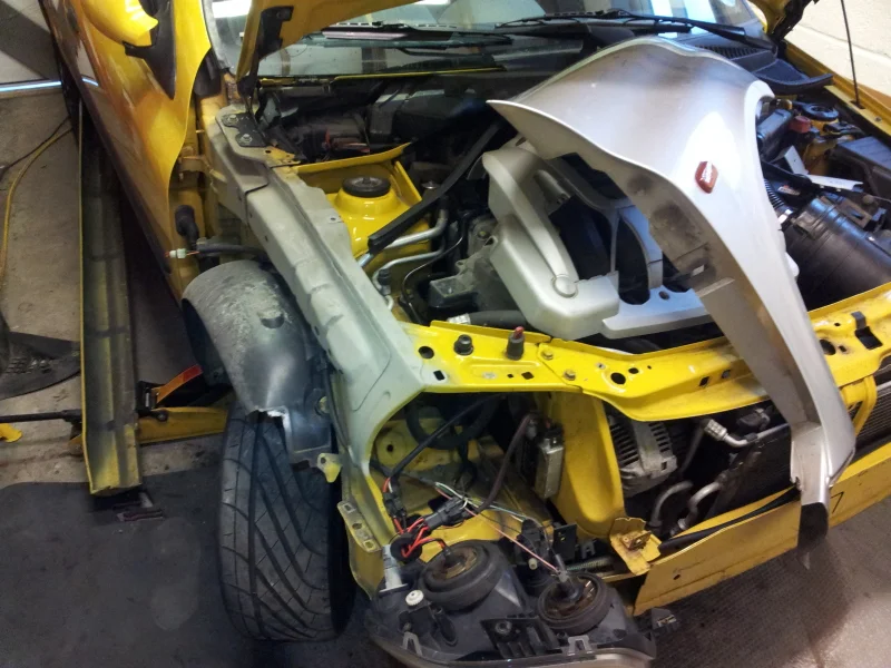

I wanted to removed the bumper to see if there was anymore damage apart from the front wing, so i incorporated this with changing the belts

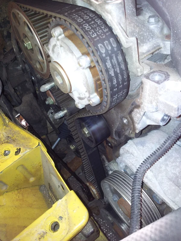

I went the whole hog, genuine belt kit, aux kit, water pump and dephaser pulley - again, kerching!!
Removed front bumper, no damage other than the wing - phew
then set about the belts
'Touch wood', the stripdown wasn't too bad - 2 1/2 hours inc bumper off, which i didn't think was bad
The belts are only 20k old and showed some alarming wear - check out the edge
They are 6 years old, hence the change
Thats where im at. The cars in the garage, stripped, but the water pump gasket has welded itself to the block so i gave up last weekend!

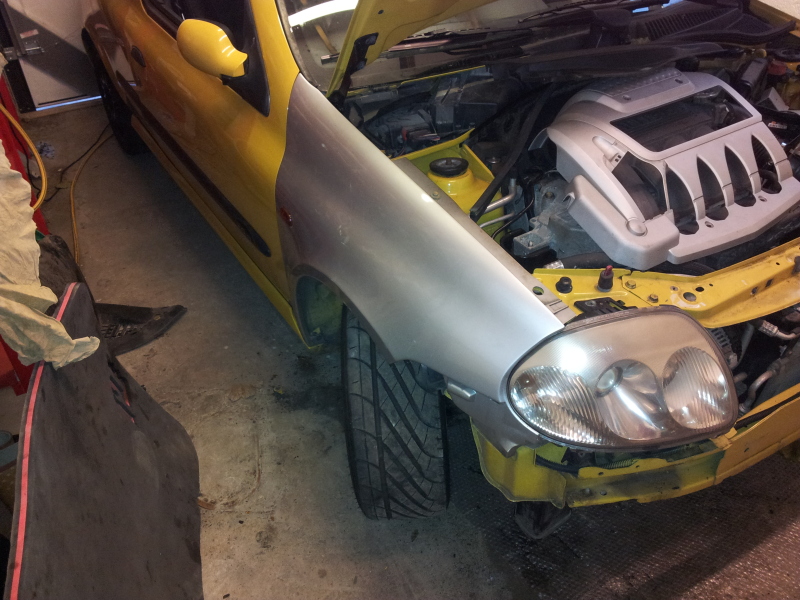

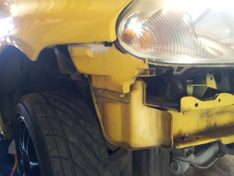

I had all the front off to do the belts, so set about rebuilding it. Unfortunately the retaining point on the damaged wing was missing, and I'd removed all the arch liners ready for the body shop, so I had no way of mounting the bumper - lucky I had a replacement wing in the boot

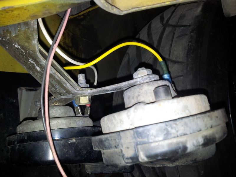

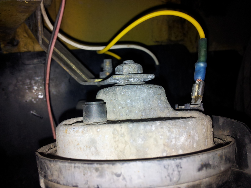

Also, the horn wasnt working, so using a dremmel with a sanding end, i cleaned all the connections on the horns, and fitting a new bridging wire and connectors - got one working, think the other one is knackered, but im happy with just a single tone horn

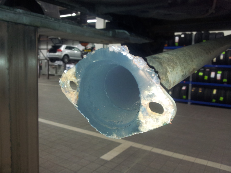

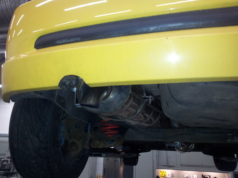

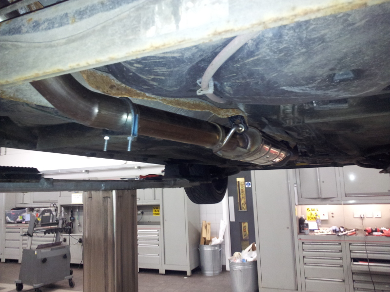

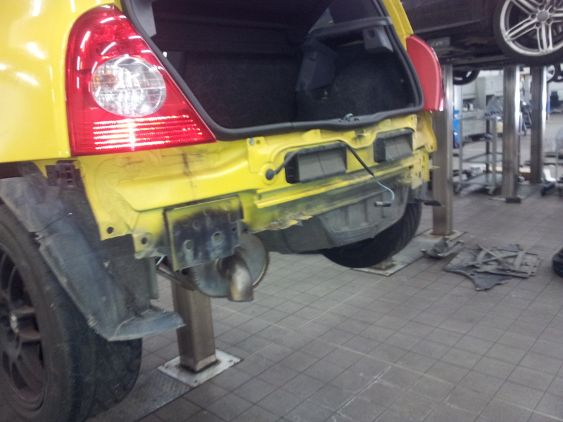

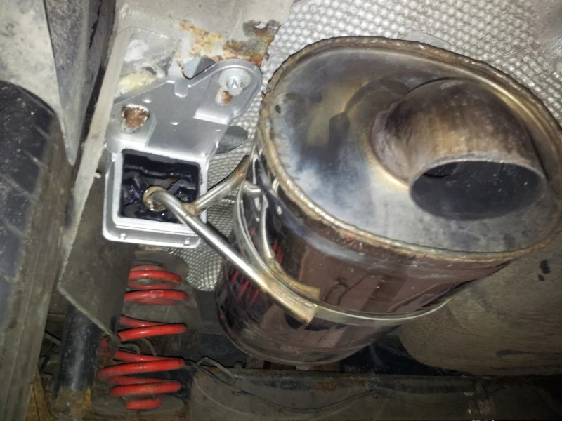

So, this sat i took it on its first trip out for 2 months, 3 miles to work. I always said the exhaust was too loud, with only the one silencer and i didnt like it sticking out the rear, so i was just about to buy a K-Tec stealth, when one came up on the bay. I clicked buy it now, and as i was on a course for work the following week, took a detour in an A4 Avant courtesy car to Birmingham, and picked it up. Its mint, just what i wanted. That meant a new bumper was also needed, and i decided to stay with the facelift rear, as i think it suits it

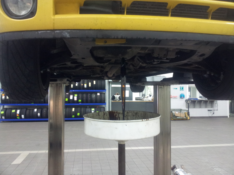

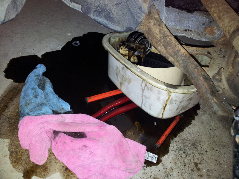

First things first, i drained the old oil - im not sure the last time it had a service, possibly years...

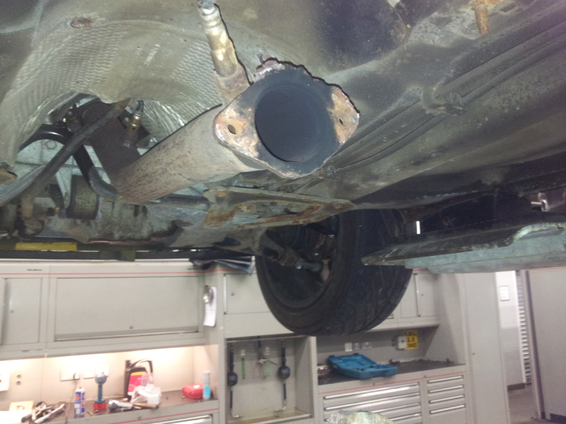

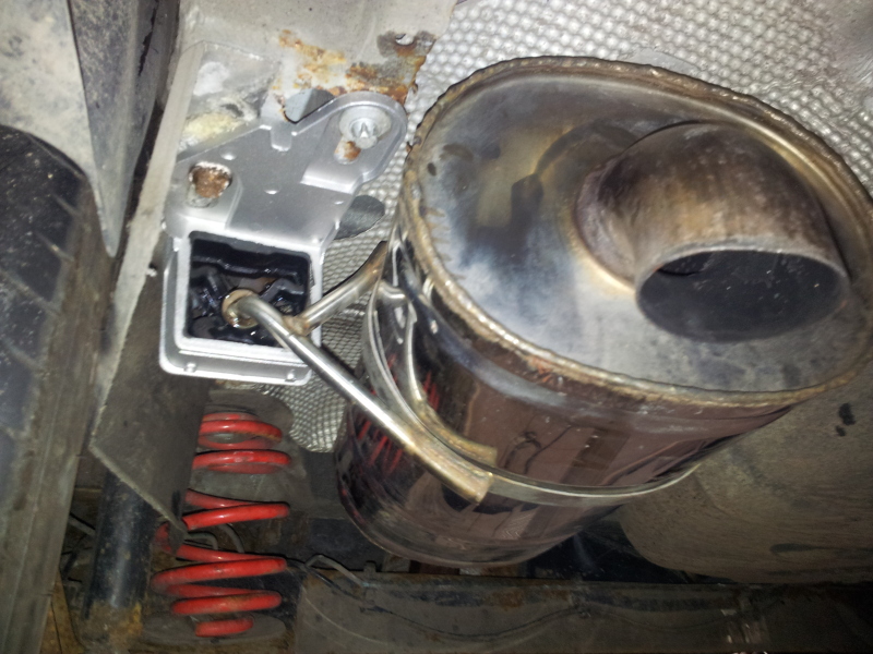

Then the task of replacing the exhaust

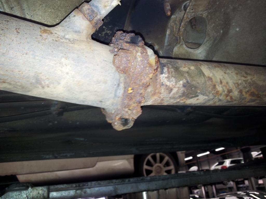

The previous owner, or rather one of them, had obv got annoyed with the exhaust blowing, so instead of sorting it properly, they just welded with decat to the centre pipe! I took 1.5 hrs to grind away all the weld, enough to see the joint, and then i managed to crack them apart

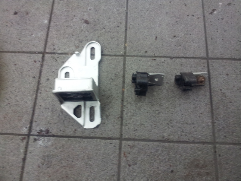

New mountings were added, the old ones had split totally
And she was on
I cut the long threads off the exhaust clamp to neaten the job

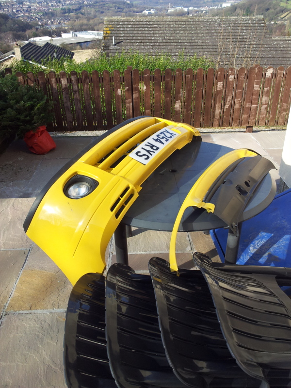

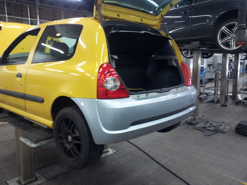

Off with the old bumper which had a cut out, and was damaged by rubbing too big wheels previously
And on with the 'new'
The facelift bumper isnt a straight swap, you need to drill two new holes under where the boot shuts, as the existing holes are in the wrong place - easy enough to do though

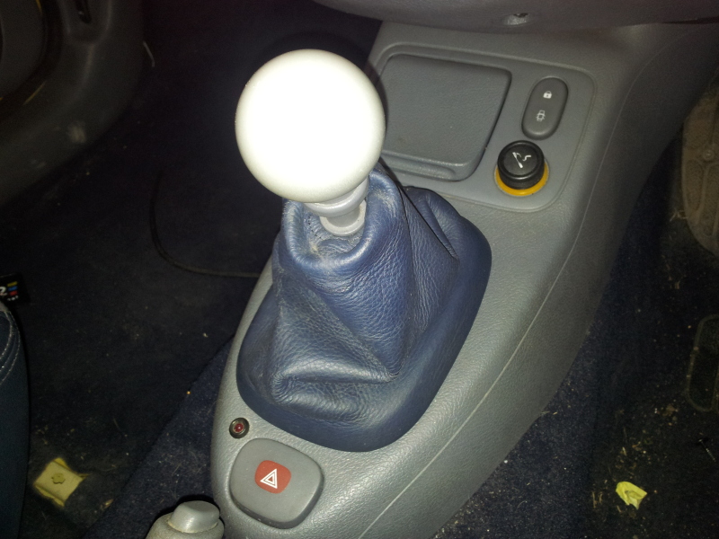

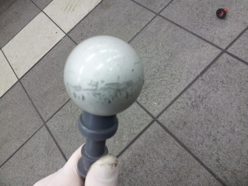

The gearknob was knackered - someone had obv tried to get the knob off with some big pliers and dug deep grooves into the metal. Id managed to get a mint used example, so set about fitting it - i didnt realise it came out downwards, and i had to split the exhaust again, DOH!
Also, my gearlever was really sloppy, i just thought this is how they were, but to my suprise the new one is really tight and precise. I think this is the reason, on the old one
