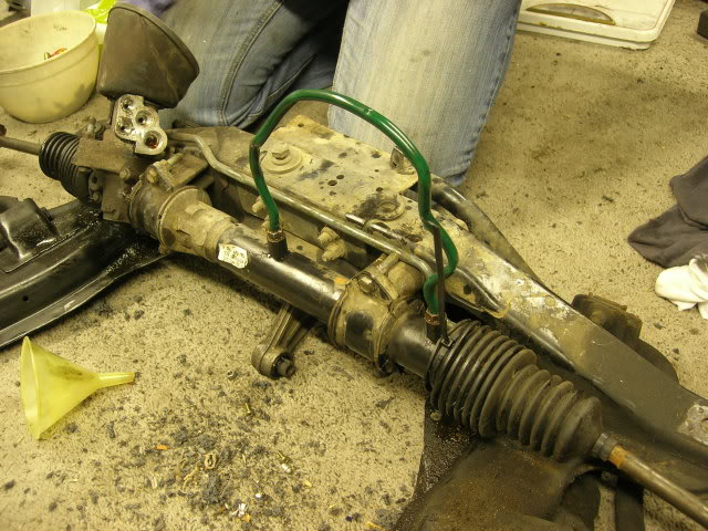

Looped rack:

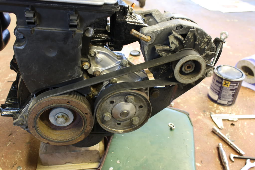

No PAS or AC. Brackets from a base spec Mk1

Whitley, is that all that's needed? Just a pipe from one side to the other? Is it not stiffer than manual having to push the fluid around the rack as well?
Worked for me and plenty of others who've used this method. As said, can be hard work at carpark speeds but fine when you're moving. No problems correcting slides/lock to lock like someone mentioned (mine was purely a track car). I did re-do that loop pipe after the photo was taken. I left 5cm of the green pipe from each port, then put a flexible rubber one between the 2 jubilee'd on (no pressure there).
have you got a list of part number's that you used for the aircon and p.a.s delete?
Mine was all 2nd hand bits, so no luck on part numbers I'm afraid. The alternator brackets can come off various cars, R5/Mk1 Clio/Volvo as Jay says above etc. I did run a 5 rib belt (5pk858 from memory?) as a 6 fouls on the plastic cambelt cover.
