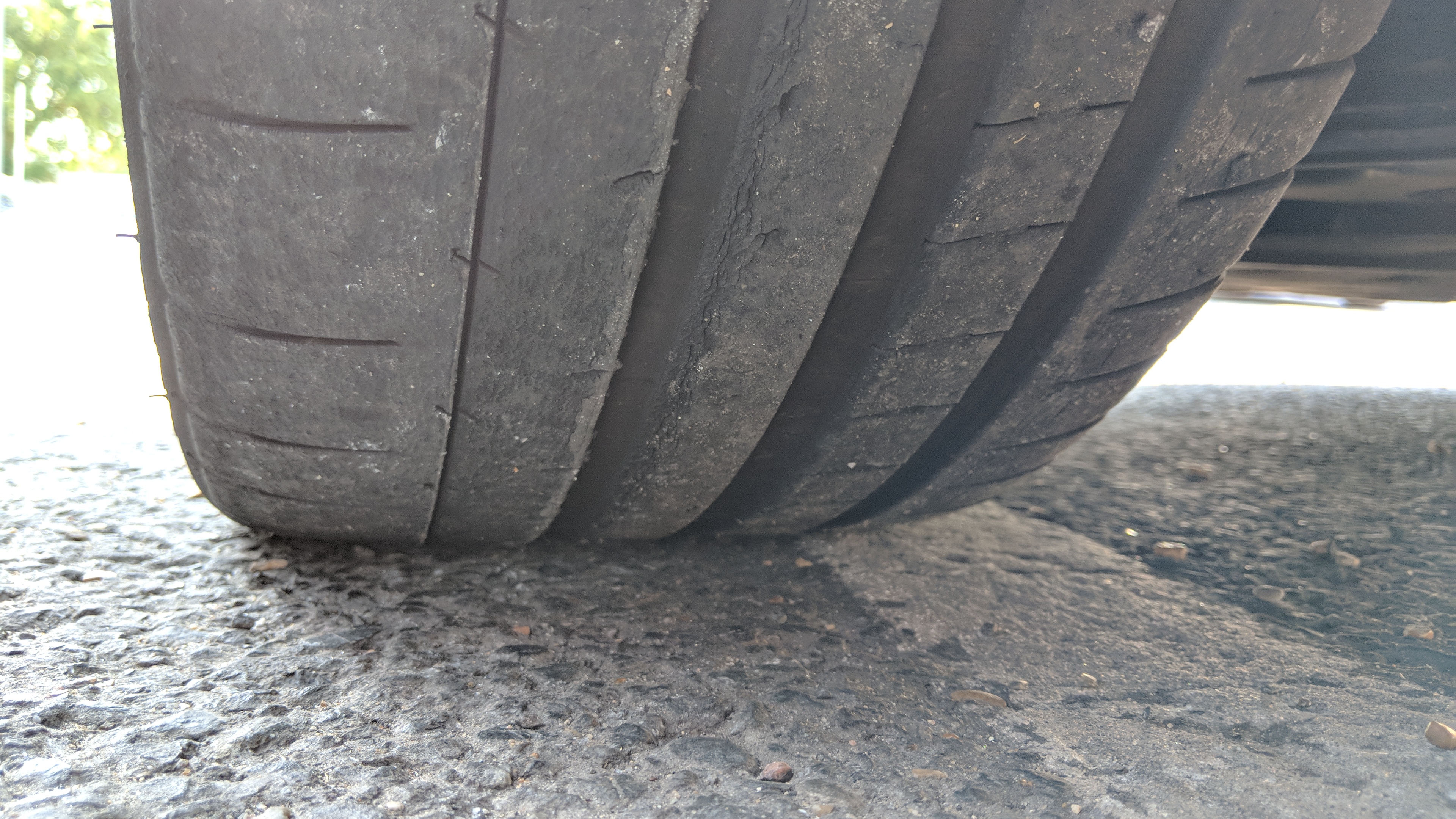

I like the ps4, but they don't wear well. Changed the fronts from f1's in Nov, to ps4. They've already got less tread than the f1's which are 20k older on the rear (and have done an airfield day).
They're good, but not enough to justify changing twice a year.

I'd find it surprising if Michelin had suddenly gone backwards in wear rate. Pilot sports have (generally) lasted very well.
Were your rears on the front in the past or are you comparing fronts to rears on what I presume is your VRS (a FWD car)..

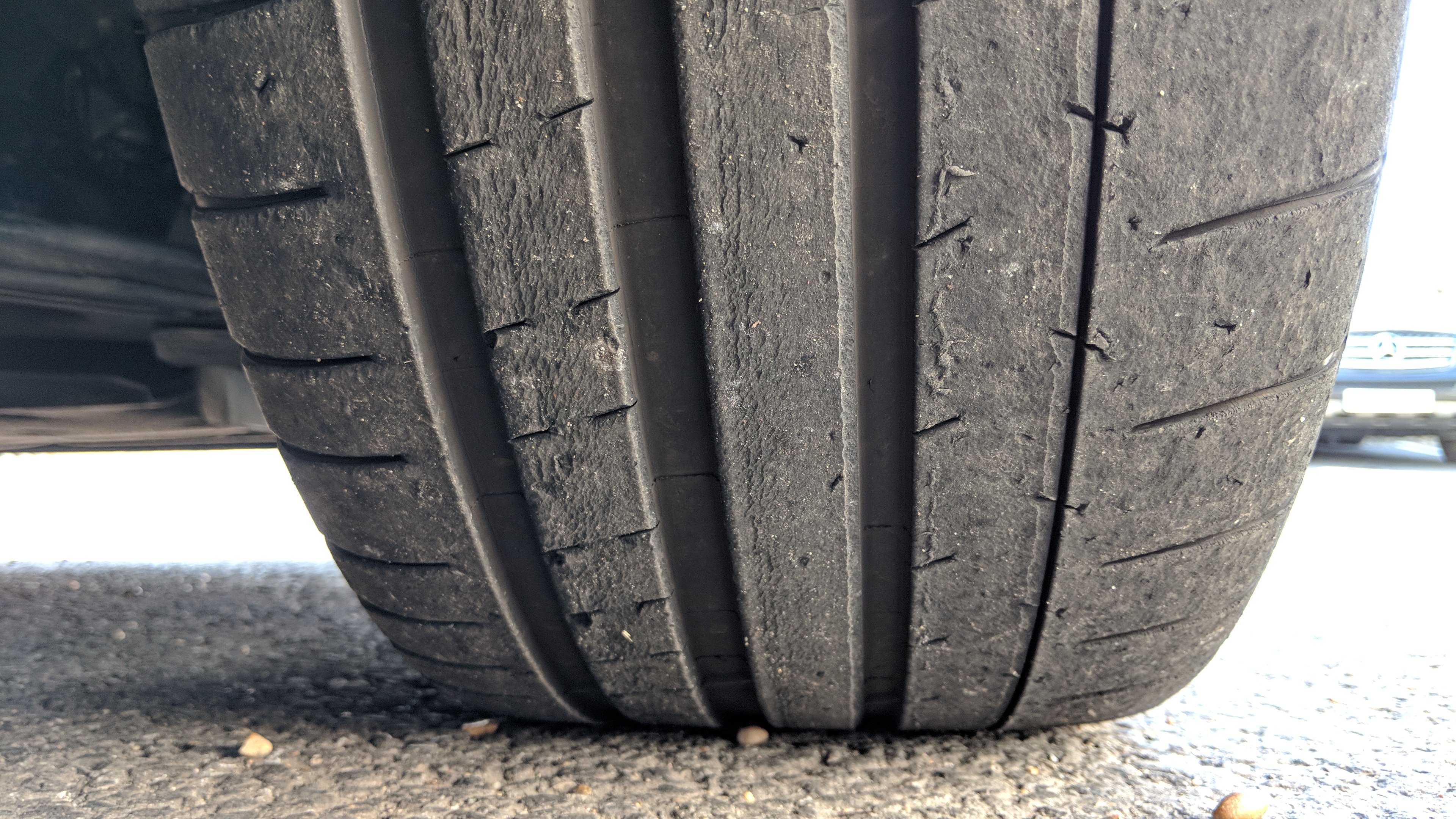

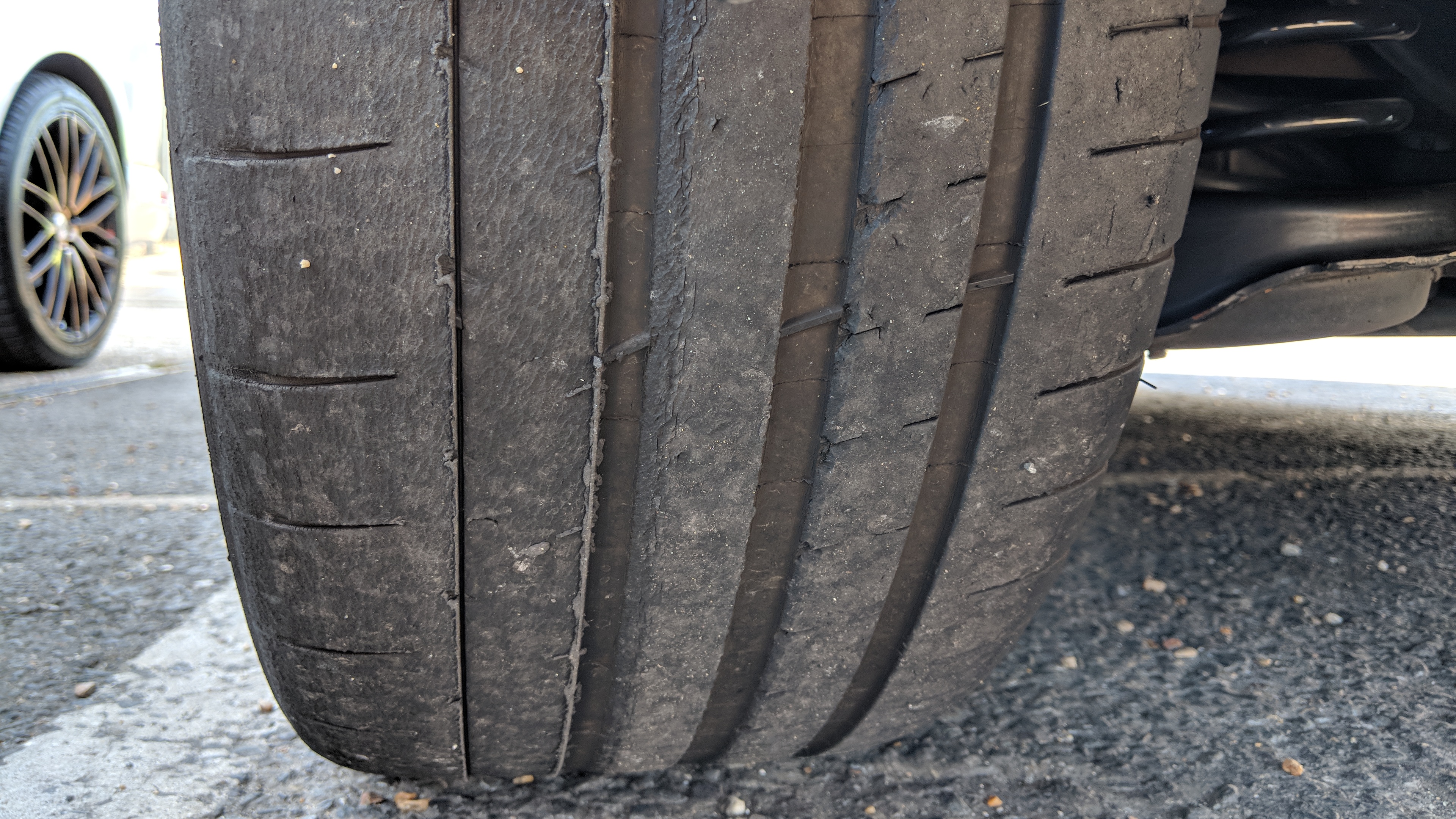

They're good...basically I have 3mm on the front axle and 5mm on the back. A swap around, a couple of thousand more road miles, and a trackday and they'll be done. Much as I want to stick to OEM all the way with Michelin Pilot SuperSports I keep hearing good things about the PilotSport 4 tyres so I may give them a bash after the trackday.
I've read the same about the PS4. Thing is, the PSS have been a good tyre for me and the wear rates are pretty impressive so I don't have a real reason to change what ain't broken...

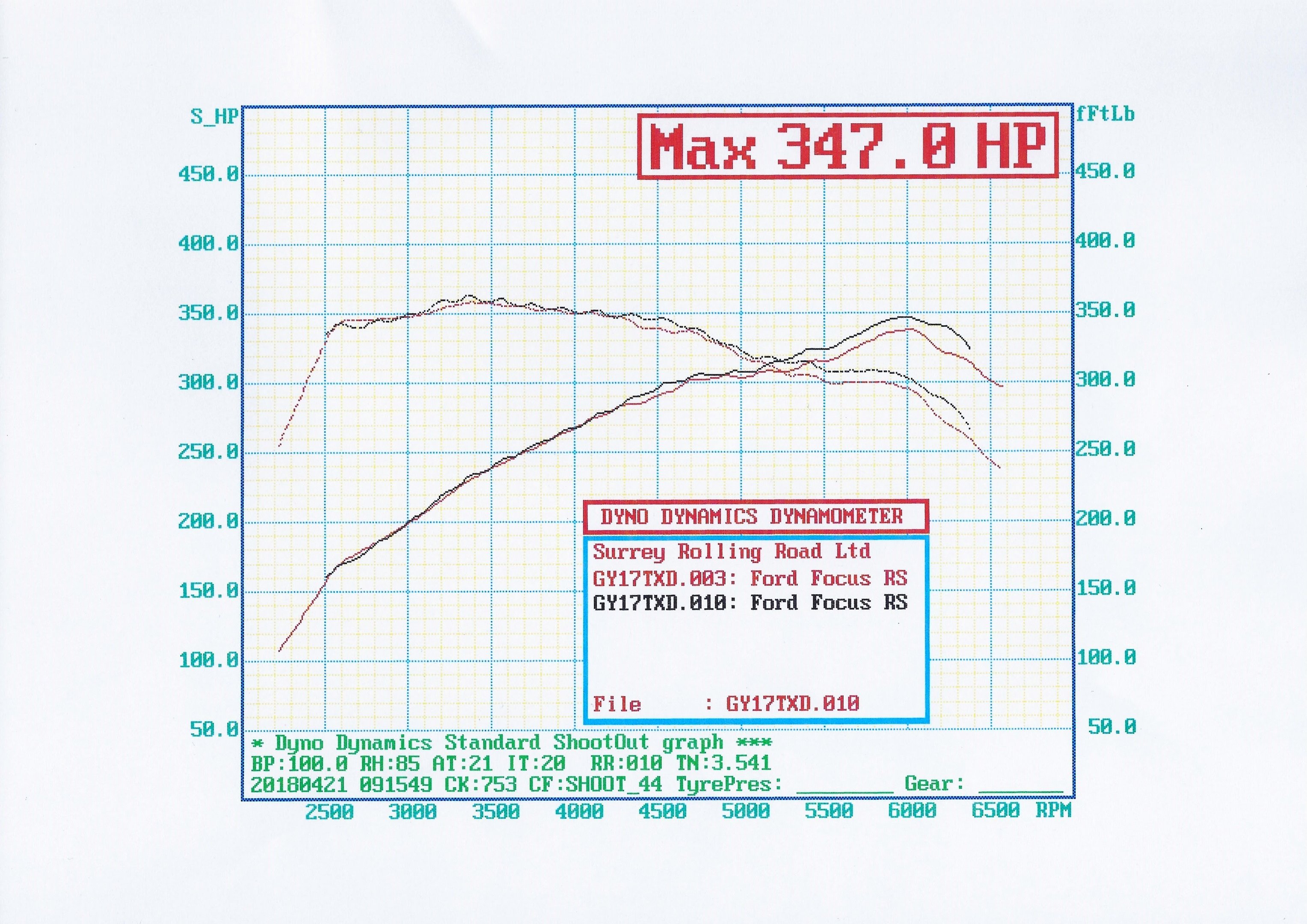

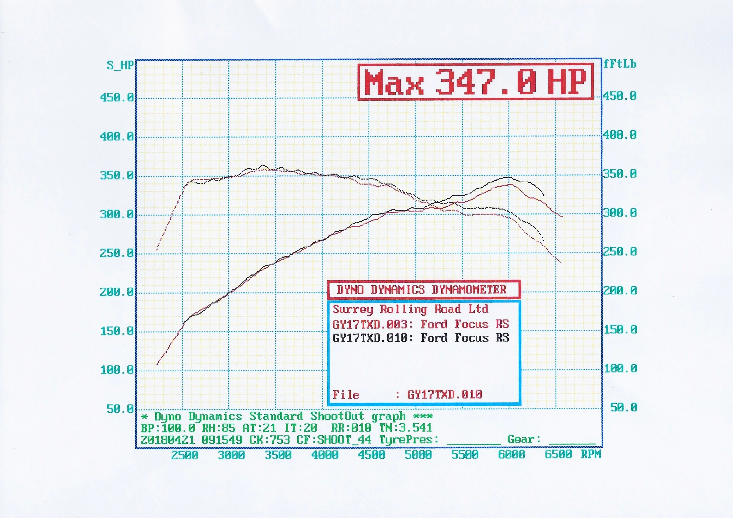

In other news I'm at Surrey Rolling Road today to have my new engine run.
Overlaying today with the original pre-engine failure run gives an interesting comparison. The engines have definitely changed!

Comparing new f1's (which were on prev), to new ps4, I've got roughly half the mileage out of them. And the f1's were subjected to a car control day, on a very abrasive airfield.

Here we go, new engine v old engine...despite starting at the exact same point with the lines tracing each other for the first few thousand RPM, the new engine starts to move ahead as the revs increase. I'm happy enough with that!

@MarkCup at what stage did you RR you old engine, was it fresh or just before it blew the gasket? Either way though 10bhp improvement is not to be sniffed at!

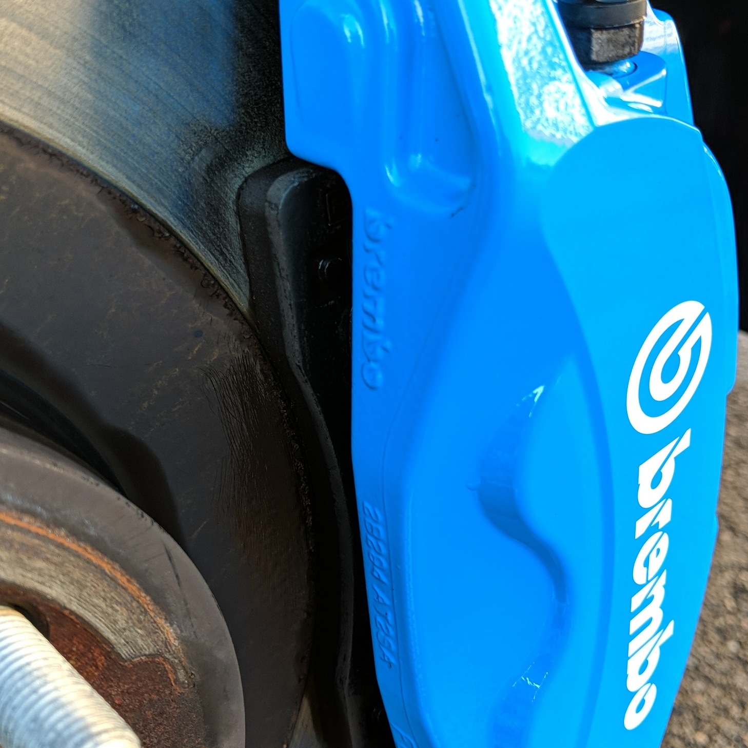

I say almost as the brakes didn't seem to hold up to Ford's bold original claim that they could "withstand 30 minutes of hard track use". They were going well all day, you only get 15 miuntes at a time at Goodwood, which in reality is more like 13 minutes, and with an out lap and cool down lap that's circa 9 minutes of full on driving, nowhere near the 30 minutes they claim.
As I know Goodwood like the back of my hand I was seeing what the RS could do and the brakes just absorbed whatever I could throw at them, the pedal stayed firm, required pressure stayed constant, in short, they were epic. That is until @Sir_Dave jumped in for a ride...

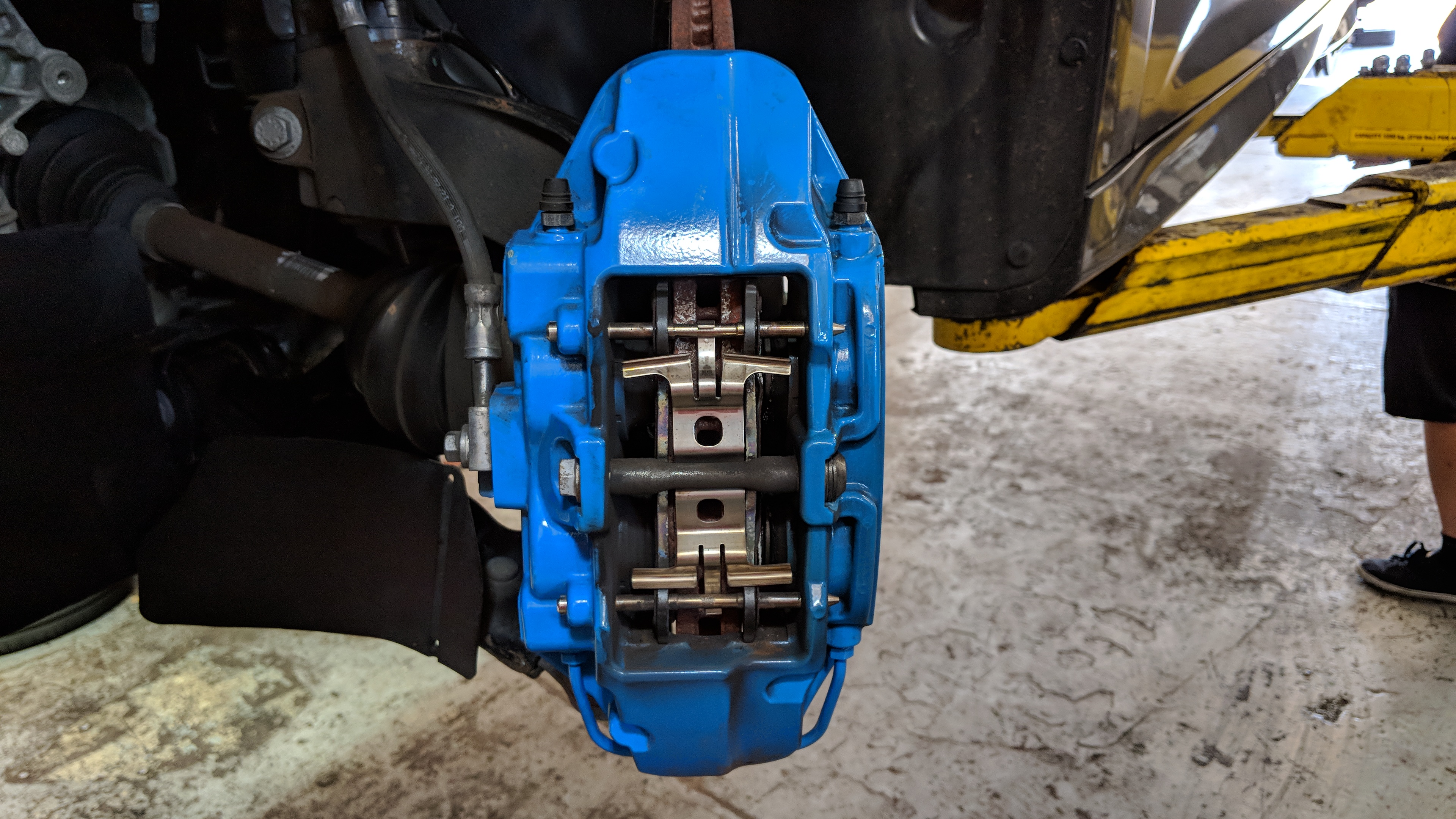

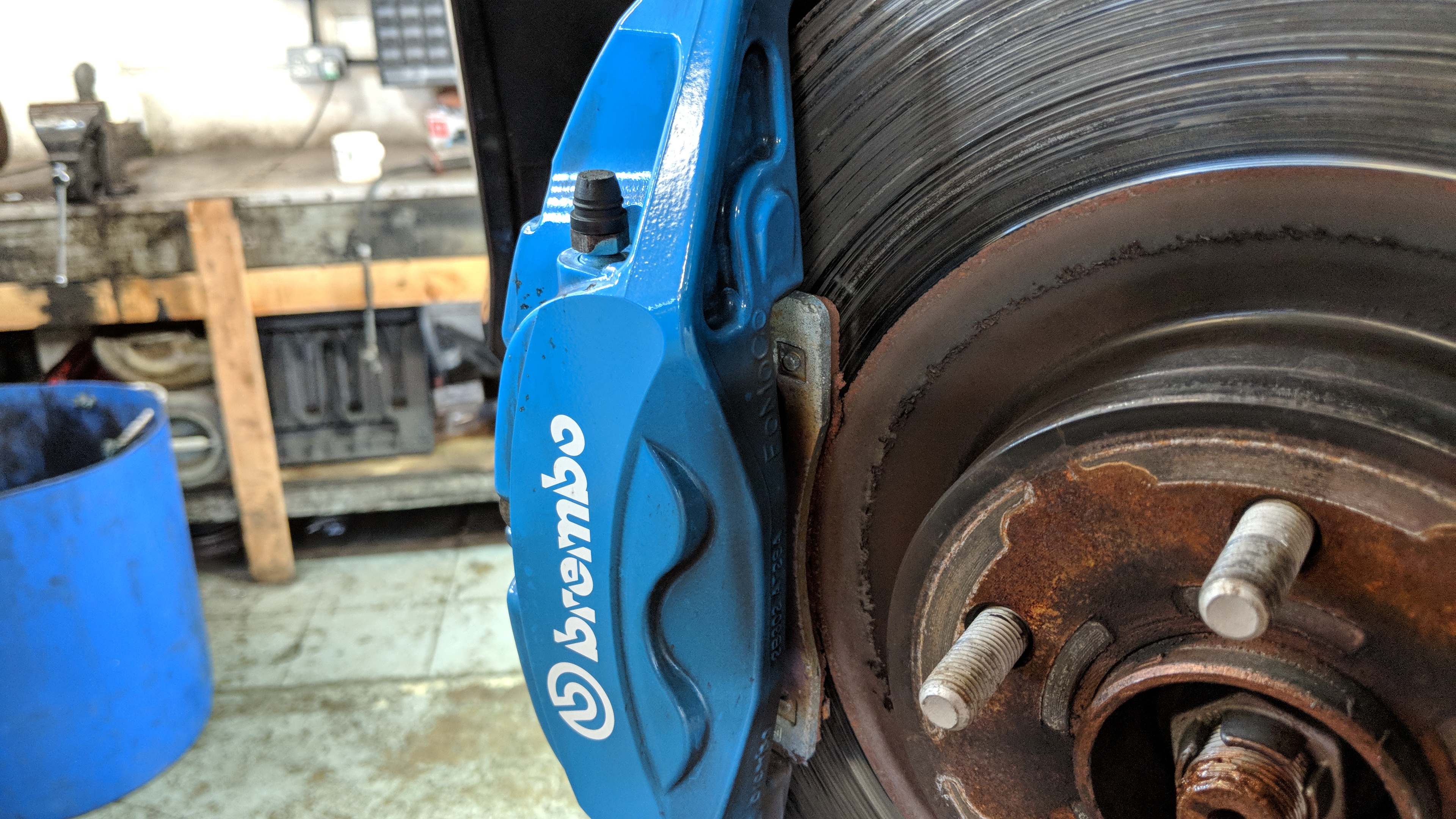

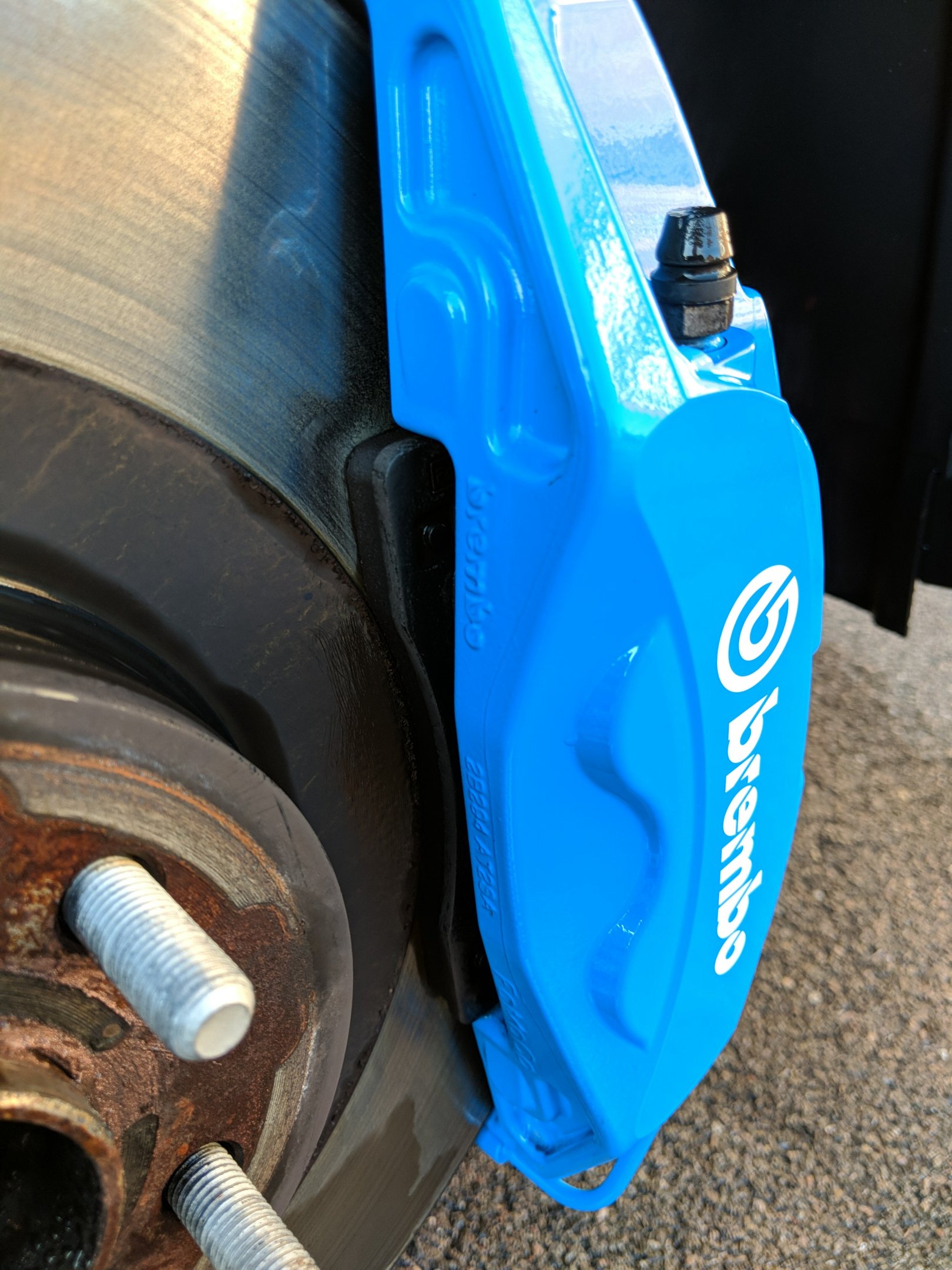

We were talking about just how good the brakes were when I suddenly had that sickening sense through the pedal that something was grinding. Pads worn down? Unlikely...this is what they looked like two ago as I went into full-on detail mode giving the car a thorough detail clean...
So I called it a day for that session, let them cool a little, visually inspected them, had a test drive around the paddock to see if it might just be pad deposits (there was still visible material on the outer pads on all four corners) but no. Time to end the day at about 1530.
Then off I went to have new tyres fitted this morning as three of the four had done 15.5k miles (the other was almost brand new following a recent puncture and being the back right had done next to bugger all work at Goodwood) and although the other three still had life left in them I wanted balanced new rubber all round...
While it was in I asked if I could take a look at the brakes. "No sir, health and safety and all that" came the response so I sat down thinking I'd need to get it up on stands at home this afternoon to see what was up as I still had the grinding.

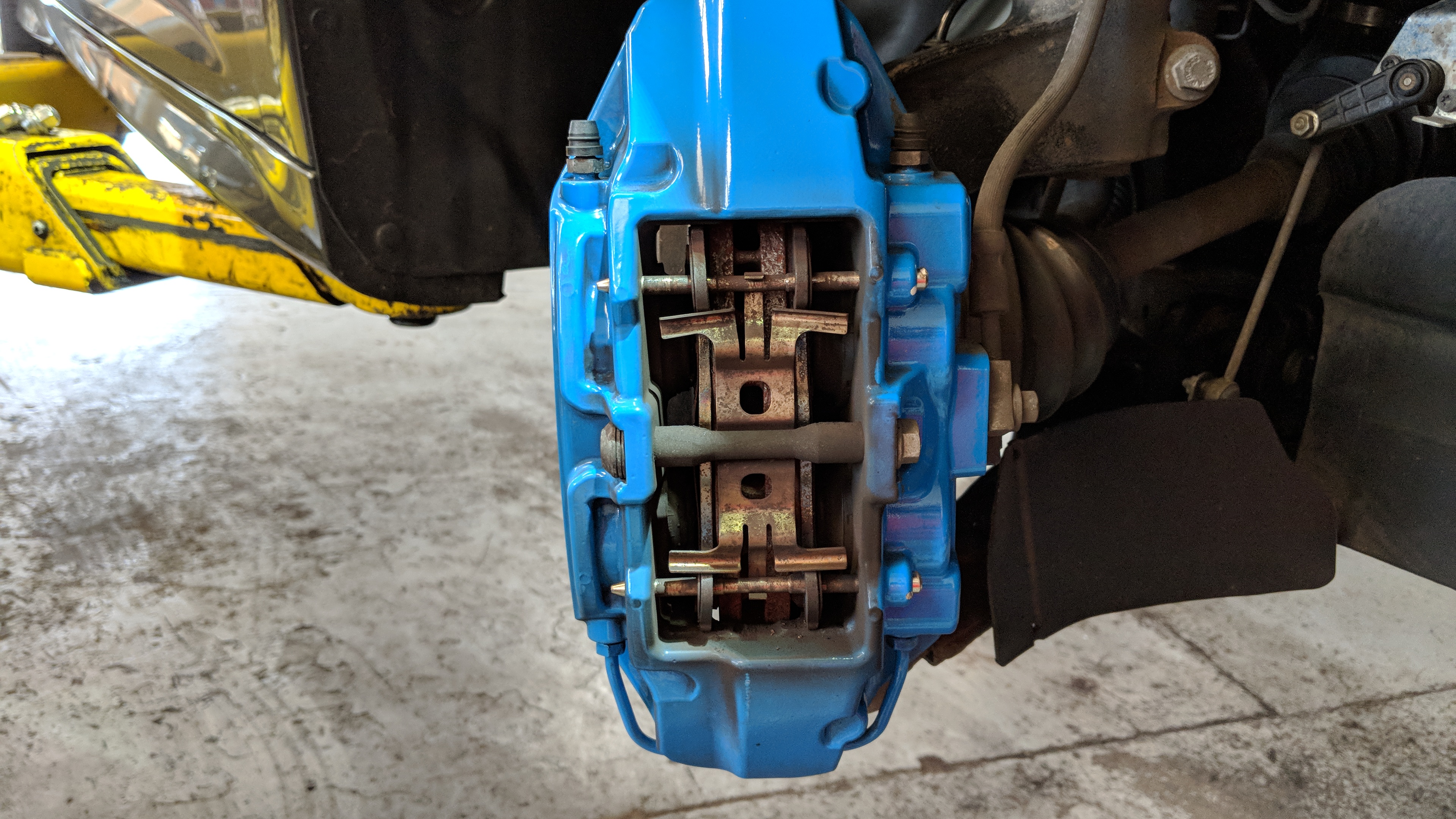

Then 30 minutes later I hear "Mr Briggs...err, umm, you might want to come and have a look at this"...

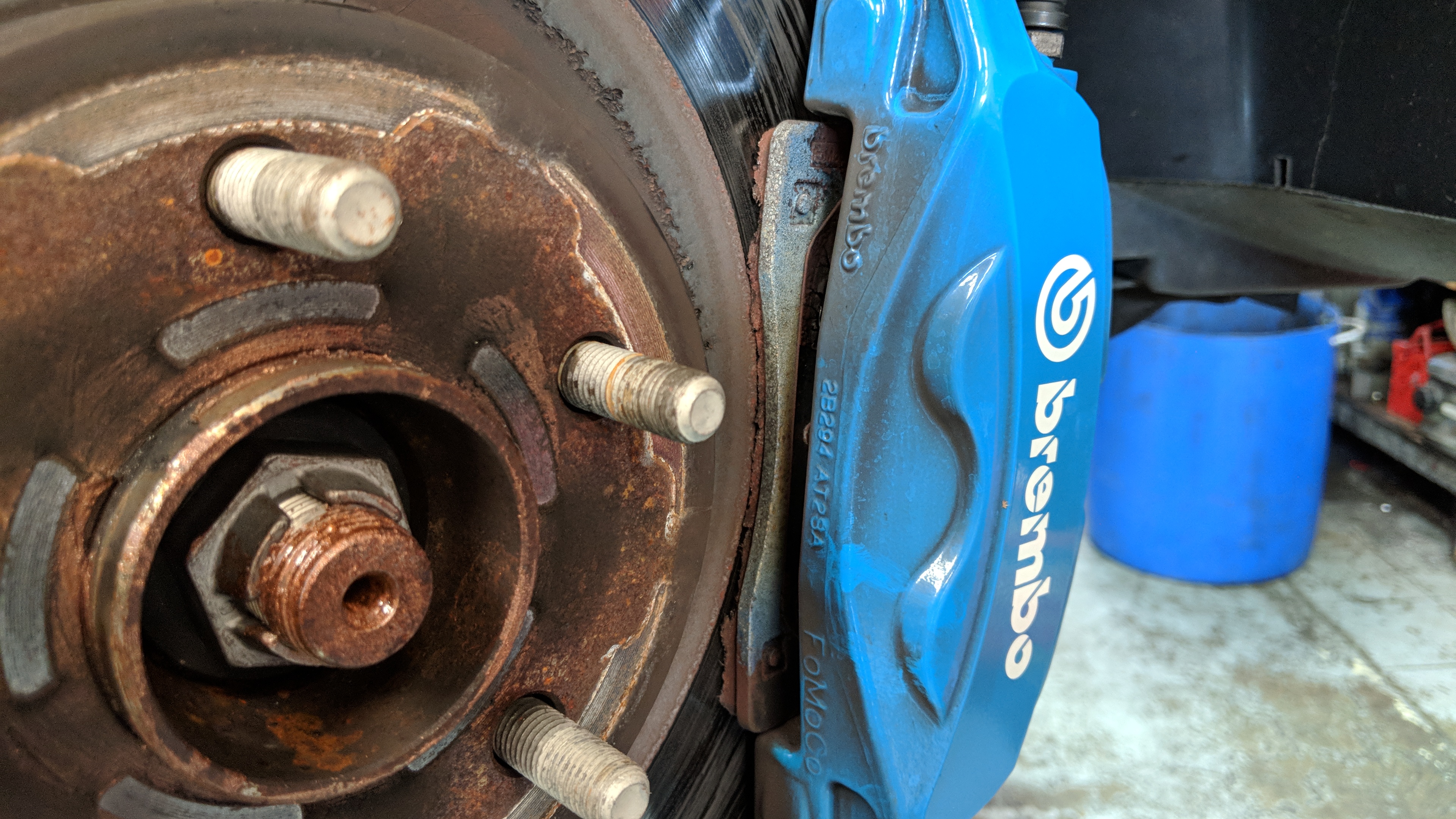

The pad material crumbling wasn't a suprise, I've had that many times before on many different pads, nor was all of the paint on the backing plates and hubs having been completely burned off...but this was...
Not only do that pads seem to have worn unevenly (the lower outer piston in the first picture has managed to get the backing plate itself quite worn but on the inside the top most piston seems to have done more work)...in the bottom picture it looks like I've actually bent the pad backing plates!
I've no idea what's gone wrong but the pressure balance across the pistons seems to go to s**t as soon as things get, ahem, a little heat in them. It had the tyre fitters chuckling LOL
