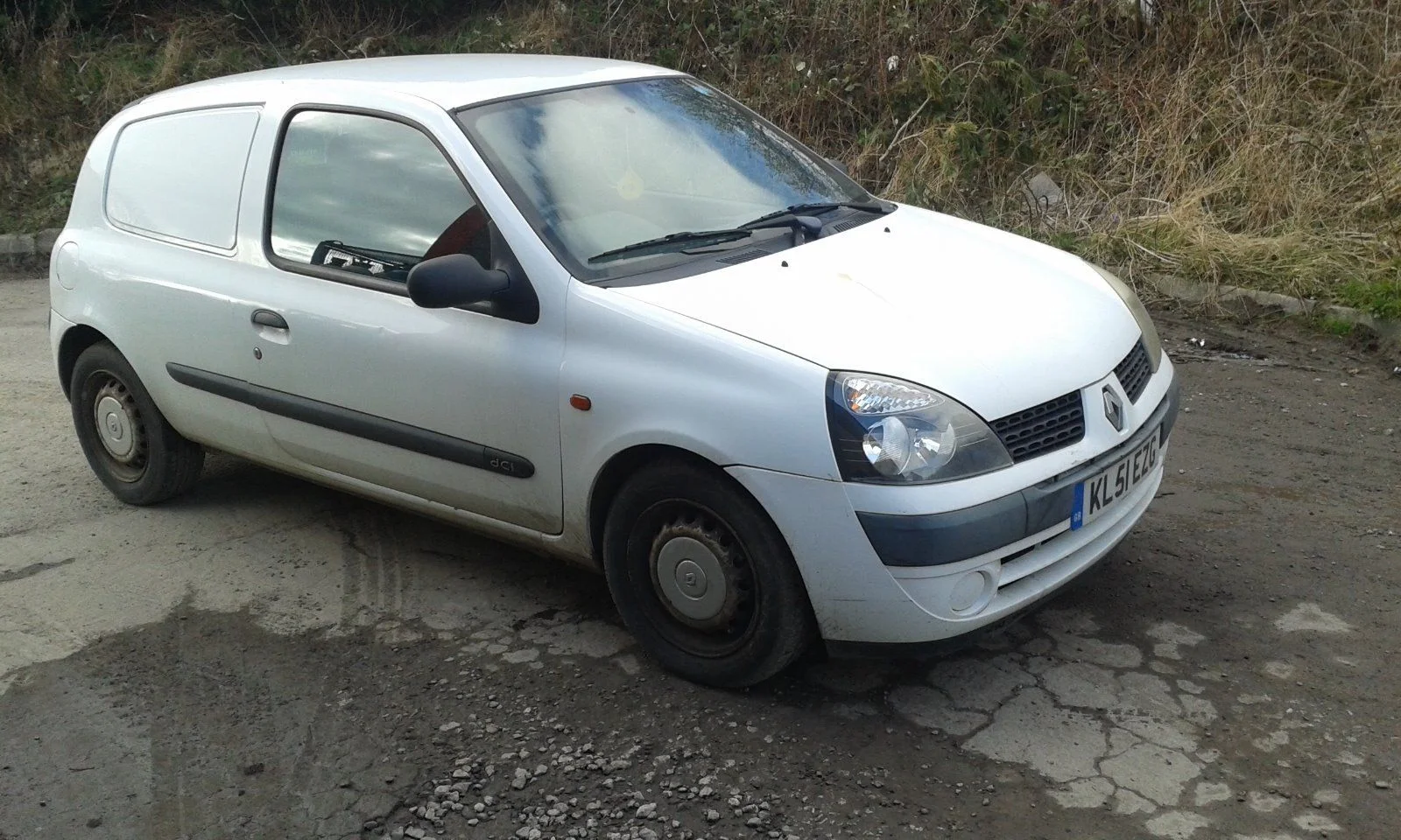

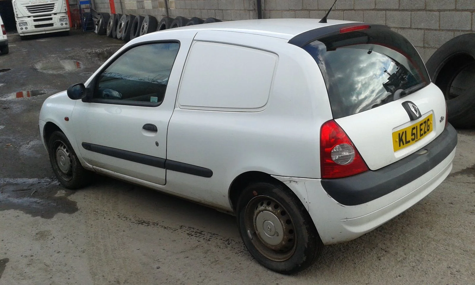

then one night on ebay I see an auction with 30 seconds left to go, a 2001 1.5 DCi van, in white, sitting at £250 with zero bids, a very quick look at the details shows its advertised as spares or repairs, 120k, MOT expired but starts and drives with a few knocks. Another quick look at google maps shows its in Sheffield about 4-5hrs drive away, so I bid £250 and win it with seconds to go!
Messaged the guy and basically said, honest opinion should I bring a trailer down or just drive it up the road? he said it starts, drives, stops just a bit rough, so I packed the Mrs mk4 Clio with tools, tow pole, and anything else I may need and booked an mot local for me to legally get it up the road. Headed down with my mate to collect it.

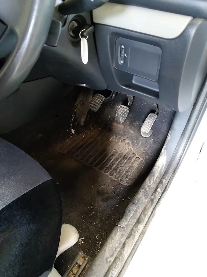

So here it was in all its glory. a few knocks was an understatement ive never heard wheel bearings so badly worn the full car was shaking the full way home, to make things worse the radio code was needed, i had the app on my phone to get it but no tools thin enough to get the head unit out to get the details!!, luckily I found a pair of ear muffs for sale in a service station so that sorted out the noise, my arms were numb from the vibration by the time I got it home. the rear brakes are also making a horrid noise I assume there is no shoes left!
The little engine runs sweet as a nut, sounds perfect.

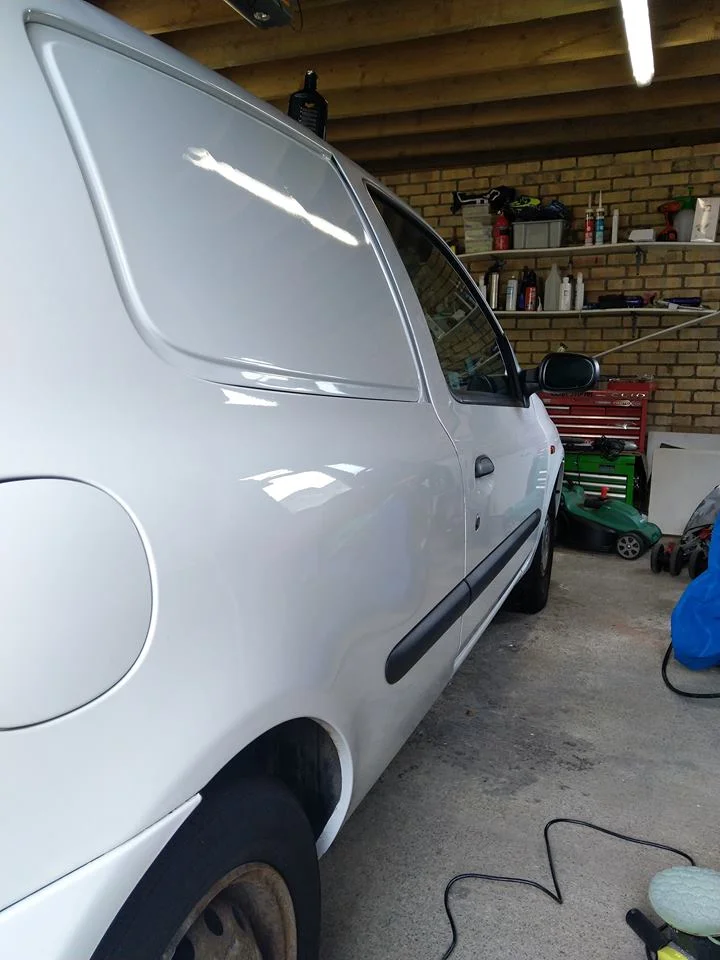

by the time I got it home I was close to cutting my losses and driving it straight to the scrappies but I decided first to clean it up and make myself feel better about it before getting my hands dirty!

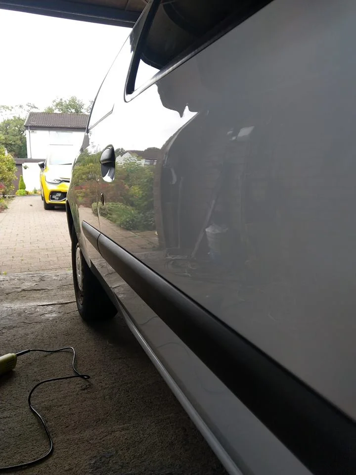

after attacking it with the clay bar and machine polisher its a cracking little shell, other than the corner of the rear bumper and a bit on the front bumper there is literally hardly a mark on it!

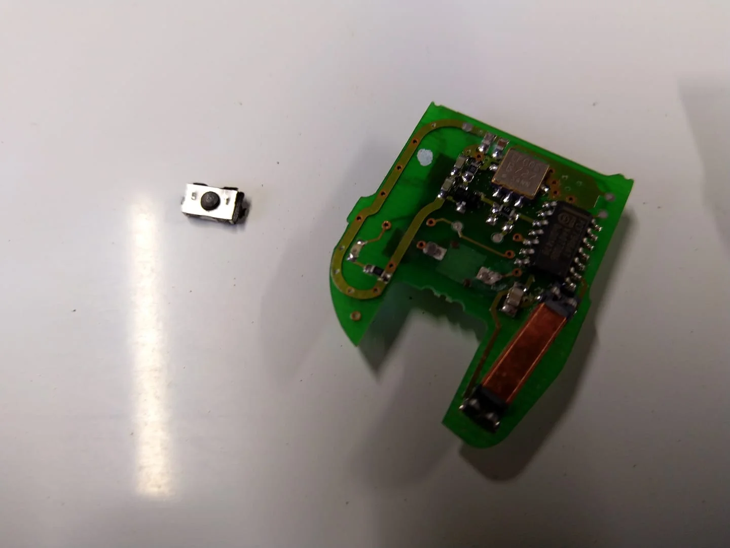

The central locking didn't work from the button on the key so I took it apart and found the button was broken off, so I popped a spare key I had from another car apart to have a look at exactly how it goes back together and soldered it back on that fixed that!..

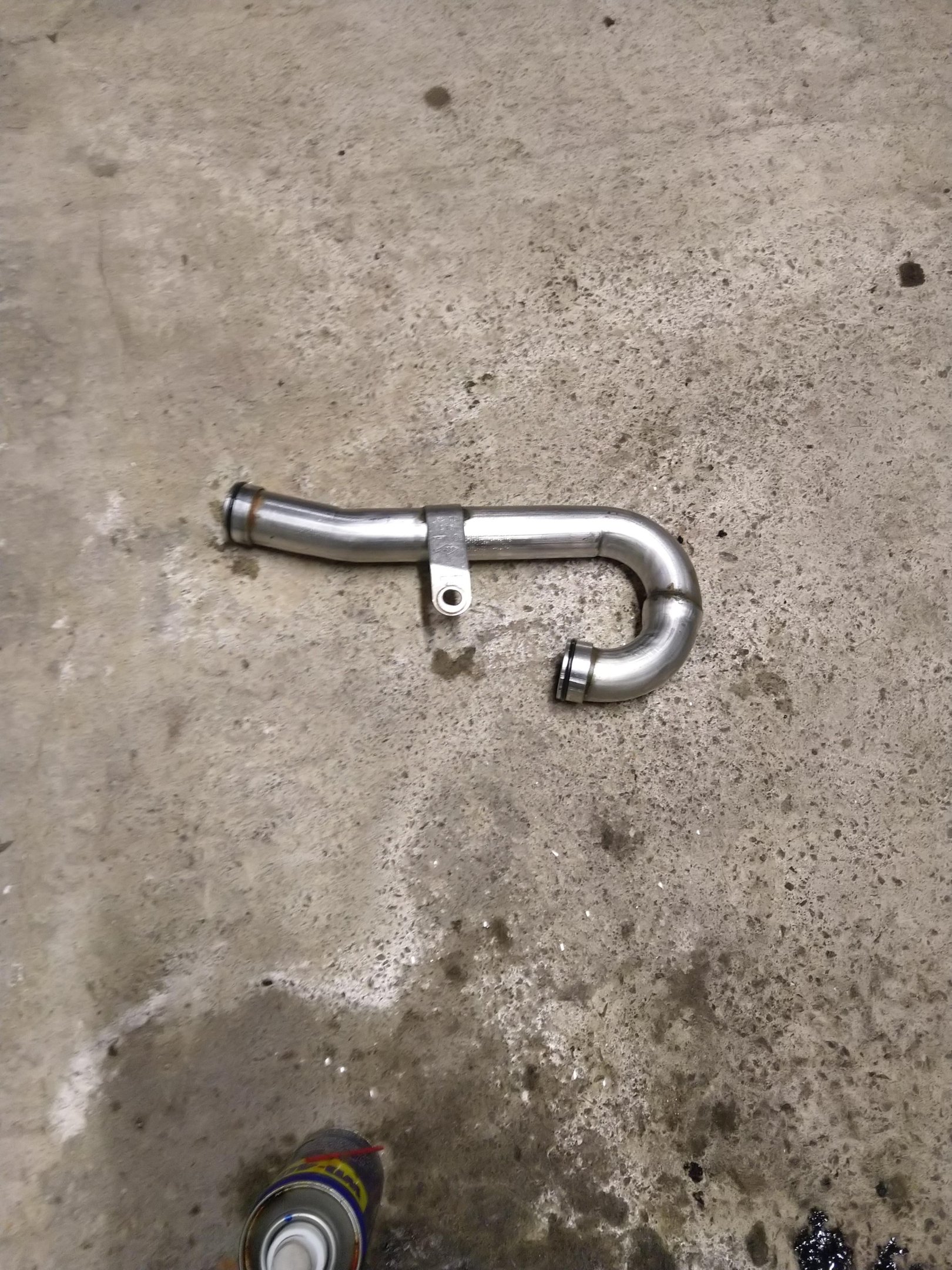

Will have a look, I like the Dacia one as it slots in perfectly where the 100 one mounts and uses the same pipework, I've got all the spare pipework from a 100 too!!

Pricing seems all over the place with them saw a second hand good condition one for £30 last month kicking myself for not picking it up. Finding good condition 100 ones are getting hard to find although I notice the campus dci70 used the same intercooler!

Yeah dCi 68 use the same setup as the 100
If I were you I’d be picking stuff up all the time if it’s that cheap!
I bought a full dCi 100 for parts so I wouldn’t have to buy any large bits for mine for a while

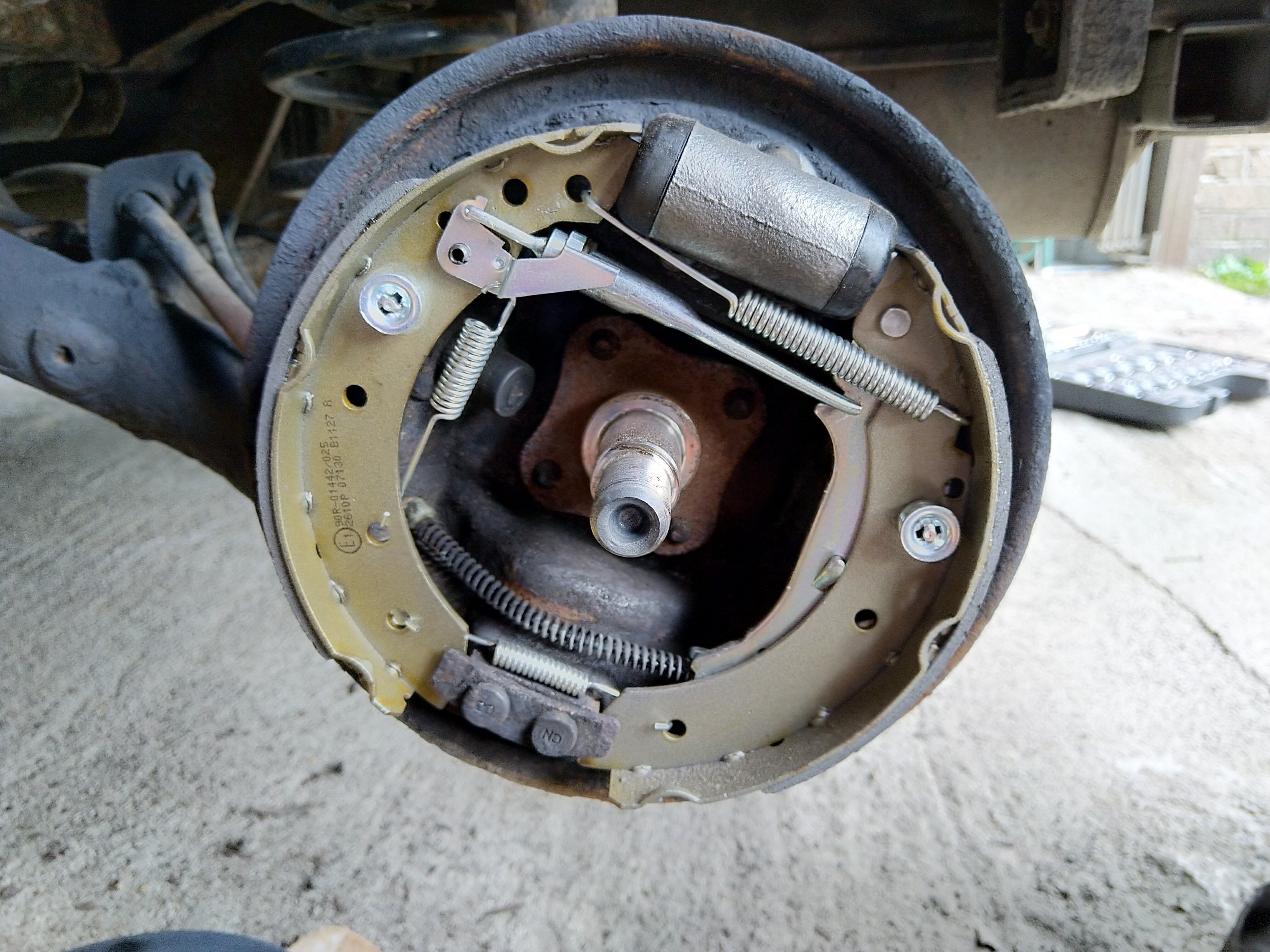

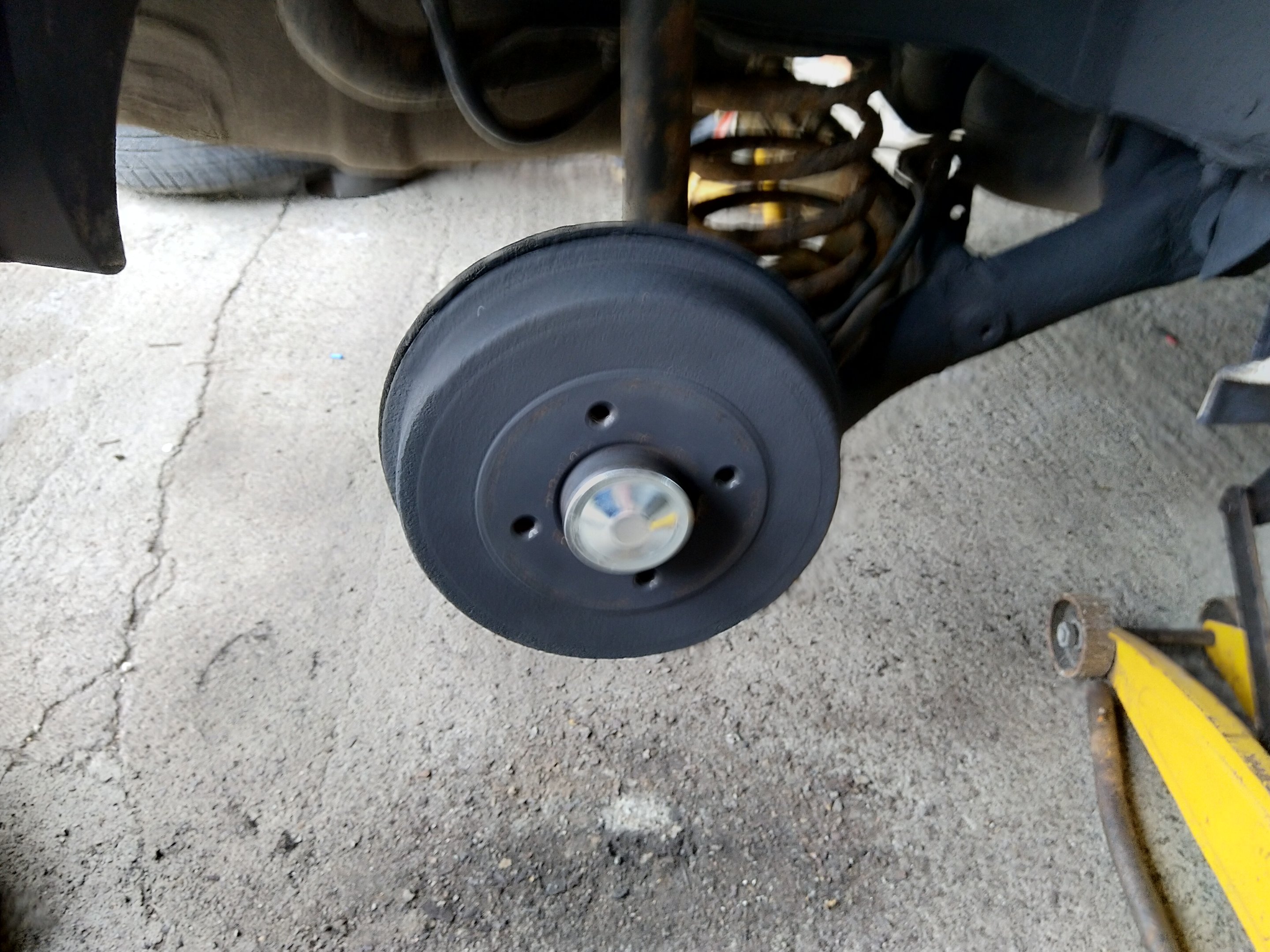

moved my attention to the rear end, more noisy wheel bearings and the rear shoes were down to the metal and making a horrid noise!
a new shoe kit with new brake cylinders, pressed a new pair of bearings in and gave the drums a quick rub down and coat of matt black high temp paint I had lying about from when I painted my old 172 rocker cover!

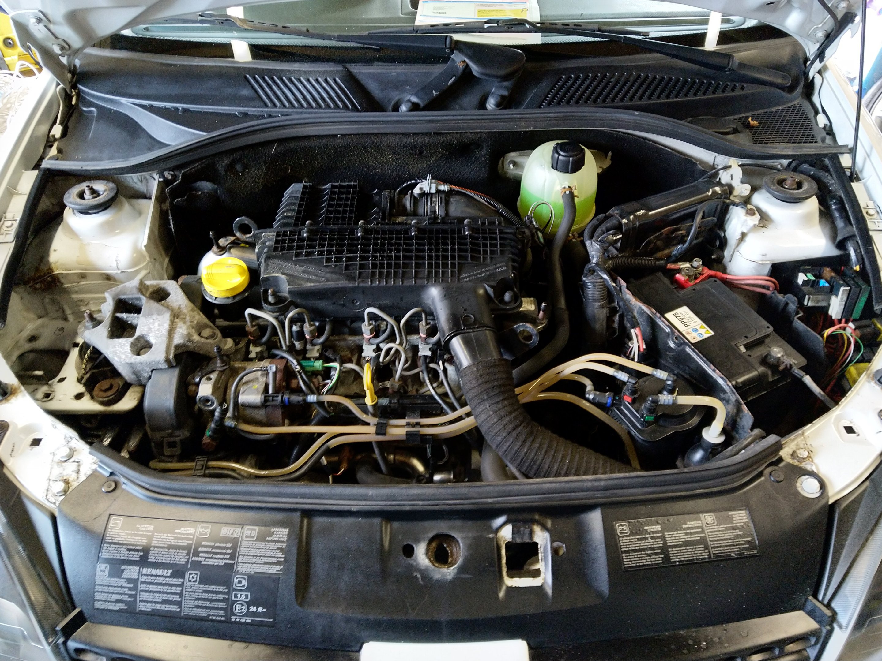

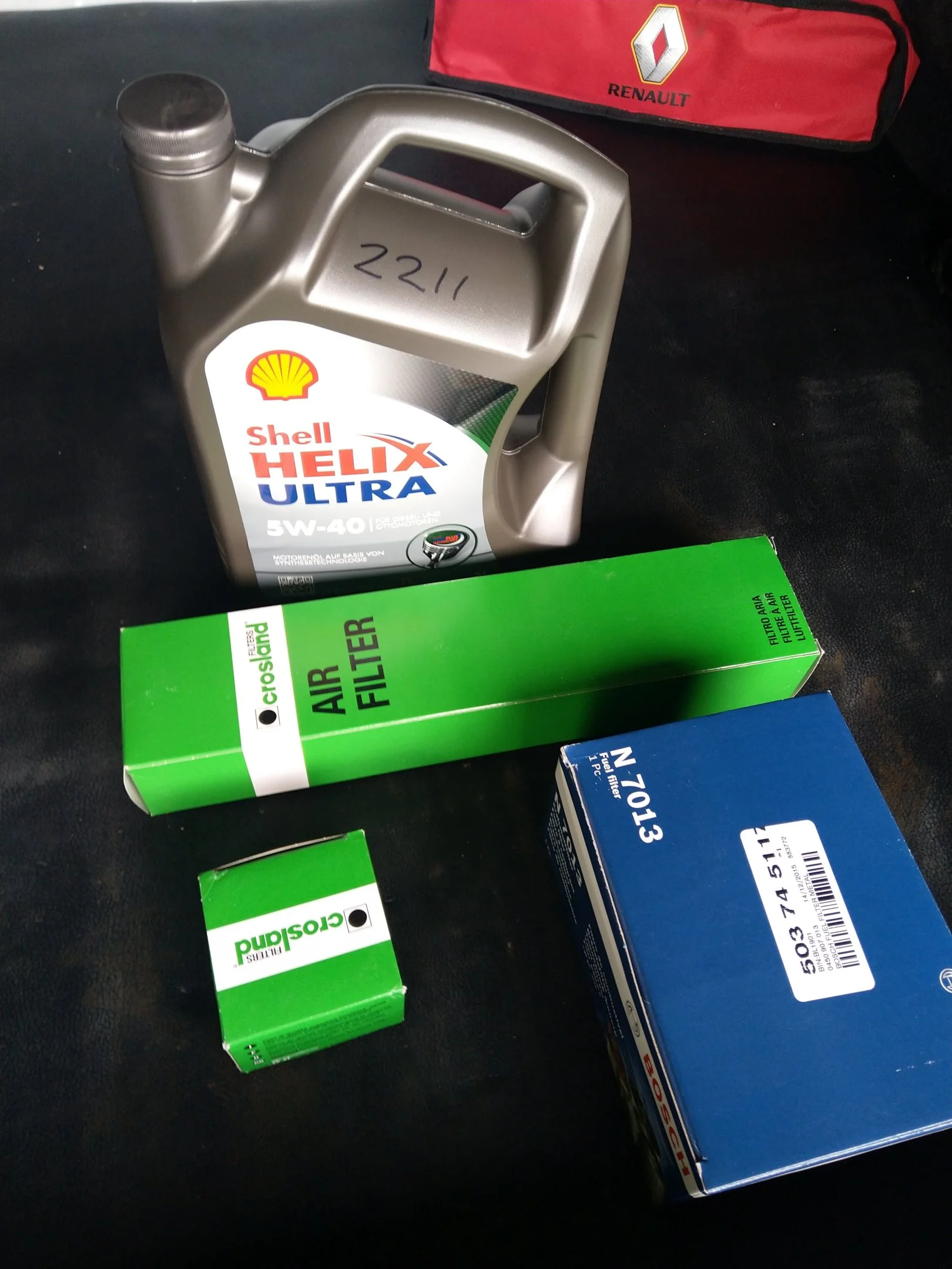

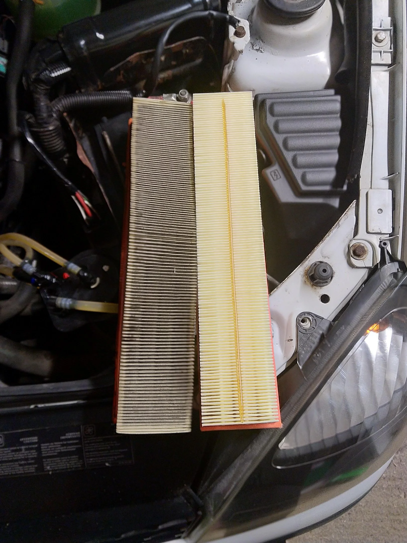

gave it a full service with new oil, oil filter, air filter and fuel filter
will
w
Will do a belt change when/if it passes an mot!!!

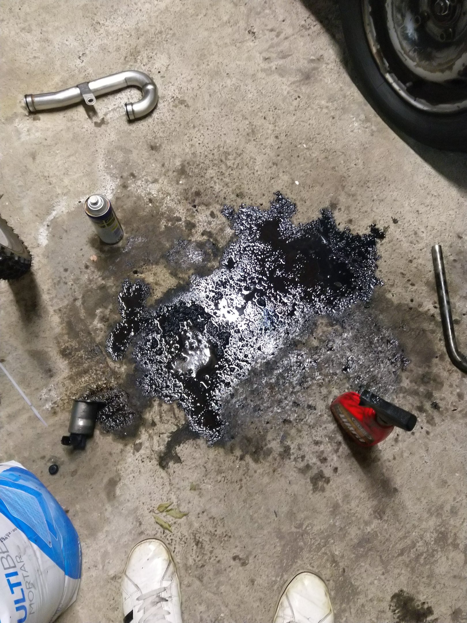

whipped off the EGR valve to find it was completely coaked full of soot, however surprisingly not a bit of oil! just dry soot so it pretty much blew out with the air compressor.
I then pulled off the inlet pipe and it was also coaked with soot (thanks EGR valve...) so I attacked that with the degreaser and got it as new!
one happy engine!...

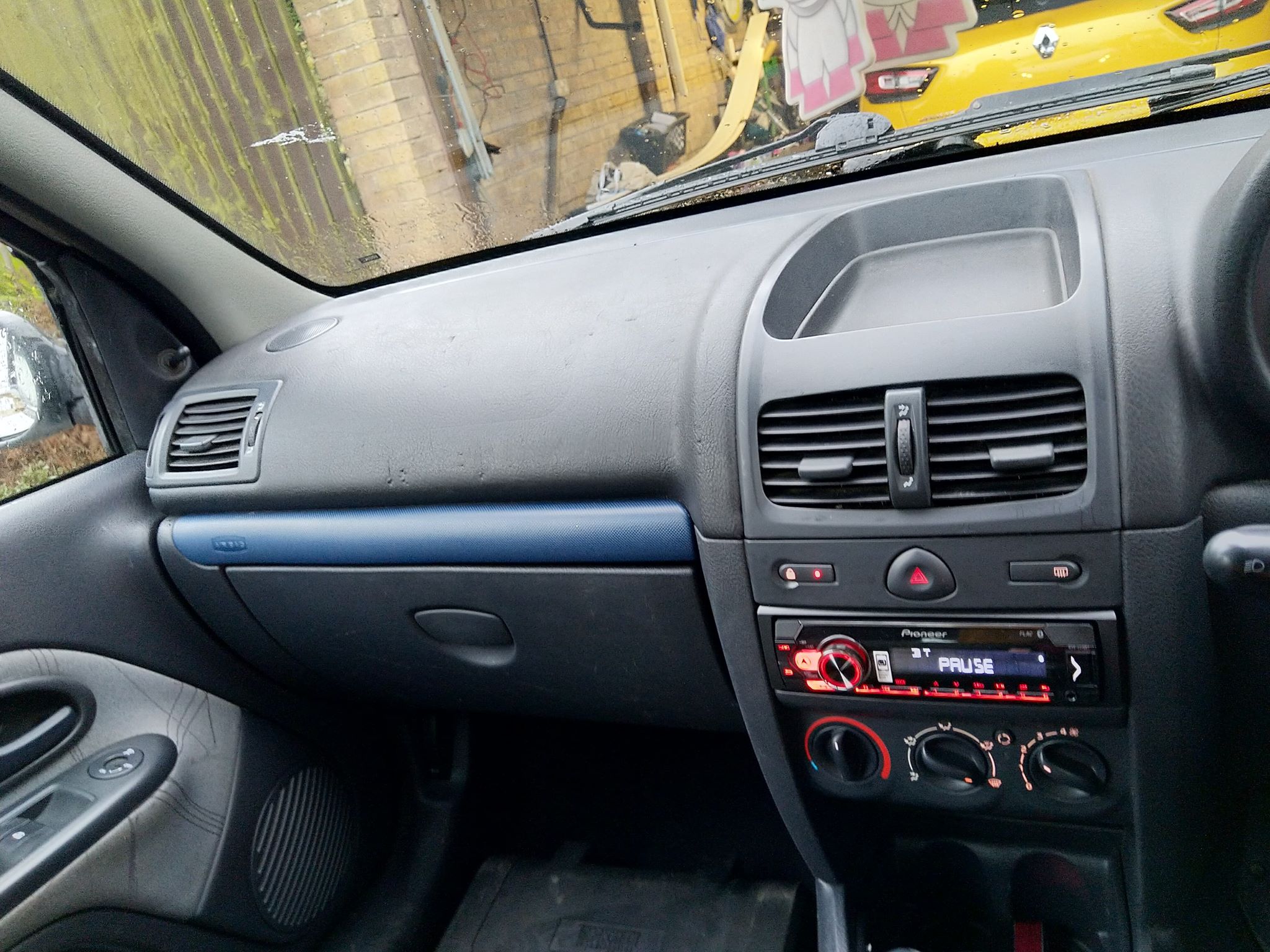

Got a new Pioneer Bluetooth head unit at black Friday for it for £50 from halfords, wired in the mic up on the pillar at the sun visor where its out the road. Bluetooth calling is better in the van than it is in the 220 trophy now!!
also had to go to the scrappies for 2x new front speakers as they were blown so got some meatier ones from a Dynamique than the poor ones that were in it and while I was there found some special edition 1.2 that had some blue dash strips (but the textured ones like the base modes) never seen them before so picked them up to brighten it up, just need to sort a pair of front seats and door cards to tidy it up inside now
