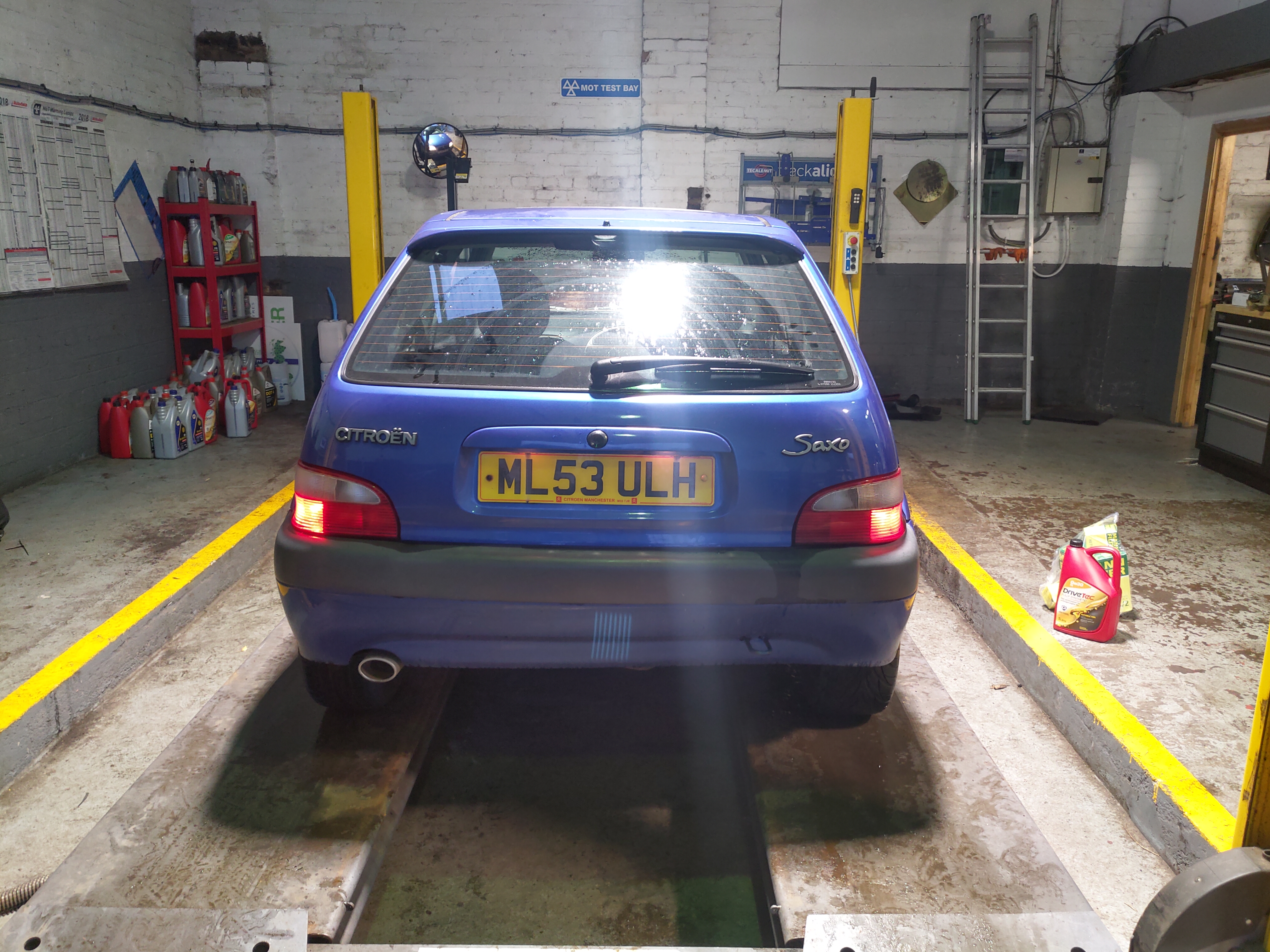

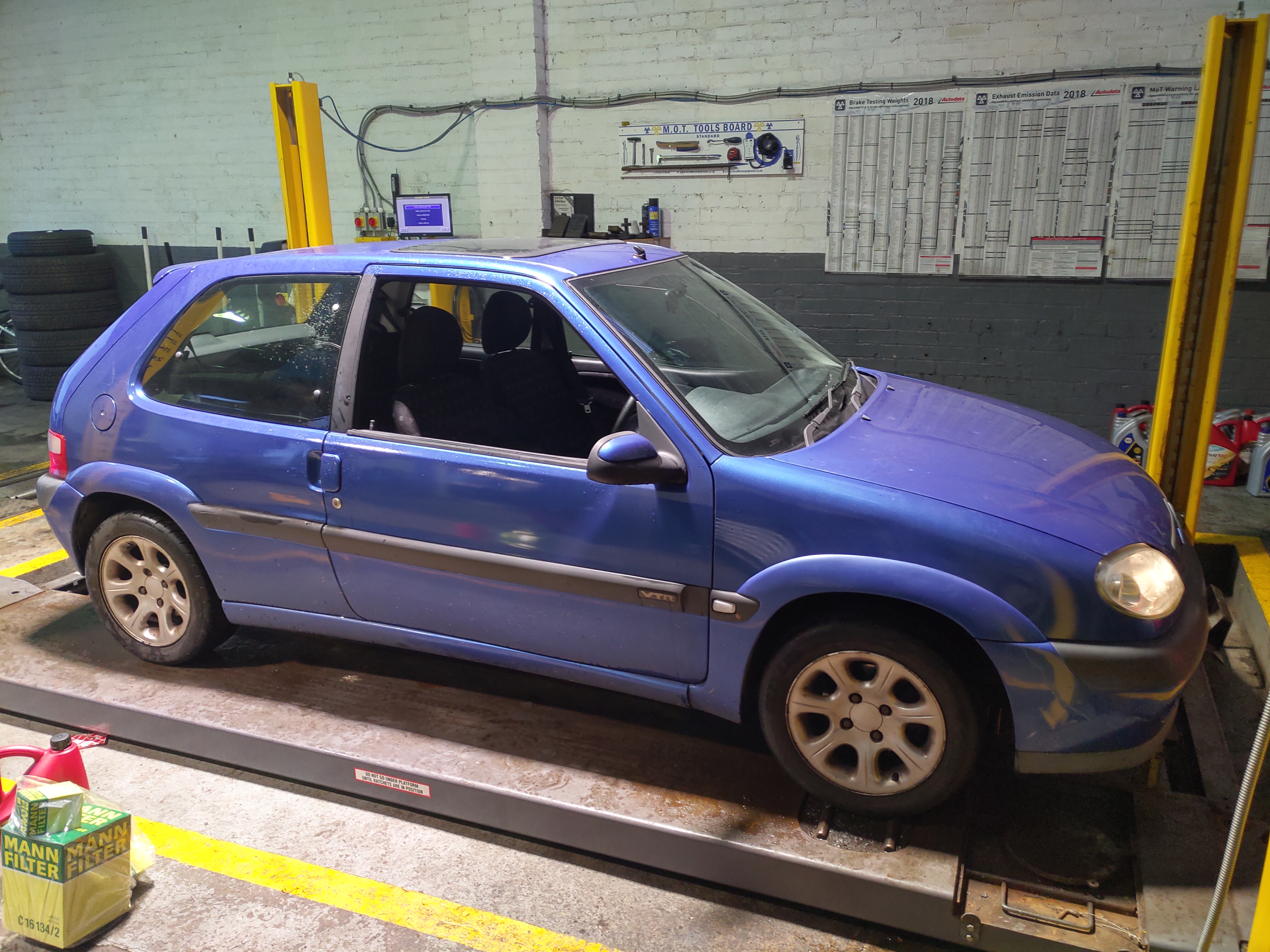

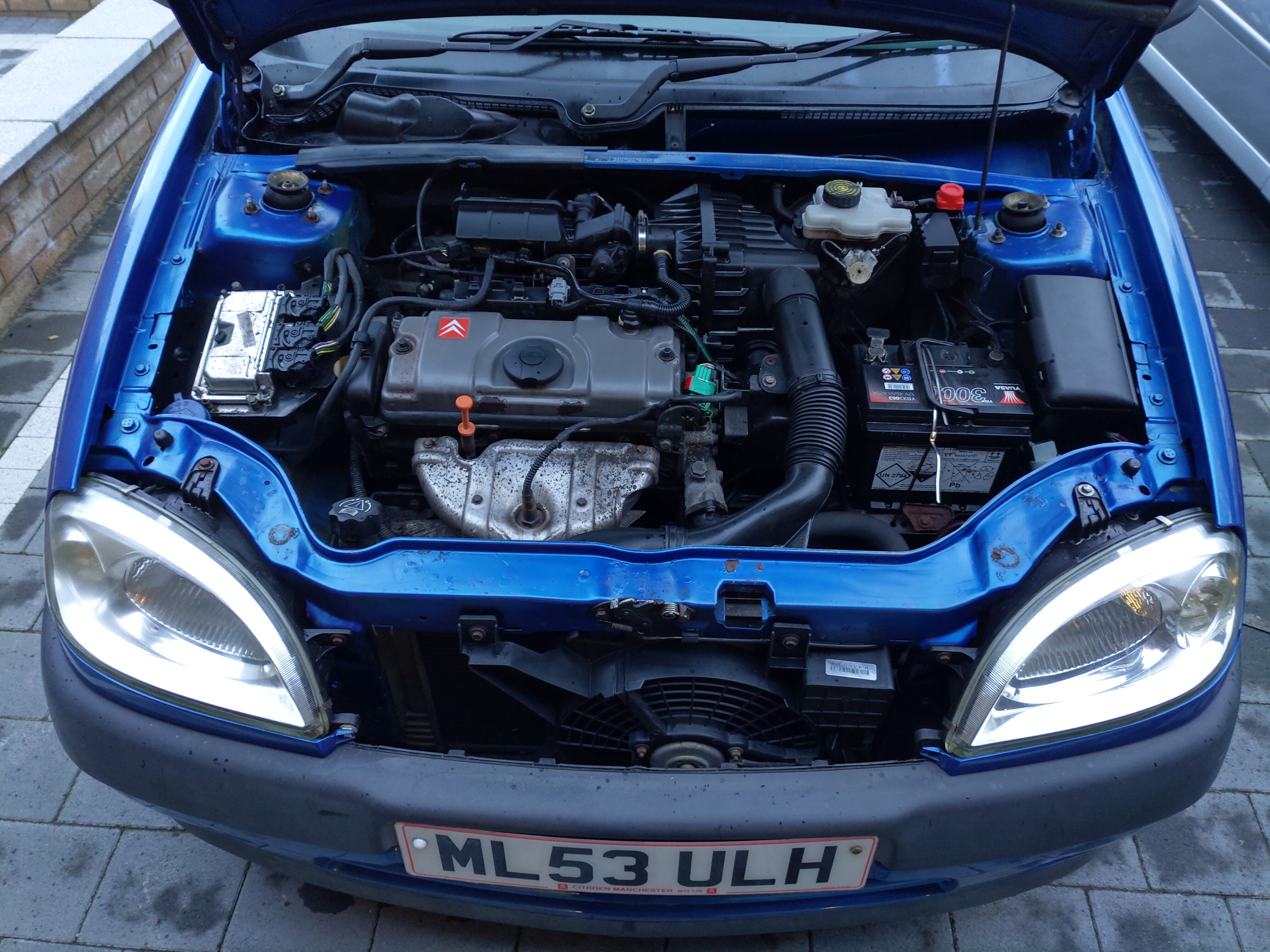

Bought this at work this week, done just over 60k, is 100% standard which i didn't think still existed!, Standard suspension, standard airbox, even has the standard stereo in the boot which ill stick back in! no 6x9s in the shelf etc lol

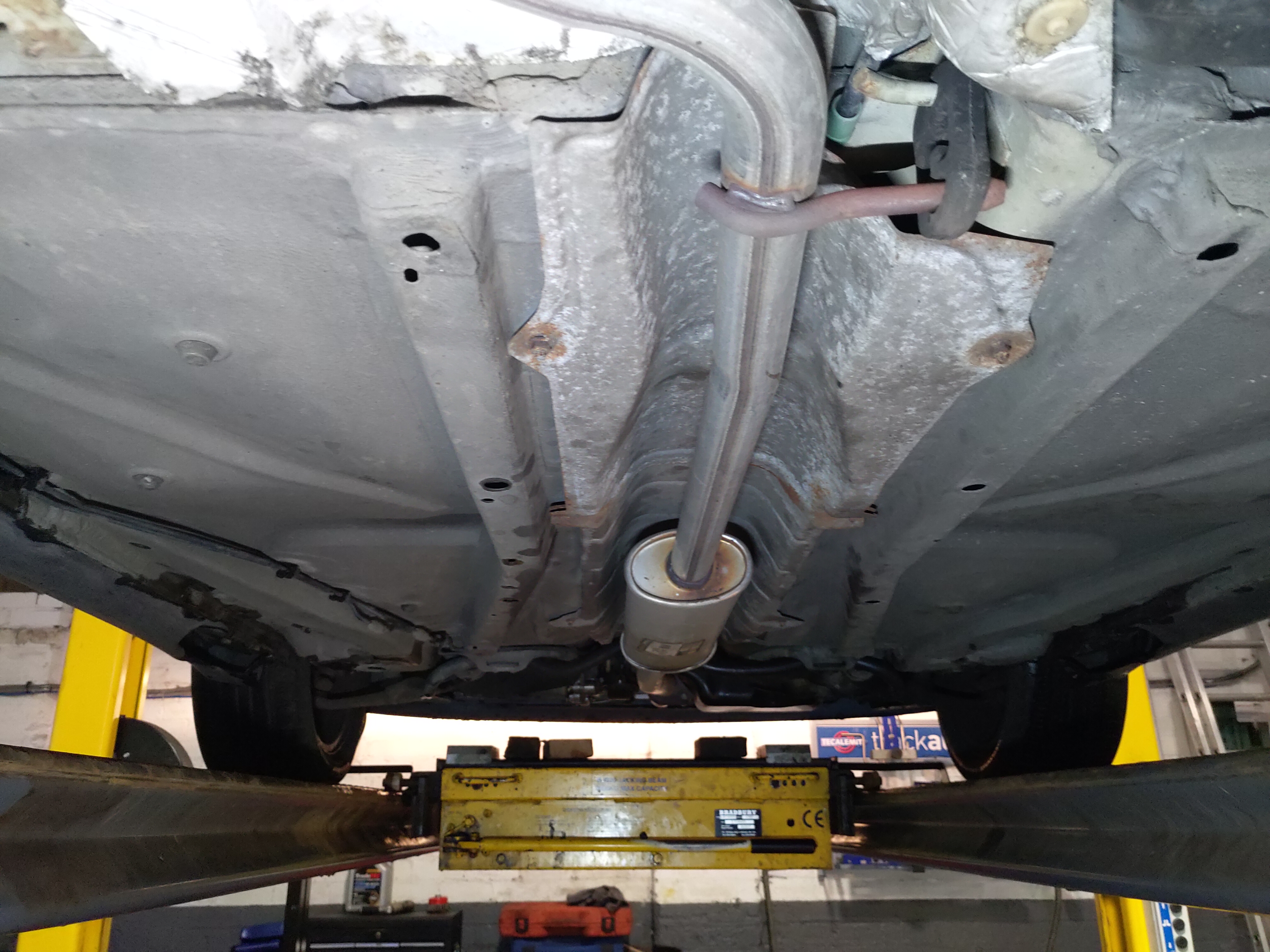

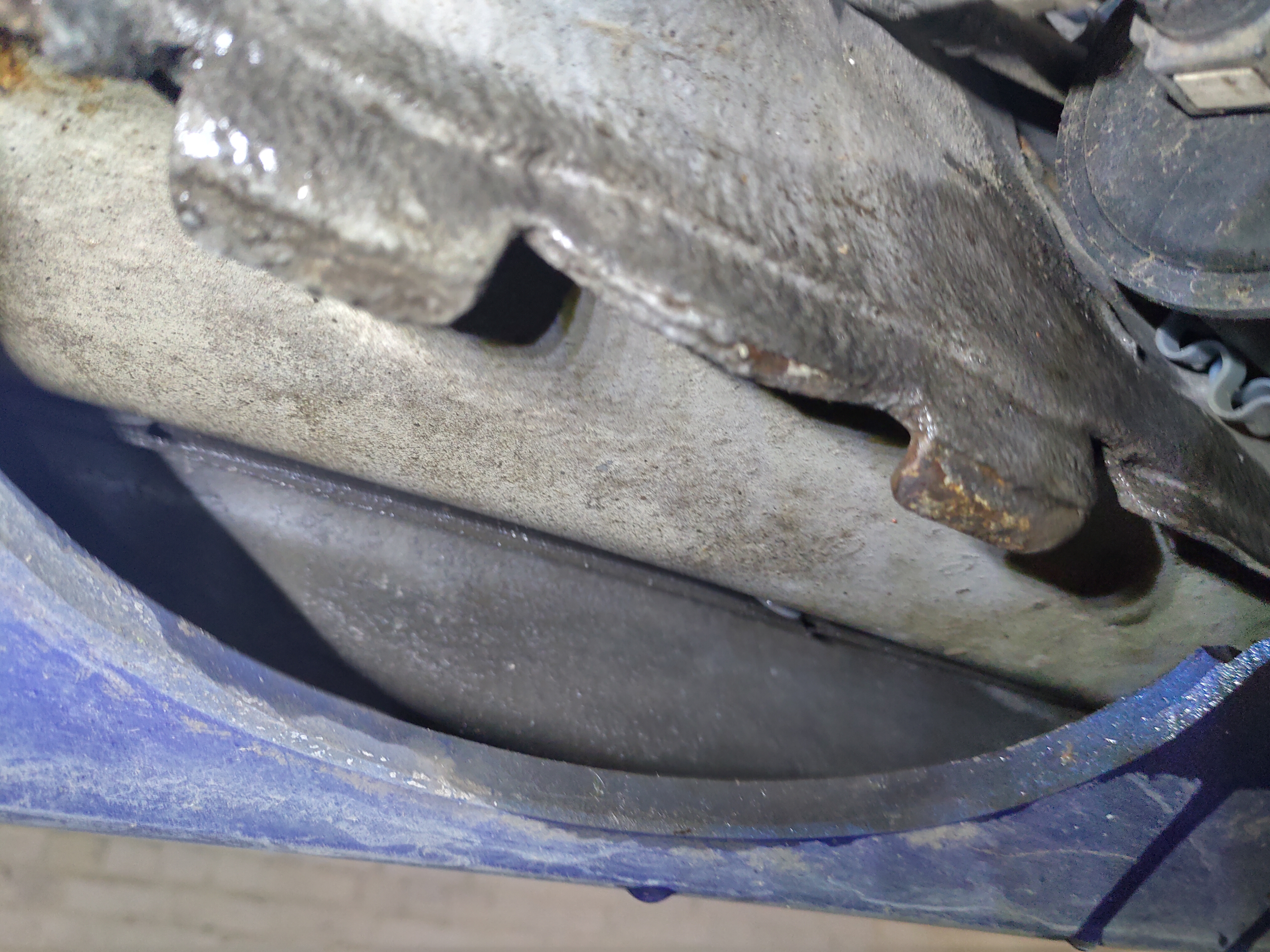

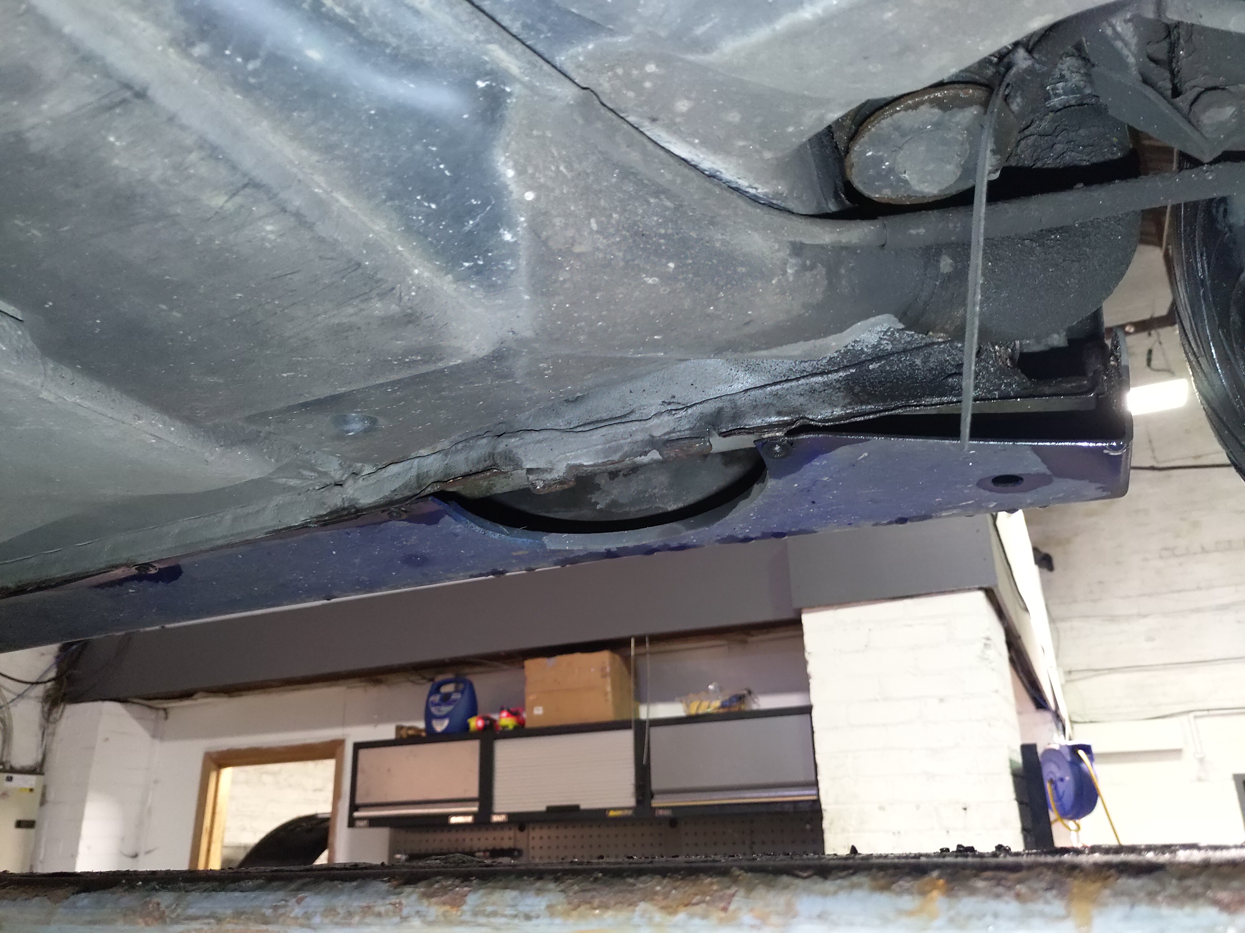

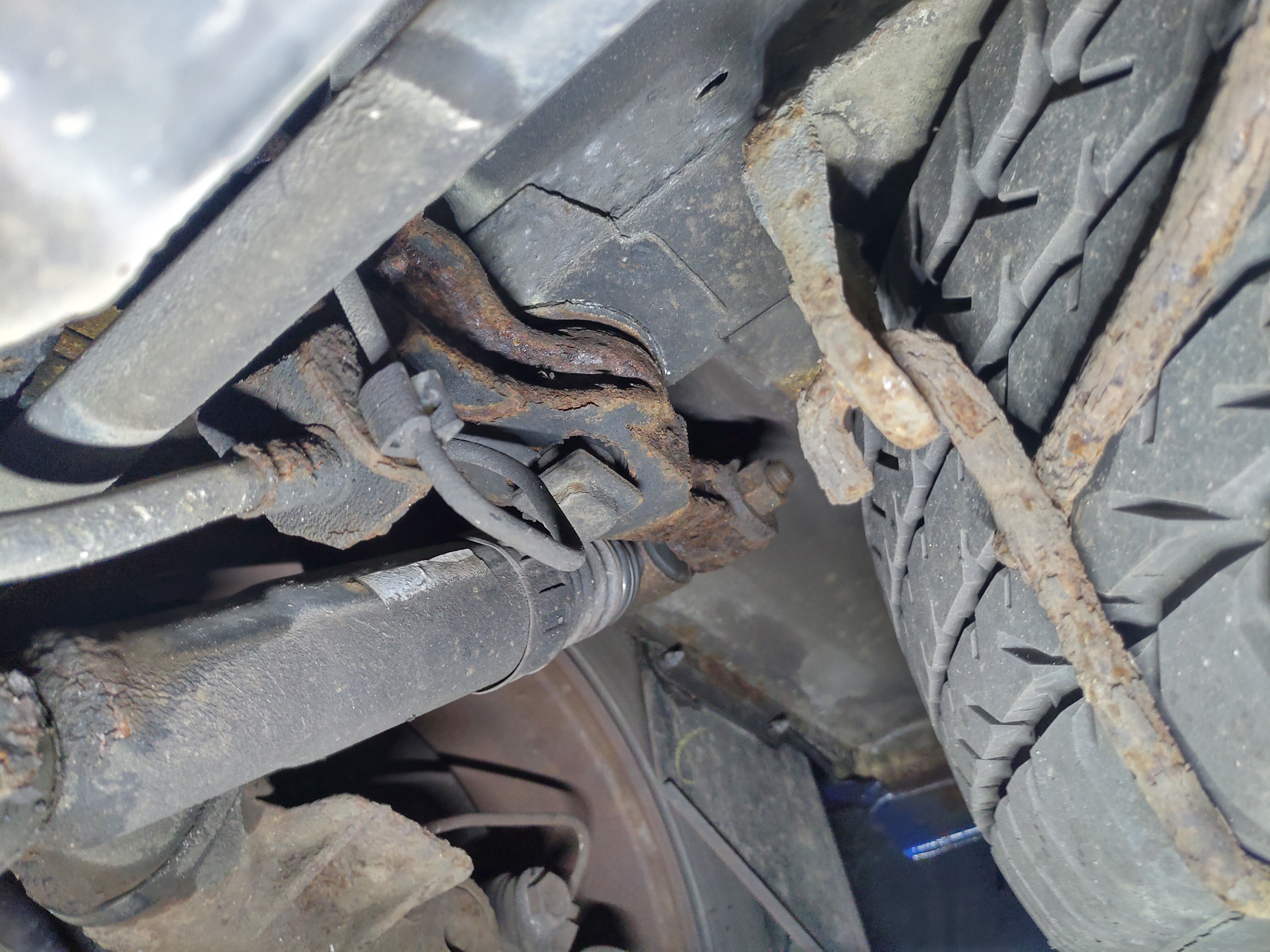

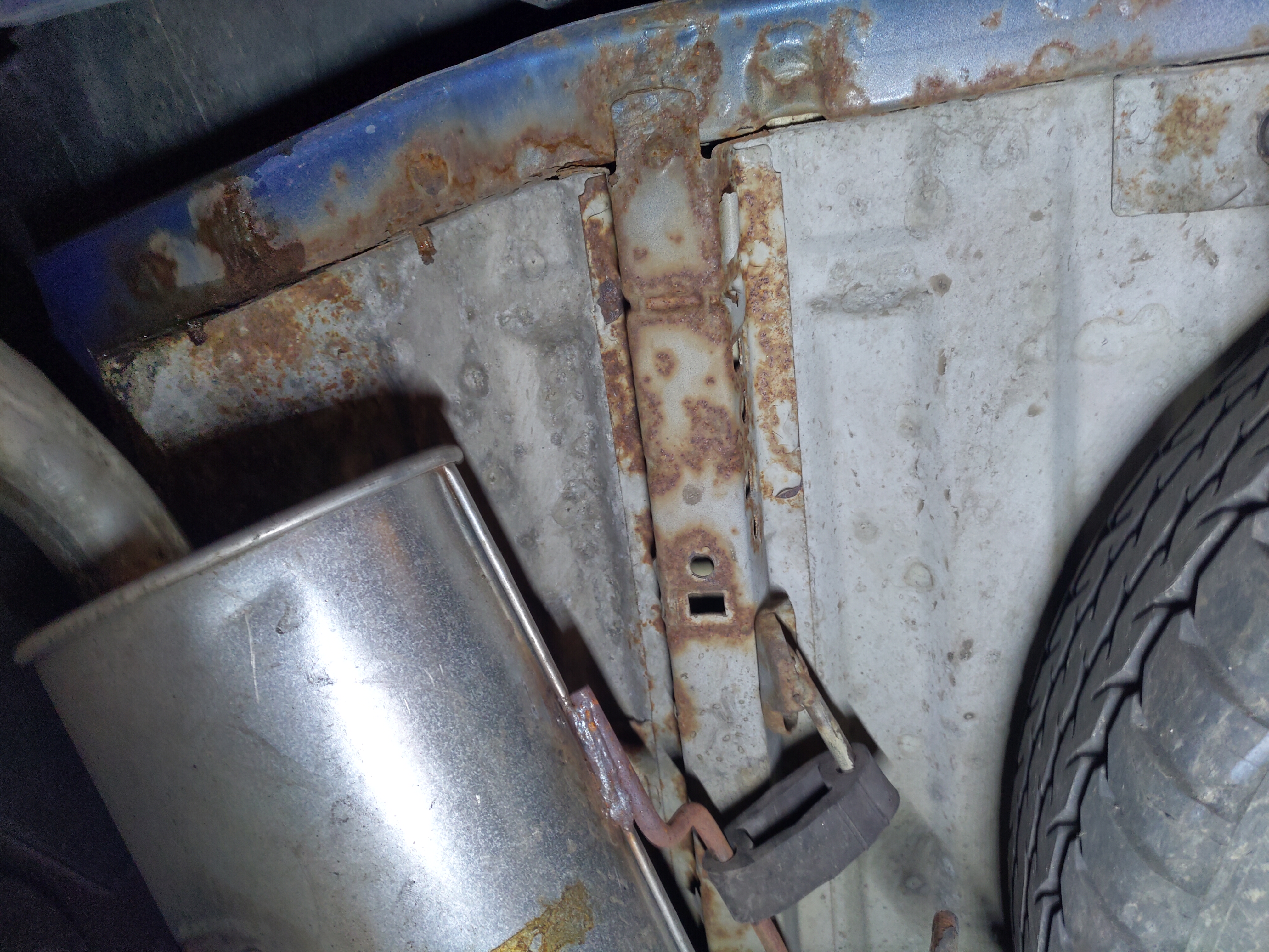

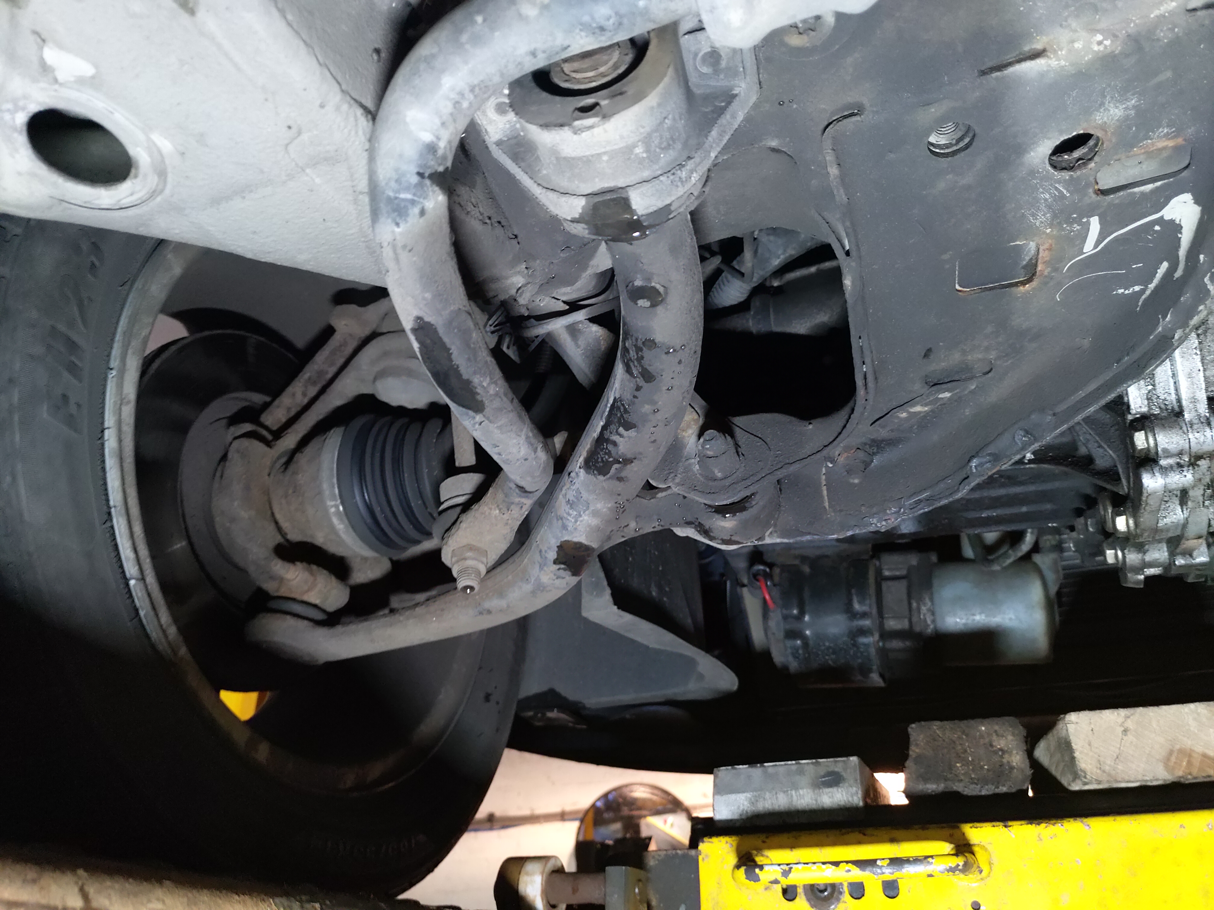

looks proper tidy underneath, I don't know a lot about them but a quick read up points to rust where the rear beam meets the boot floor, under the ecu and fuse box and sills all of which appear to be spot on!

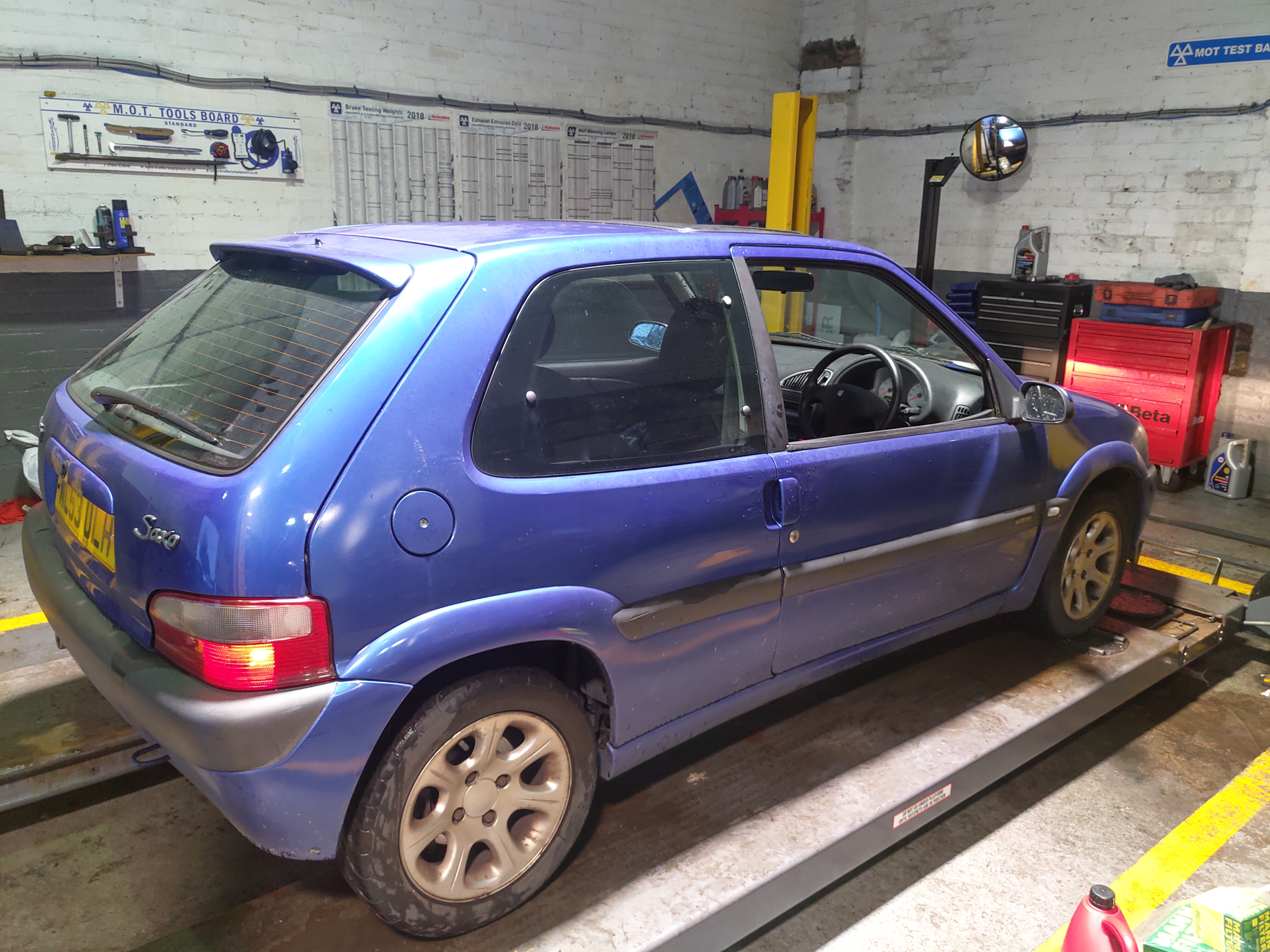

it needs a bit of love to the bodywork as all of them seem to do given how thin they are, some dings, some scrapes, a dent in the rear quarter and the lad said he's never washed it in the 2 years he's owned it, has a couple of suspension knocks but ill give that a good going over anyway!
not sure what my plans are, tempted to just do a minor restoration on it (rear beam, suspension, brakes, underseal, bodywork), I couldn't insure one when I was 17, enjoy its old skool thrills and keep it in the garage and see what happens with the values over the next few years!
Tips? things to watch out for? stuff to check?

Rot:
Front bumper hangers, uUnderECU, Under fuse box, underside strut tops, corners of boot floors, lower section of wheel arch/tub where the rear torsion bar sits (both sides).
*Edit, forgot sunroof drain. Get that done asap.
Mechanical, nothing worth worrying about at all. It can all be fixed cheaply & easily.
Electrically these are starting to show their age. ECU's starting to pack up, sensors (TPS etc) but it's all resolvable. Original parts are difficult but OEM can be a mixed bag, but cheap enough to throw the parts cannon at.

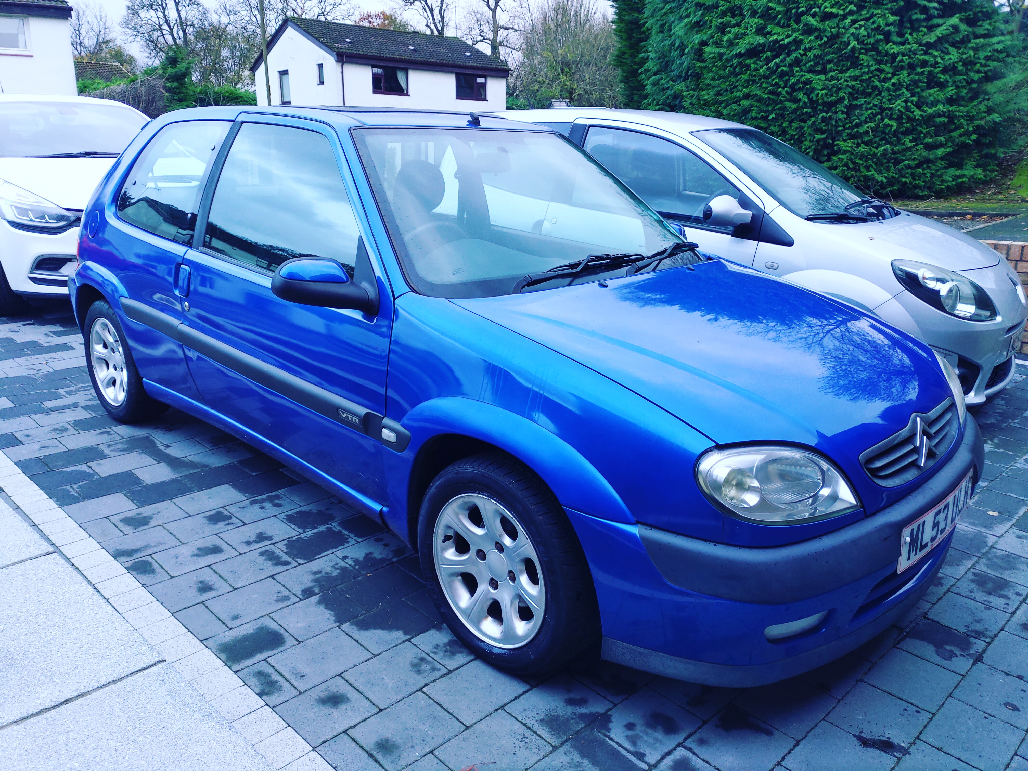

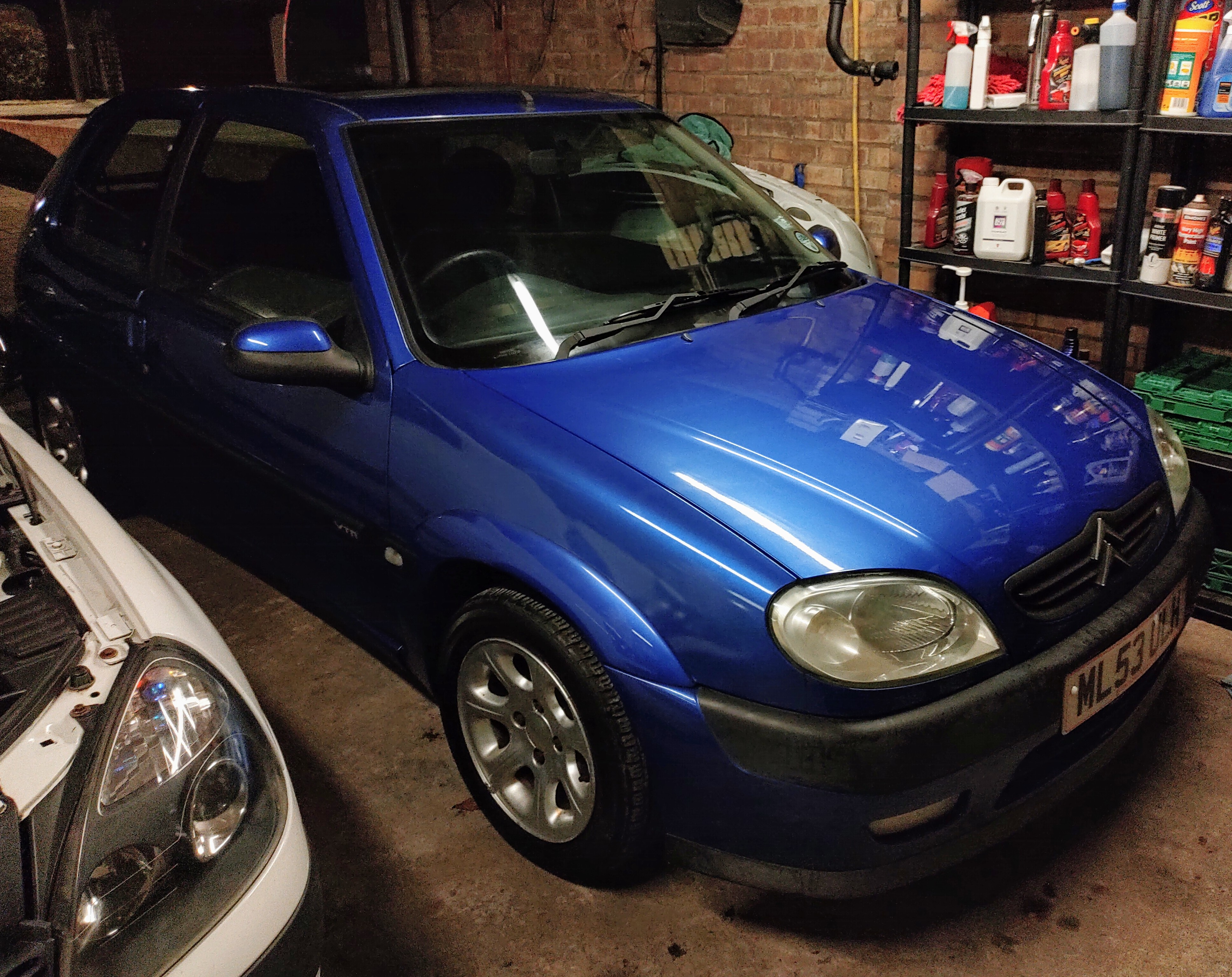

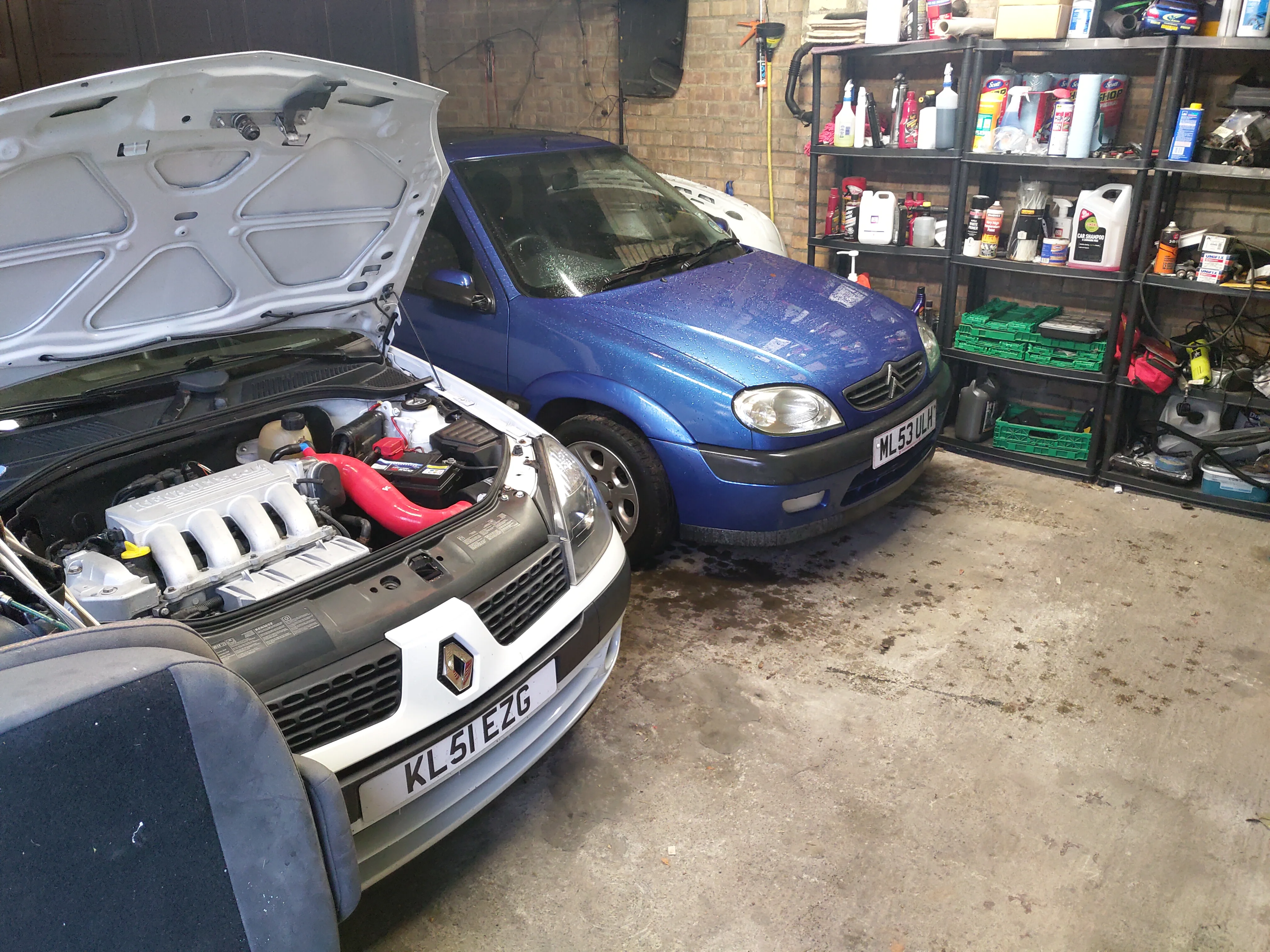

Not had much time to do anything with this so its just been tucked away but I took it to work today and gave it a fresh Oil filter, oil, air filter, fuel filter, and NGK plugs - and as a bonus found a fully stamped up service book in the glovebox! I've ordered a timing belt kit and water pump for it but didn't have time to get it done, maybe next week.
The paint work was in a pretty bad state even though it passes the 2 meter test. Just a few years of neglect, never getting washed and a few dings. I'm going to get it into the body shop to get some paintwork done on some areas so I gave it a proper good clean, blasting out all the grime from the window seals etc, went over it with the clay bar and then ran the rotary over it so I could see what's good and what needs attention. So far looks good and came up very well. It needs a bit of paint on the NSF corner where its got a scuff in the bumper, a tiny bit of rust bubble under the rear wiper where the glass bonds in so ill get the rear screen removed, repaired and refitted its had a small knock on the OSR quarter right on the rubbing strip that has pushed the quarter in a tad so ill get that repaired. Lastly it looks like someone has reversed it into a bollard or something and the towing eye has been shoved over a little and damaged where it comes through the rear bumper so ill straighten that out and probably put a bumper on it if I can get a good one.
For a car that's coming up on 18 years old and looks like its all original underneath it drives really nice but I can feel a bit of play in the steering and the suspension is SUPER soft! although it seems to control rebound still?! so I think after the bodywork is fixed ill refresh the steering components, shocks, springs, arms, bushes etc! - sticking to standard parts.
that's it tucked away again, bit brighter now! ill do a proper detail with the trims etc restored once the paint work is done
