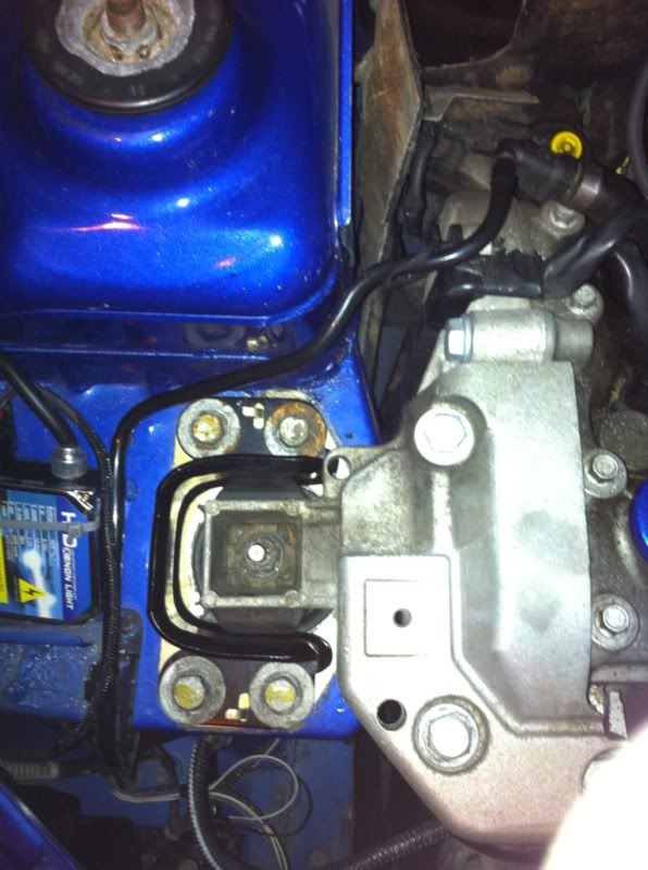

Since I had my Clio 172 cup I ve had massive vibrations come through the dash even when stopped.
A friend said it because I've got a poly bottom dog leg bush on my gear box. But there's no vibration coming through the gear knob.
It's hard to see out of the rear view mirror it vibrates that much lol.
I also have a Decat so the exhaust should be well clear of the sub fram.
Thank you in advance

Dan he wasnt on about the top mounts, he was on about the engine mounts, if your off side top engine mount and upper gearbox mount( the one under the battery) have been uprated to something like the k-tec mounts it will indeed make your car vibrate like fu@k

I would guess that its your upper gearbox mount thats faulty, or the bolt going through it has snapped in half, this happened to mine
It looks ok to me just went and got photo it's not up rated is it?
I had this it was the upper gearbox mount shook the car silly even when still. At 70mph in 5th it was terrible.
