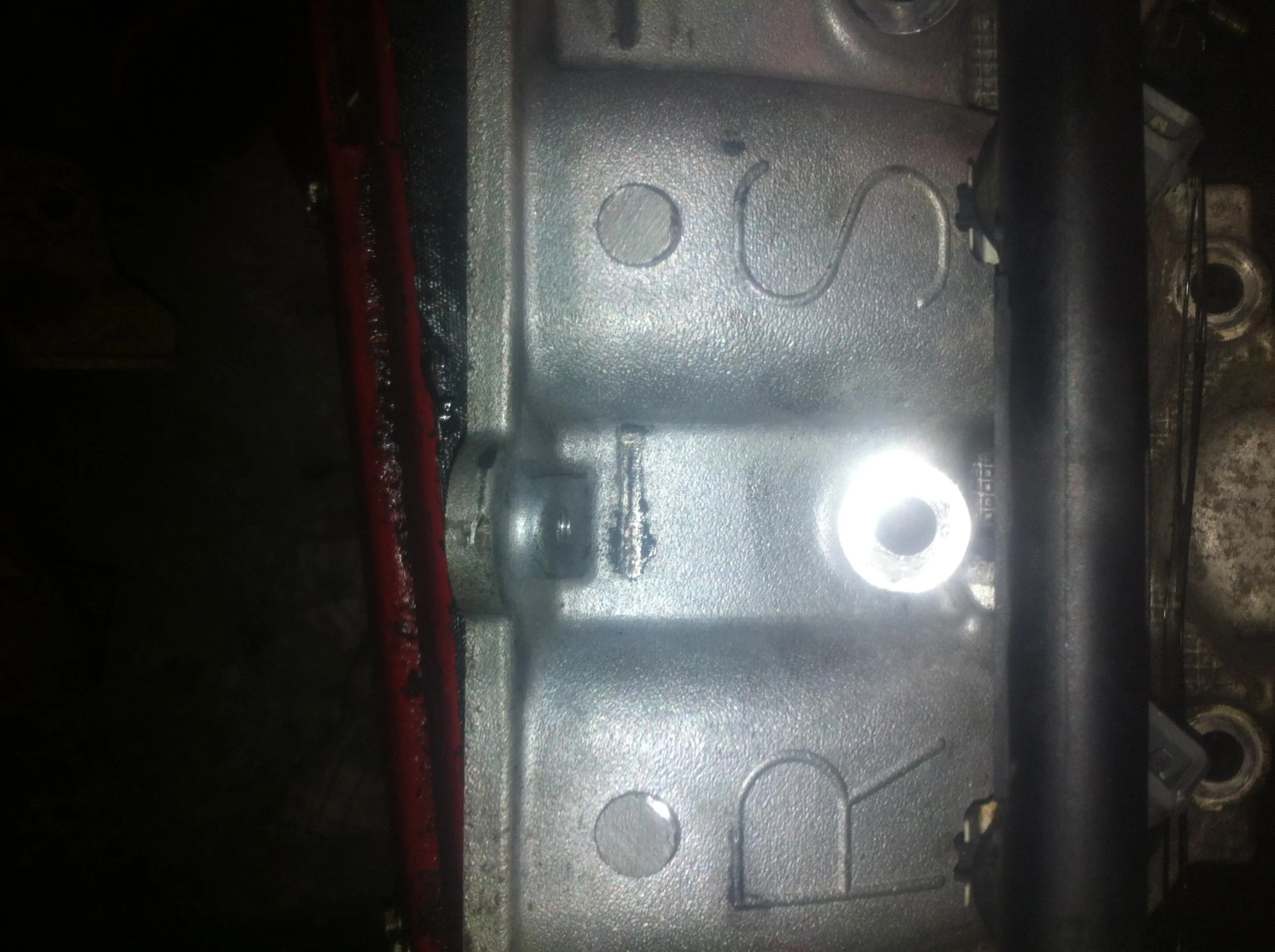

Check first to see if you have the rs stamped lower inlet if so don't bother as they matched from the factory. Remove fuel rail guard(2 x 13 mm I think could be 10mm tho lol) and see if it has rs on it.
inlet manifold.webpIt has RS on there if that's what you mean? so could I get the top inlet matched or is that not worth the pennies?
Ok maybe not a perfect match but hardly worth doing? Questionable if its even worth doing a non rs set imo, money would be better off spent elsewhere for the gains you will see.
I don't think there is any gains with the top inlet being done thb or ktec would be selling them
