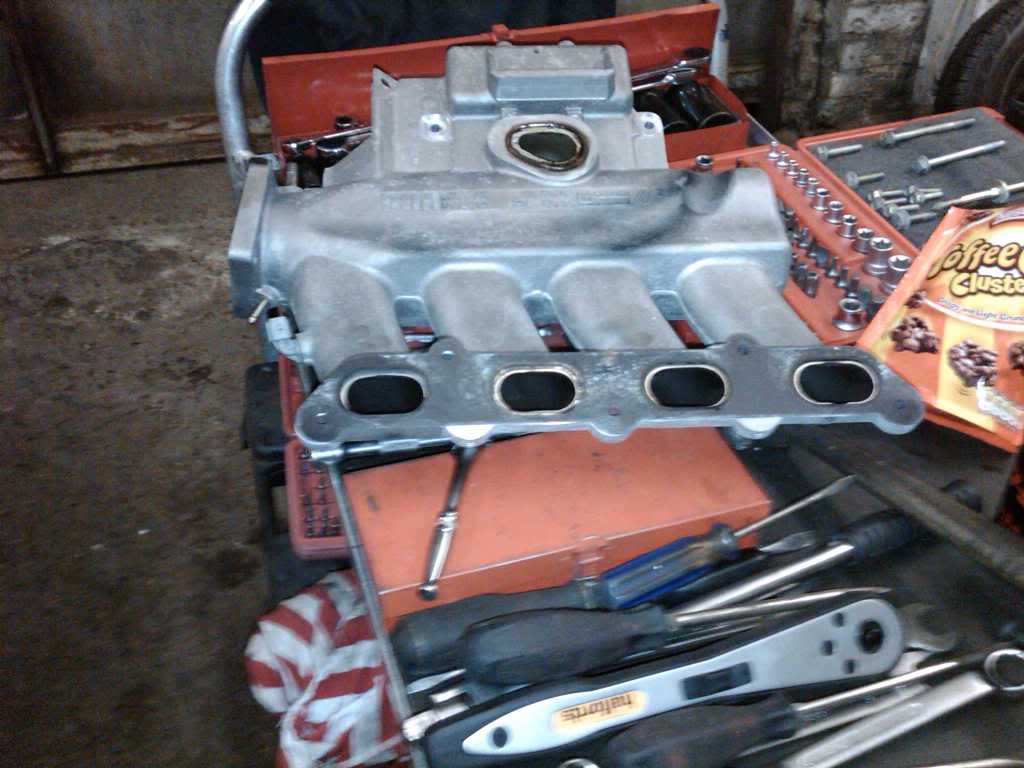

now the plenum must come off, raz the bolts out and lift up, carfull not to mallet the plenum to inlet manifold join as there is a small dowl going though the gasket:
once off you shall notice the plenum hasnt the best ports either:

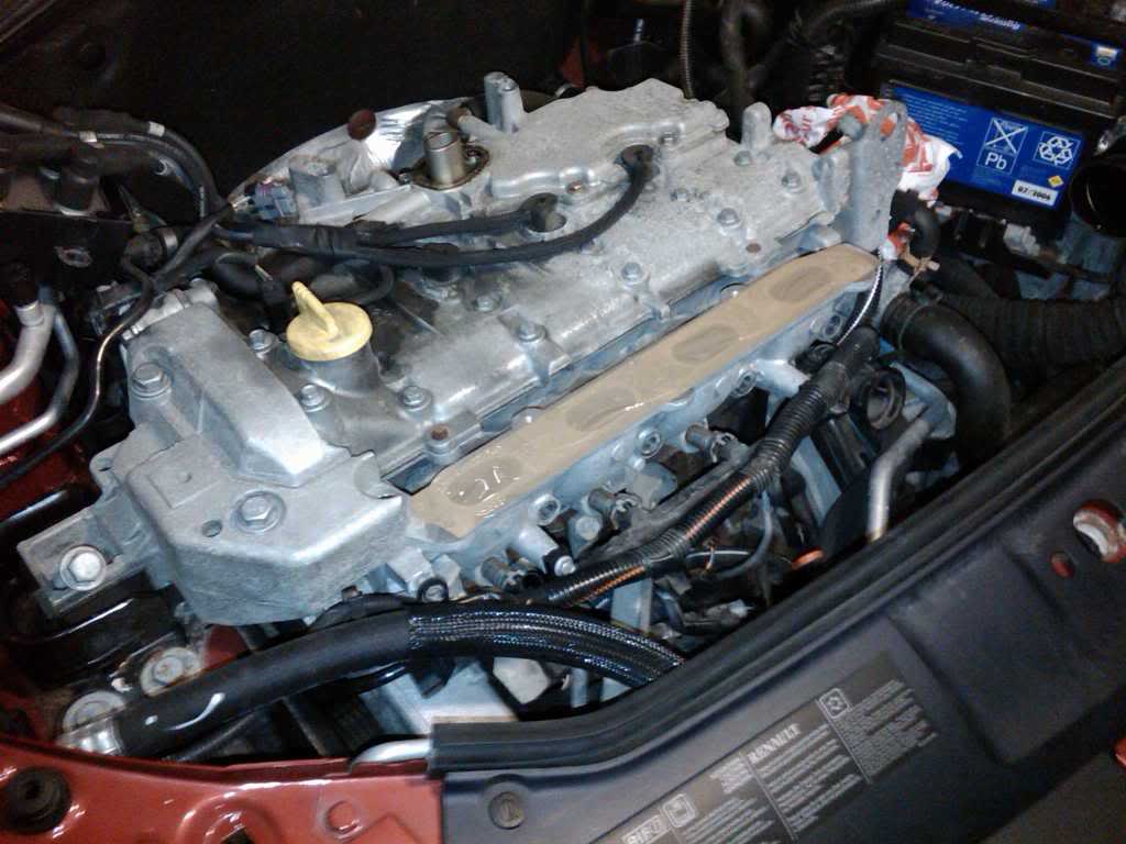

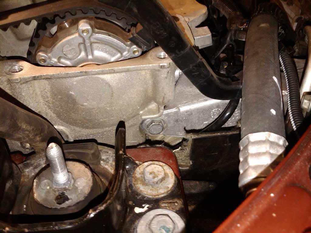

ok so now for the nobby bit, raz off the bolts holding the mani to the head, there is a couple under to the far left which are a little hidden. now you will notice it still isnt budging, this is becouse its a c**k! and has the top mount holding it down and the altonator bracket! now im sure there is other ways to go, one way is to jack the engine a bit and take off the top mount, we simply got pissed off cos it was early in the morning so we got out the engine hoist!

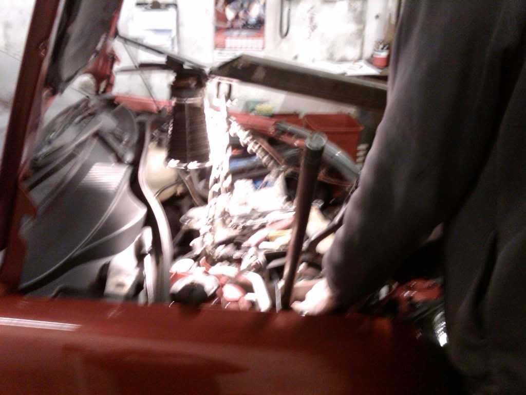

as you can see we jus rigged the chains up to the lifting points, took the mount off and lifted the engine, now got a bar off somekind and push the engine over to the passenger side of the bay.
this will give much easyer access to the side bolt which is a *****! you will find it down behind the bit of carpet which is randomly there? once you have done this its still pretty tight so me being me took a wooden mallet and tapped the manifold on the side to knock it in the direction of the passenger side. if i have missed anything its becouse its proboblly to clear to see that its pointless writing about.

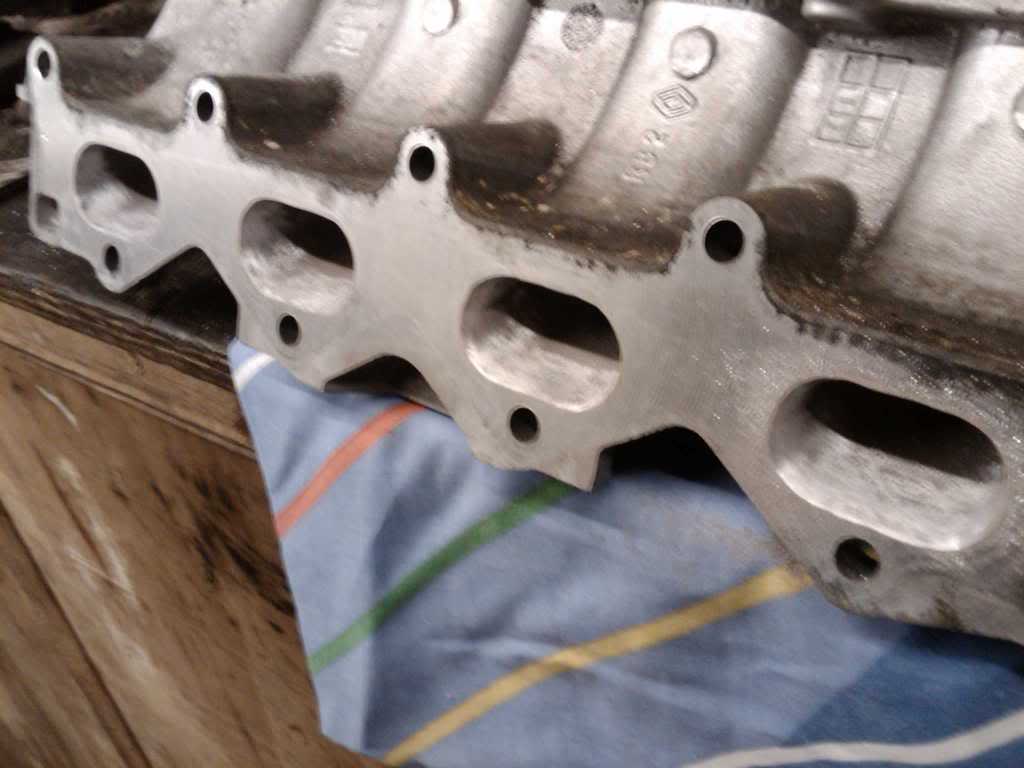

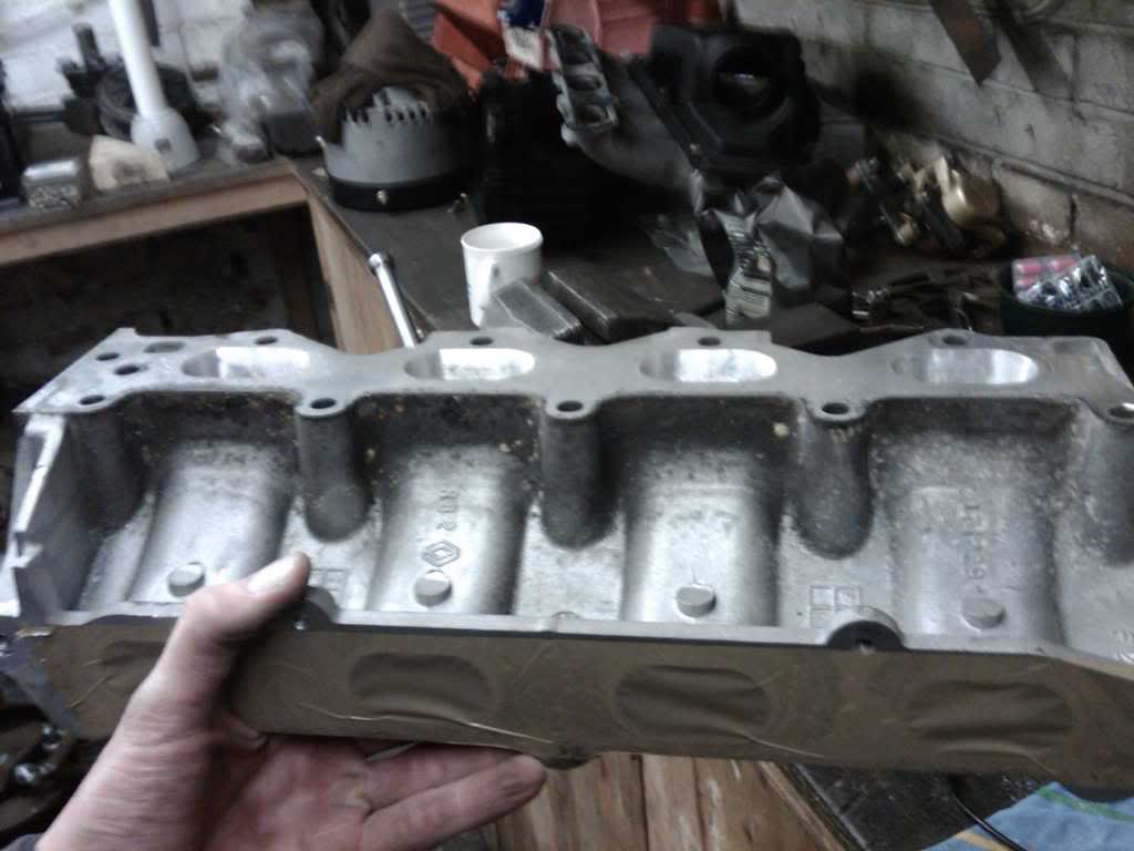

this was the state of the inlet manifold, as you can see its a sack of s**t.
now with this method we are not doing a complete match as that require removing the head, now with most cars you would do this but with 172's its just a case that a heads have been port and polished and are really good, and the inlet mani was sold to renault by opium farmer!

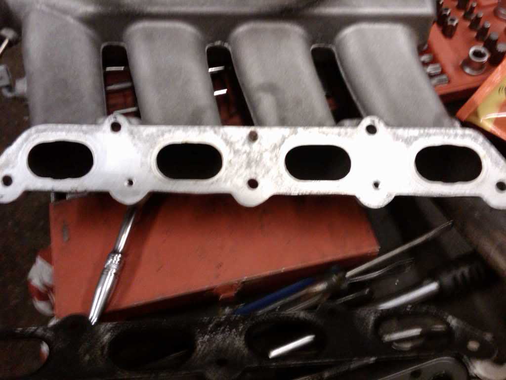

see, tasty stuff.

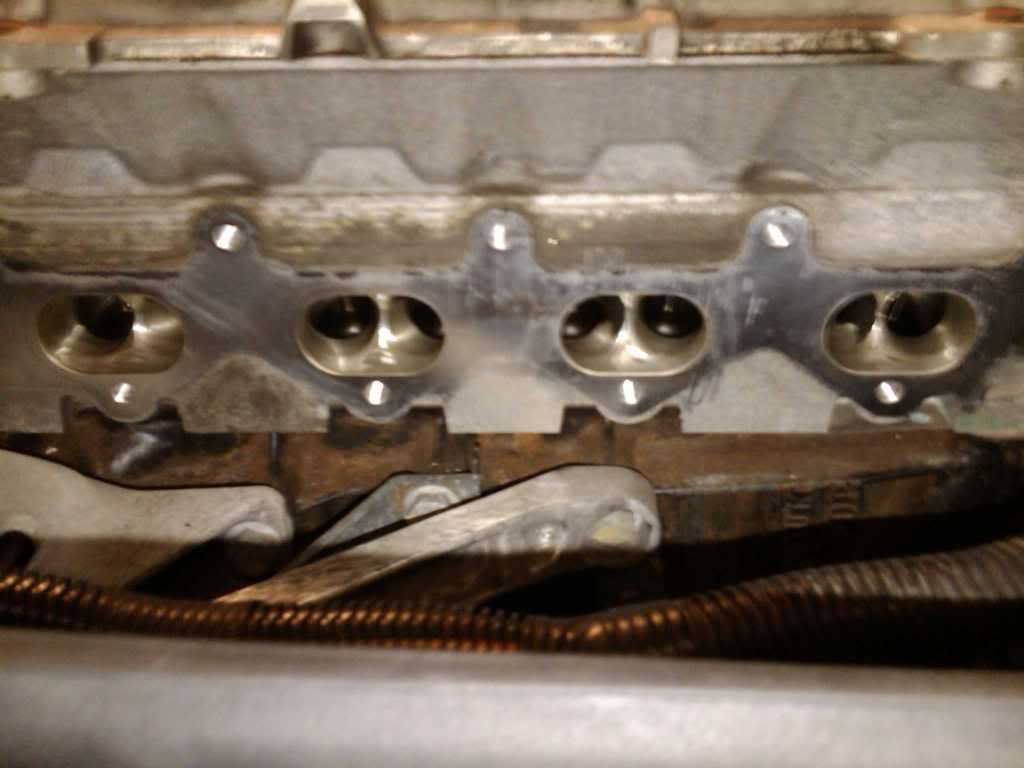

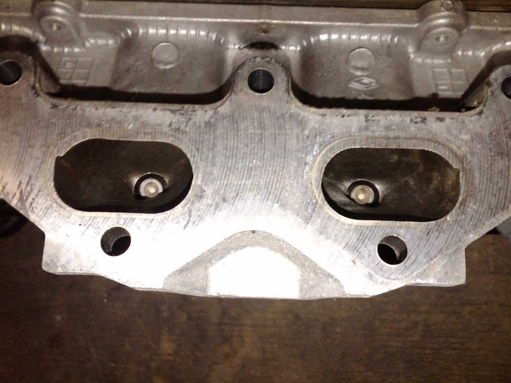

so now all we need to do is get the inlet manifold looking like the ports on the head! remember this is no where near as good as taking it to a pro. so what we did, was made up a template over the ports on the head, remember to block up the ports first to stop s**t getting in them, now we used some flexible flat plastic and a stanley knife. it was cut outs of parafin containers to be the honest, like the containers you get 5L of screen wash in. we screwed this to the head the made cuttings till it was about 98% acurate, then placed these cuttings on the mani and screwed them in position, start grinding with the special bit at the top of this thread then get a nice finnish with the sander bits. again people may say this is bodged but its better than standard and cost little, the rules are simple, dont change the head, dont make the mouth of the manifold bigger than the mouth on the head as this will create a lip. once finished it will look a little like this:
and put her all back together using a new inlet gasket. just use reverse order we found no problems when fixing back up. the plenum gasket in most cases can be reused.
and there you go, hope this sheds some light for people worryed to do a bit of DIY. o and sorry for the spelling im hopeless.

How did you ensure the ports on the lower inlet are the same size as the ports on the plenum? And how did you measure to make sure they are all equal?
Good effort :)
By eye or with tape measure/steel rule probably.
Good on you giving it a go though bud;)
  03 RS clio 172 flameR
Good effort :)
didnt match the plenum to manifold ports mate, they were a bit s**t but not mega s**t like the inlet manifold to head ports. the point i think you are getting at is to ensure that the ports on the head should be the same size throughout, though the main objective i was trying to get was, getting rid of the notch in the inlet manifold and to widen up the inlet manifold port, in the event of me grinding out the inlet manifold too much it would then sit against the head with a lip which would create a drag in the airflow. however if it was the otherway round and id hadnt grinded the inlet manifold enough then it wouldnt create a lip. so basiclly as long as whatever i removed remained less than or equal to the head then all i could have done is create a improvment in power or same as before. like i said i didnt change the inlet to plenum ports so they remain the same as before.
