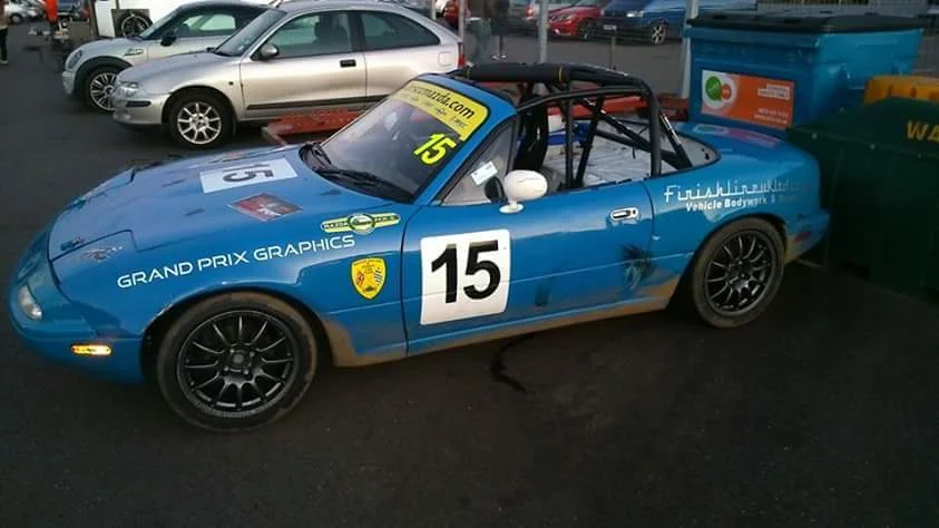

Hello Mx5! With entries over 50 cars per race weekend, strong, reliable engines and drive train and competition at its best this was right up my street!
With it being the first rear wheel drive car I've have ever driven, I thought I'd best have a day to get to know the car's characteristics before jumping in at the deep end. I've never had so much fun on track. These little cars are very underated. Never the less I was very slow. I was taking it easy but to be fair a lap time of 1:55 was nowhere near good enough. I had a lot to learn!
  Clio 172 Cup
The time came. My first race weekend! Was I prepared? Nope. Lol.
I was honestly ready to sell up after this meeting. You will see why further down...
The championship I chose to race in was the BRSCC Mazda Mx5 Championship. Because of the high number of entries the races are split in to an A race and a B race. The A race being the fastest half and the B race being the not so fast.
The format for cadwell was one qualifying session followed by 3 races spread over a 2 day meeting. Each session 20 minutes long.
A quick check over the car and applying the championship decals to look as if I knew what I was doing. Excuse the budget set up.

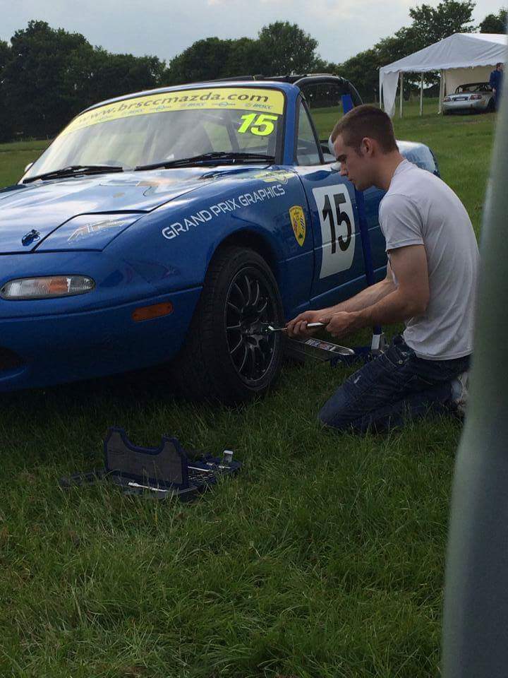

The rush was on to get my car repaired in time for Race 2! I almost forgot to torque my wheel nuts up.

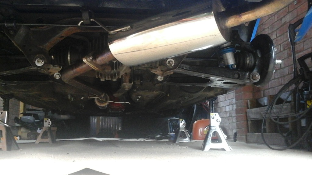

  Clio 172 Cup
Engine/Gearbox
Skimmed head, 3 angle cut valves, standard bottom end
AK Automotive race exhaust, K and N panel filter
Cold air feed, adjusted MAY and engine timing
Alloy radiator, SFS coolant hoses, motul coolant
Rebuilt gearbox, AP Racing clutch, Quaife knob, Vlsd.
Suspension/brakes
Gaz gold professional coilovers
IL Motorsport bushes, powdercoat ed suspension arms, Powerflex ARB bushes
New ball joints, track rods and ends. New wheel bearings
Refreshed calipers, Mintex M1144 pads, Brembo HC discs, Hel braided hoses, Millers motorsport 300 fluid
Interior/safety
Safety devices roll cage, lifeline fire extinguisher, msa rain light
Sparco 6 point hans harness, Corbeau Revolution seat, Sparco steering wheel, OMP boss
30KG Ballast to meet the 960kg minimum weight.
Other
R package splitter, cold air feed, wide rear view mirror

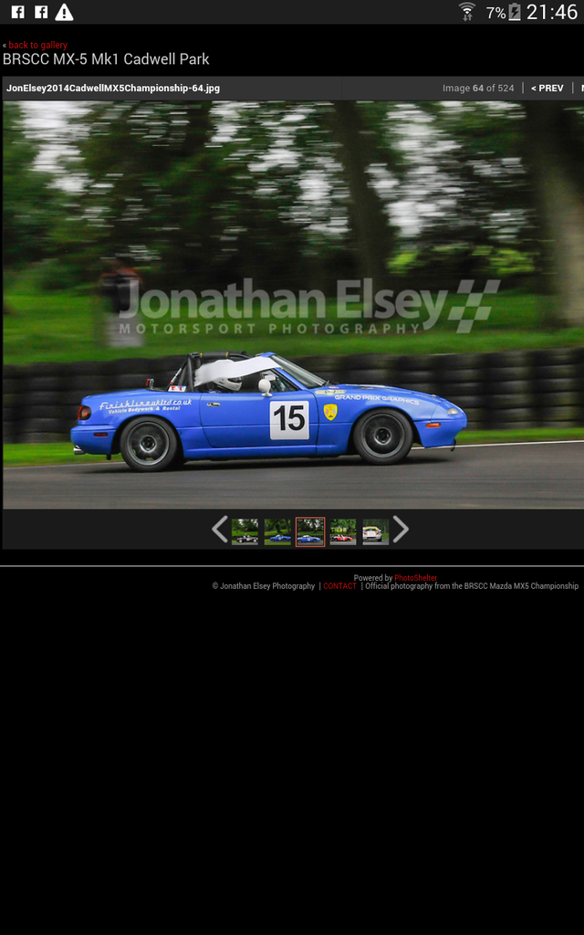

Silverstone saw me straight into the A race. I went from 28th to 21st. The competition is so much greater than the previous year. I must have had contact 6 or 7 times in the 2 races. My freshly powdercoated right wishbone got bent slightly in race 1 :(
The improvements I made over winter made the car feel so much more balanced. It gave me the confidence to push harder!

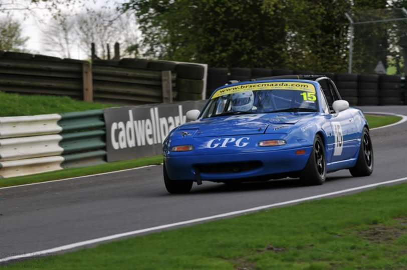

And then back to the notorious cadwell park. This meeting didn't disappoint. It was my best chance for a top 10 overall. Close racing would be an understatement. Only us in mazdas could prove you can go 4 abreast into the mountain!
  Clio 172 Cup
I managed 14th with lap times into the 1 minute 47s. Big contrast to the times I was doing in 2014.

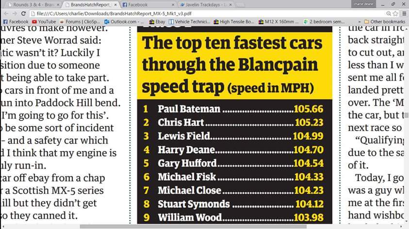

Looks like great fun! I just noticed that Chris Hart is racing in this, I used to work for him many many years ago! He seems quite competitive for an older, larger guy.
Yeah he's probably got the fastest engine on the grid too. He has about 6 to 10mph over my car along the straights. I also have a bit of his paint down my drivers side after brands hatch. But yeah he's a lovely guy and a great character!

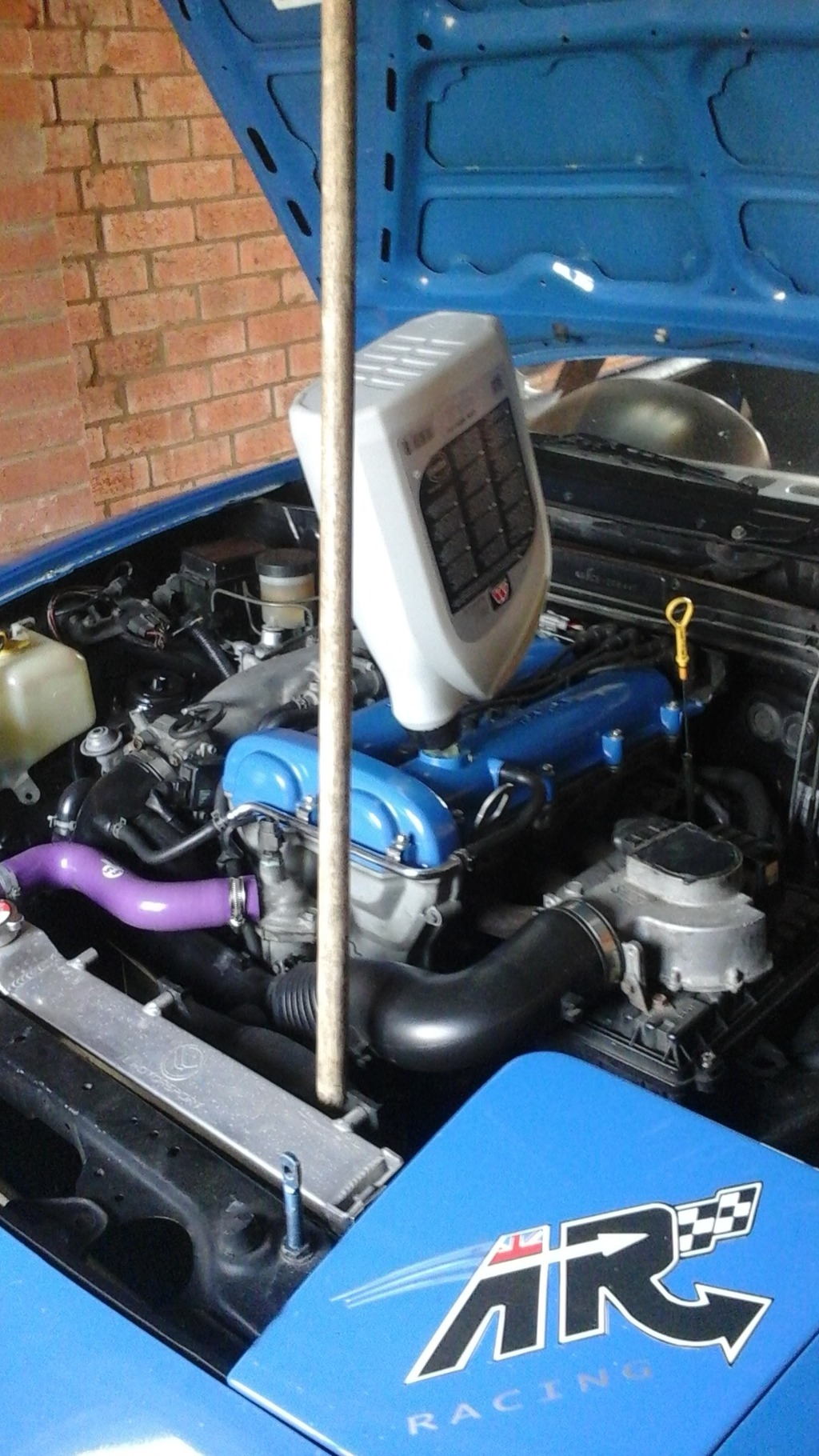

With the first meeting of the season just days away, I thought I best finish off the preparation of the car. Oil and oil filter change, timing check and a full brake fluid flush with Millers motorsport 300.

What are you allowed to do regarding engine tuning?
Replacement panel air filter. 63mm cold air feed.
Standard exhaust manifold but you can grind off the internal welds for better flow, exhaust system free up to a bore of 3 inch I think.
Head skimming is free to raise compression. Valve seats can be cut.
.50 larger pistons if you have the block rehoned
Static engine timing is free.
On a dyno you can play with the air/fuel meter to optimize performance.
Flywheel, valves, camshafts etc all have to be standard.

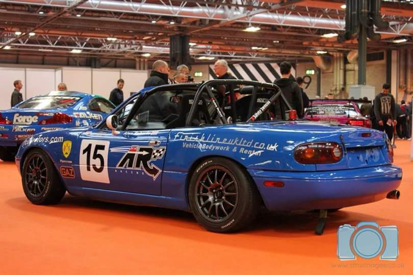

Here's a picture of the two Finishline cars in 2014 in 8th and 9th place at brands hatch indy.
It was also on show at Autosport international

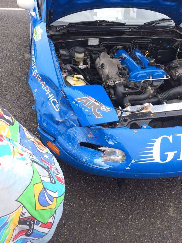

Rear quarter, door, wing and front bumper took a fair amount of damage. Passenger front wheel was toeing out like crazy. Such a shame. I'll let you decide who was at fault. The race was red flagged as the camera car couldn't move.
I limped it back round to the pitlane. It called over the tannoy that I was in the pit. Cue my girlfriend to come running over to me lol.
The guys from D and S motorsport pulled my wing back out to clear the wheel to try and get back out. I was in a little bit of pain as my shoulder half dislocated. I made the restart from the pitlane putting me dead last. I came back on the racing circuit at the field were already approaching the hairpin. The car drove like a Limited edition Corsa. Awful. Loads of understeer followed by unwanted oversteer. Even a whiteline RARB wouldnt help me. Never the less I made it up to 18th so not a wasted weekend. I still really enjoyed it and had a smile on my face! Just.
The car is almost fully repaired before Brands Hatch. I just need to do full geometry and new rear pads and brake discs all round. George Snee is my disc supplier!
